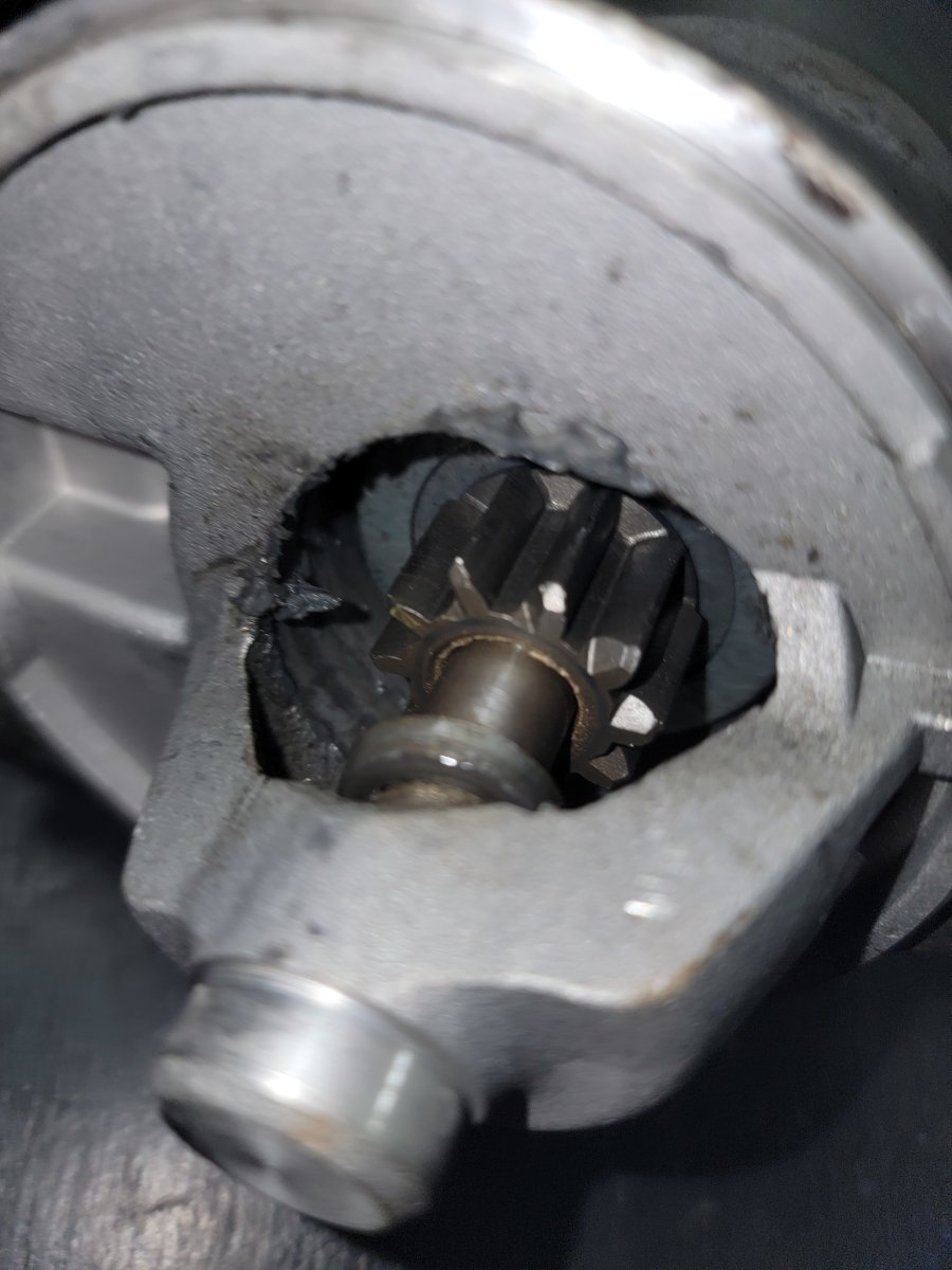

I would also confirm that the starter has the right gear on it. The engagement is way less than it should be on the ring gear, not like the starter shifted a little, more like the starter gear has too few teeth.
Long shot, but also try to confirm that you got a manual starter when you replaced it. 4.0 starter's have slightly different "nose" lengths for manual and auto trans.
Okay. I just pulled the starter out of the truck the bottom bolt was very snug, the top one actually wasn't the tightest. Maybe 5 foot pounds on it? Oops. I do believe this is a manual starter based on the images I am seeing on RockAuto. Look right to you?
Having said that though - it does actually seem like the starter is making minimal contact with the ring gear when trying to turn the engine over. Attached is the current condition of the ring gear. In the position it is currently sitting, the flywheel isn't making contact with it and it is not turning over. The pics aren't the best, but you can see where only the tips of the ring gear are worn down. Other than that there's still a lot of each tooth there. Surely it can't be designed to only use that much of the tooth as a contact surface for cranking over? (P.S. See! I cleaned the plate before reassembly.. not the gunk inside the bell housing but I did clean the mounting surfaces lol)

So I did check and I have 10 teeth on the starter. The flywheel I installed was this one from Orielly's. I don't know if that is at all useful info but I figured I may as well put it out there.
I can find a lot of people talking about similar problems and headaches but none seem to offer a real solution which is a bit disheartening.
I don't have a starter "nose" measurement, and I can't tell the difference manual versus auto starter by just looking at a starter. I'd need to see the two side-by-side to see the difference.
The only suggestion that I can think of, is see if there is a parts store nearby (maybe a "big box" chain store) that has both 4.0 starters in stock (manual AND auto), and see if they would let you come in and look at the two, comparing them to your starter.
That would also let you check where that thrust bearing, that stops the drive gear, is supposed to be (I'm not sure that it looks right). Replacement parts quality has gotten so bad, that you can't really rule out, that the new starter that you put on it, may have a wrong part put in it or be incorrectly assembled.
I can try checking around, but just comparing pictures all of the manual transmission starters for a 4.0 ranger on RockAuto have the same rectangular cutout that can be visible in my 2nd picture of the starter while none of the automatic ones have that.

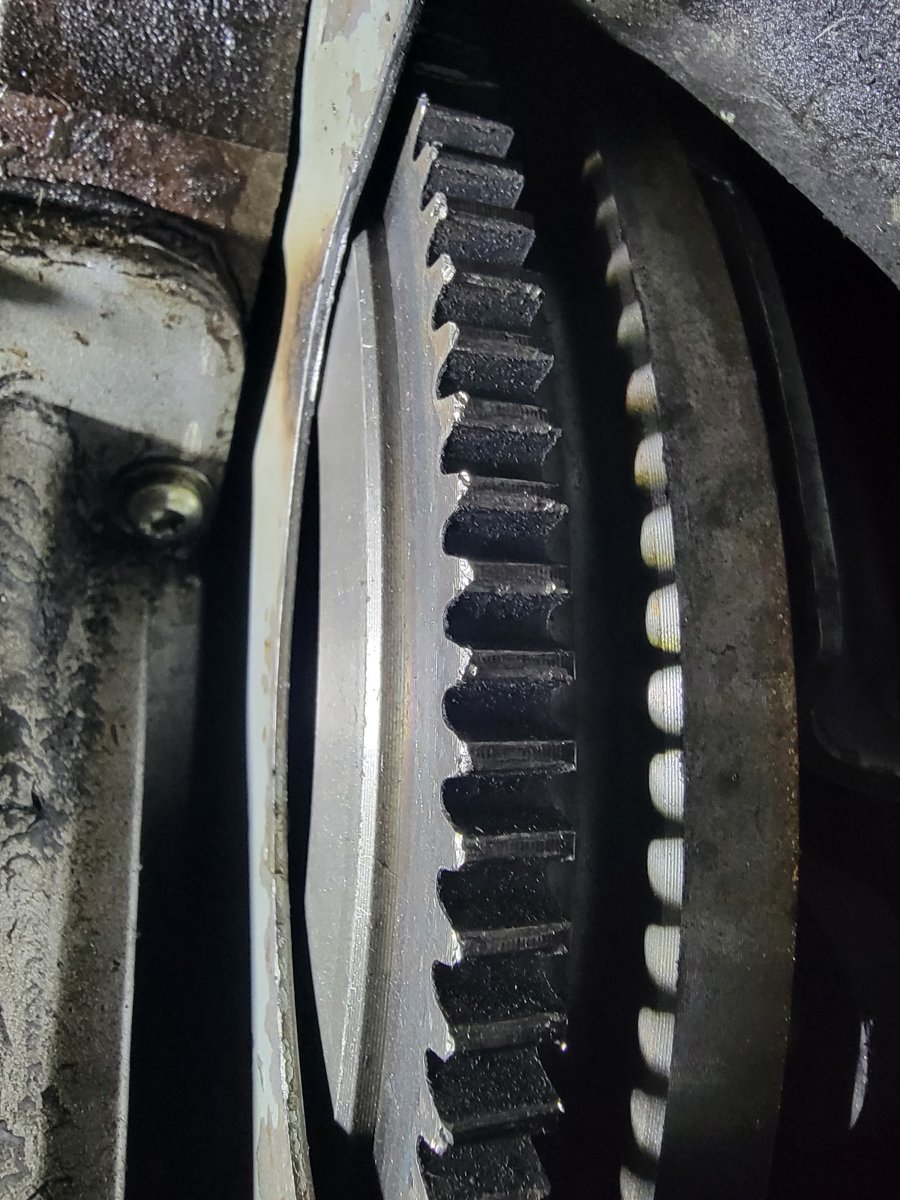

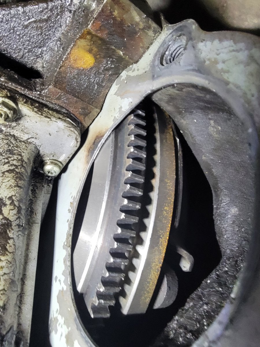

I agree that it looks like the starter gear isn't making good contact with the flywheel. Not sure how that 's possible though with out something being the wrong part or at least worn/broken. Hmm. I don't see any damage to the starter teeth. May just be the picture though
I see what you mean about the square inset area. Definitely looks like the manual starter. Both parts on RockAuto are listed as 10 tooth gear. It seems pretty unlikely they'd have 2 different 10t gears but possible I guess. If there were they probably wouldn't fit in the same place.
Pretty sure that's the same flywheel I'm using. As long as the right one was in the box. I can't imagine anything else being close enough to bolt up and match the clutch though.
As for the crank sensor, I've heard alignment of those is critical. Never had a problem with it myself. Can't really see how that would cause the tach to move either though. I could see an aftermarket sensor being sensitive enough to pickup on the magnetic field of the starter spinning. Weird and unlikely but possible I suppose. I doubt that would hurt anything as long as it stopped when the engine fired. Could cause the timing to be off when it first fired I guess.
Looking closely at the teeth I can see some wear, but very minor and none of them are broken.
The flywheel matched the old one I was replacing and didn't have any weird fitment issues so it is the right one as far as I can tell
