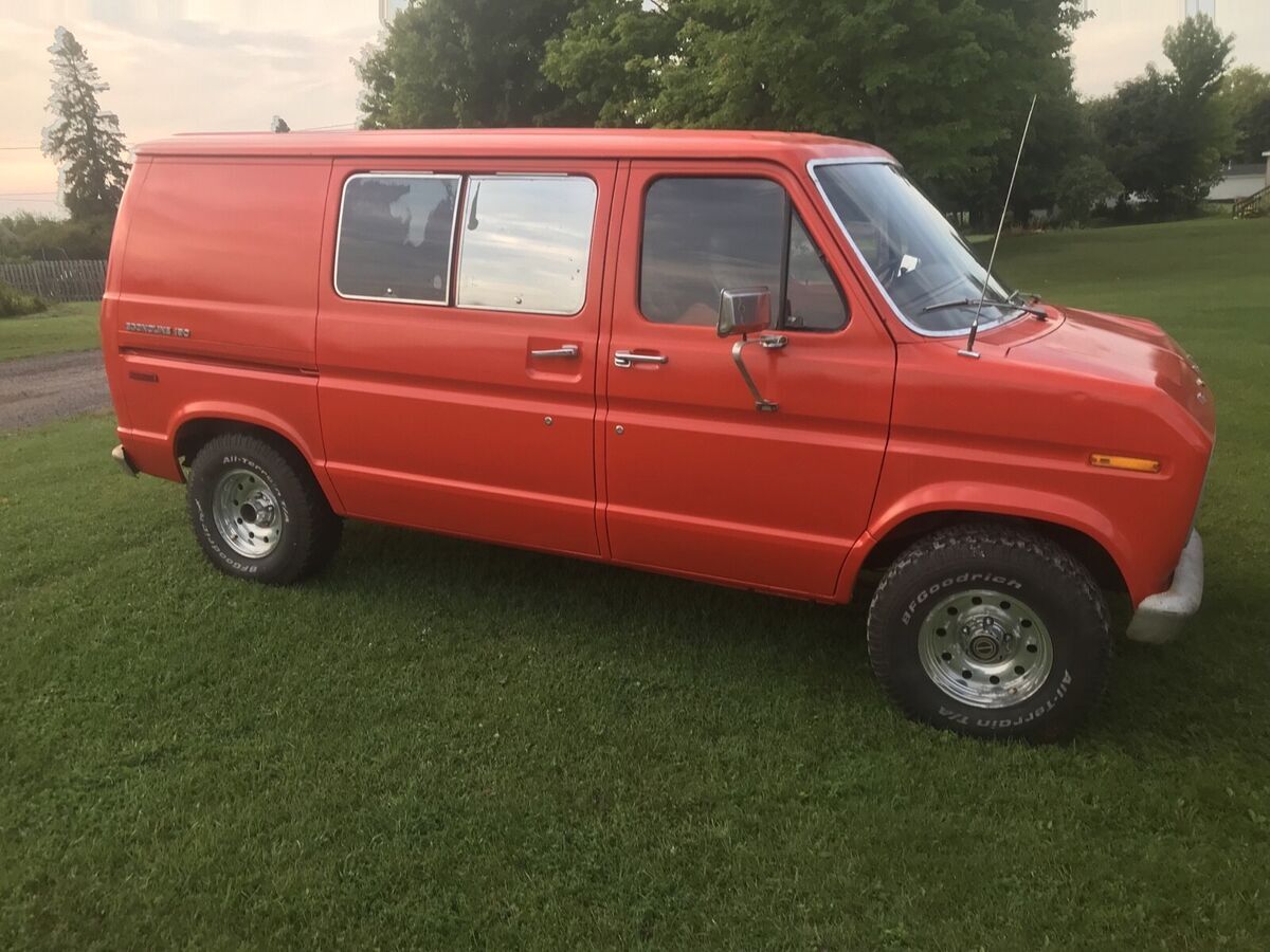

Someone ranger swapped the front of your van, ha ha ha, thats awesome.
My parents had an e150 from wheb i qas in kindergarten till 10th grade. It sat in the driveway for a few years so i was politicing to get it as my first car but they have it to my uncle who trashed it, like everything else he ever had. I was bummed because it was such a cool van.
78 e150 with inline 300 and autotrans. They bought it on oahu when we lived there and brouhht it back to austin and socal when we moved back. It was a cross country cruiser for a family of 6
Like this, but brown

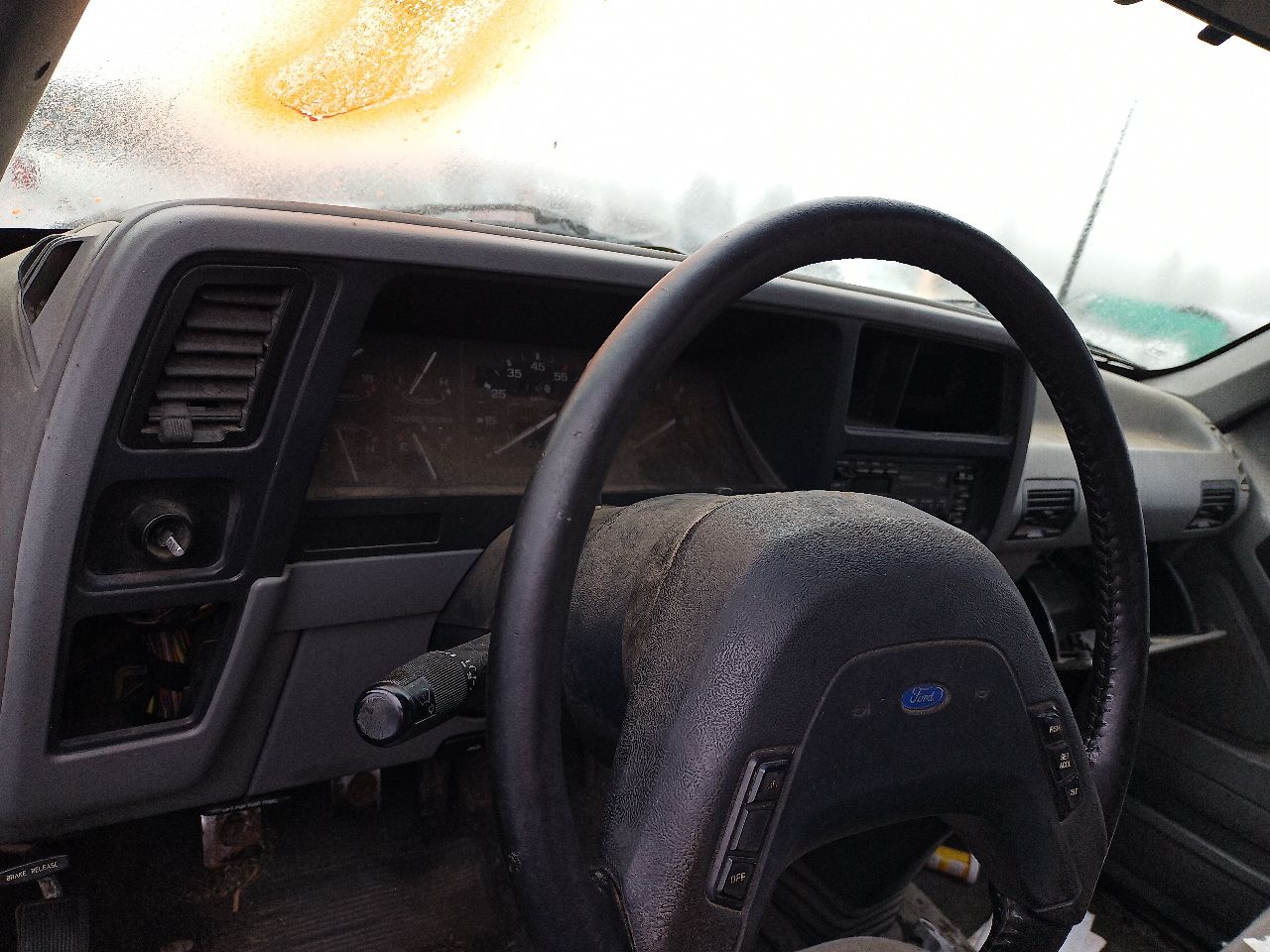

Yeah I feel that, going to another state for a junk yard sucks, but they're taking pictures of the insides now
Soul crushed and seeking advice on starting problems
That's obviously a gear shift, I don't know if there a flywheel or starter attached to it somewhere, if it's oem or even usable.
