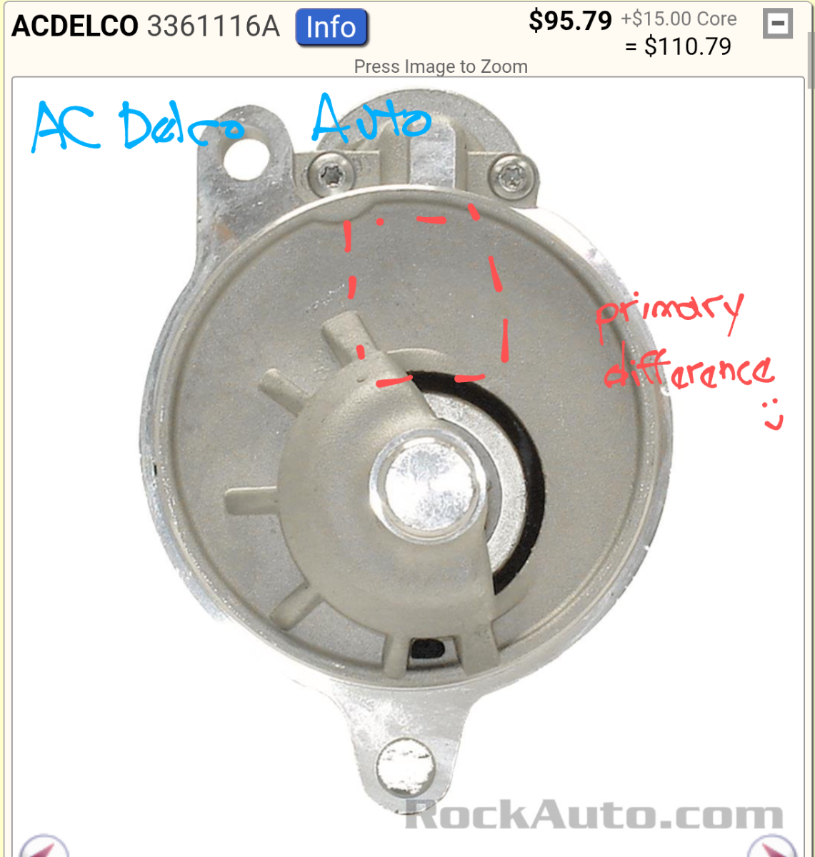

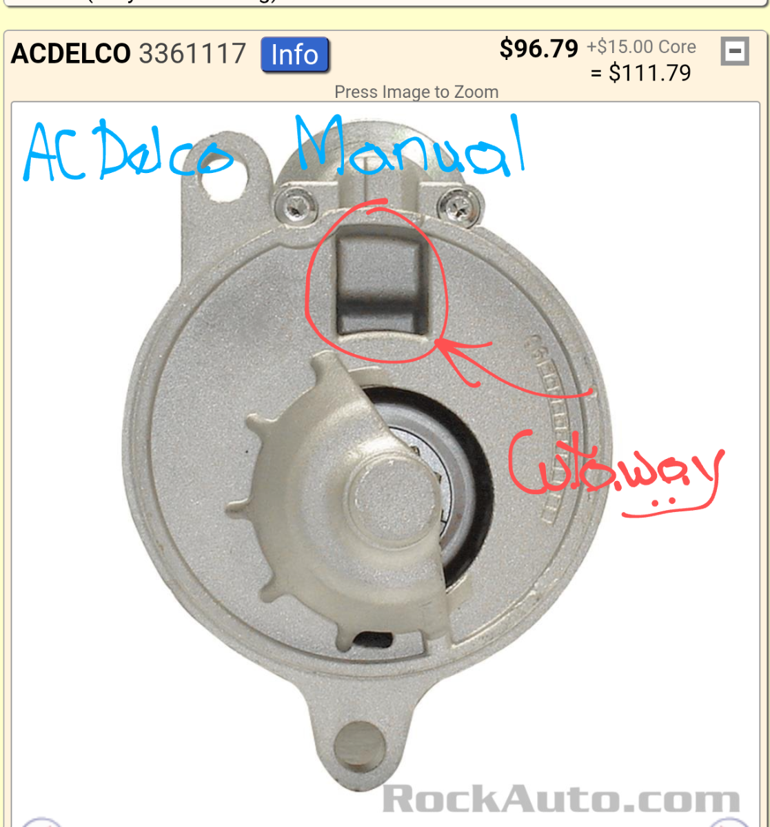

  • Soul crushed and seeking advice on starting problems
I just noticed that there is more of the teeth visible in that straight on picture of the manual starter. Maybe the sprocket is sightly different and the rebuilder used the wrong one?
I would say its a slightly different angle. The clutch drive sits back from the end of the nose about 3". Doesnt take much to hide the teeth.
Indeed I had made a similar observation, but to my eyes my starter teeth stick out the same amount as what I saw seeing in the online pictures.
