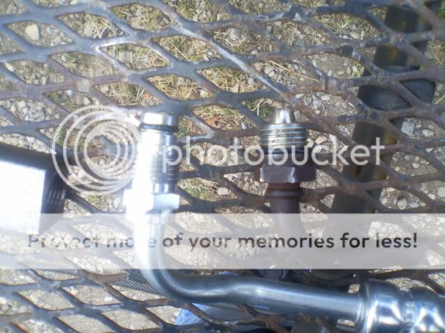

When I did my saginaw pump on my '95 4.0 I had to buy a high pressure hose for and older truck. The fitting that goes into the pump was different. I think they changed hose styles in '95 when they went ODB II.
Heres a comparison of the two styles. Saginaw hose is the shiny one.

Mine looks like the one on the right.....
Mine looks like the one on the left.
It looks like the one one the right and it worked on the Saginaw? I tried it at first and it leaked like there was a 1 inch hole in the hose.lol Thats when I noticed the pump fitting was a lot deeper and didnt have a tapered seat fort he tip of the line.
