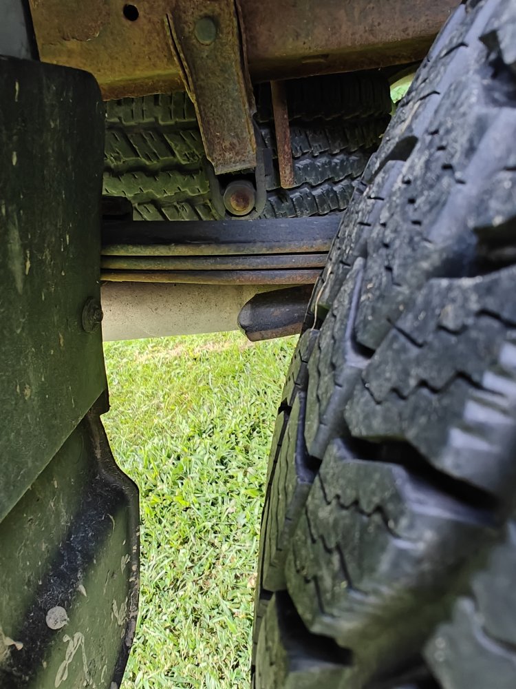

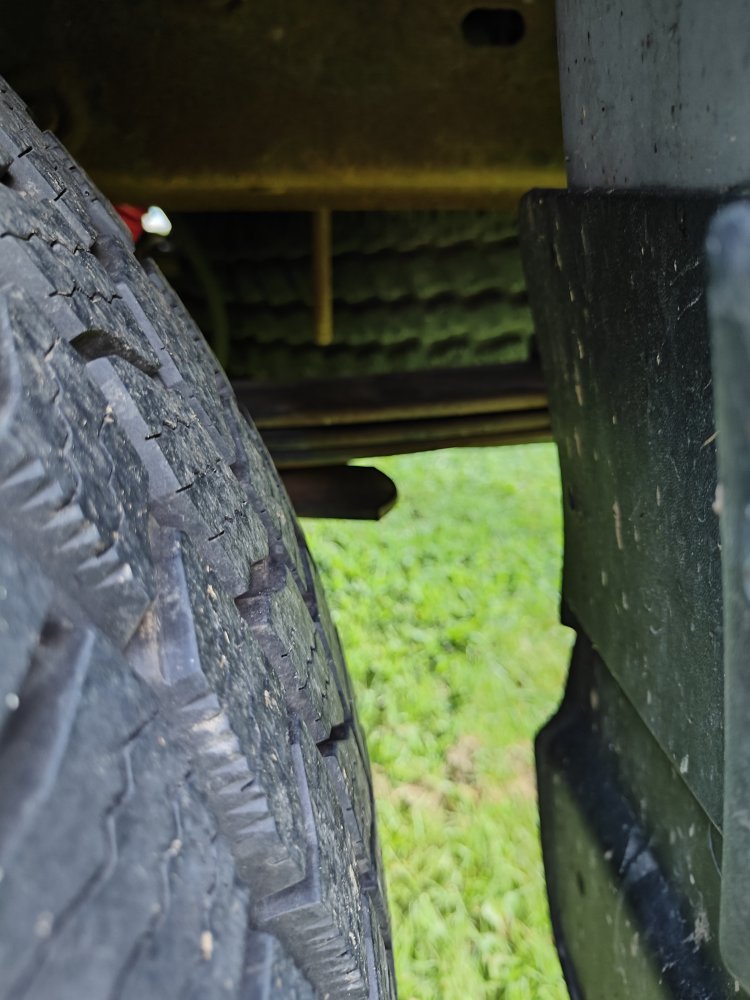

Ok so here's the passenger side view from what I can see fore and aft of the tire:

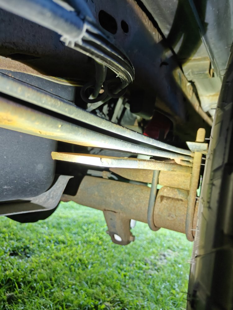

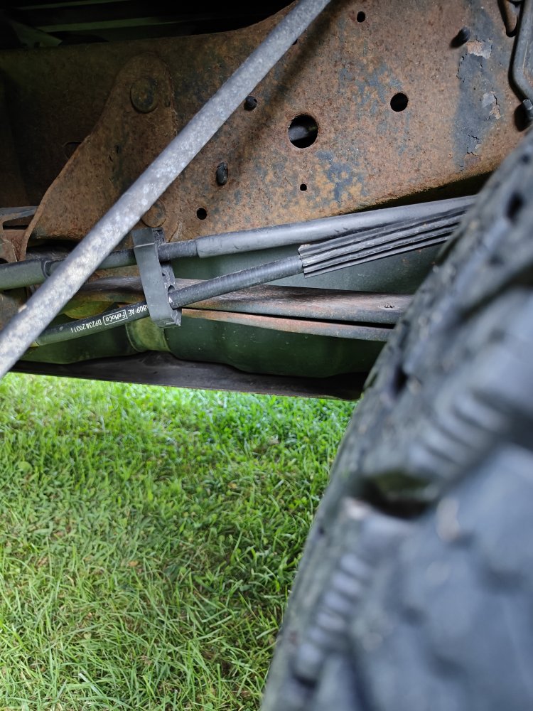

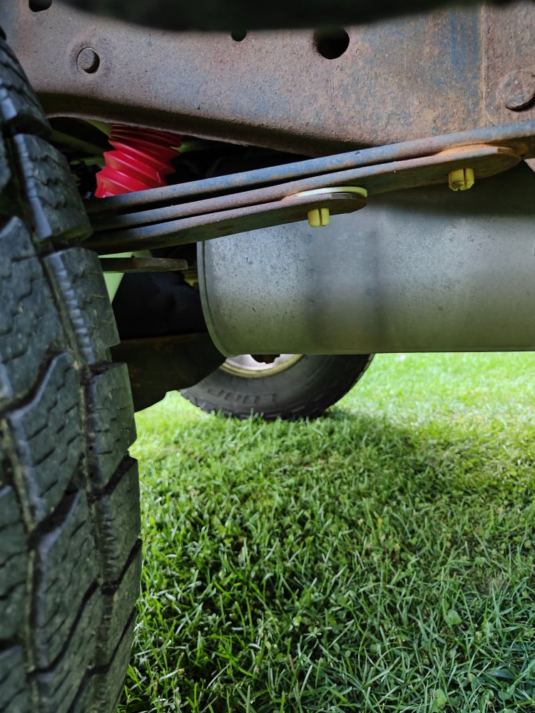

And here are photos of the driver side leaf spring:
It's a little blurry, but I think I see three (excluding the thick bottom overload) behind the axle and only two in front. I thinks you might have a broken leaf spring from those pictures. Take a look up behind the wheel to verify. If so, that could definitely cause a height difference.
Yes you are correct only two in front and 3 in the back. Thanks, I'll go out and check right now! To think I had both tires off yesterday and completely missed it lol
You are 100% correct, so I guess new leaf springs are in order. I think I'll go with the 1200lbs as I think OEM is 1100 on an XLT 4x4?
Now I know what a broken leaf spring looks like lol. The break looks rusty to me so not sure if it was broken when I bought the truck because in all my suspension faffing, I've measured the front and rear height a dozen times and I swear it was always level lol. I'm guess it doesn't matter now as I need new leafs either way. Is it safe to drive the truck to work until I put new leafs in this weekend? Thankfully the job site is only 10 minutes from my house this week
