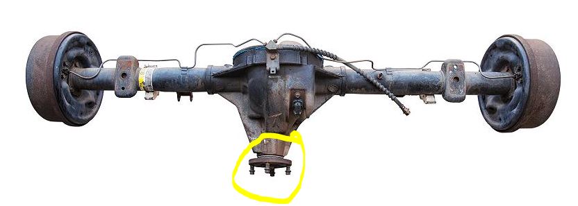

Converting to a lower-tooth-count tone ring on the driveshaft is brilliant, but I guess I don't really understand why it works? Not sure if this is a derail, since it seems like OP cares very much about keeping ABS.
I get that both setups are 29 pulses/output shaft rev, and I guess maybe the computer can track output shaft revs via the speed sensor?
I would have said input shaft, not output.
The 108/3.73 is just an example. If I had 4.10 gears would have been 108/4.1 = 26.4, so 26 teeth on the tone ring. Not quite as nice, but close enough to convince the computer the rear axle was turning the correct speed. Divide by the appropriate number for the ratio you are using and machine the corresponding toothed ring. Note: While this works fine for my '98 with just RABS, full ABS would freak at the difference at highway speeds. <In theory, there is a way to tell the computer you have a 7.5" (102t tone ring), then 102/4.1 =24.9, close enough to 25 that ABS should be happy. But I didn't have to sort that out in Forscan>.
Note that I never said I have a Toyota rear axle. I tried, but I could never find one for the price I wanted to pay (>$300 * 7 - 14 x 5J Toyota dually rims really slowed me down).
I found that the dually Sprinter vans came with 16x5.5J rims. OEM tires on the Sprinter were 215/85R16. 205/65R16 looked more appropriate on a 2wd Ranger, IMHO. So, think Ford 9" with Chevrolet Dana 44 front axle spindles hubs (gets 6x5.5 pattern/effectively they make it full floater) then adapters to the 6x205 pattern for the Sprinter rims. Caddy Eldorado calipers work with discs on the hubs and provide both regular & parking brakes.
The snout on the 9" makes for easy mounting of the sensor.
Just properly proportion the rear brakes before driving on gravel.
