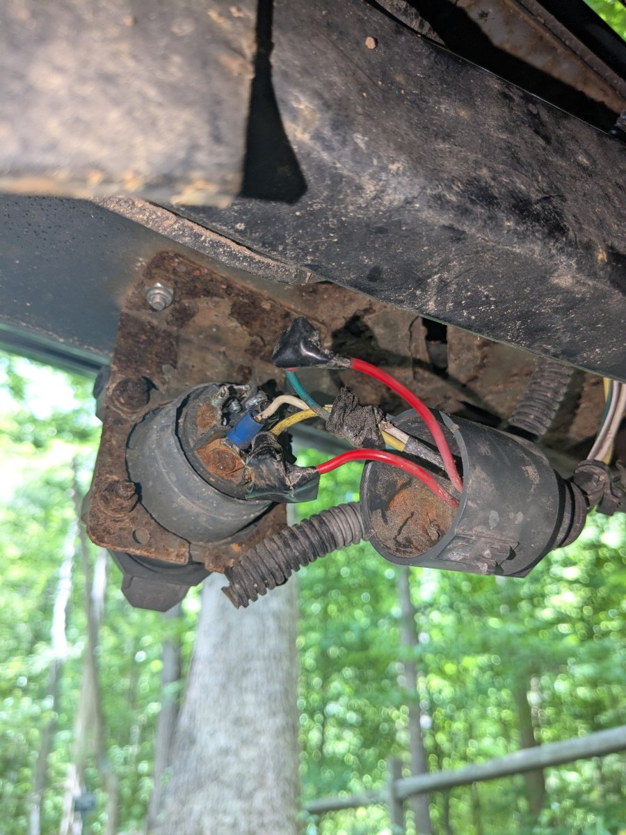

Lastly, There is what I believe to be a factory tow package that has a messed up 6 or 7 pin connector. It looks like the previous owner ran a wire from the trailer wire harness for a bed cap brake light. It isn't plugged in, but there is a tangle of connected and unconnected wires that would connect to the pin blades.
That needs to be fixed, before you do anything else.
And once that is fixed, you probably won't have to do anything else.
Perfect. I can probably do that. I've seen the terminal to wire color diagrams here, should I follow those and temporarily hook up the terminals? Or would it be better to cap the wire ends?
I never tow anything so seeing this thing has really rubbed me the wrong way.

If it were me . . .
I'd cap all of the wire ends, eliminating any compromised plastic insulation in the process.
Get the basic lighting problem resolved first.
That trailer connector looks to be well past its "best by" date. Once your lighting problem is corrected, if a trailer connector is wanted, I'd replace that one with a high quality new one.
Good luck!
Sounds like a ground problem causing the turn signal filaments to find a ground path through the brake light filaments. As mentioned above, clean up and/or remove that messy trailer plug harness. Re-analyze performance. Then troubleshoot as necessary.
