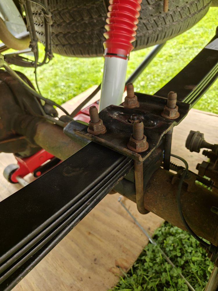

yeah....only people who live outside of the rust belt think ubolts are re-useable.
although they can be reusable- the wormy ass units on a oem ranger can be stretched easily. if you know how a stretched threaded shaft that is transistioned to flat form fails, then you will be weary to reuse the 1/2 in ones. especially if you have to go over 150 pounds to re-seat everything....
. i step up to 9/16 or 5/8 to make sure and dope the hell out of them with antisieze and run way under on the torque capacity ensuring i can reuse them....as i never know when swapping out an axle is going to happen or when i will be popping in my heavy spring packs to run heavy.. a 5/8 can hold enough tourque to ruin the axle and mounting plates ect so dont just torque it down with a 5 foot cheater... it sux to open up the holes in the spring plates but worth it.
since the truck is lifted and you are not certain those are oem springs....i would consider running the heavier spring offering for the ranger....it is definitely ideal. the ride is not harsh unladen in any case....but not having enough spring is a sure way to bust them.
my light springs are the hd f150 2wd springs....which are 2650 iirc....there is a 33...but different arch. i run the 9 in arch.....and i go up from there if i need to load the truck.
i usually just get them at michigan truck spring. almost always the best price and unfortunately made from chinesium,,,,they are cheap and effective enough i dont care...when one pops i just toss em and get new ones.
though i am sure prices now are getting out of hand.
9/16 u bolts 3 1/2 spread are usually 12-15 bux each. look at your bolts carefully...measure for stretch....if they are good...they are good. use them. otherwise it is not too bad to replace them.
