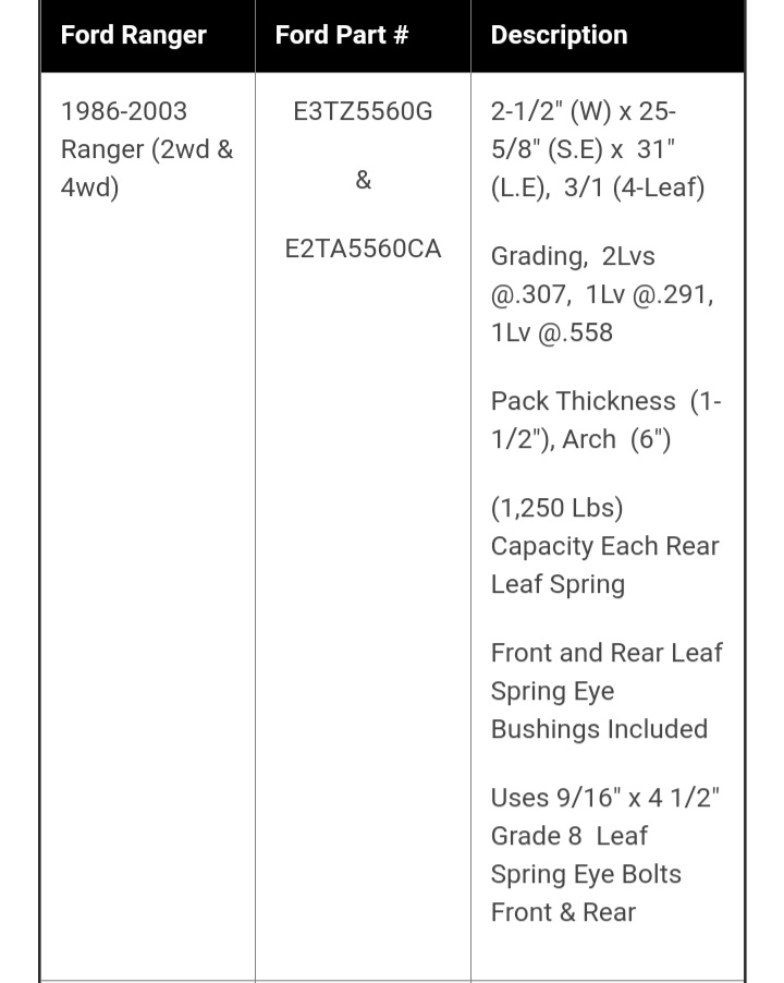

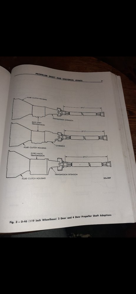

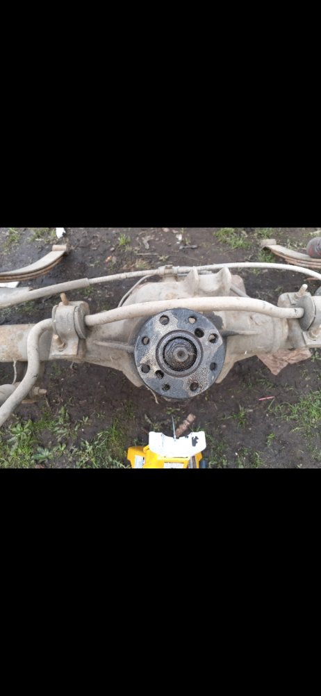

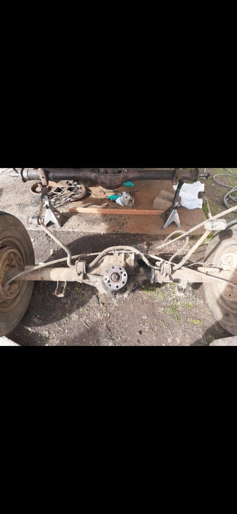

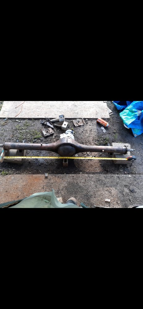

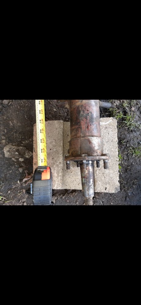

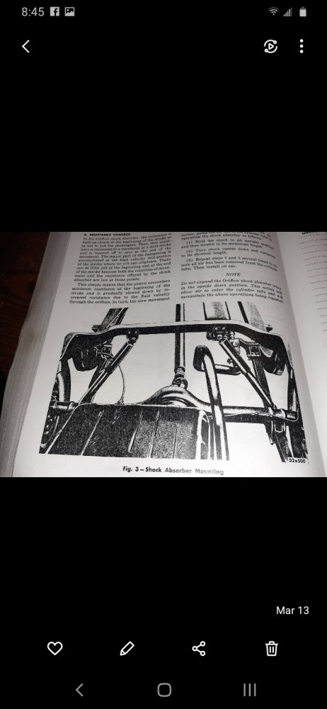

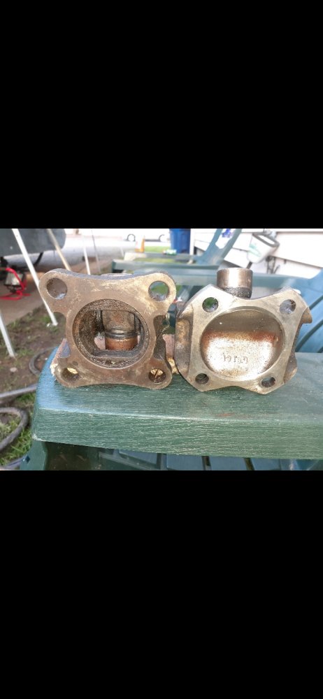

Good Morning would like to ask for help from you Ford experts in here ok here is my situation I am currently doing a rear end swap on my 1953 dodge meadow Brook car I was told a ranger rear end would work so I purchased a used 1988 for ranger rear end and am currently trying to see what needs to be done so far I understand I will need to change flange to differential as well as need to cut and re weld the perches for my u bolts and brackets for my shocks and add some spacers to get my wheels to fit where they were but here is where I need the experience of you in here would it be possible to also use the leave springs from the ranger and just add new brackets as well to my '53 frame that way I can use hopefully rear end and leave springs any help would be greatly appreciated thank you all also I am adding the pictures of what i have tooken so far as well as pictures from my '53 manual specs
