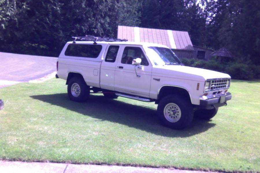

Hey guys, I just bought an 88 Ranger. It has a Rancho lift, maybe 3 or 4 inches. Anyways, the back end rides about 1.5 inches lower than the front. It is pretty noticeable. So, I was hoping some of you who have experience with lift kits and such would be able to help me out with a solution to leveling it with the front end. It already has 2 or 3 inch blocks on the axle under the leaf springs with extended U bolts. Are there block kits that i could just put on top of these, and then just get longer U Bolts? Would adding a couple leaf springs be a better option? Someone told me to put air shocks on the back but i don't know how that would work seeing as it is already lifted in the back or how spend that would be. Just looking for a simple quality fix. Im posting a couple pictures so you can see what is going on, camera is my computer so they are pretty bad. Anyways any suggestions would be appreciated!

Belltech 6400 shackles or the equivolent.
Gave me 1.5-2 of lift. Better ride and flex.
