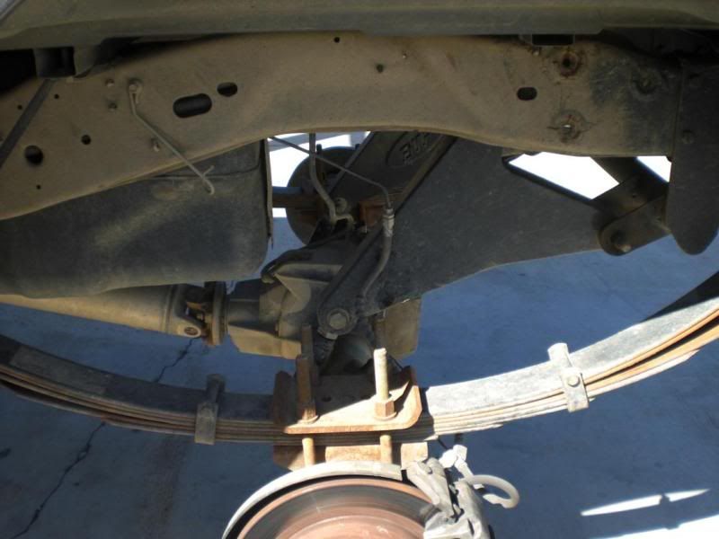

In the pictures below you can see the kit installed on my truck at full droop. The brake line looks rigged on there because I did an 8.8 swap at the same time and due to complications with tools breaking and the RuffStuff 8.8 swap kit having holes too small for the center pin of my Deavers (with no drill bit big enough to resize), it being 11PM and needing to pack for a week long trip to Yosemite the next day, I rushed. It's been fixed, looks better, and works perfectly. I have more pictures, but photobucket is down at the moment and I'm only allowed to upload 5 pictures per post.

Droop (I can get more, but this is with the shackle and hangers in the stock location)
