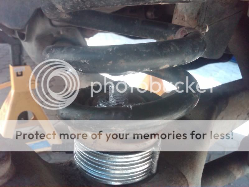

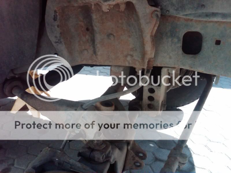

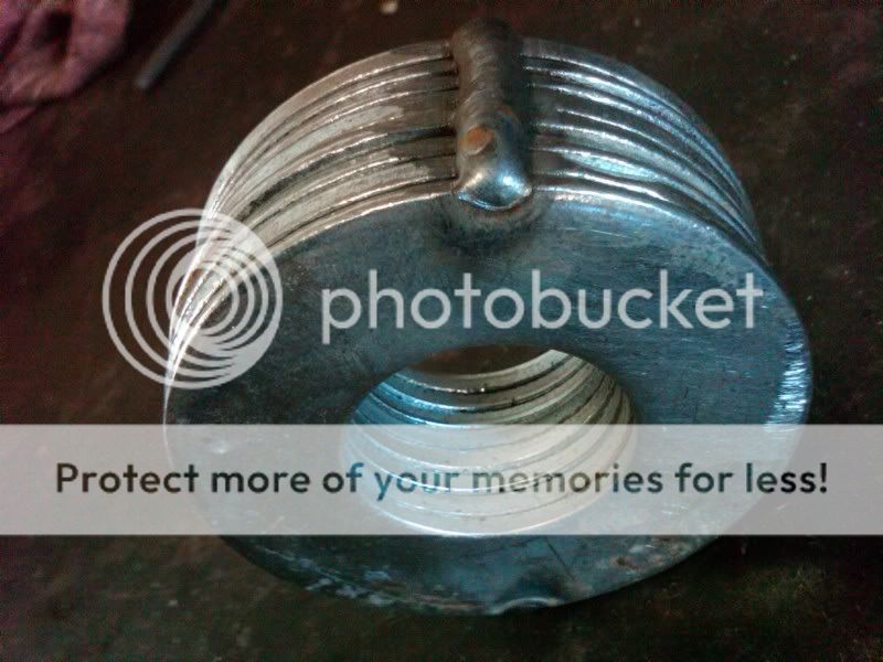

Front end still sat about an inch lower than the rear, so I addressed that. Tore it all out. Took all of 5 minutes, got this down to a science now haha.
Rangebe...version 2.0

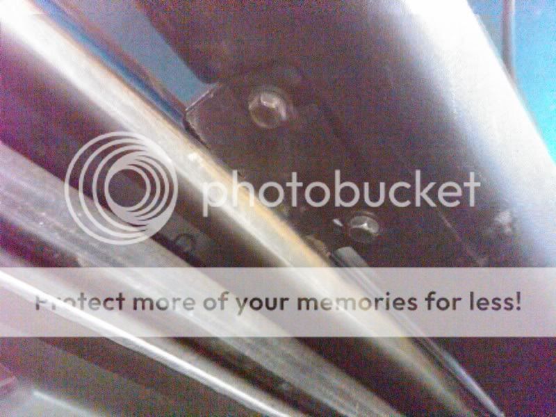

Took out the washers I had in there, added some more and welded them up for added reassurance. Not necessary, as they are captured about the spring bolt, but I figured why not.

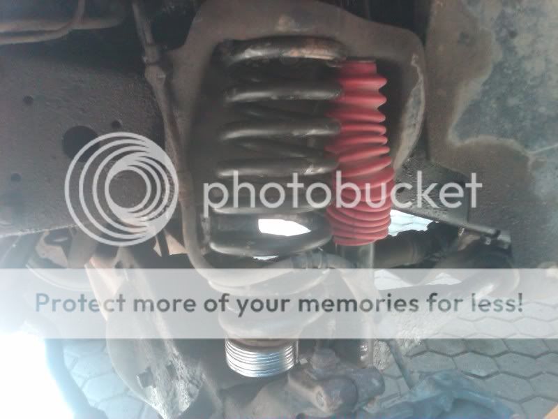

Spring in place, have TONS of thread for nut engagement.
And all buttoned up. Also added some shock boots I had kickin around on there.

And.....removed the rear sway bar. Truck is totally sway-bar-less :D Ive got to try and squeeze every ounce of flex I can out of this pile.

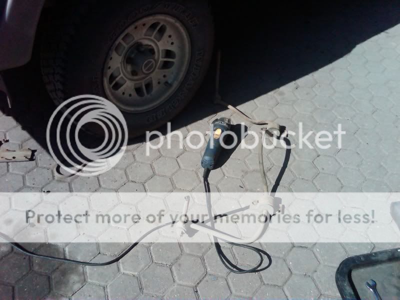

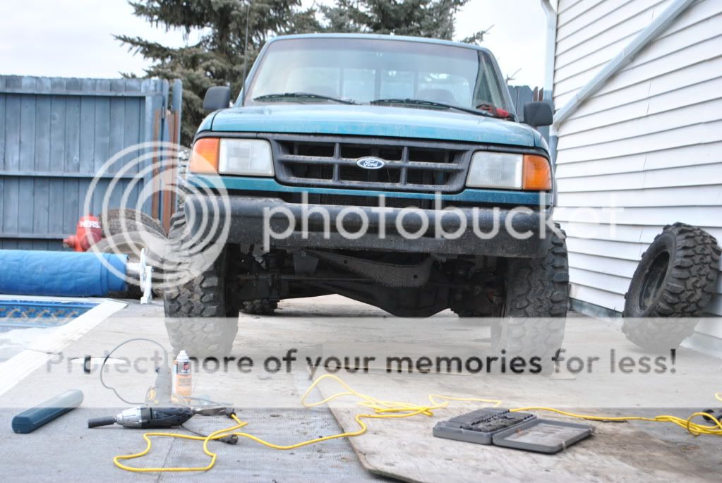

Forgot to snap a pic of the truck after, but it sits level now. Also trimmed the front bumper at the wheel opening to make sure the new dubs dont rub.

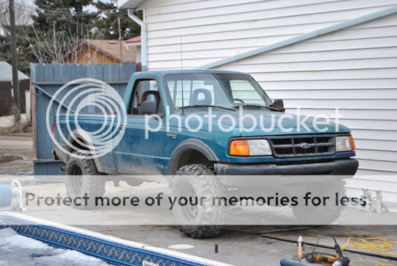

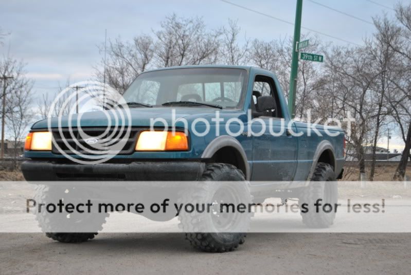

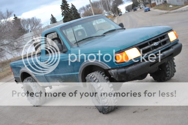

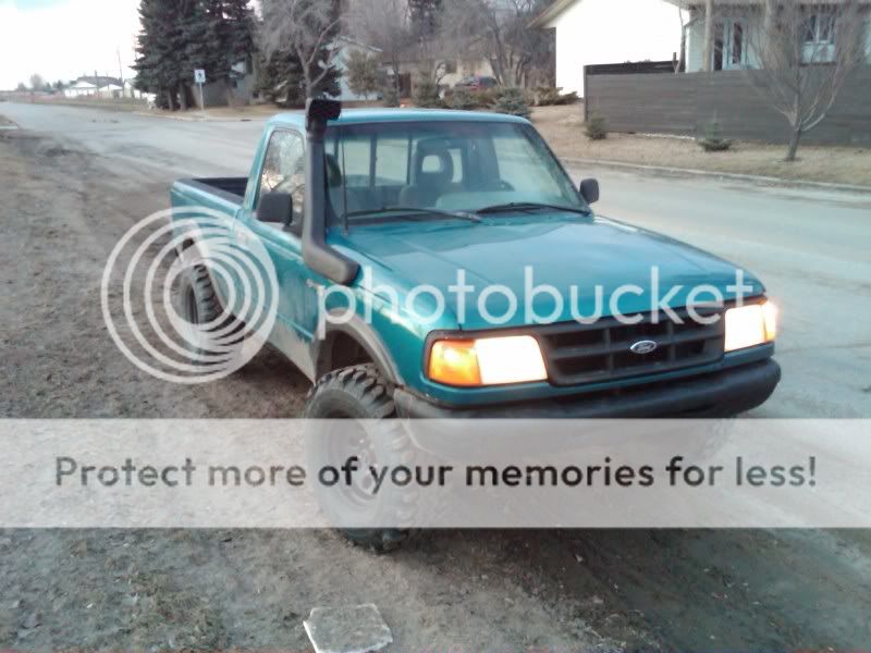

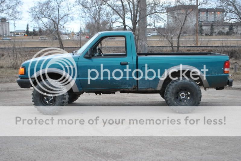

Couldnt be happier with the stance. It sits wide and low, should do well offroad.
Thinking if I have time this weekend, spare tire carrier and snorkel might go on.
looks great Nathan, whats the tire size?
I know! I know! :D

They are 31x11.5x15 TSL bias, with 90% tread, with cragar 15x9 wheels. I have 5 of each, and the 5th swamper has never even been mounted.
Will do the manual lockout swap, and a small lift before I put them on.

Trucks looking good Nathan. I like the way it looks with the lift and the Swampers on it.
Thanks Clay :D

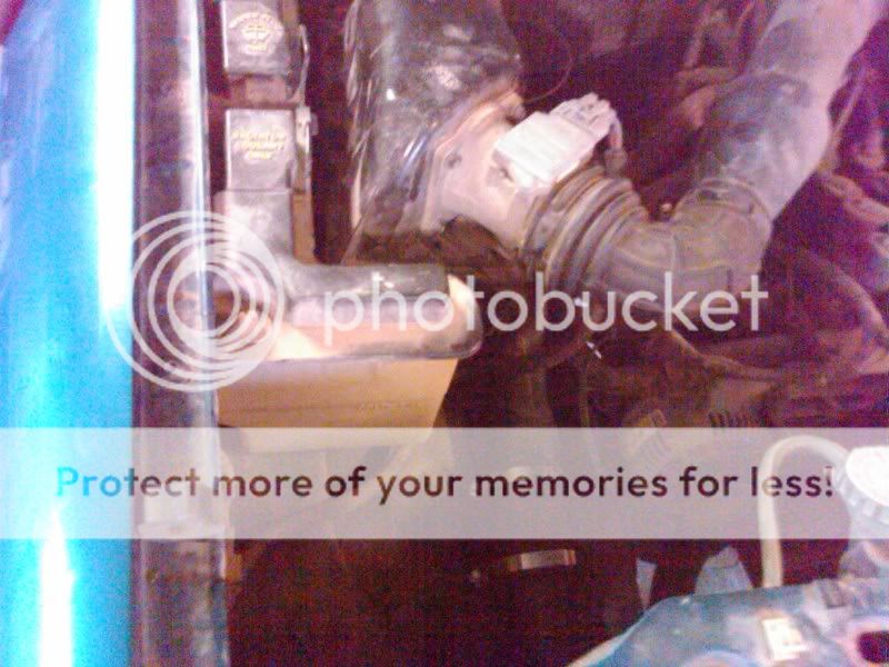

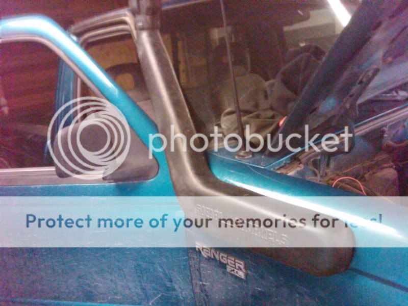

Got the snorkel on. As it turns out, the 1993-94 2.3 and 4.0 litre ranger motors have the same airbox. This made it very simple to hook my snorkel up to, as it was an identical process to last time...talk about deja vu.

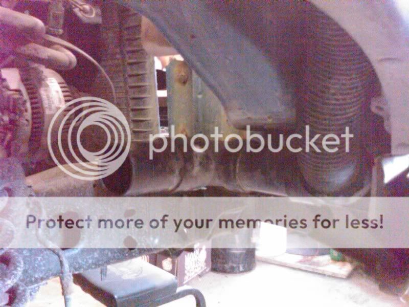

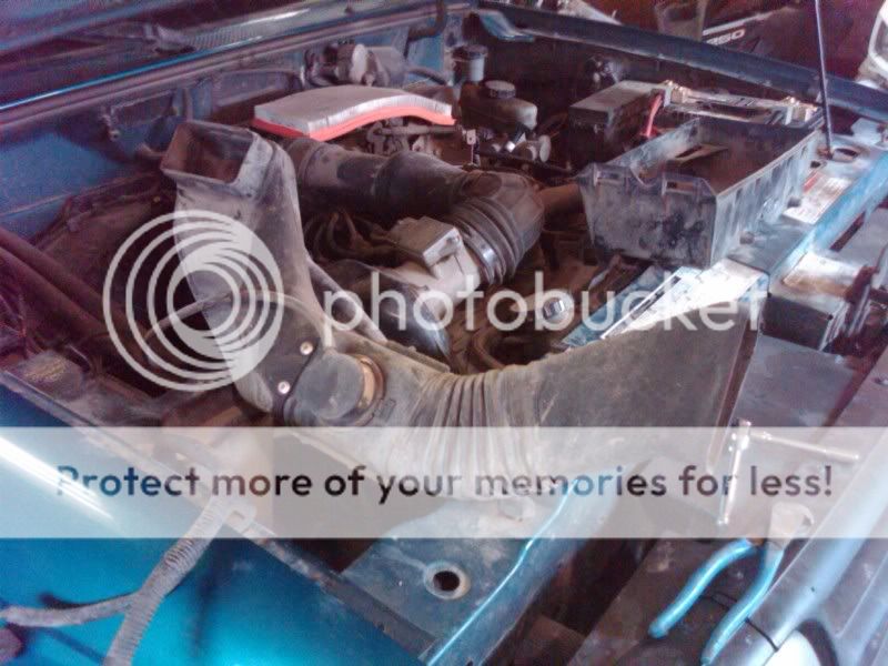

took the airbox out, and the airbox intake off, as well as removed the inner fender.

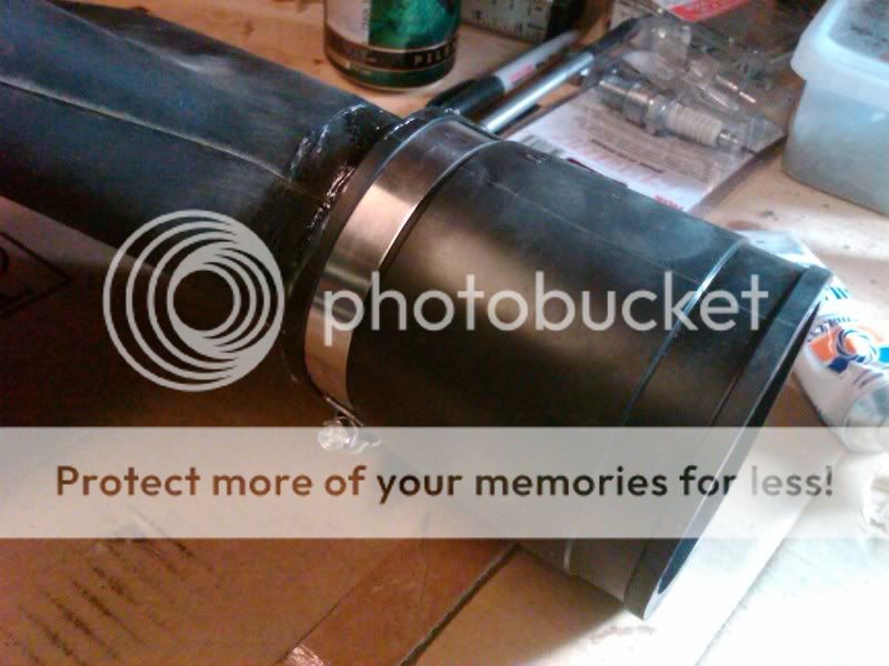

epoxied the aribox intake hose so it was sealed up well

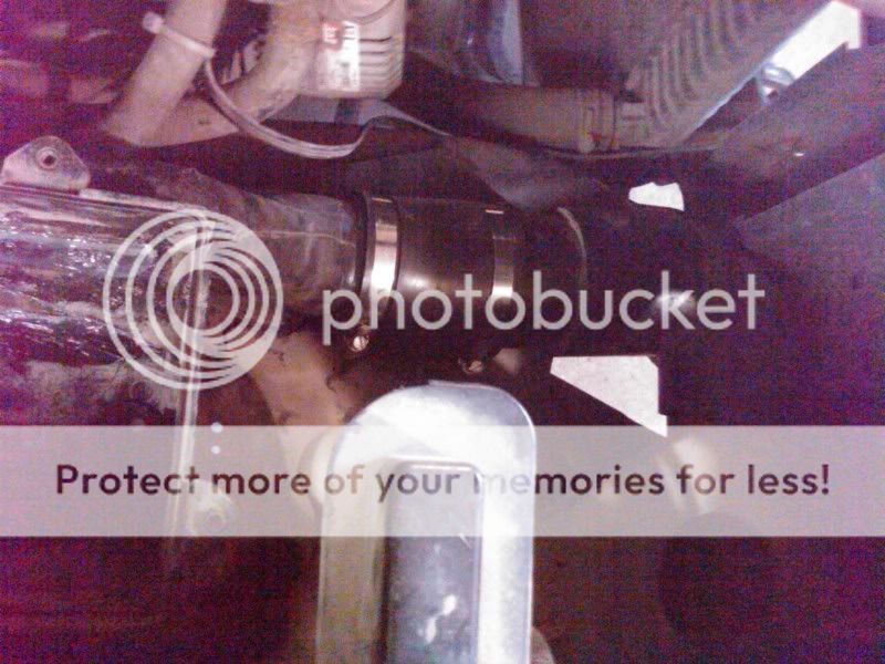

and put the coupler in place, which will connect the airbox to the snorkel tubing.
put the hose/3" abs pipe in place, its the same piece as my old Ranger, so have a look in that thread if youre wondering what I used.
drilled holes in fender, again same as last Ranger, and put snorkel in place.
used the same bracket I had made before, and screwed it into the pillar
put the inner fender back and hooked up the air box.

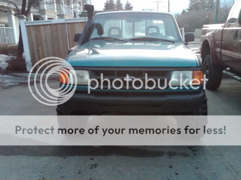

and all together
and done. Some may say it is a bit ridiculous to put the snorkel on such a mild build, but the stock airbox intake opens up right under the passenger headlight, and is known to take on water easily. I had all the parts, so figured why not.
