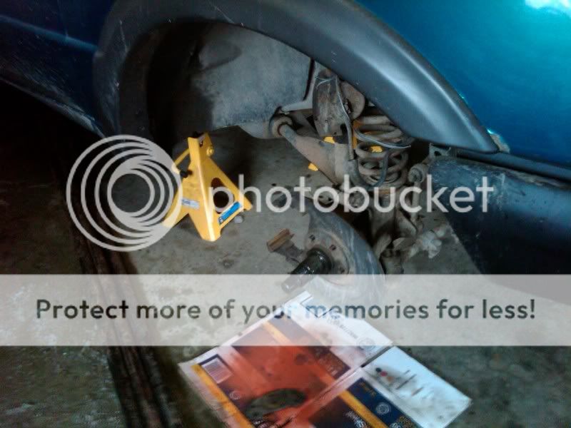

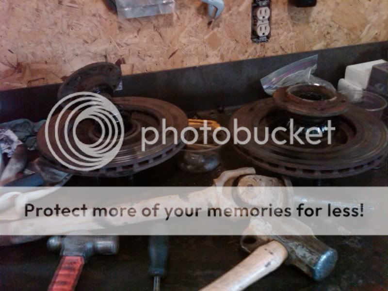

got the wheels off, calipers pulled, and auto hubs off. I used a spare dental tool I had laying around to get the wedge out, and then spun the nuts off, and pulled the rotor. So I was left with this spindle.

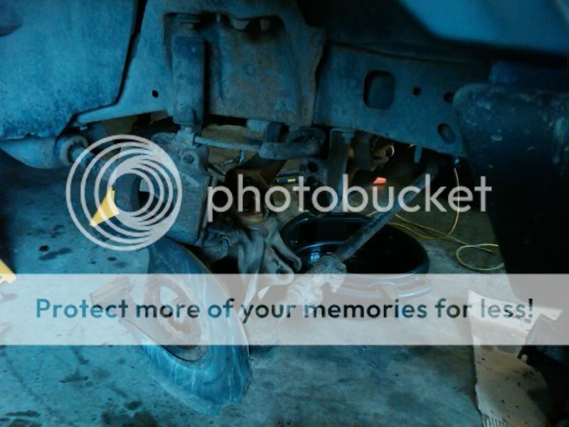

Spindle tool in action. Worked AWESOME!!!! two pulls with the slide hammer and it came off. Ive fought for hours before getting these off, and it literally took all but 2 seconds and it was off. AWESOME.

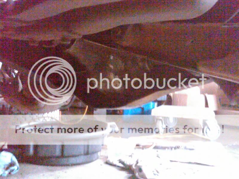

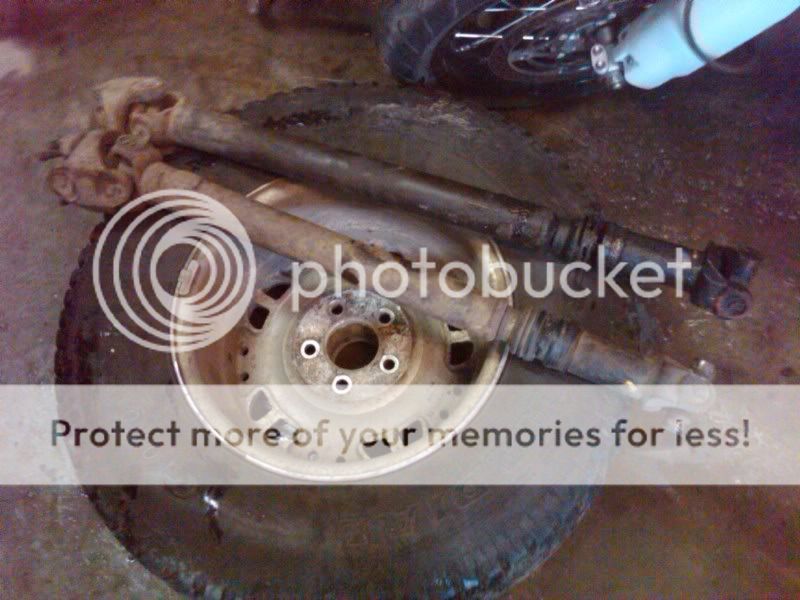

Pulled the tcase skid, and then the driveshaft. The cv joint in this one is pooched, so Ill use the one I had leftover from V1.0

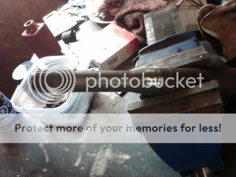

pulled the axleshafts out. Yep, u joints were crapped.

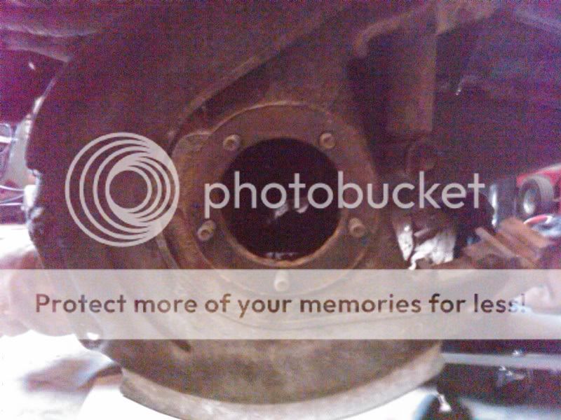

here is a pic of the neck down, its so small haha :icon_rofl:. Shouldnt matter, its got big outers which are the important part.

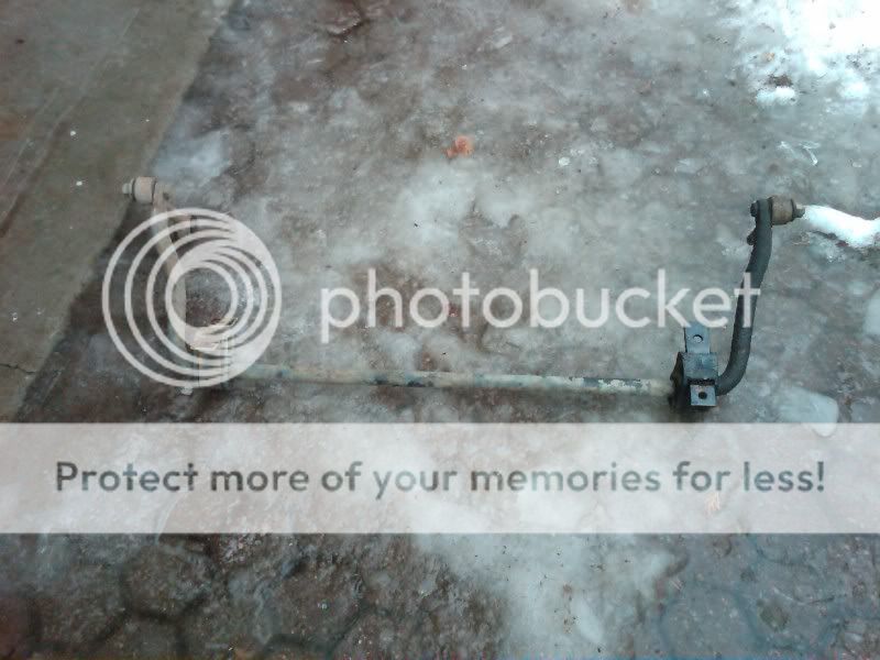

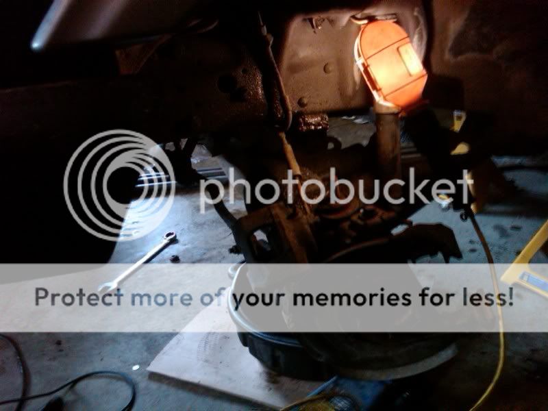

time to remove sway bar. bolts wouldnt cooperate, so I busted out the blue tipped wrench :D
goodbye anti-flex bar.

and front end is completely disassembled.
Up to this point took about an hour or so.

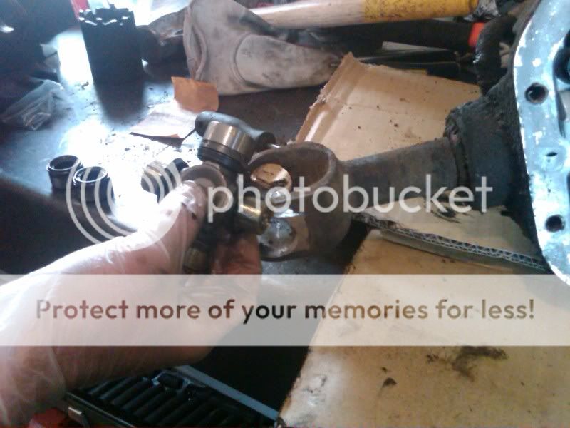

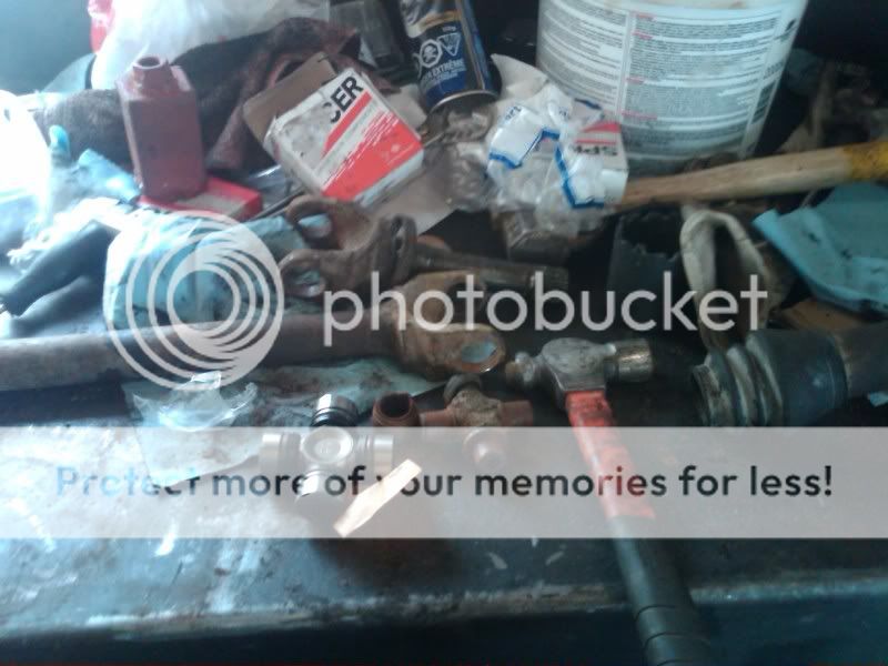

new 5-760x's going in.
I did the middle joint, and left the shaft in the diff....so the splines of the side gears wouldnt fill up with spatter when I welded the diff :D
all of the old joints were pooched. Some had no bearings left in them, just dust.

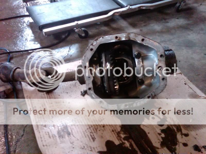

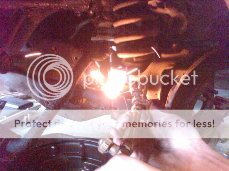

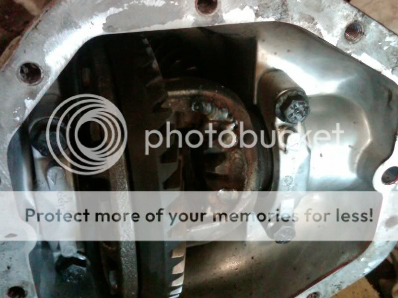

cleaned up the diff, and did this :D :icon_welder:
hellloooo lincoln locker!
also made the u joint caps a permanent part of the axle shaft. Should NOT shear ears off haha.
and put diff back in!
