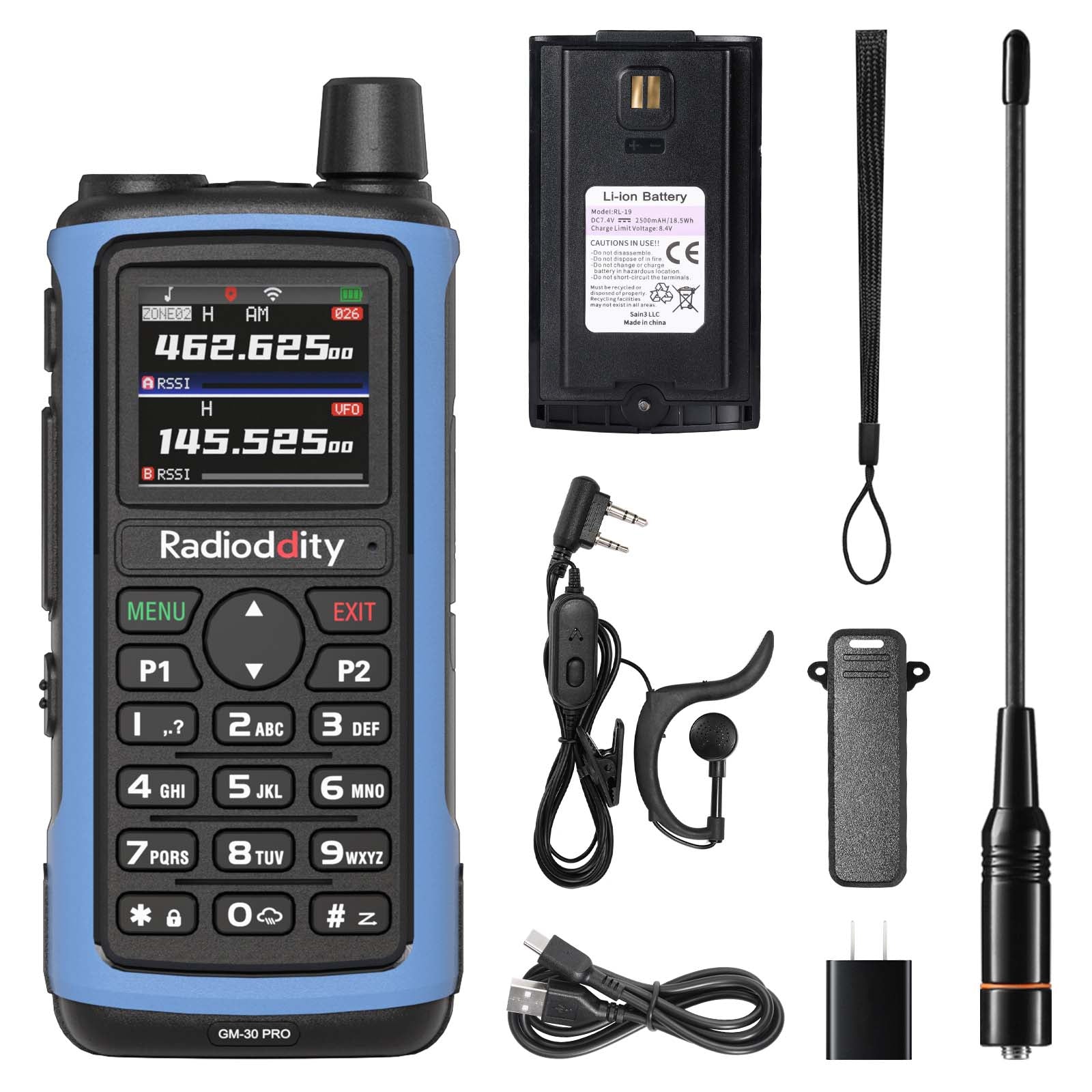

FYI I think I've landed on the Radioddity GM-30 Pro. Most of the features I wanted (really not a lot) at a price I like, and good reviews. The Pro drops the GPS from the Plus, but gains bluetooth. The GPS allegedly only works with another of the same brand and/or model of radio. Even if it worked with more radios, GPS coordinates are about useless without a GPS to plug them into which will also provide the coordinates. Also seems likely to be an extra drain on the battery. The bluetooth is included to allow programming wirelessly via a cellphone app. Allegedly the app is "hot garbage", but does work. I do intend to get the programming cable to use laptop, but having wireless programming could be handy when the laptop and/or programming cable isn't.
Handheld GMRS?
There are some features I've seen that would be nice to have, namely better bluetooth implementation (IE: able to use bluetooth headset and mics) and USB-C programming. The one or two radios that claim to feature those things and more at this price point allegedly sacrifice performance and reliability, in addition the FCC certification is questionable and the implementation of those features is apparently finiky. Stepping up to a radio that has all of the features and good reviews moves to a price point I don't want to approach at this time.
Now to decide if I want to get one or a pair. One is all I need/want for the trip. If I had two I'd have a spare to hand off to my BIL when we're working at the hunting land, or could hand off to family when we're out at an event or park somewhere. Having two of the same would be easier for me to familiarize them with usage. They'd already be covered under the GMRS license I'll have to get anyway.
The pair kit also appears to include longer 15" antennas (in addition to stock) and speaker mics. I will probably hold off on buying better antennas for now and use the included one for this trip, it should be good enough for the ranges and terrain encountered. Since vehicle body seems to be biggest source of signal interference, I may try to get a suction mounted antenna to stick outside the window while in the vehicle. The suction mount is something that could also be used later when/if I acquire a mobile radio since it'll probably be setup to be portable between the vehicles. If nothing else the mic could be handy while driving, especially if especially if the radio is wired to an exterior antenna.
