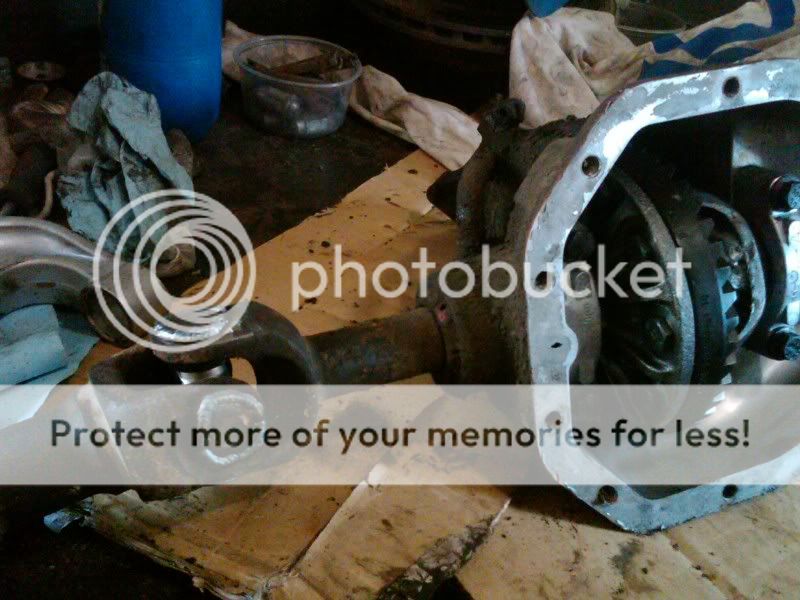

Haha. So the plan is to beat on this thing...hard. I fully welded the ujoint caps as to make them a "part" of te ear. Should avoid failure at these points. I don't care about replacing them, if I break a shaft or the carrier ill swap in a true 35.
Hopefully going to lift and weld up the rearend next weekend, and have my wheels/tires by then.

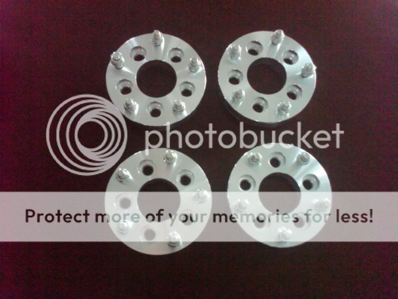

got some goodies in the mail :D

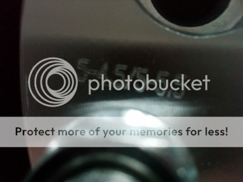

sweet. I have the exact same 5x4.5/5x5.5 spacers on my Ranger now so I could use the 33s and rims off my 79, haha. how wide are yours? mine are 1.25" i think

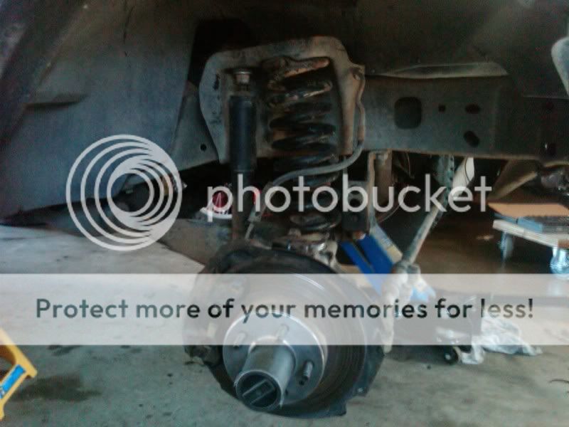

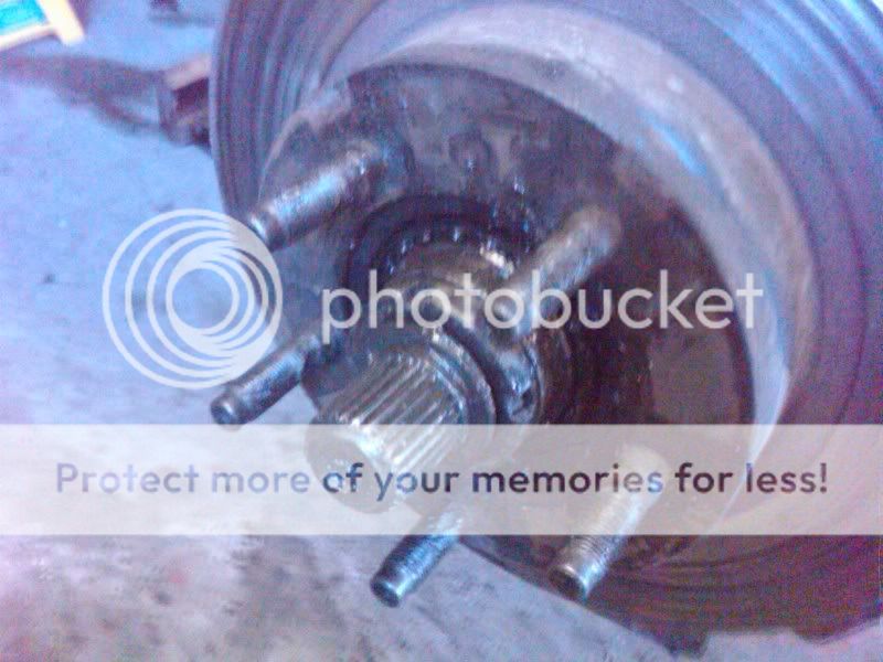

Got the axleshafts in, spindles on, and rotors in place. Then put the manual lockout spindle nuts on.

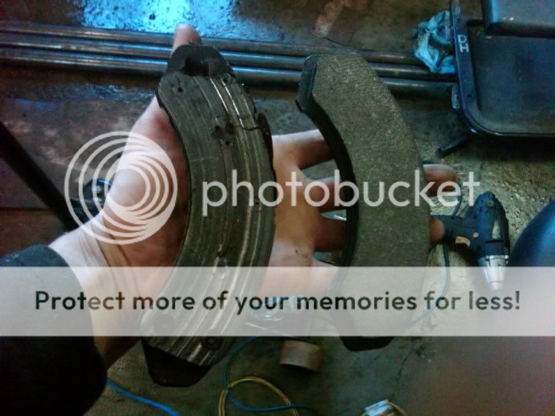

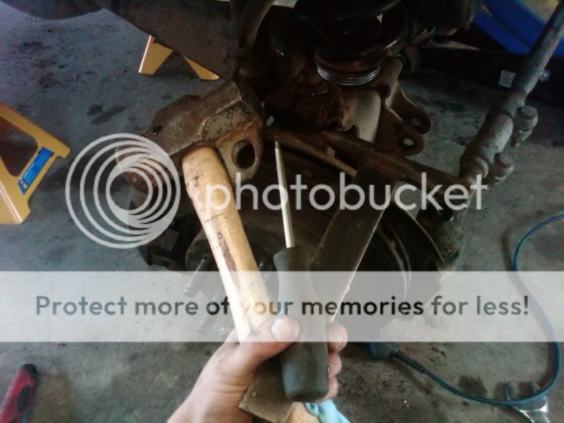

put a new set of brake pads on her....think they were a little overdue ? :D old is on left, new on right.

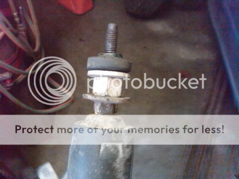

shocks were maxed out, so in order to regain a bit of down travel, used a "custom spacer" to lengthen the mounting point of the shocks. this is indeed a budget build.

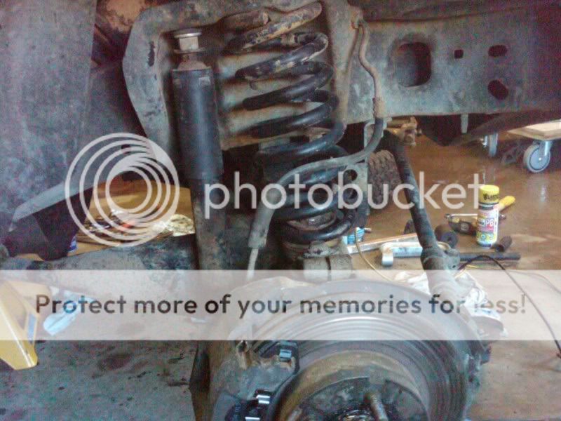

springs and spacers in place, and caliper bolted back up. Yes the rotors arent in great shape. I dont care.

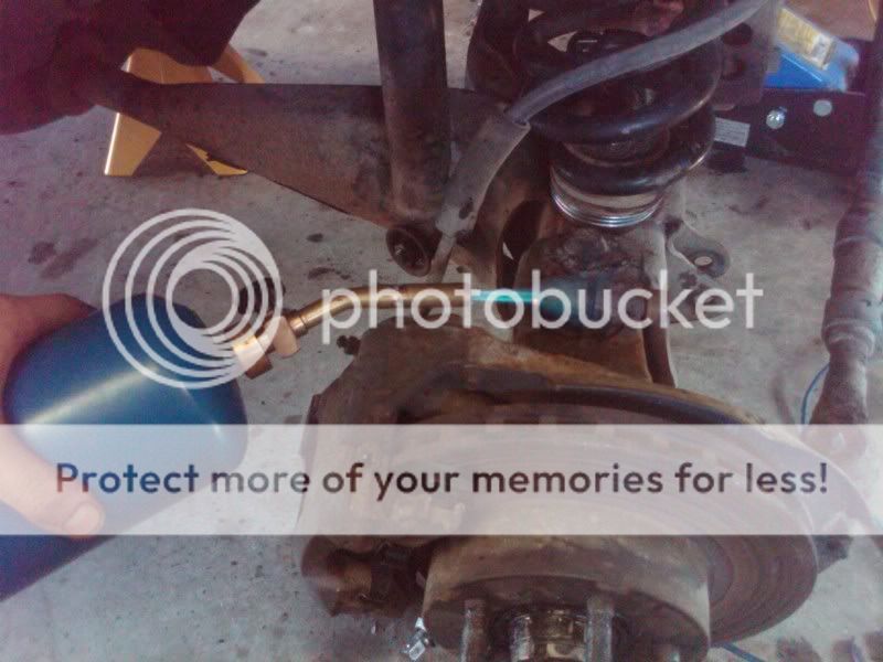

at this point I needed to adjust the camber. It was not cooperating so out came the propane.

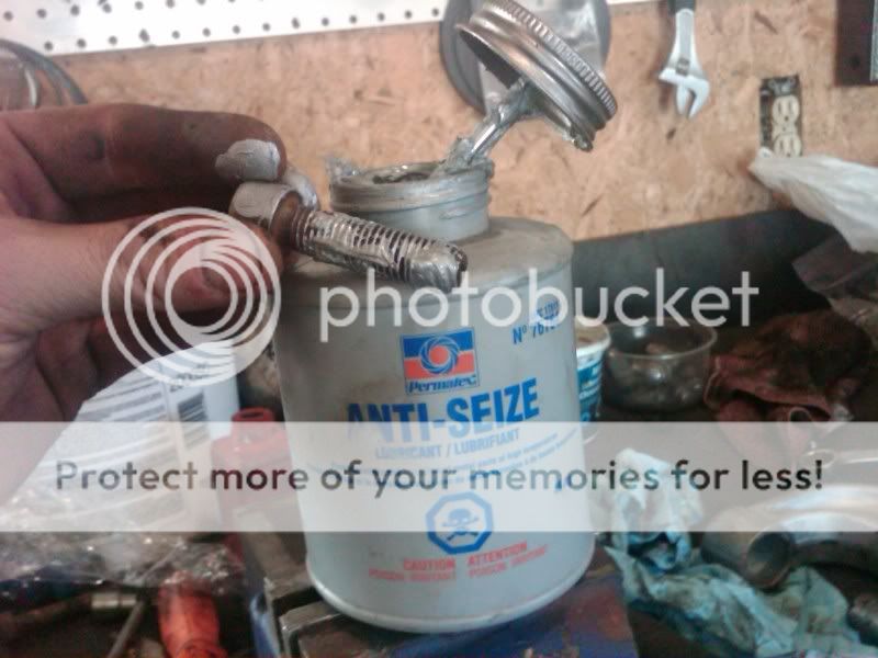

once aligned, pinch bolts went back in place. Made sure they wont seize up again :D

On another note, that anti-seize will stay on your hands for days
