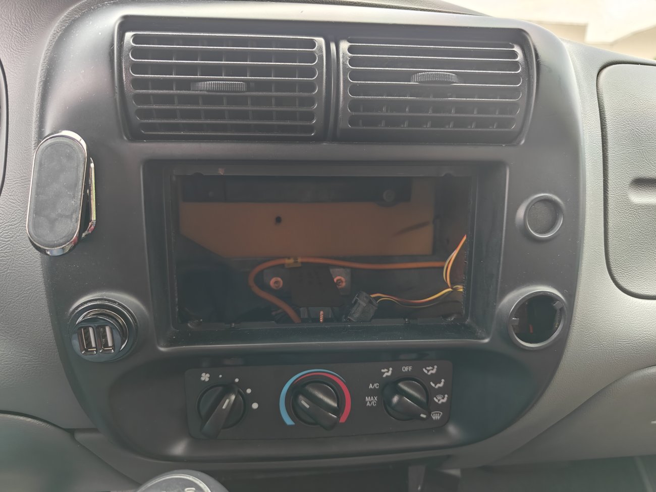

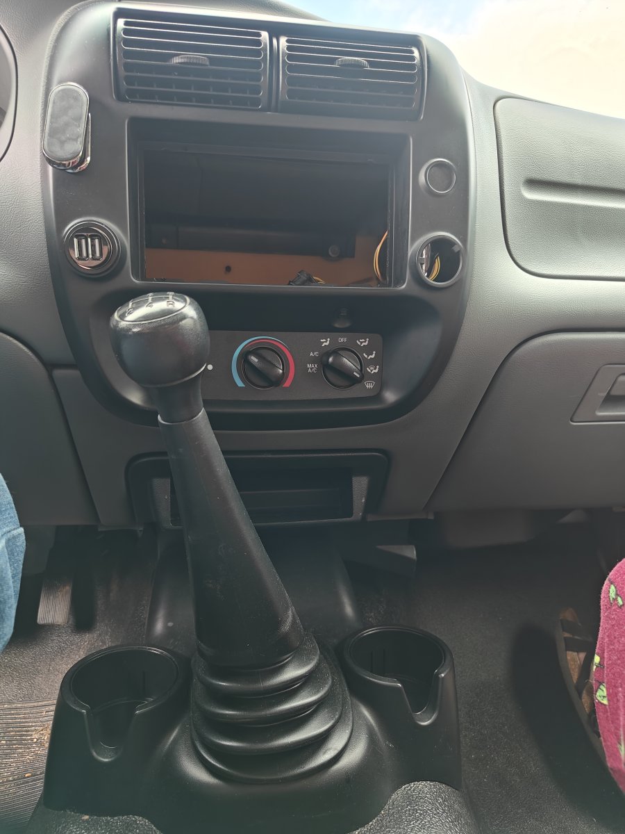

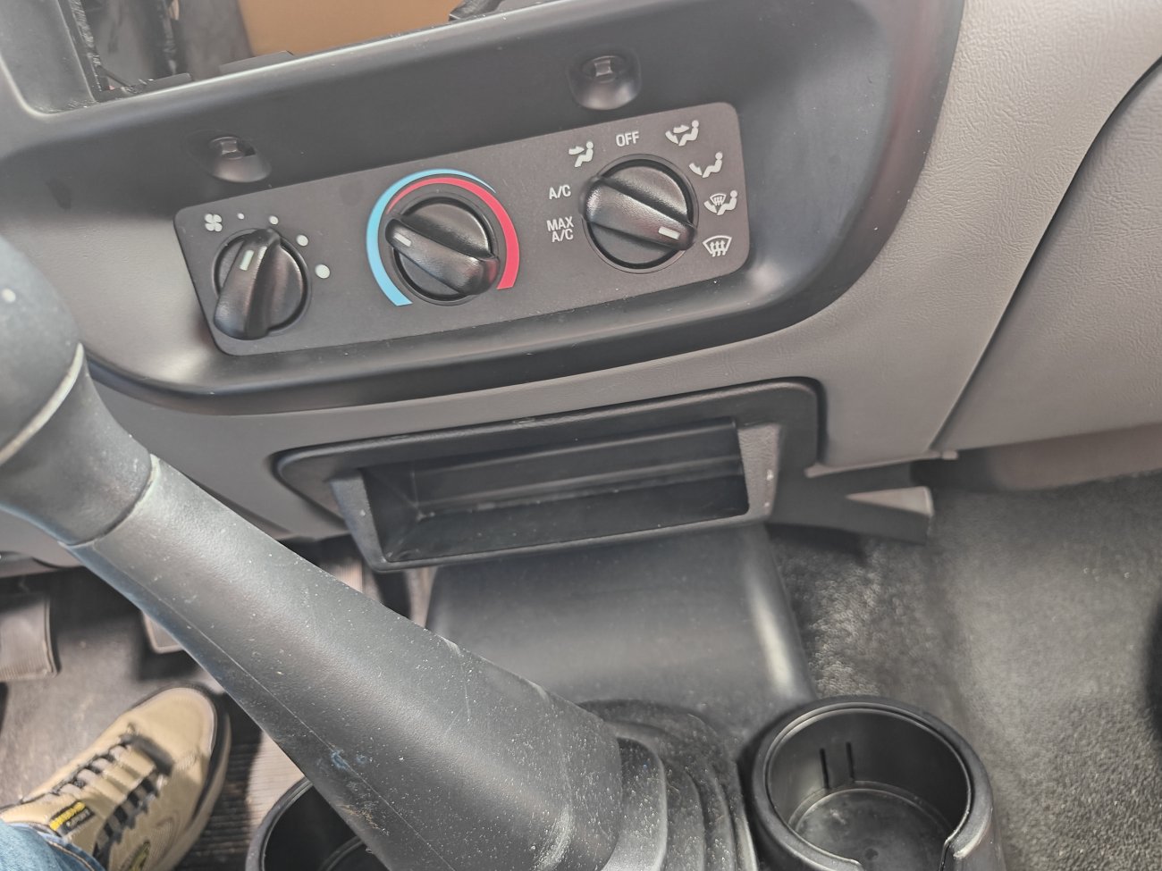

I've been putting a lot of thought into my truck lately, specifically about the audio system. Right now it doesn't have one. The previous owner did the right thing and put an aftermarket stereo in using harness adapters and not slicing up the wiring, but the install wasn't very solid and it rattled going down the road so I ripped that piece of crap out - I mean, professionally uninstalled it, and have been riding in silence ever since, which is when the thinking started. I like the silence. No ads. No invasiveness. Just time driving the truck, and at night there's a warm glow from the climate control lighting in the double-DIN-size hole that I've pretty much chosen to leave open until I figure something out.
I had an idea to forgo the head unit entirely and mount a blank panel in the radio spot, then put a magnetic phone holder there. That way, I could mount the phone in landscape mode and use it for maps. Well, that got me thinking, "what if the phone was my head unit?" I only use the phone anyway, and if I want terrestrial radio, there's a few apps for that. However...

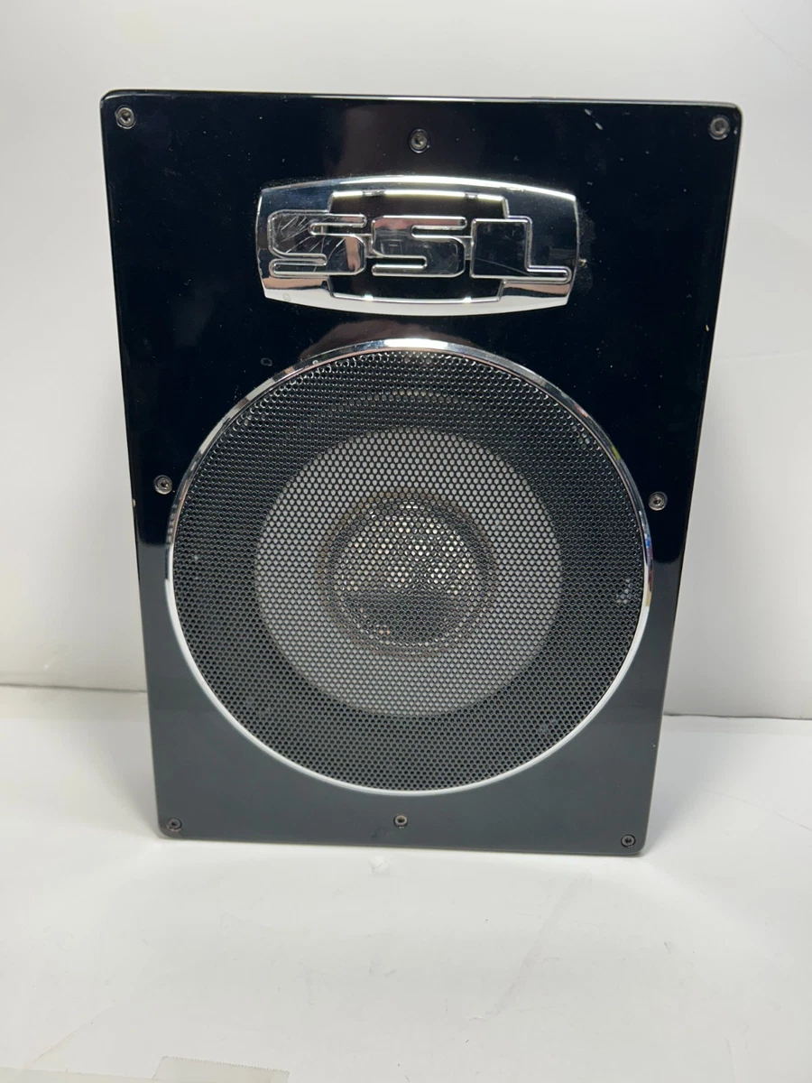

I have a SoundStormLabs SSL8 all-in-one under seat subwoofer that I pulled out of my Festiva, and online I found a set of Jensen 6x8" speakers with a 2-channel, 200w Jensen amp for about $115. I've seen multiple conversations about the rear speakers in the standard cab, which I have interpreted to mean are mostly a waste of time due to their low position and firing angle, so this will be a 2.1 setup.
The sub will not fit under the seat, nor do I want to lose precious wubs, so the AIO will be oriented vertically and centrally on a carpeted MDF panel on the back wall so it will fire between the seats like a sports car system (Fiero, Corvette, Viper, etc.) The SSL logo will be replaced with the Ranger badge from the tailgate. I have other plans for that. I've also got two pairs of silk neodymium tweeters, one pair of which will live in the sail panels in the doors, as long as they don't interfere with the window air vents in the dash. The speaker location in the doors should be high enough to actually stage fairly well with the tweeters. EDIT: Changed my mind. See below.

The under-dash tray is the perfect location for relocating the 12v sockets, though my plan is to 3D print a replacement for the tray that fills in the area. That's not necessarily a part of this project, so I'll start a thread on that later. The reason I mentioned it, though, is because I am about to have three holes in my radio bezel. My version of the panel has two 12v sockets and a passenger airbag warning light. All 3 spots are going to be repurposed as switches, because the 12v socket locations "fit" 22mm switches, as long as you have the plastic insert ring.
The warning light will be relocated to the 3D-printed panel. The left 12v hole will be populated by a green, illuminated switch with a speaker indicator to enable/disable the subwoofer. The truck doesn't have fog lights but it does have a brush guard that will get some lights, so following Ford's weird layout, the right side 12v socket is getting a blue LED switch to indicate bumper lights. I need to measure the hole left after removing the passenger air bag light, but I'm mounting a set of Nilight backup lights to a hitch bracket I bought, and that smaller hole will house that light switch.

Subwoofer, and AI badge replacement mock-up:

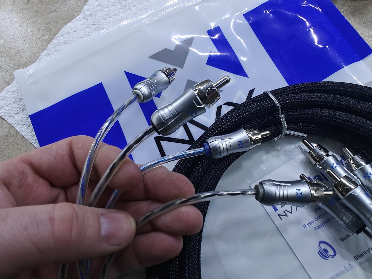

NVX XPLOC4 4-channel converter and Metra 71-5520-1 reverse harness purchased and waiting. The XPLOC4 is likely overkill, considering its 600w max input. I just needed a wire to RCA conversion. Need to test the audio output of the RCA to see if it even picks up the ~1.7w of output from the Fusion radio. Got some wires and ferrules coming soon, too.

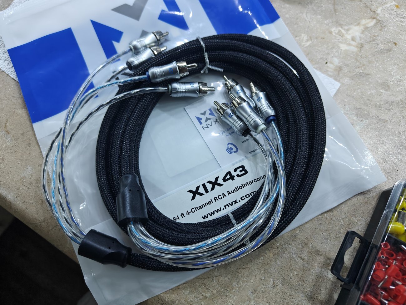

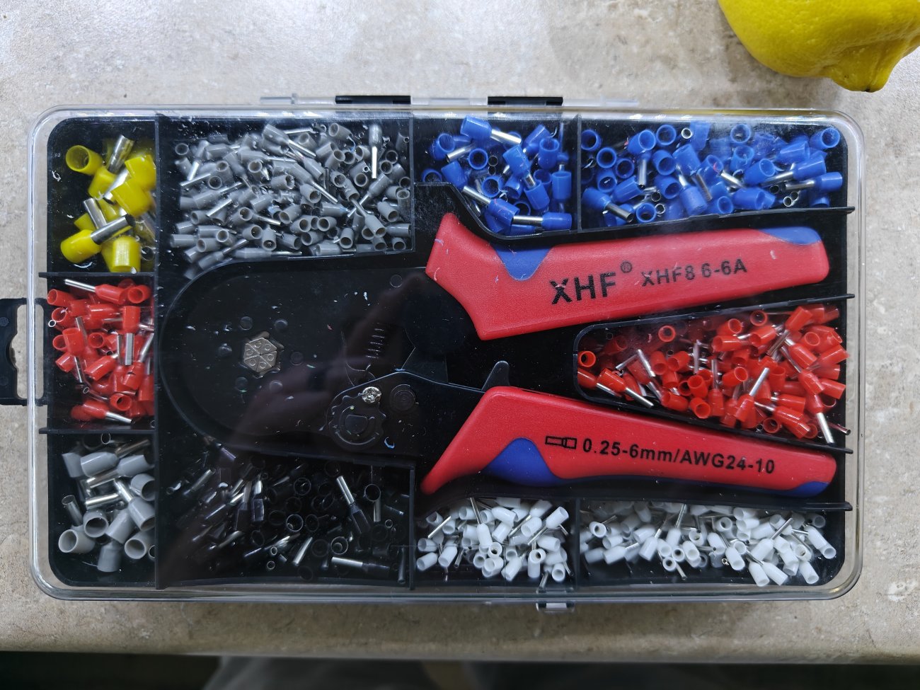

Just got the NVX XIX43 4-channel RCA cable and ferrule kit in. Next up is the NVX XFDBU2 fused distribution block. I'm still waiting on the OFC 14/4 National audiophile speaker wire to run from the speaker amp back up to the front speakers through the harness. Lots of movement right now. Mostly my money moving out while parts move in.

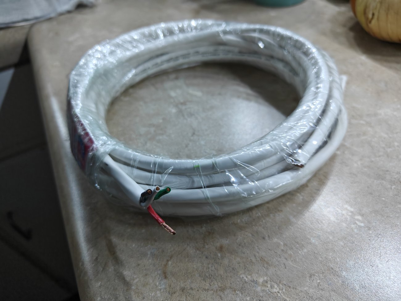

And because I'm pretty much sharing everything, here's a picture of wire.
