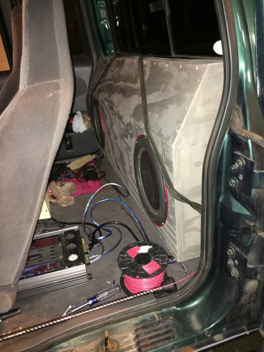

Built one sub box for a single 12” sub for an extended cab truck, sits on the ledge in the back of the cab and still allows one rear seat to be used. Also built a double 12” box that sits on the ledge in the back of an extended cab. Have to see if I can find some pics.
I’m not a fan of MDF at all. It’s heavy, it’s somewhat brittle, and whatever you do, don’t get it wet. The plywood boxes I built are lighter than an equivalent MDF box and stronger.
I was a little concerned about acoustics by going to plywood because everyone builds boxes out of MDF. I know that like subfloor rated plywood can have voids and stuff in the layers, but a quality 7-layer sanded ply will typically be pretty solid. My concern over acoustics was ended when I started running my random orbital sander on the first box and heard the sound produced. IIRC they worked out to about 1.4 cubic foot of airspace per sub.
Bungee cords were just temporary to test things out before finishing and bolting down.

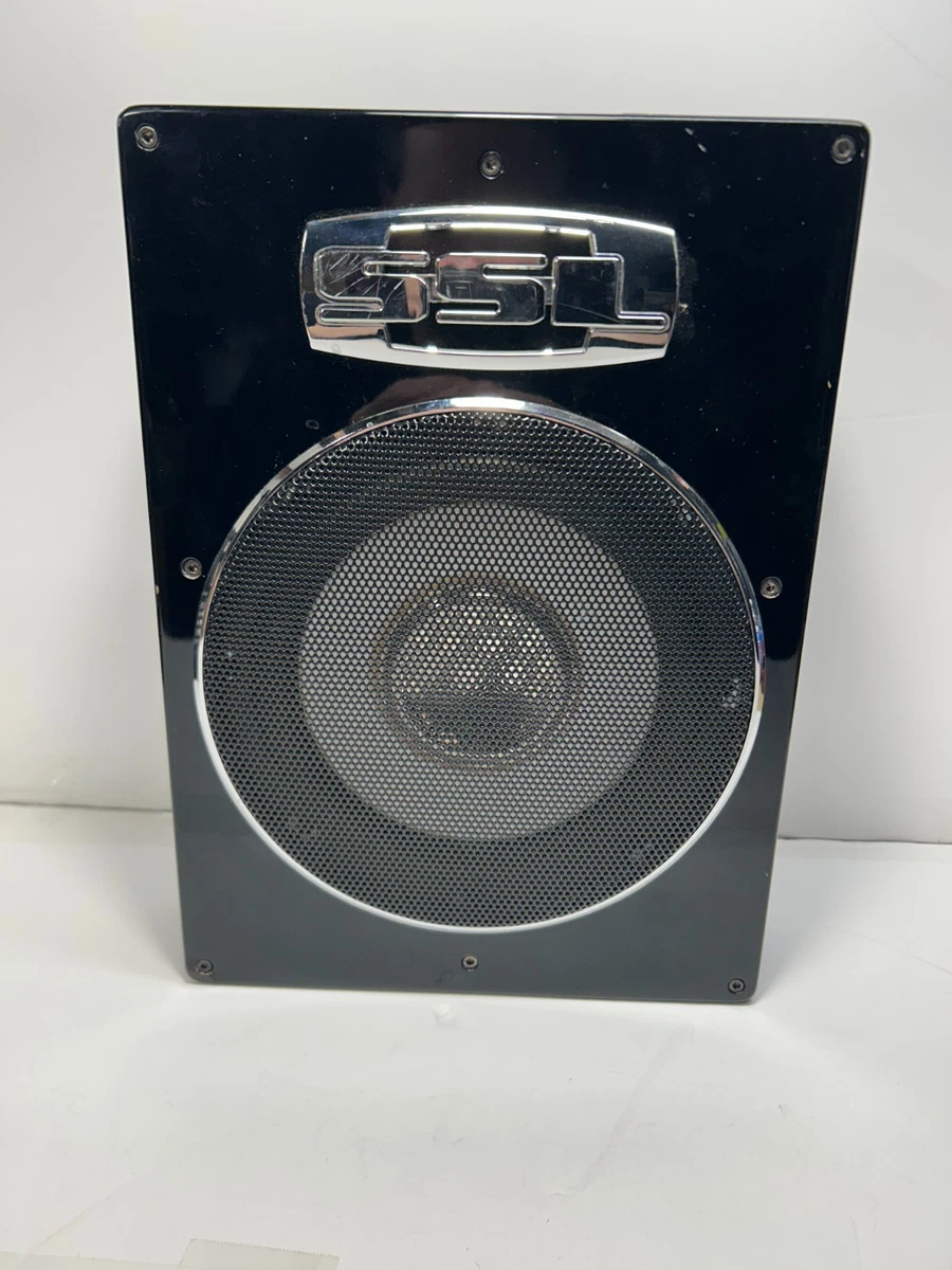

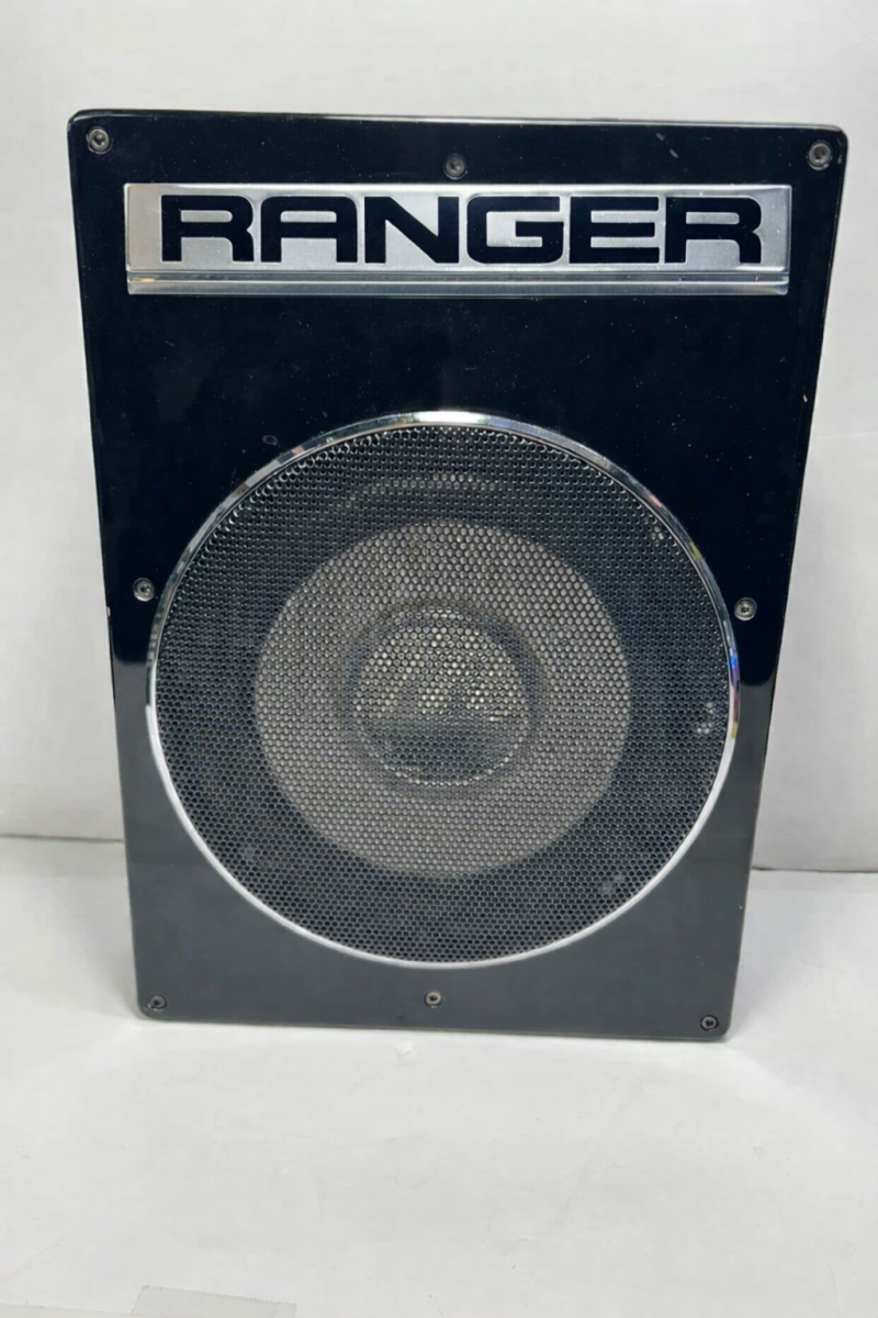

Subwoofer, and AI badge replacement mock-up:View attachment 140330View attachment 140333
Heh. I have the same sub in my Ranger.
Right now it's on the floor behind the passenger seat.
I pulled the jump seats out and am building a platform where they were.
Im going to mount a lock box for my pew pew under the platform behind the driver seat.
I kinda like the idea of the sub vertical on the rear can wall, I'm not sure I left myself enough wire to move it tho. 🤬

So under the trim on the back wall are some mounting points and stuff and with the 3rd door extended cab the rear seats are bolted to that ledge in the back of the cab so you can bolt to the rear wall mounting points and the bottom. I don’t have any pictures though. Rivnuts might be needed on the back wall mounting points, don’t remember at the moment. Put the bolts in from inside the box through the holes for the subs. I never decided how exactly to handle the trim situation around it. Was working with a buddy on it and both of us had health problems so everything ground to a halt.
You will find 3/4” ply in 5-layer and 7-layer typically. I went with a 7-layer B-C sanded because it got the quality I was after without being stupid expensive (try pricing out A-C or finish grade plywood and you’ll see what I mean). I got my plywood from a lumber yard, NOT a big box store.
The double box is a 2-chamber. I did a double layer of 3/4” plywood between the chambers for isolation. Not sure that was necessary but it’s what I did. Thought about poly filling the box but that’s something else that hasn’t been tried yet.

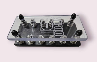

L3 Audio makes some really affordable and nice distro blocks. If you need one side of the block linked, the company should be able to do that
