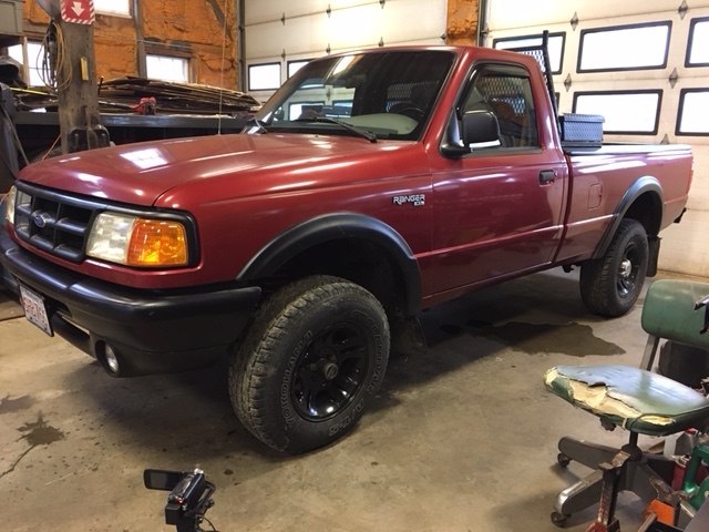

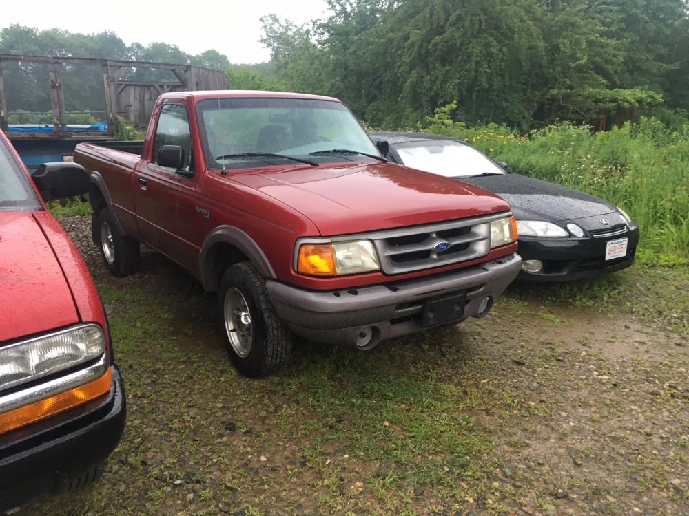

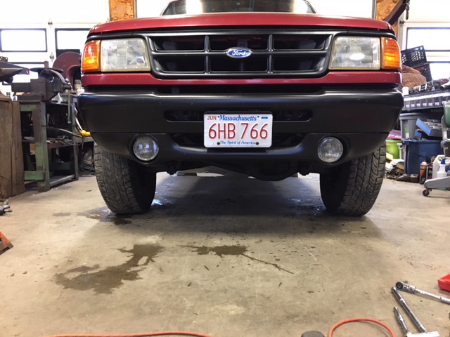

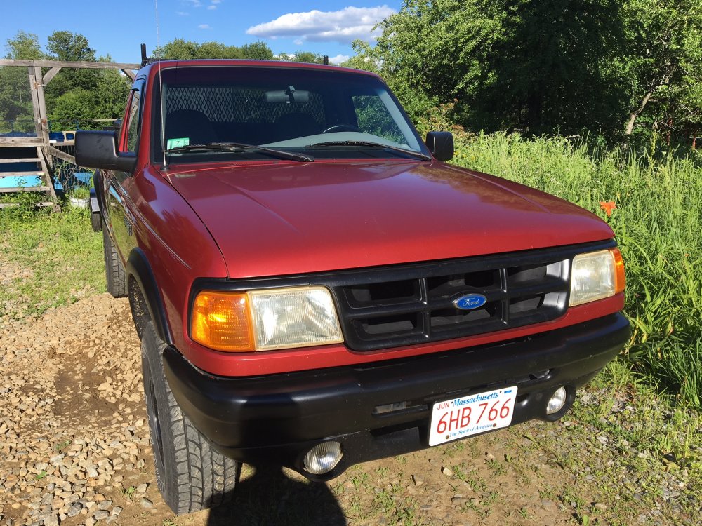

These pictures are from when I just got the truck back in July. I bought this truck for a decent price locally, it only had 108k miles on it and was very clean for a truck from the northeast. When I first got this truck, it really needed some attention. It ran and drove well and everything worked, but I had a coolant leak and an oil leak, and it was going to need a clutch soon. I also ended up finding I had a leaky fuel injector and over time the truck was getting harder and harder to start. It also needed some cosmetic love; it needed new fog lights as they were busted out, and I didn't like the gray/silver color on the bumpers plus the paint was peeling as you can see in this picture. I had a rack and toolbox on it (both of which I got for free) for a while as well.

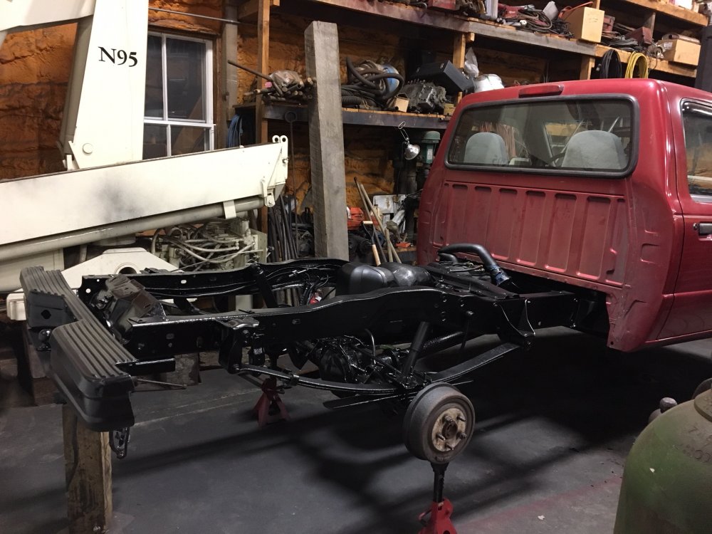

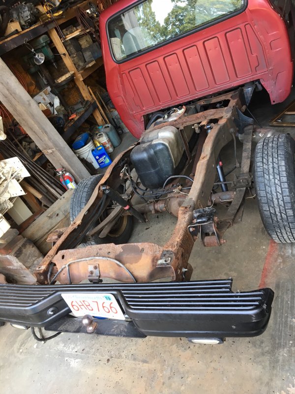

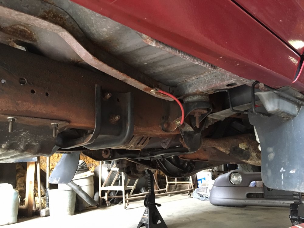

Once I had the truck sorted out with no leaks and starting reliably again, I wanted to undercoat it since rust on these trucks around here is such a problem. I plan on keeping this truck around for as long as possible so this should help a lot. Here are some pictures from before the undercoating:

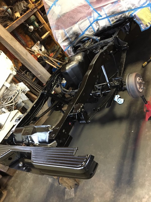

As I said, it was pretty clean for a Ranger for the northeast. The only rot was what you could see in the picture, the rear of the frame towards the bumper. The rest was just surface rust really. After some prepwork, I laid down 2 coats each of Eastwood's Rust Encapsulator and Extreme Chassis Black to just about everywhere I could reach.

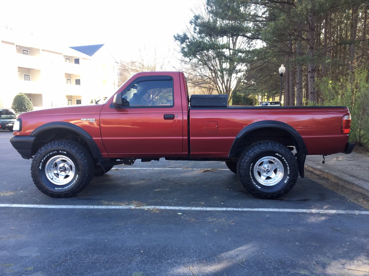

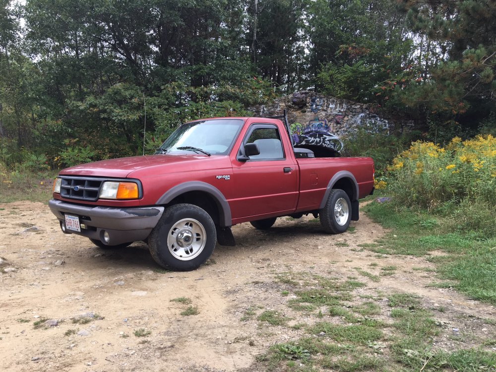

I also sprayed the bumpers, grille and fender flares and wheels black during the process and did an 01-05 tail light conversion. I found a 7' bed liner and a better matching toolbox locally as well, and added a side exit skunk muffler that I also got for free from a parts truck with a snapped frame that my brother bought lol. It actually sounds pretty good for a 3.0. This is how it sits/looks currently.

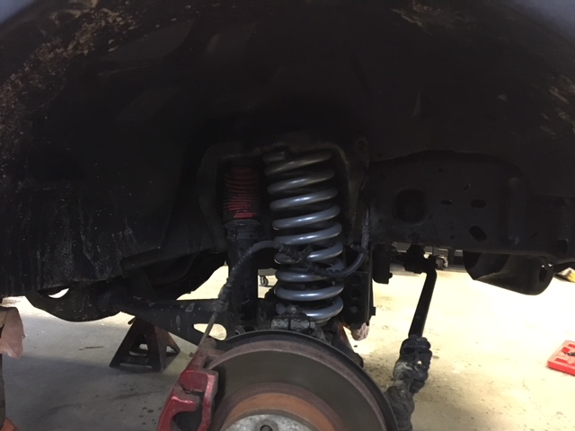

Got the leveling springs in today! Also took the opportunity & repainted the sway bar and replaced the bushings with poly bushings while it was out.
My 1997 Ranger 3.0 4x4
I tried to correct for the excessive positive camber after installing the springs. It's closer to stock but not quite there, I'm hoping as the springs settle that it'll come in more. If not I'll just suck it up and get some fully adjustable camber/caster bushings.

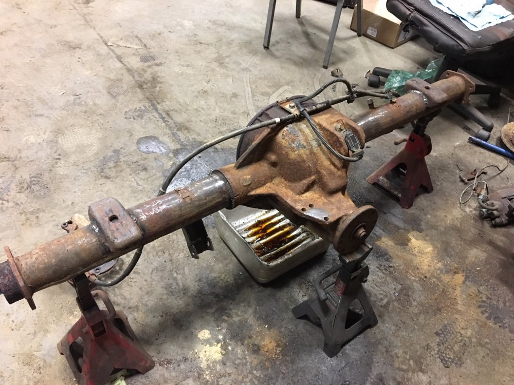

A little change of plans... I sold the 3.73 8.8 L/S explorer rear end I had bought. Long story short after pulling a small trailer with a lawn mower in it I've decided my truck would probably benefit a lot from having 4.10's instead of 3.73's. I really didn't want to have to change out the front diff as well as the rear but the truck could really use it.
So, at a local junkyard I found this rear end in an 03 Sport Trac. It's an 8.8 L/S as well, this time with 4.10's. Internally it's actually in better condition than the 3.73 was, and I spent less on it. :icon_thumby: The exterior is actually decently clean considering as well.
Now to find a TTB 4.10 front end...
Small progress - got the spring perches & sway bar brackets chopped off, and with my brother's help, welded the spring perches back on in the correct location. He also helped fab up some shock mounts and we got those on tonight as well. :icon_thumby:
