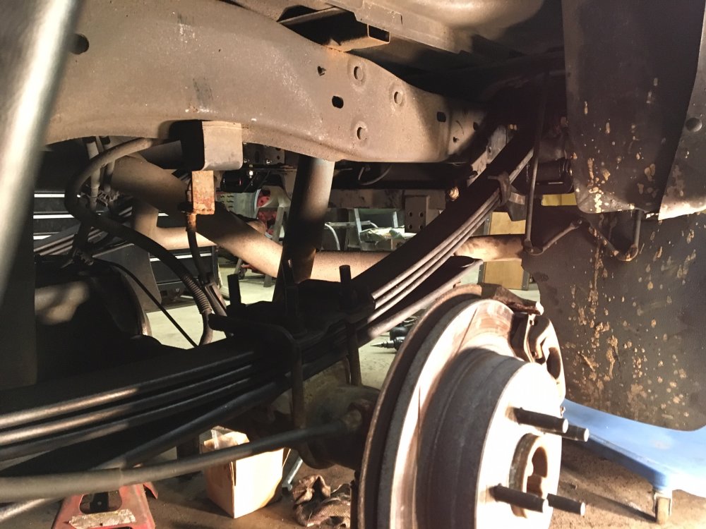

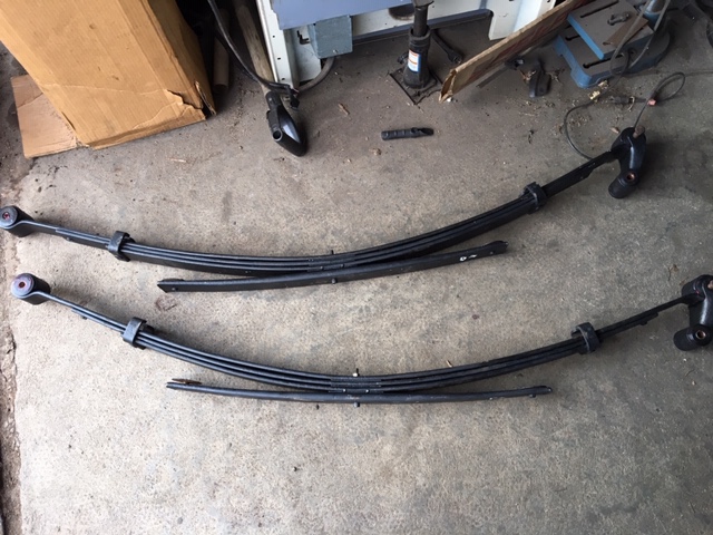

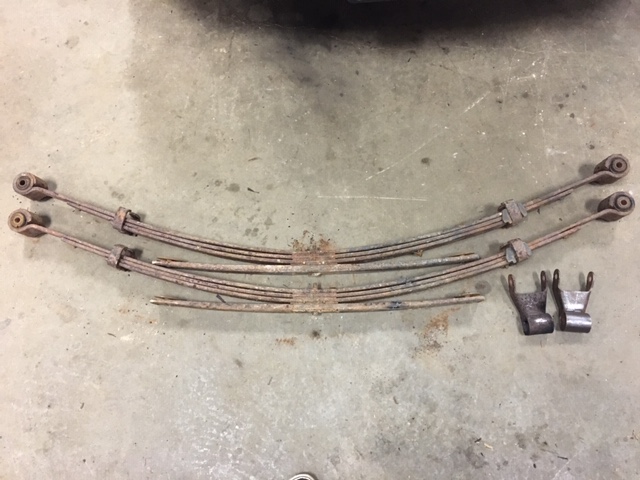

Started my next project - Chevy 64" leaf spring swap. I found a pretty decent set at a local junkyard, they came with the shackles and frame hangers as well. I scrapped the hangers because I don't need them but I'm keeping the shackles. The shackles are the same length as stock Ranger shackles and look almost identical, but the bushing seems to be a larger diameter. It saved me a little money to just get the Chevy spring & shackle bushings rather than getting those and the Ranger shackle bushings and re-using my shackles.
Here they were right out of the junkyard.
My 1997 Ranger 3.0 4x4

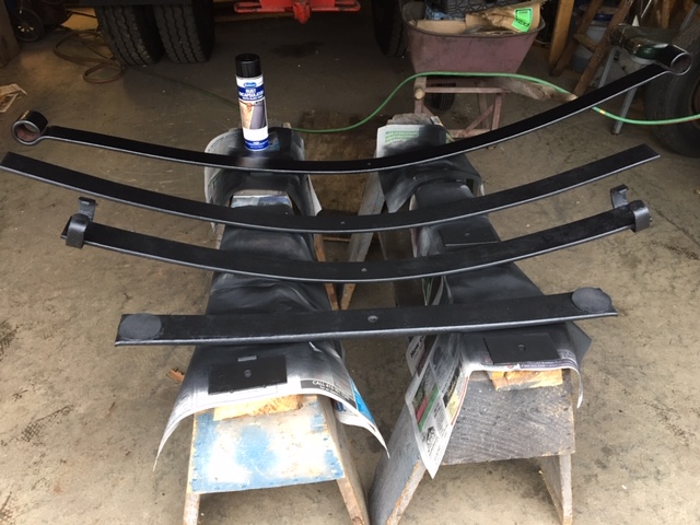

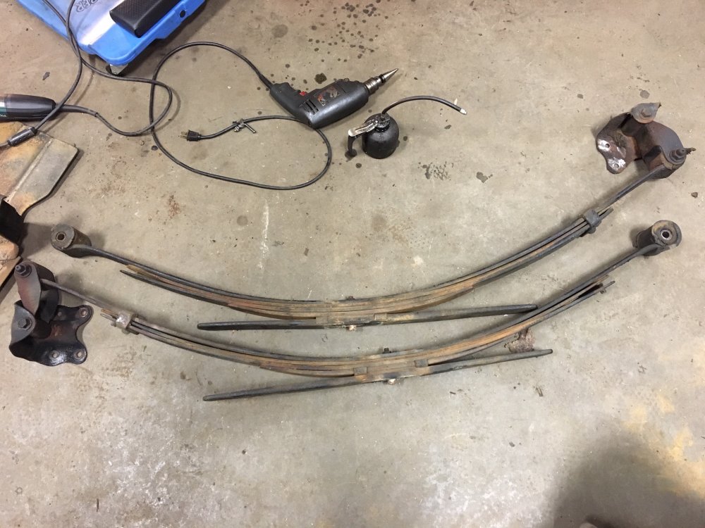

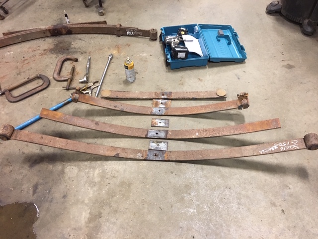

I can't put rusty springs in my truck with a nicely painted undercarriage, so I took them apart to clean them up and repaint them & installed new polyurethane bushings. :p

I also noted their original positions side to side so I can install them the opposite way in my truck to hopefully help with the driver's side lean. Meaning I will use the spring that was in the passenger side of the C1500 on my driver's side and vice versa. Hopefully I don't regret going with junkyard springs but new ones are much more expensive, and even spending $50 per spring for my set - many local junkyards were charging $65 or more per spring. Now as soon as I have a weekend free I can tackle this project!

To get access to the bolts & nuts holding the front hangers on, I removed the gas tank skid plate, unbolted the filler neck from the bed, supported the tank with a jack, loosened the front tank strap, and removed the rear tank strap. The tank was almost full so I didn't want to undo both straps completely and try to balance it on a floor jack. This worked well enough for me to get my hands in there to get the bolts and nuts started threading and then get a wrench in there to tighten them up completely, although it really tested my patience lol.
The front hanger moved forward one bolt hole, holes center punched.
And with all of the bolts in place. As you can see, I had to reverse the top two bolts. It was easier to get them through the holes from the back than to try and start a nut on them on the inside. It looks stupid but there was no way I was going to get it to work otherwise.
Also, I did this swap without removing the bed. It is possible, but removing it would make the job easier. I didn't have help getting the bed off, but even with two people these 7' beds are significantly heavier than a short bed. But the bed made a nice storage bin for all the parts! ? If you do decide to do this swap without removing the bed, invest in a unibit (christmas tree looking bit). I don't think an actual drill bit in a drill would've fit between the bed sides and the frame to drill the new holes. The unibit was just short enough in my case and does a pretty good job.

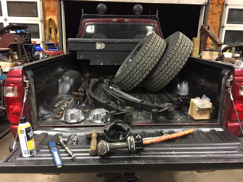

The old springs are out...
...And the Chevy ones are in.

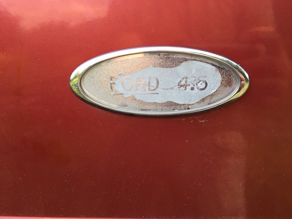

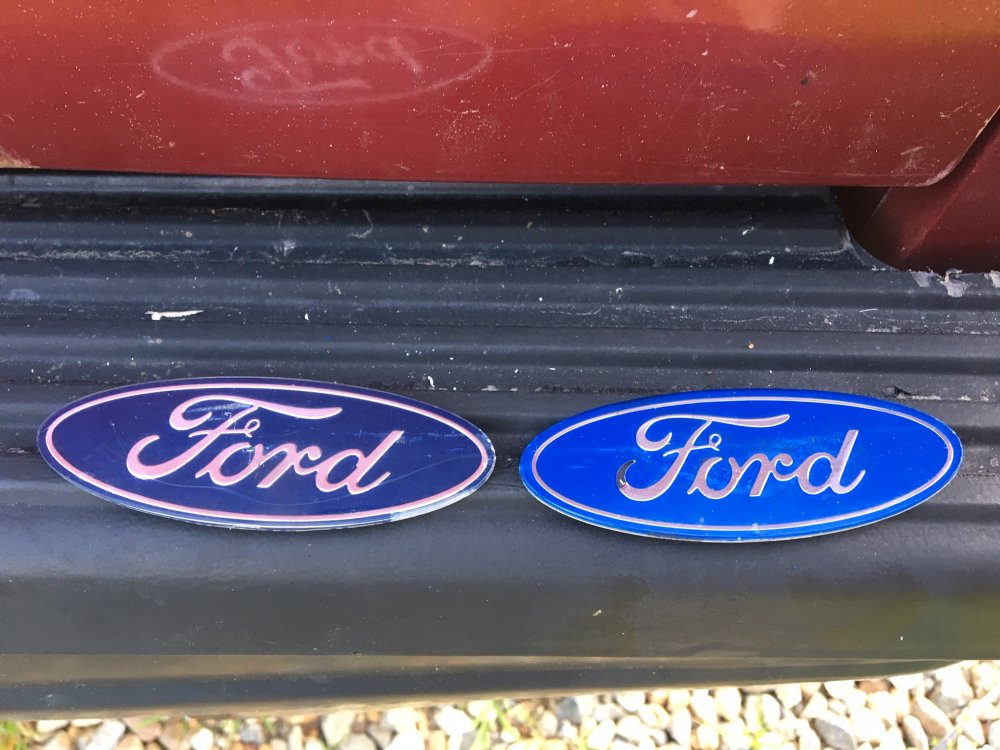

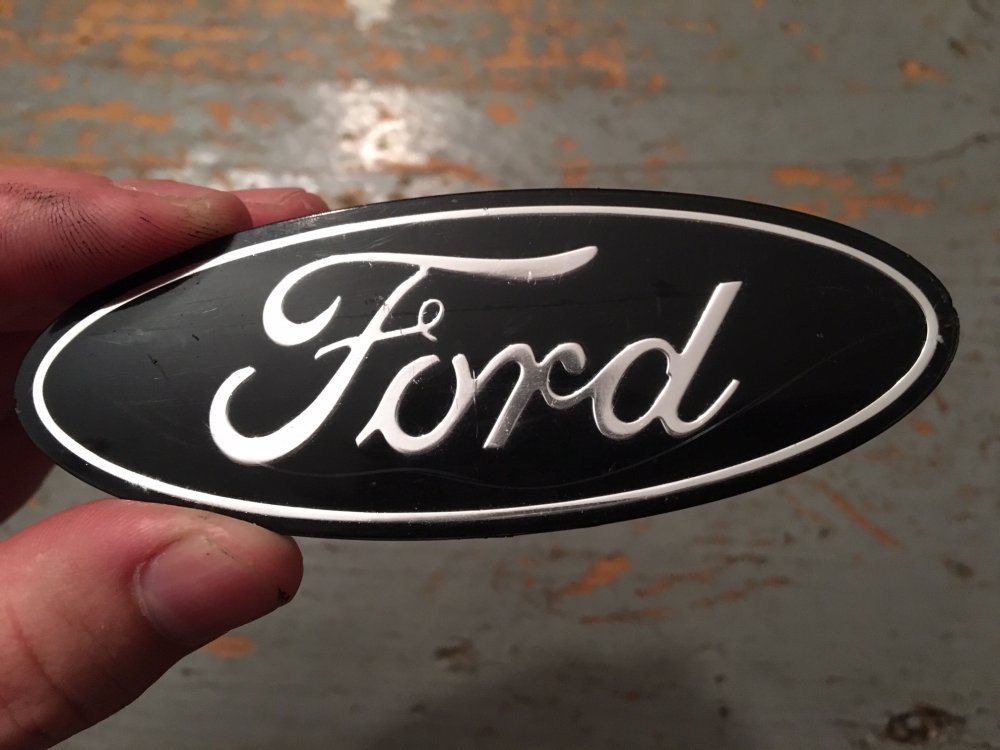

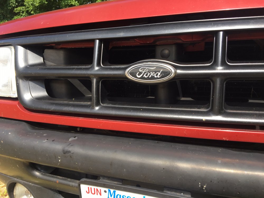

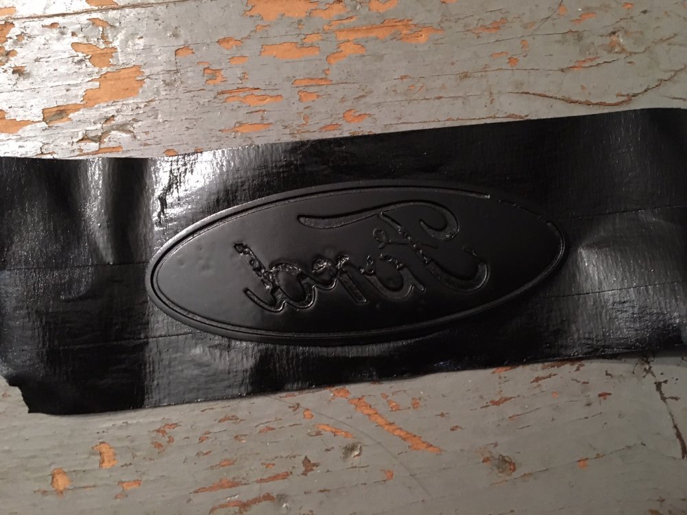

Nothing super exciting has been happening with the truck lately, but here's a bunch of small projects I've done. I removed & repainted my Ford logos black to match the color scheme of my truck.
Side note - who would've guessed they were this off color from each other? I never noticed till they were side by side lol.

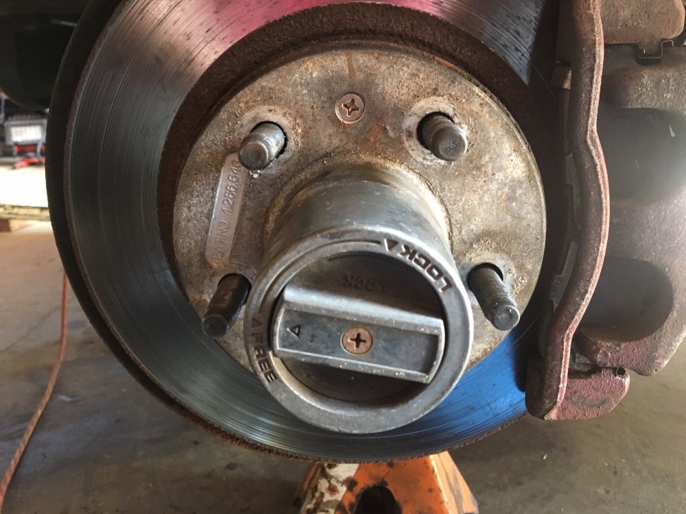

Sometimes the easiest and simplest mods are the best. No longer will the locking hubs come off with the wheel. This was absolutely worth the time, every time I take the front wheels off I'm so glad I did this haha.

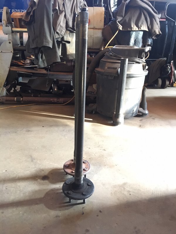

One other thing I did find though while trying to sort out an on road vibration before this trip was that I had a bent axle shaft. The whole wheel/tire and brake assembly would wobble when rotating. I discovered this by having the truck running in gear on jack stands. I ended up going to a junkyard and pulling an axle shaft from an 02 Explorer Sport (thankfully the Sport and Sport Tracs both had the same solid axle) and replacing the bearing, seal, and caliper on that side. The caliper guide pins got totally wrecked from all that wobble. I think this axle was already bent when I got the axle from the junkyard last year. I remember it making funky brake noises coming from the rear after the axle swap - when driving at slow speeds, there was this "erf" sound that would happen more often as you increased speed. It eventually went away, and I realize now that noise was probably the rotor wobbling inside the caliper & pads and the sound was either the pads rubbing, or maybe the whole caliper vibrating making the noise, until the guide pins got out of whack and the whole thing could wobble. But anyway, here's the best picture I have of the bent shaft. The bent shaft is in the front, the replacement is in the back. You can see how the front shaft is bending to the right in this picture.

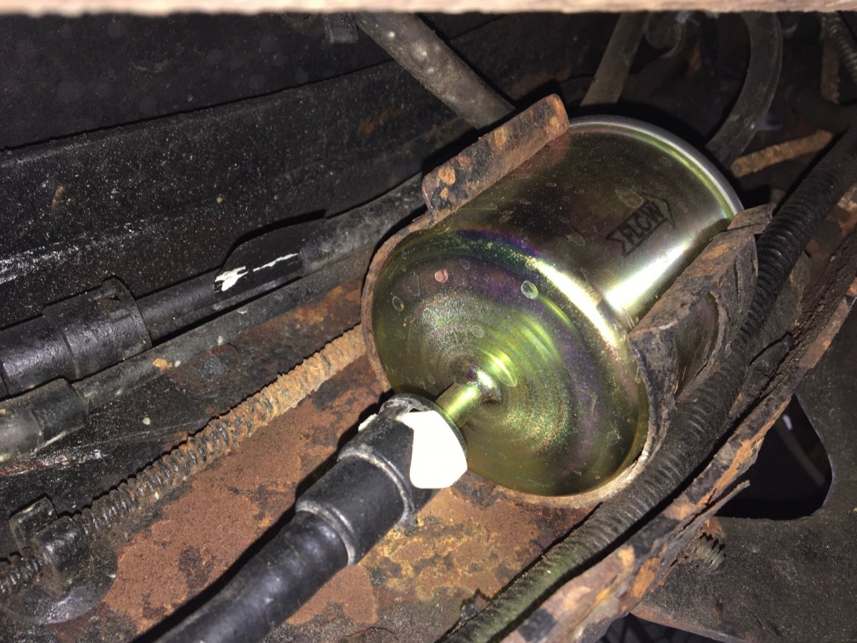

Maintenance time, I've now owned the truck for a little over 30k miles. According to the service schedule that came with the truck, the air filter and fuel filter have to be replaced again now. New fuel filter...
40054

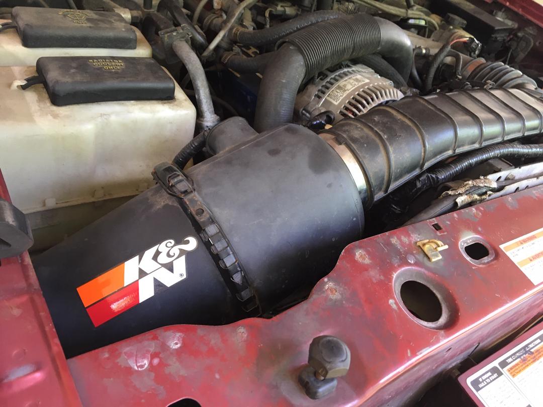

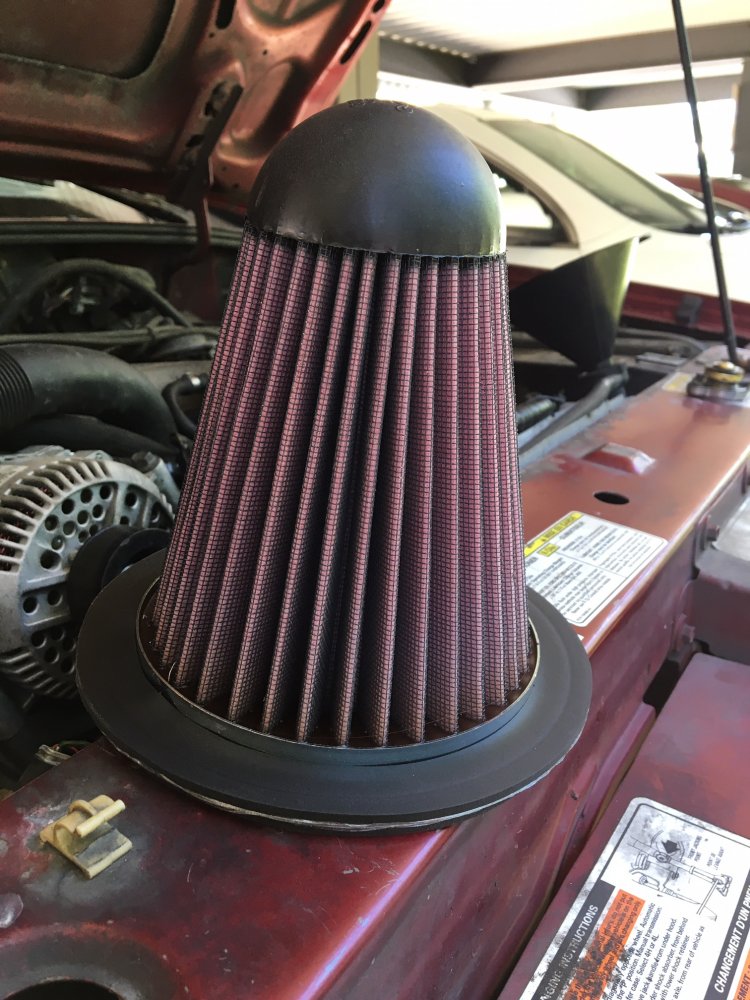

...and new K&N air filter. I figured I'd give the K&N air filter a try, any slight power improvement with these 3.0's helps. I did also do the throttle cable mod, and between that and the new air filter it feels great. I didn't realize how much slack my throttle cable had and I wish I had done that sooner.

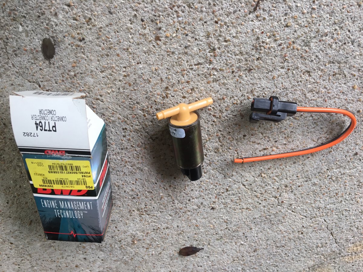

I've had a P1443 code for a while, and hadn't been able to determine why. I had done testing on the purge solenoid and sensor a while back and I thought I remember them testing fine. But I went back the other day and found that there was no power getting to the purge solenoid. So I bought a new pigtail, and after a little searching this is the part number I found that matched the purge solenoid connector, PT764. I bought a new purge solenoid too, because when I first tested my purge solenoid it didn't seem to open when power was applied to it. But after I did some more testing it opened and closed as it should without fail numerous times, so I returned the new purge solenoid as it didn't seem necessary.
40059
All soldered, heat shrink'ed and taped up. The only thing with that pigtail is that the colors are backwards from the direction of the original plug. The red wire from the harness has to go to the brown wire on the pigtail, and the gray wire has to go to the orange wire on the pigtail. So far, this seems to have fixed the problem. I went for a short drive and the code hadn't returned yet, it usually does pretty quick after disconnecting the battery. Hopefully it stays away.

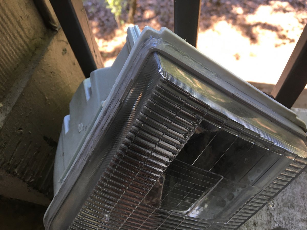

I've been dealing with moisture inside the driver's side headlight and it's been annoying the heck out of me. I had some time today so I decided to take care of it. I took it off, filled it with water to find the leak, let it dry, then applied clear silicone sealant around the part that was leaking.
40064
40065
All back together. I guess I'll know in a few days if this is actually an effective repair. Unfortunately some of the reflective coating on the inside of the housing got worn off, I'm assuming due to the water getting in there and so now that headlight looks a little less clear due to that; but hopefully the light output isn't impacted from that. If it is, then I guess I'll just have to suck it up and replace it... again lol.

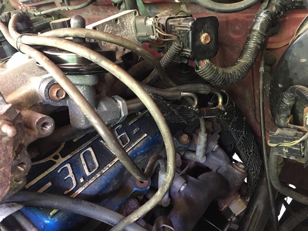

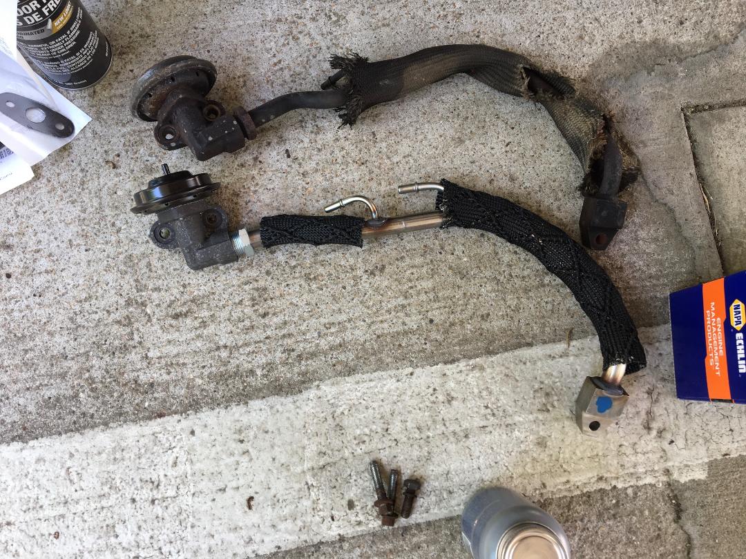

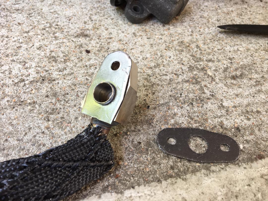

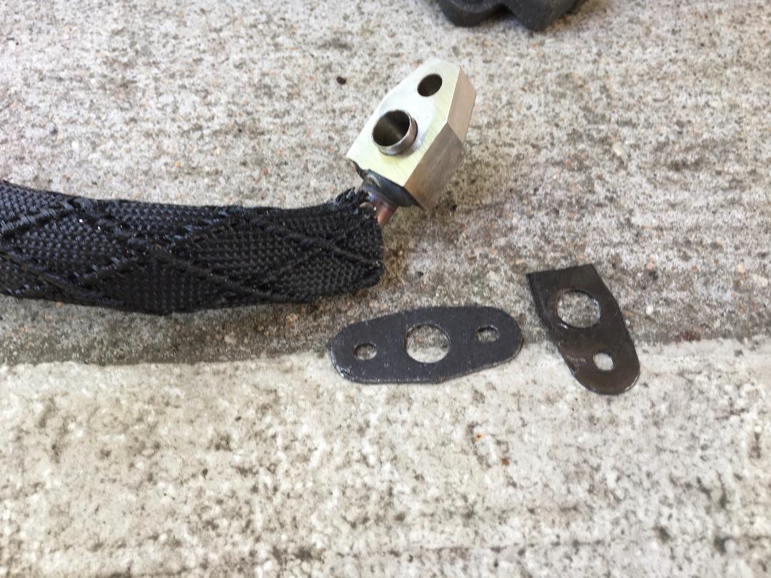

I figured I might as well replace the EGR valve with it, and I'm glad I did. I believe that my old one was bad. Ever since I've owned the truck, the idle air control valve seemed to stick or something. It would rev hang real bad; so bad that I left it unplugged to drive it because I couldn't stand it. When I first got the truck, I had tried cleaning the original IACV, replacing it, replacing the TPS sensor and none of it helped so I gave up. After replacing the EGR valve, it acts almost perfectly normal now. I don't know if the EGR valve was stuck open effectively causing a vacuum leak or what, but nothing beats unintentionally fixing a different problem while fixing another. Usually it goes the other way around, you create more problems trying to fix another :icon_rofl:
Anyway, here's a clever trick I discovered to make a gasket for the exhaust manifold side of the EGR tube. (I don't believe anyone makes a gasket for it, I couldn't find one.) Buy a 2nd EGR valve gasket, and trim off one side right near the bolt hole. The other two holes line up almost perfectly to use as a gasket on the exhaust manifold side.
41103
41104
Done, and no leaks anywhere. (y)

I almost forgot, how could I expect to get any possible gains from the K&N filter without adding the K&N sticker? ;)
41106

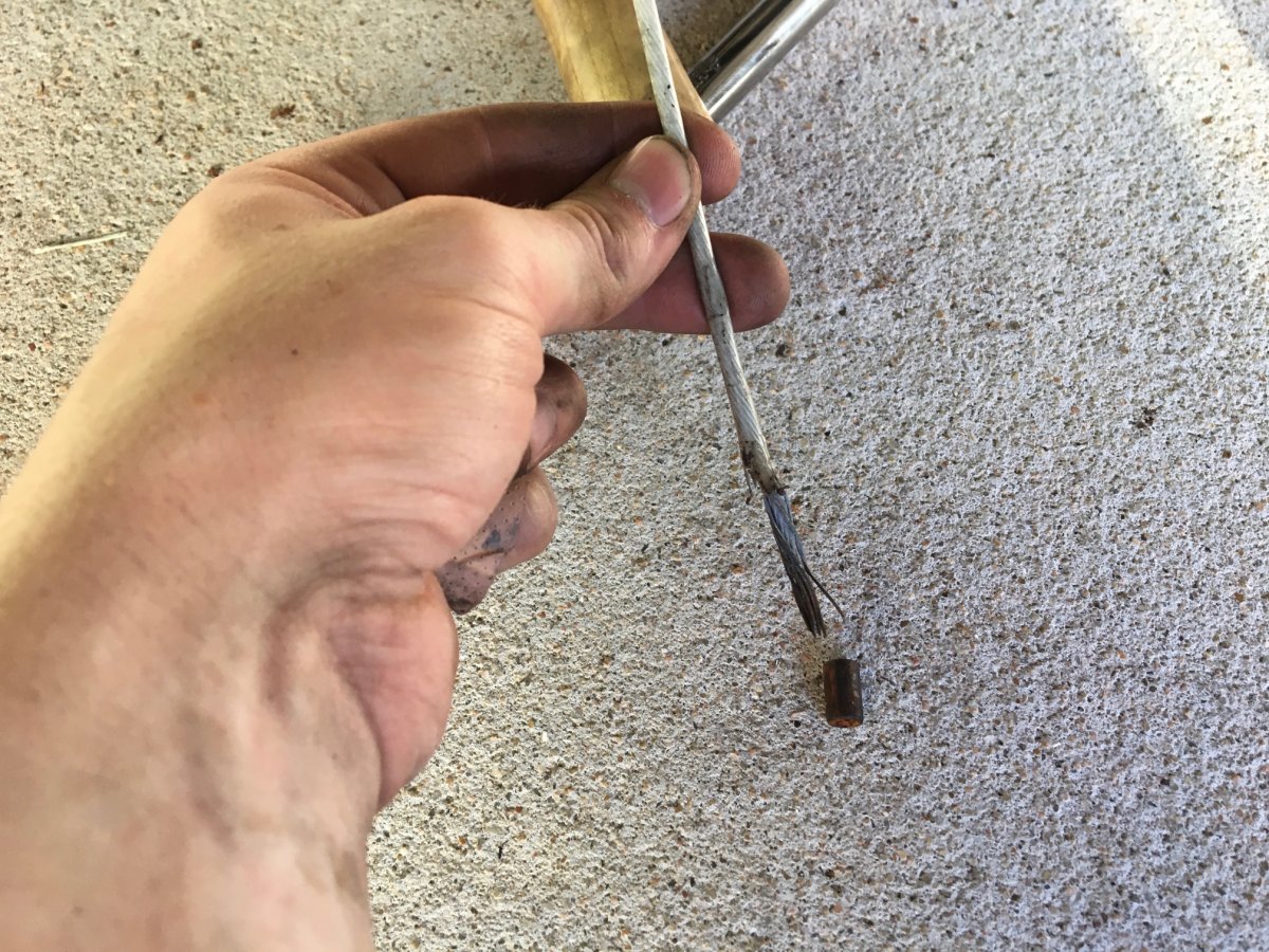

Still trying to get the parking brake to work well after the Explorer rear axle swap. When I initially did the swap, my brother and I were able to make the parking brake work decent. However, after doing the 64" leaf spring swap and having to relocate the bracket bolted to the spring hanger, I never did finish making the e brake work properly again. So I finally set out to do just that.
The first problem with trying to mimic the factory setup that I could see is that it doesn't seem to pull the cables equally. I don't know how it works with the drum brakes and I don't understand how people make it work with these disc brakes, so I decided to modify the setup to pull both rear cables simultaneously. I have limited resources here at my apartment so here's what I came up with. The driver's and passenger's side rear cables are different lengths, so I came up with this solution to space the top cable back so that they were the same effective length after the bracket.

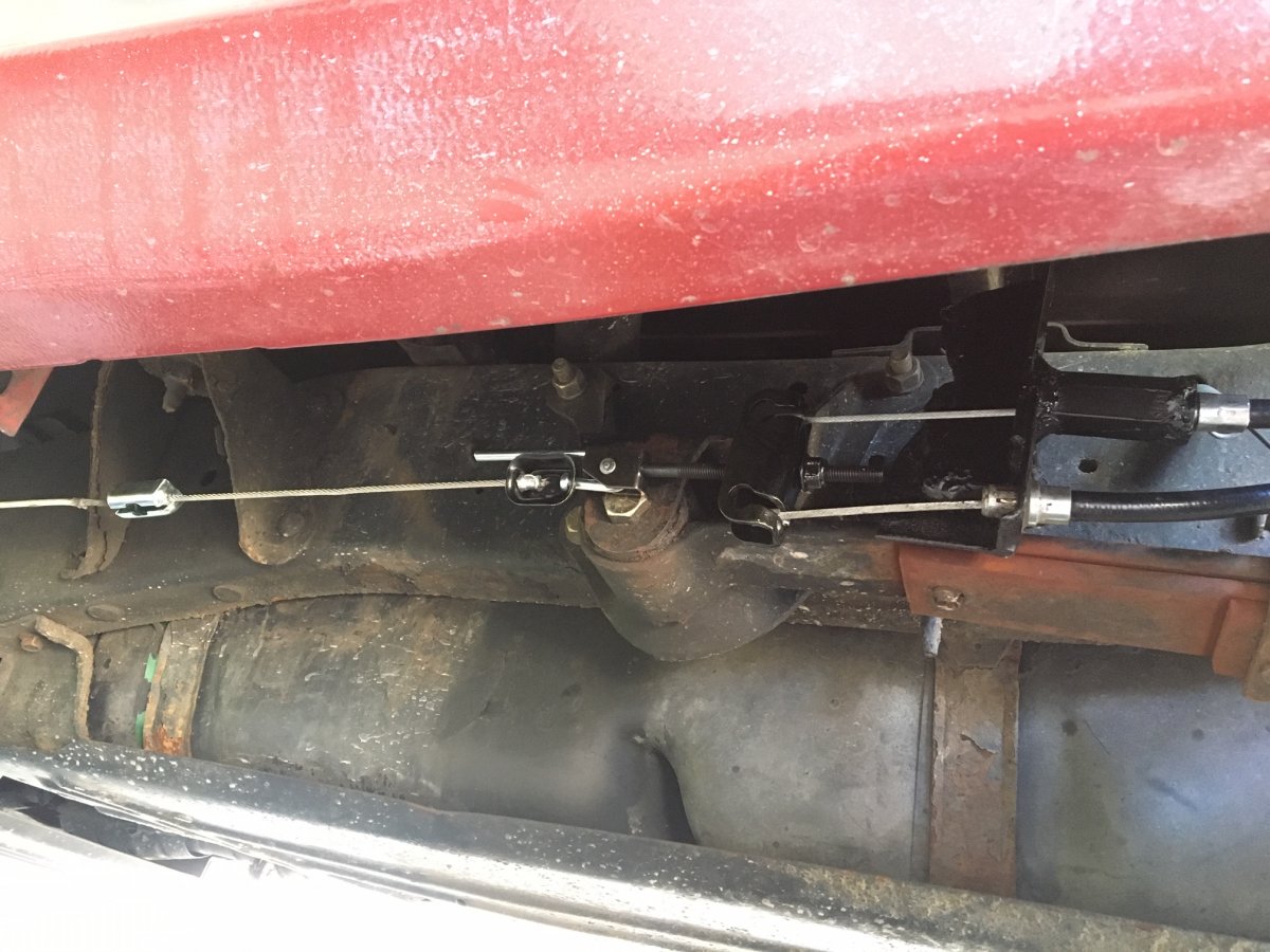

Doing this though left me with almost 9" of cable I needed to make up to connect the cable coming from the pedal to this equalizer bracket. So I bought some 1/8" stainless cable and some cable stops and made my own cable. It's not pretty but it seems solid, and I bought extra length of cable and extra stops to make another if this fails later on.
42541
That and a connector from a cheap kit of various parking brake connectors from dorman... and it's all hooked up.
42542
I tested it and well; unfortunately it doesn't hold that great. I did notice though that the bracket I made for the 64" spring swap actually flexes quite a bit. Just pulling on the main cable by hand you can see the deflection of that bracket, so I can imagine it flexes a lot more when actually being used. I believe that is now the problem, since some of the force needed to actually engage the shoes inside the hat of the rotor is lost there flexing the bracket. I'm going to think on ways I can stiffen it and try again. Other than that, maybe my shoes aren't adjusted that well. I followed the procedure in my Chilton's manual which said to adjust the shoes out until the rotor won't turn, then back it off 8 clicks. I found that I had to then turn the adjusters back in 2 more clicks for the parking brake to work on the slightest incline. I'm curious, what methods for adjusting the parking brake shoes have you guys found successful? Maybe I need to adjust them differently.

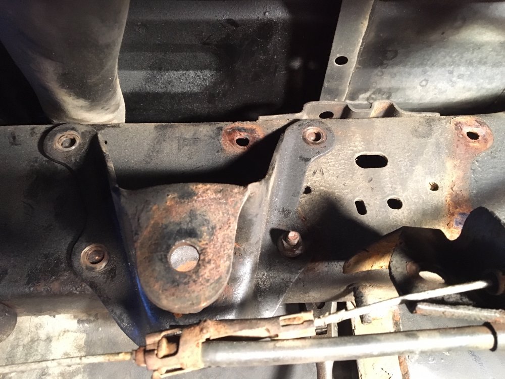

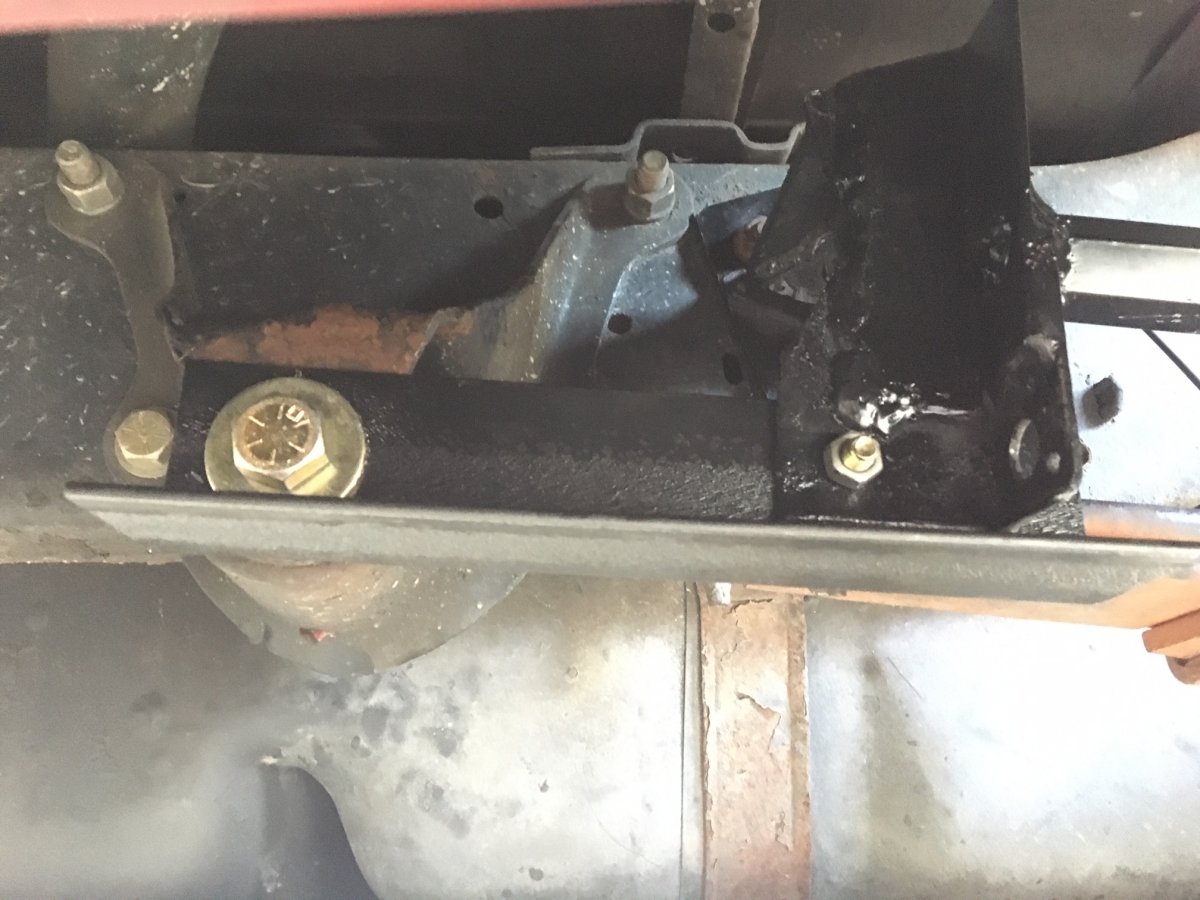

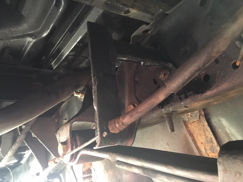

I made a simple bracket that ties the parking brake bracket to the front spring hanger to stiffen it and stop that bracket from flexing forward under the cable tension.
43016
For now it just bolts together but eventually I'll weld it together to strengthen it more. But even just bolted together it fixed that flex-y bracket problem (y)
43017
All hooked back up you can see the angles aren't perfect. One day I should redesign this bracket and move where the rear cables go through the bracket so that they don't pull downward like they do currently, as you can see in that picture.
Went to test it, I tested it twice and it seemed to hold noticeably better! Then went to test it a third time... and this happened...
43018
When I heard it snap I assumed that it was that intermediate cable that I made that had broke. But to my surprise it was the factory cable that broke, not the one I made!
So I spent a while trying to fix this by crimping on a new cable stop to the factory cable, along with various other methods but nothing would work. For some reason, the cable stops and whatnot that I bought hold onto the stainless steel cable very well, but just slip off of the factory cable under tension. I don't get it. After spending a few hours trying to make it work again, I finally gave up for now. This shit makes me want to drive the truck off a cliff sometimes. :pissedoff: It's just a parking brake and it shouldn't be complicated, but man does it just refuse to cooperate with me. Why does no one else on here seem to have as much trouble getting their Explorer parking brakes to work on their Ranger? Even if/when I do make this work I feel like I'm going to have trust issues with it lol...
