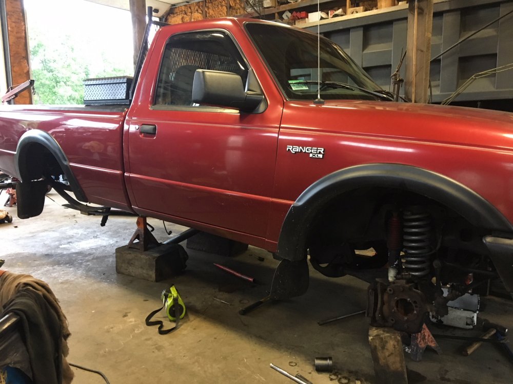

I was too excited to wait, and there was still plenty of time in the day so I got started by removing the stock rear end. Out with the old, and in with the new :icon_thumby:

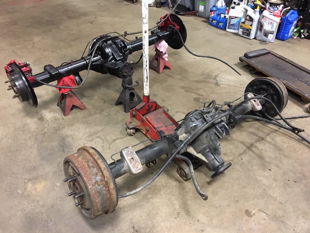

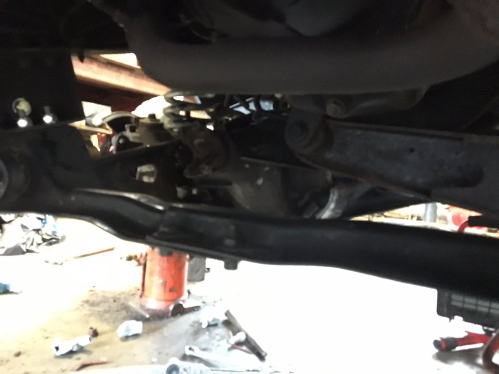

Front & rear axles both out...
The 4.10 D28/35 hybrid on the left, stock D35 3.73 on the right.

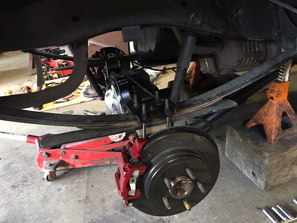

Started getting the rear end in place, all went well and got it bolted in place.

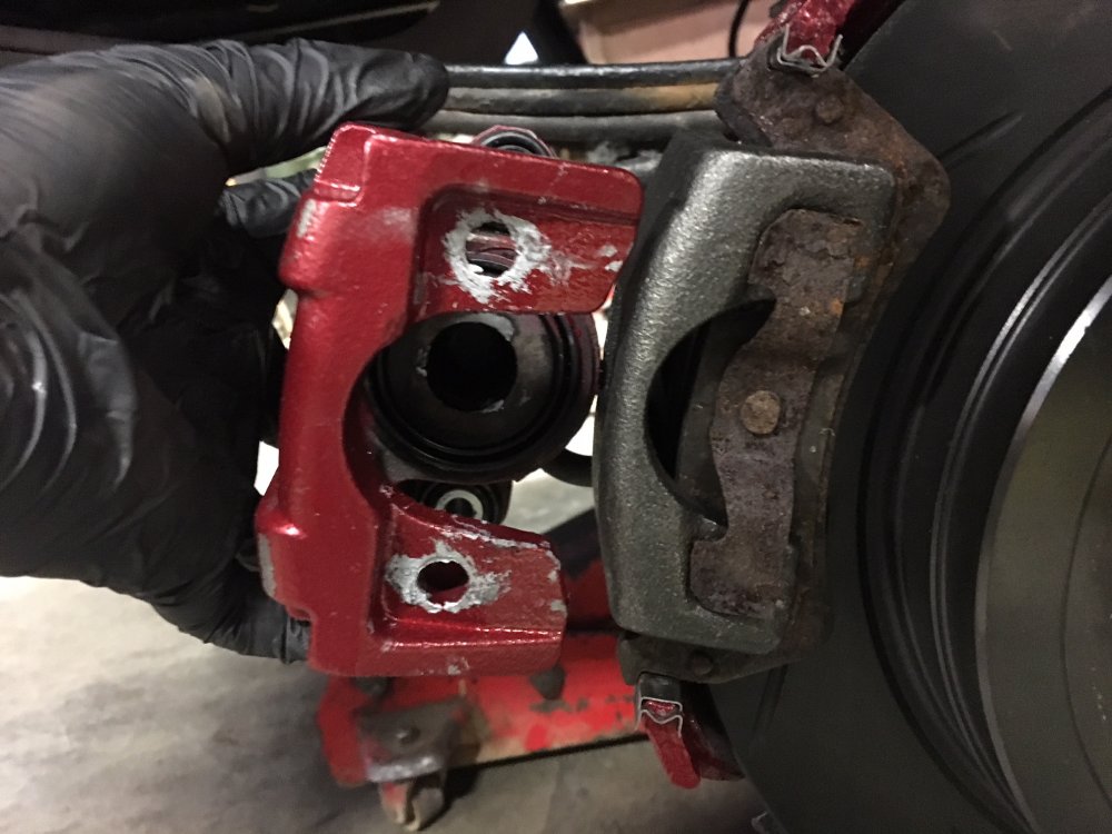

Ran into my first problem though, and figured I should document it though in case it helps someone else! So, apparently the Explorer Sport Trac and Explorer rear calipers differ slightly. The Sport Trac calipers are slightly larger overall, and neither sets of my 15" wheels will clear them. While I was having a moment of panic trying to figure out what I can do other than having to buy a set of 16" wheels, my brother did some research and noticed that the Explorer rear calipers looked smaller. So for kicks, we bought one caliper to see if it was smaller and if it would work, and it will. The Explorer caliper bolts onto the Sport Trac caliper bracket.
So if you want to run 15" wheels with an Explorer rear end swap, make sure you get Explorer rear brake calipers and pads if you bought a Sport Trac rear end. The rotors are larger for the Sport Trac, along with the different calipers and pads (compared to the regular Explorer 95-01 rear axle most people use). Otherwise, I believe it's the same basic 8.8 31 spline axle, aside from the brake parts.
Here's a side by side of the Sport Trac (left) vs Explorer rear caliper (right)
Painted the new calipers & swapped them in

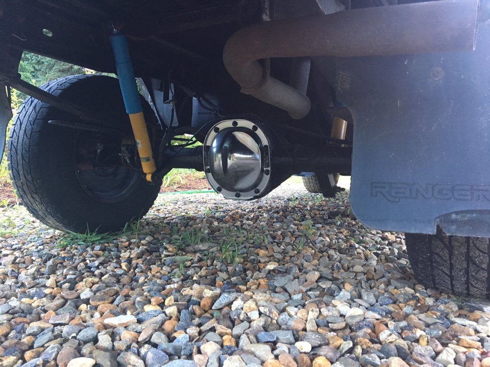

Got Bilstein shocks for the rear of this truck. I've been trying to find them for a long time but no one had them in stock - I really wanted to try them and know what they're like. So far I'm really happy with them, they really take out a lot of the harshness in the ride quality of the rear end since I've added the add a leafs. I'm now tempted to get them for the front as well and see how it changes the overall ride quality.

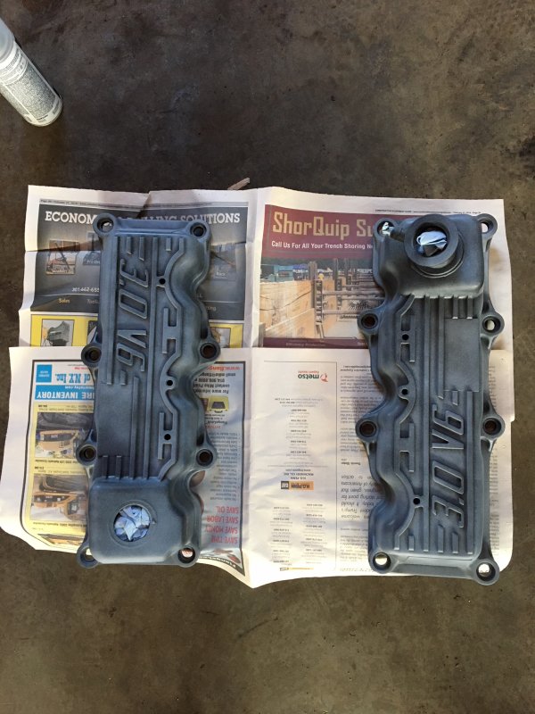

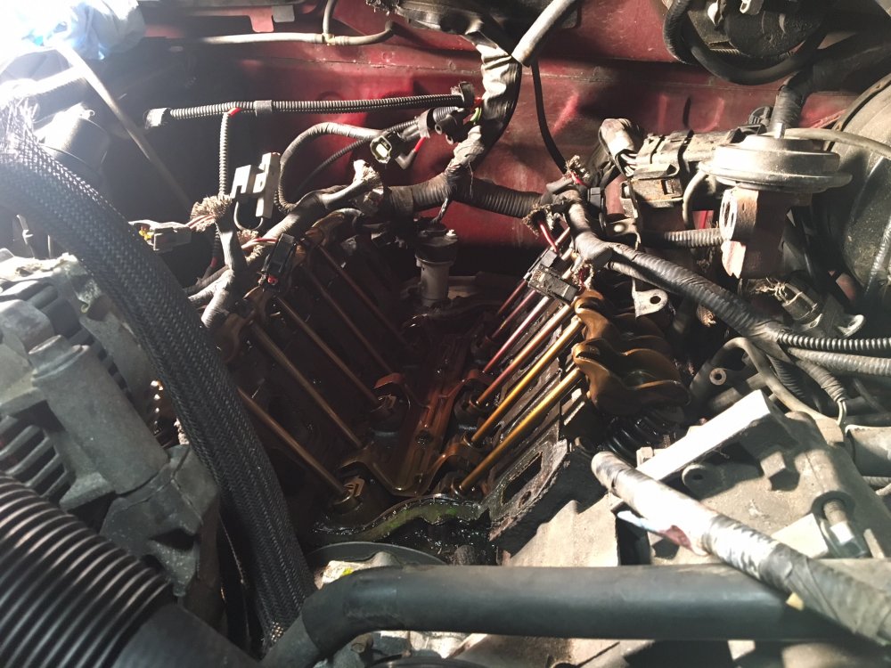

My truck was throwing a p0172 (system too rich bank 1) code and after doing some tests I discovered it was due to a leaky lower intake manifold gasket. I've had my suspicions since day 1 of owning this truck that it had either an intake manifold or vacuum leak because I have a lot of symptoms of it; so it was time to fix the problem.
I forgot to take a lot of pictures during the process but here are some I took. Lower & upper intake manifolds off:

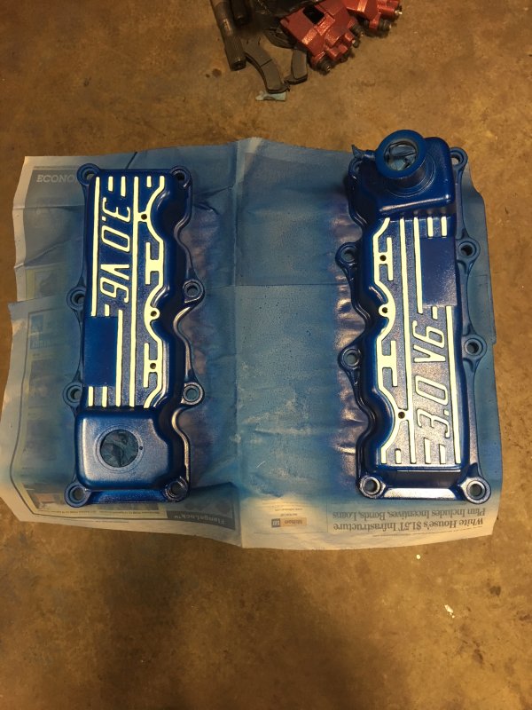

Since I had to remove the valve covers to remove the lower intake manifold, I decided to replace the gaskets & paint them up. Here they are with the tack coat of primer:
...and painted, with the help of my brother doing the lettering for me!
...and with the lower intake manfiold & valve covers back on
The truck's all back together now & running better than ever with no p0172 code anymore. Now if only I can get rid of that pesky p1443 code that refuses to go away :dunno:

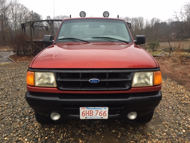

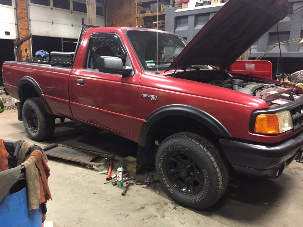

Small update but I found a nice set of 30x9.5R15 tires on craigslist so I am now running 30's instead of 235/75R15 (29's). It's a subtle difference but I feel like it's a more appropriate tire size for the truck. I just wish these trucks didn't have to come with 215/75's from the factory lol.
Here's how it sits now. I need to touch up the paint on the wheels now from dismounting the 235/75s and mounting the 30s myself, but other than that I'm happy!
