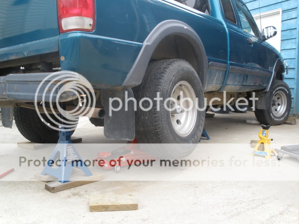

This is what I got accomplished today. To put it simple a whole lot of nothing.

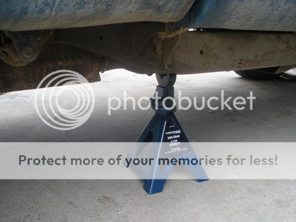

Got some new jackstands though, high lift 6-tons. BOO-YAH!

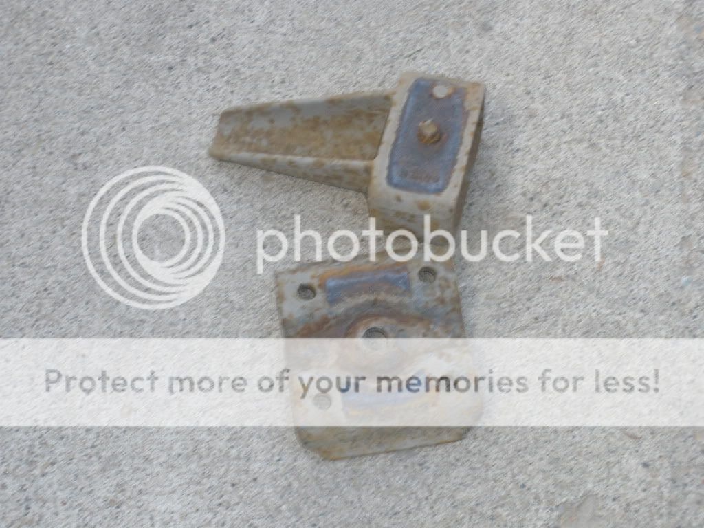

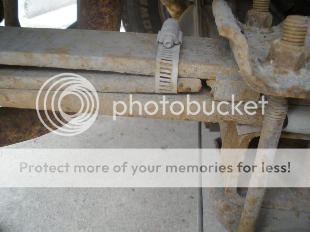

Second Ranger, second broken leaf.

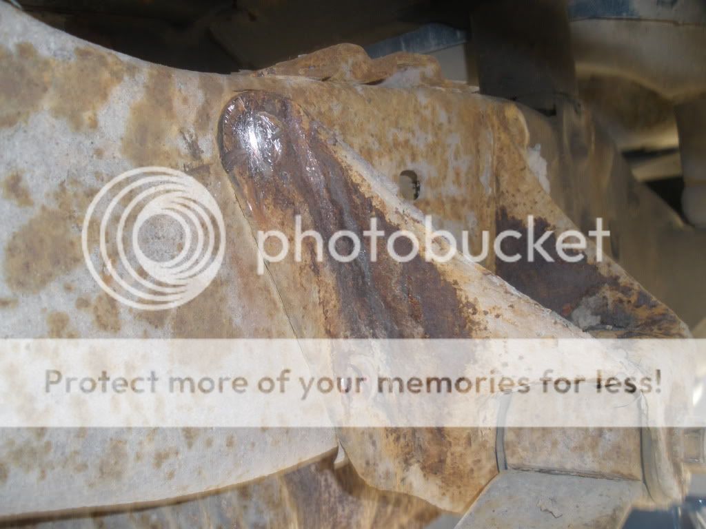

Thinking about painting these before I throw it back together, but at the same time F it.

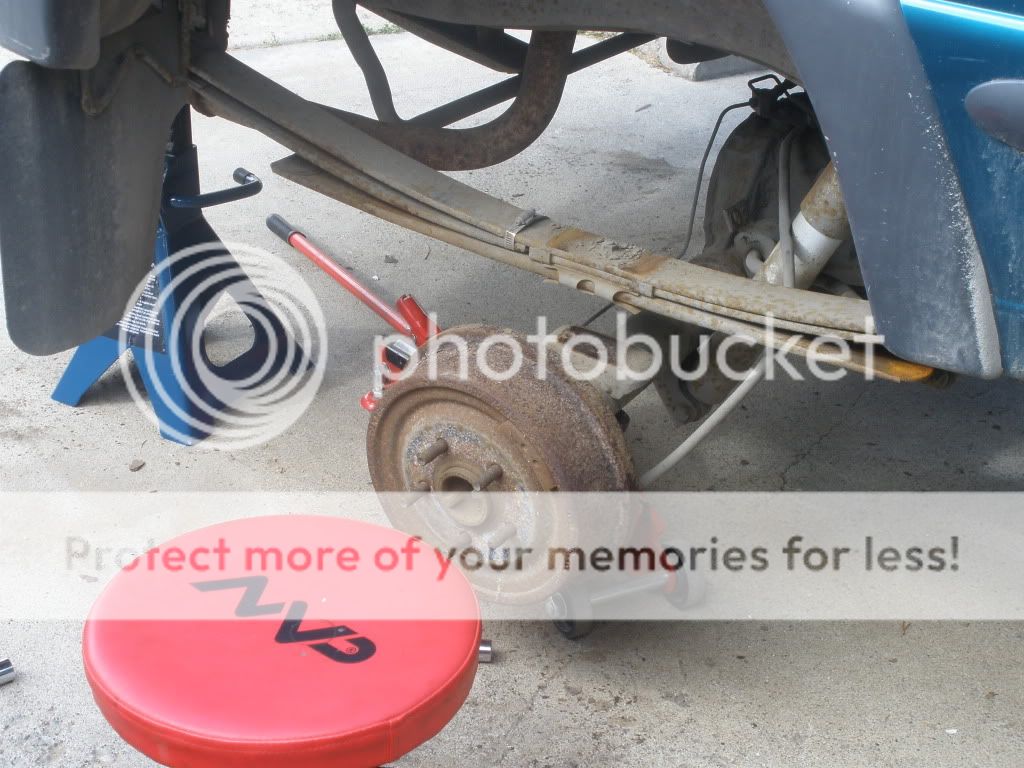

Better than any desk.

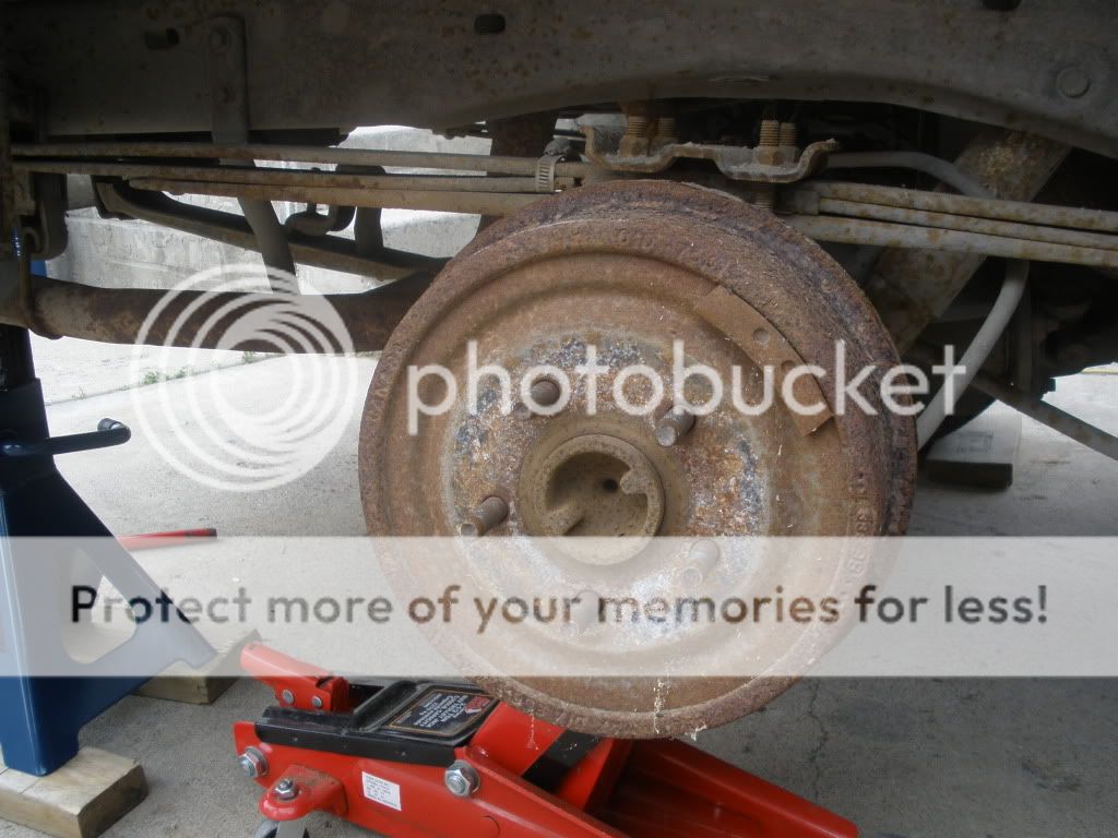

And that's as far as I got today.

...why are you taking the hanger off again? I forget.
You can't really tell from that pic but they are rusted into oblivion. That one looks alright but it has become really thin. As in I can see it buckling thin.
I got nothing done today, just started staring at it. I'm half considering getting this one side done and getting a shop I deal with that did a set of Ranger springs not long ago to do the other side. I thing with a grinder it won't go to bad but I'm sketched out with the tank right there. Hopefully the weather is nice tomorrow and I don't feel so burnt out. If I can one side down i might just be the inspiration I need.
when we did mine wasn't too bad....
remove the tank skid plate....
support the tank with the floor-jack...
unbolt the tank straps...
push tank over enough to get the new bolts into the frame and wrench to hold them while we tighten them down...
put everything back....
and yes we ground the rivet heads off with the grinder.....
l8r, John
Alright John good to know. Well it's been raining tonight but that fine because I've got the labour day long weekend ahead of me. No work and the weather will hopefully hold decent. Should be able to get really far along over the course of those days. If I can't get the leaf spring free I could even get even get one side buttoned up.
