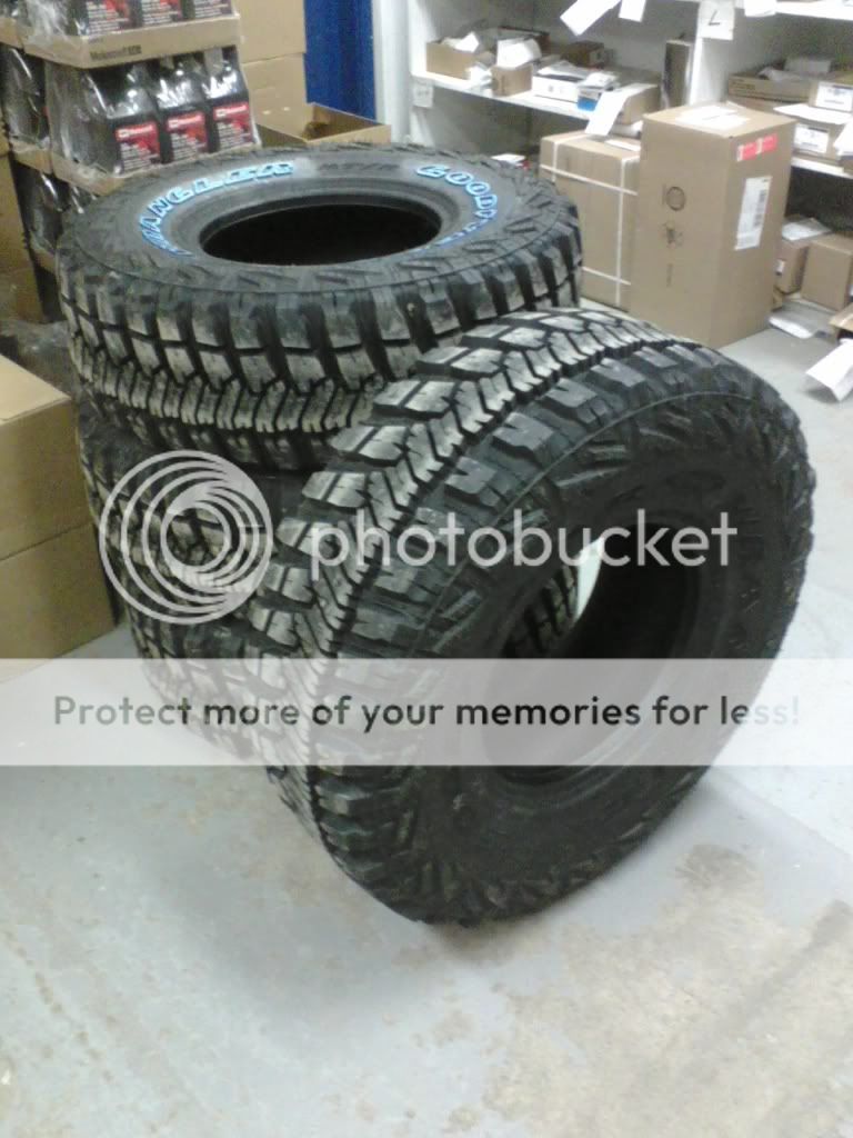

Alright so... my tires came in today. Something tells me those 32x11.50 are going to rub a little. Good thing I don't mind trimming:D

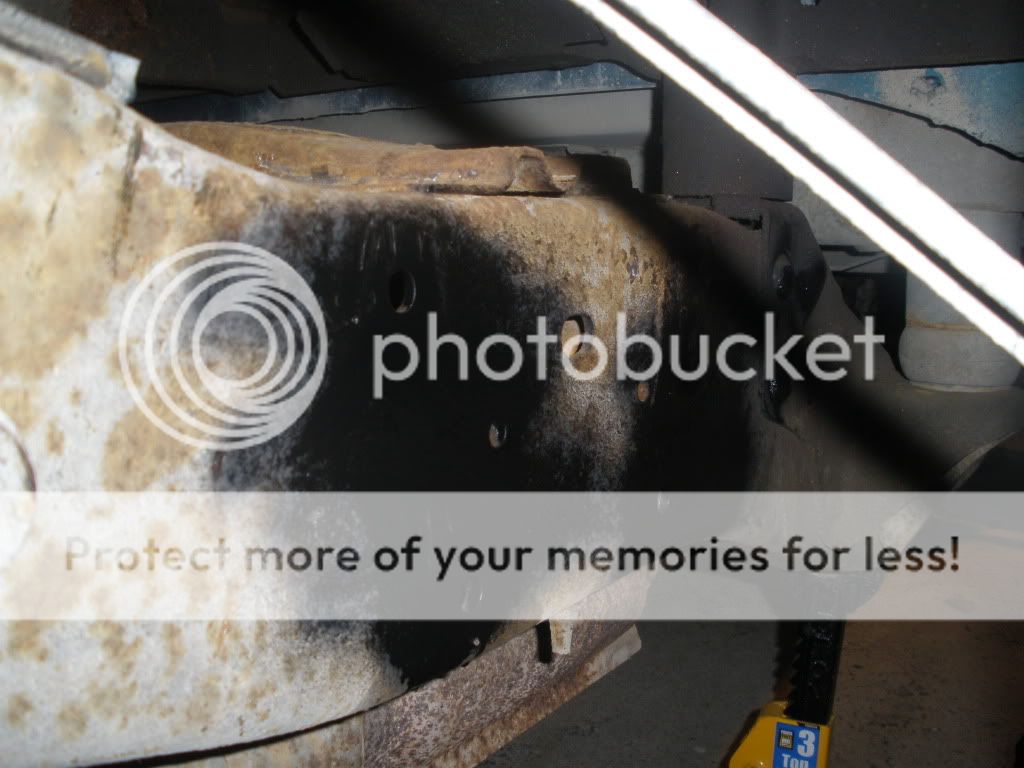

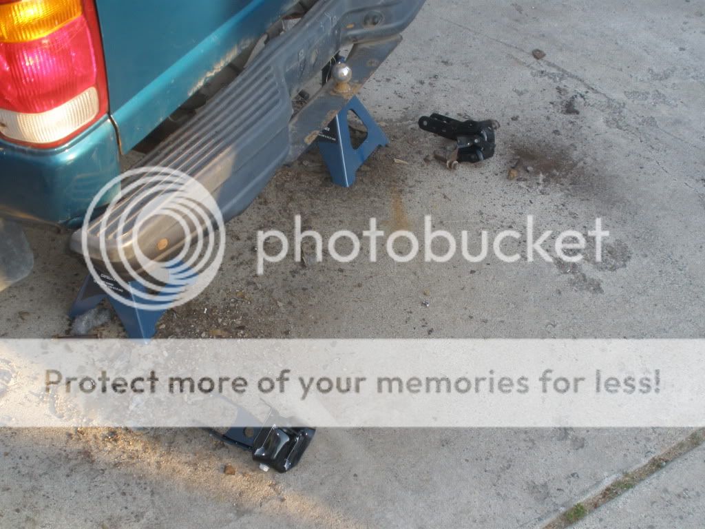

I got all the hangers off the frame yesterday, now I'm going to pound the rivets out tonight. There will be pics and some stories later on!
You mean these tires?
A-BOO-YAH!
Clever eyes will notice Ford oil in the background haha.
them's some purty tires.
i like what they've done with the tread design.....kinda drifter meets bogger,and the sidewalls got some meat,too..they should work good,probably quiet too.

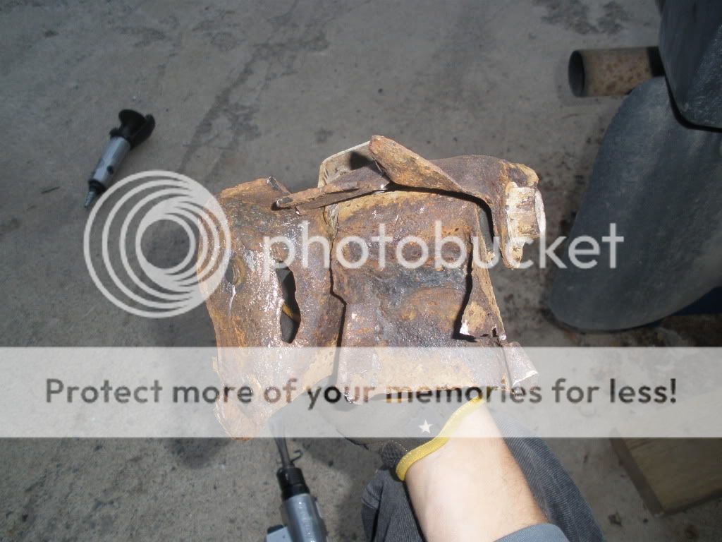

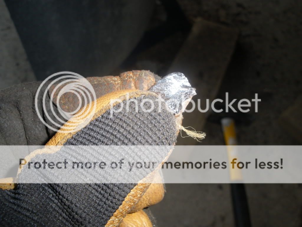

This is what my new impact hammer did to the hangers, it's so wicked.

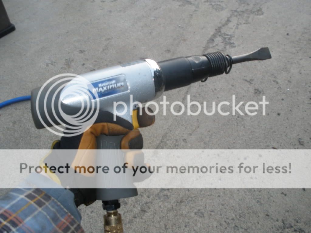

In case you wondering, this is the new air hammer I got, a long stroke one this time. It kicks ass, I used it today to push the bolts out of my leaves and all the rivets out of the frame.

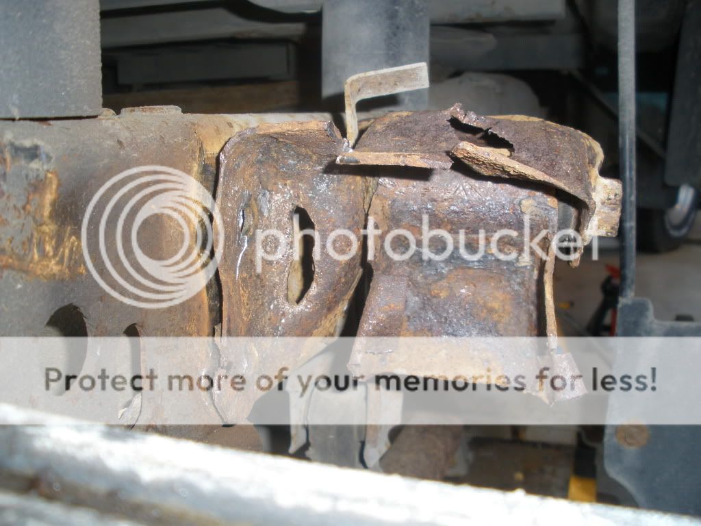

The hanger on the truck, almost off.
It just ate through those rivets.

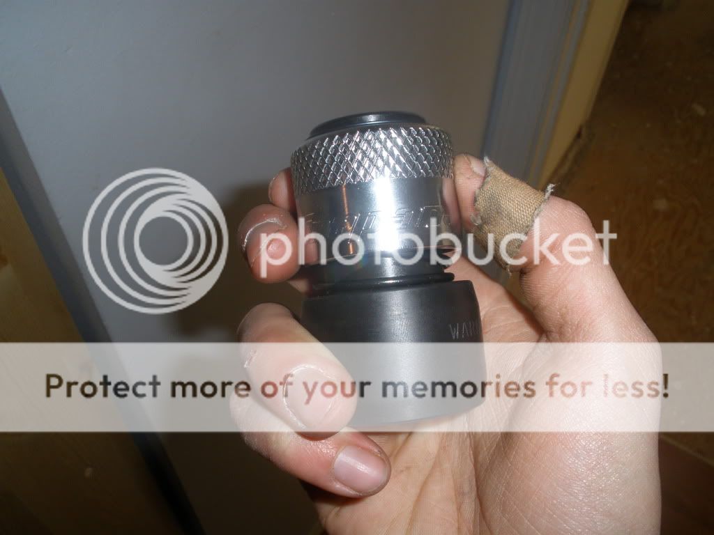

Bought another little goody today. It just so happened my new air gun was wrecking springs and today was the day the Snap-On guy came to the dealership. It's a quick release air hammer chuck. Definitely worth the money after all the springs I wrecked.

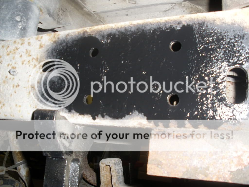

First coat.

Tires look awesome! I only get slight rub on my truck with 32's but thats because I have a leaf spring issue in the back passenger corner. I've got 2" coil spacers, 1" lift shackles, no body lift. You might be fine. Probably depends on the rims you mount the tires on though too
Tires look good, Mike! I'm kinda jealous a little. Good luck on the safety!
Yeah I can't wait to see those on the truck...like Tire Porn!
Thanks rk, I'm worried about the front a little. My rims don't have much back spacing but I'll just trim if it turns into an issue.
Hey man I think I was about due to have a TRS-worthy truck haha:D

That it will be. The techs coming to the counter notice them right away, one is actually pretty excited to see them on the truck too.

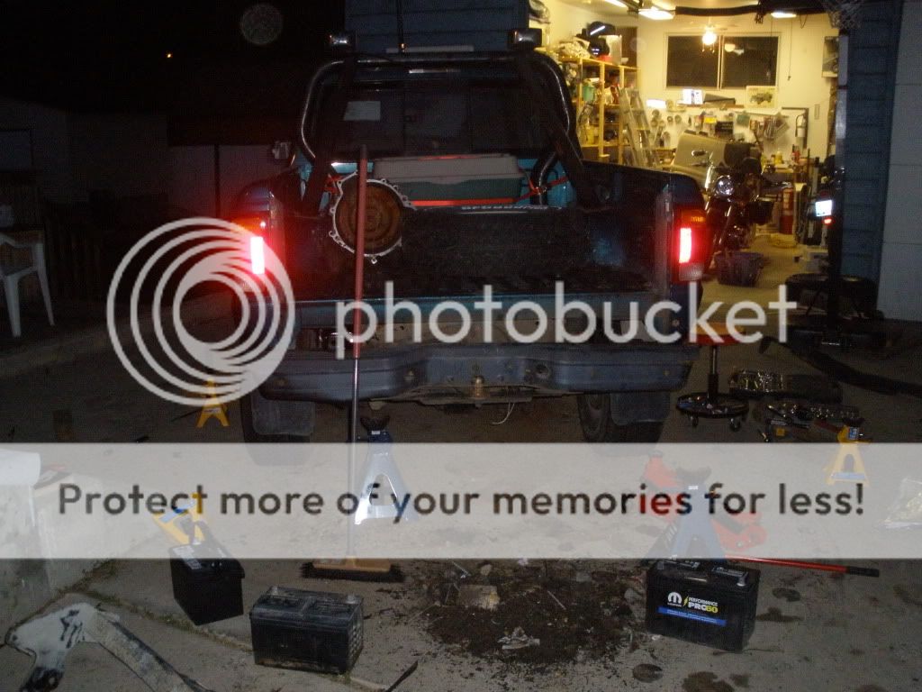

This is how much I got done today, found out I have to work tomorrow so things are going to be a little close. I have to figure out why the battery went dead. Or just toss in my spare for the 2 days it will be down at the shop.

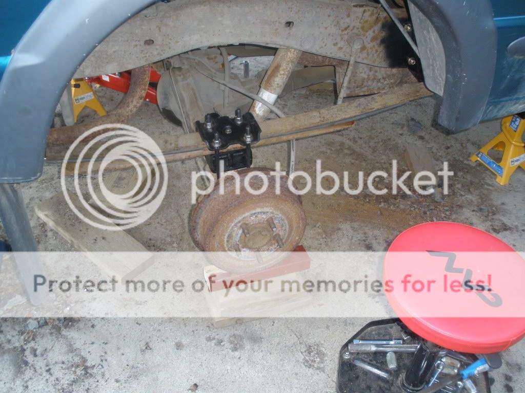

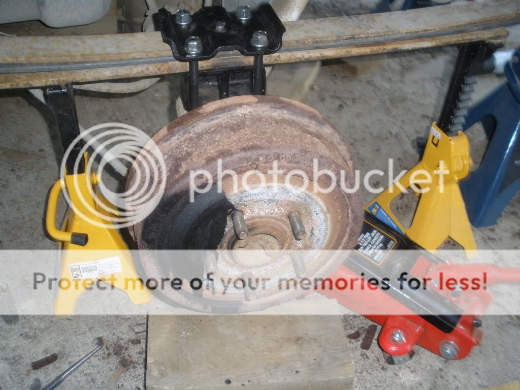

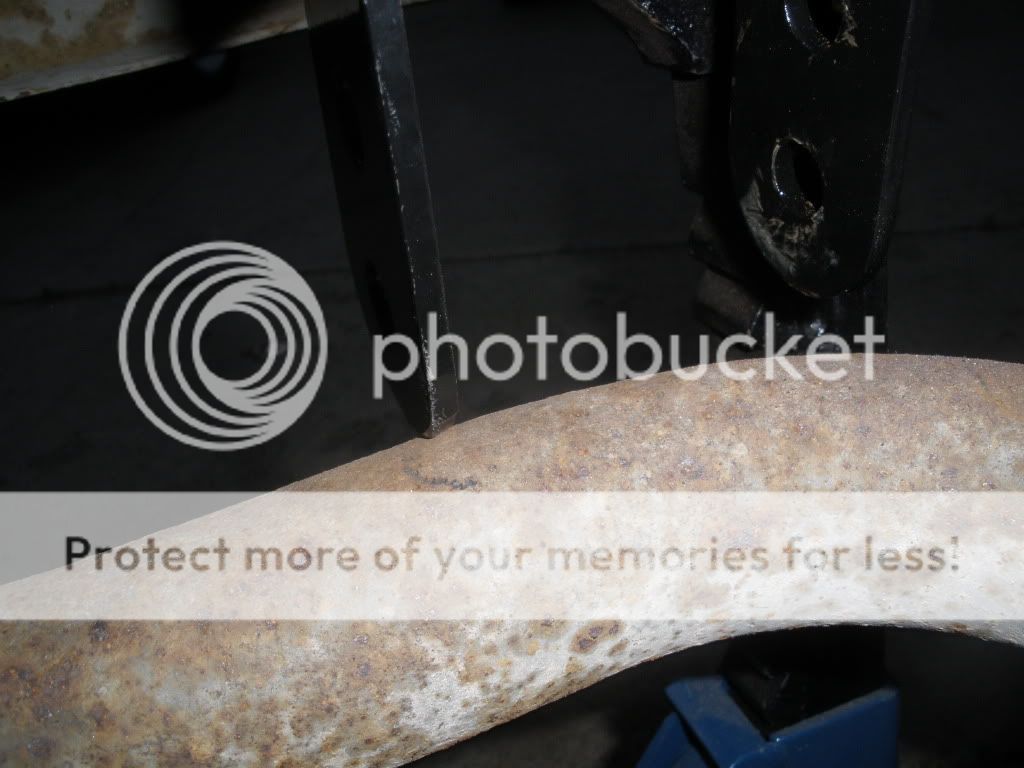

Lining things up.
I thought they would be tighter in the hanger but w/e.

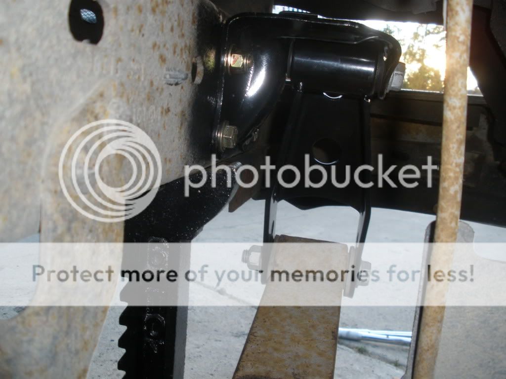

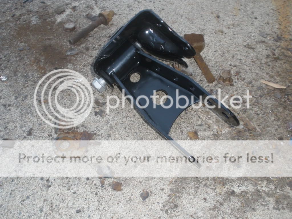

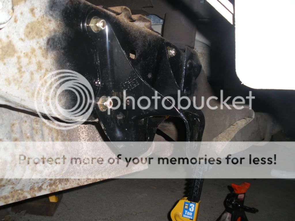

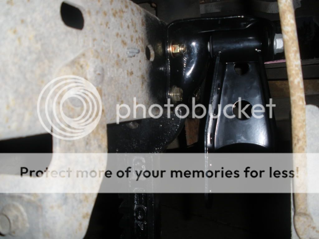

Front hanger on, sure looks pretty. Ended up going with 1" bolts instead of 3/4". I put washers on both sides and it worked perfectly. All except the bottom two on the front hanger due the the crossmember ties in there.
Back hanger on with the shackle hanging in place.

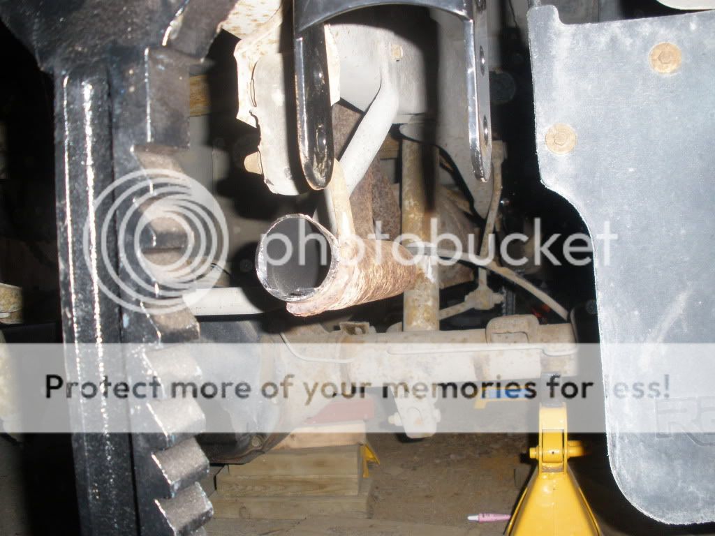

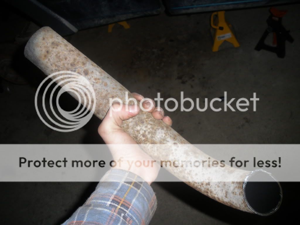

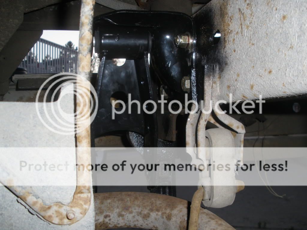

No one warned me about the stupidest fitment issue ever.
SOLUTION!
I'm building a side exit exhaust later on anyways so this it NBD, just happened that cutting it on the bumper side of the hanger was perfect for now.

I noticed the Belltechs tightened up in the hanger once I torqued them to spec.

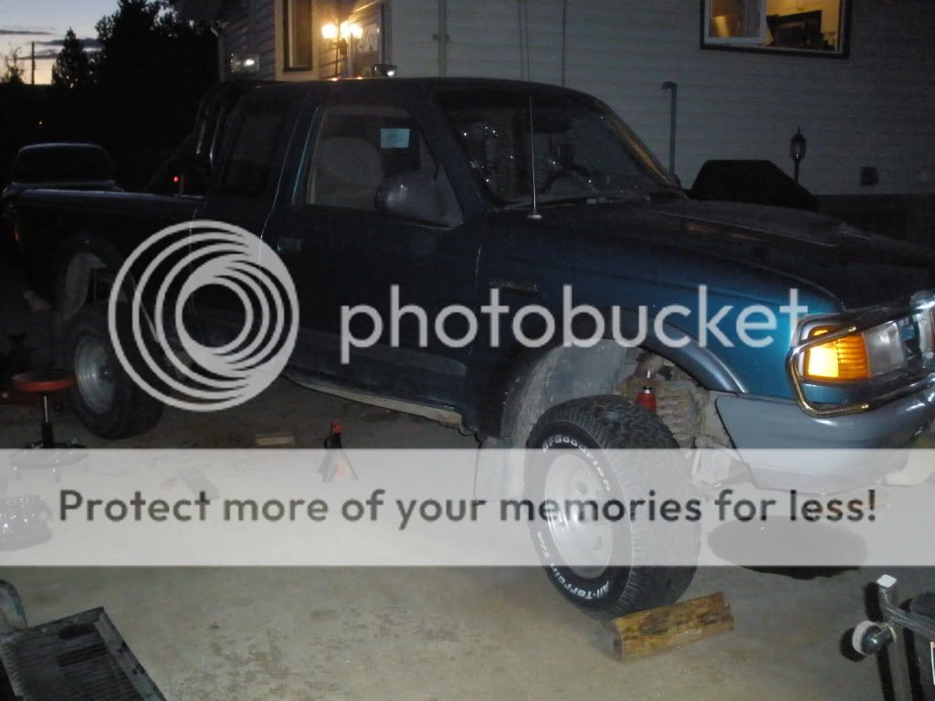

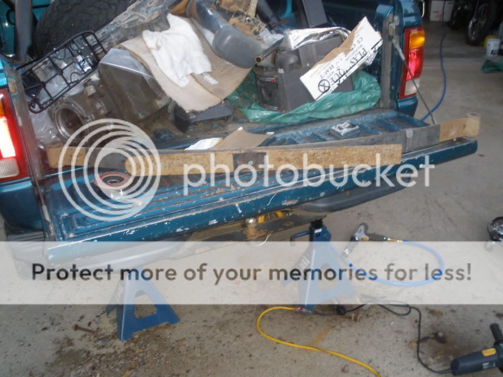

Once I got the tires back on I decided to clean out the bed, what a mess.

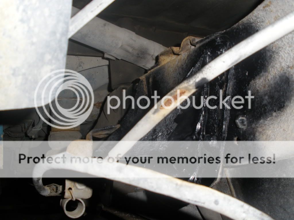

Looks good, will look even better with the tires. That's just a power steering leak, source TBD.

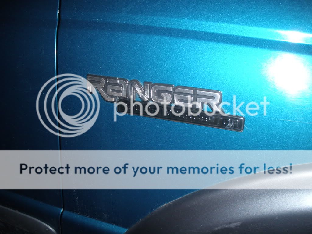

I also got a new badge.
AWW YEAH!
I also got another one for the tailgate, once it's fixed up I'm going to put Ranger on the left side and PI on the right. It should look pretty cool in a funny sort of way.
