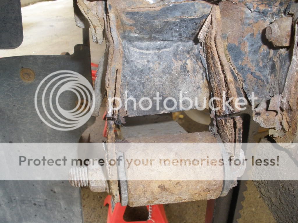

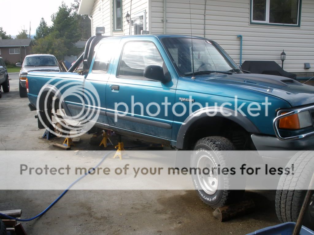

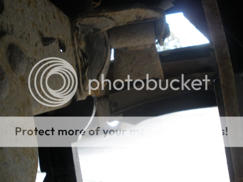

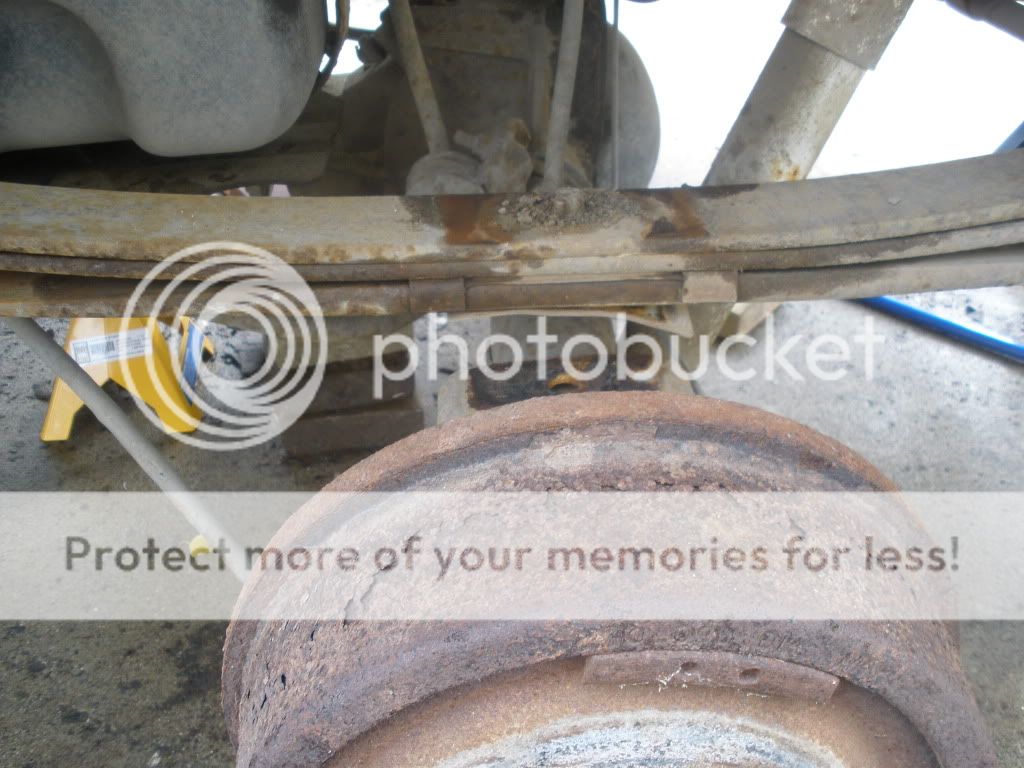

Pics from today. I'm leaving the left front hanger on for now, I don't want to mess around with the gas tank until I get access to a hoist. I'll just clean it and paint it up for the meanwhile.
Had this off before, you can see the break.

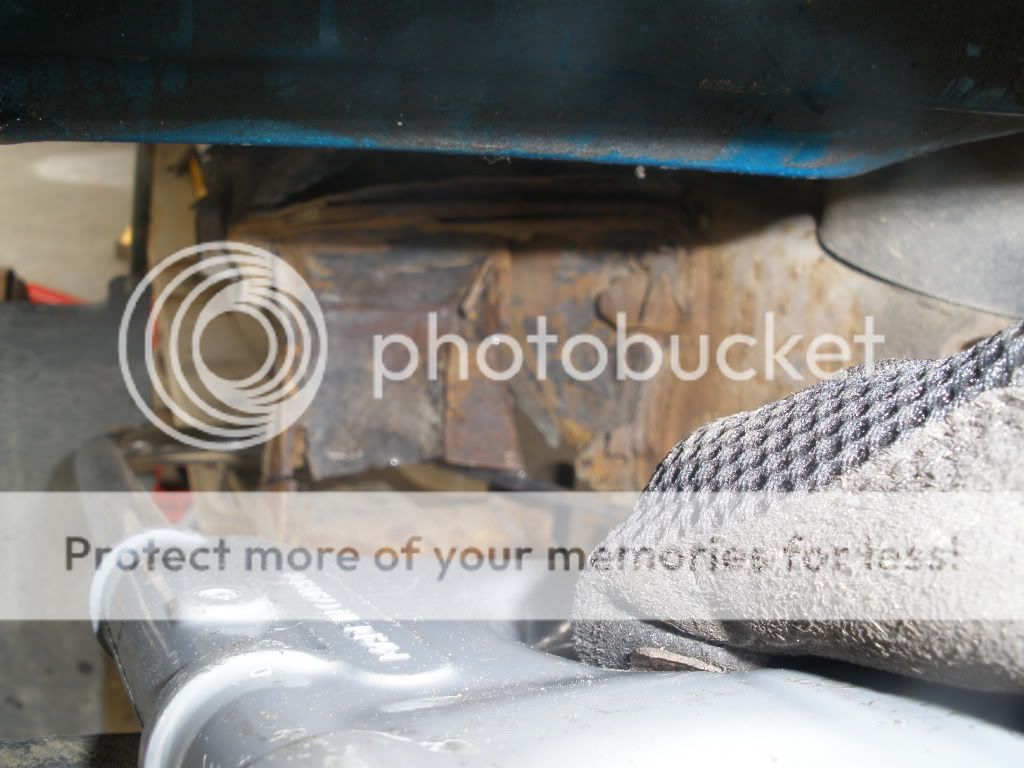

Mike's '93 4x4
Hanger pryed off.
Mike's '93 4x4
That's how I got the backs off:D

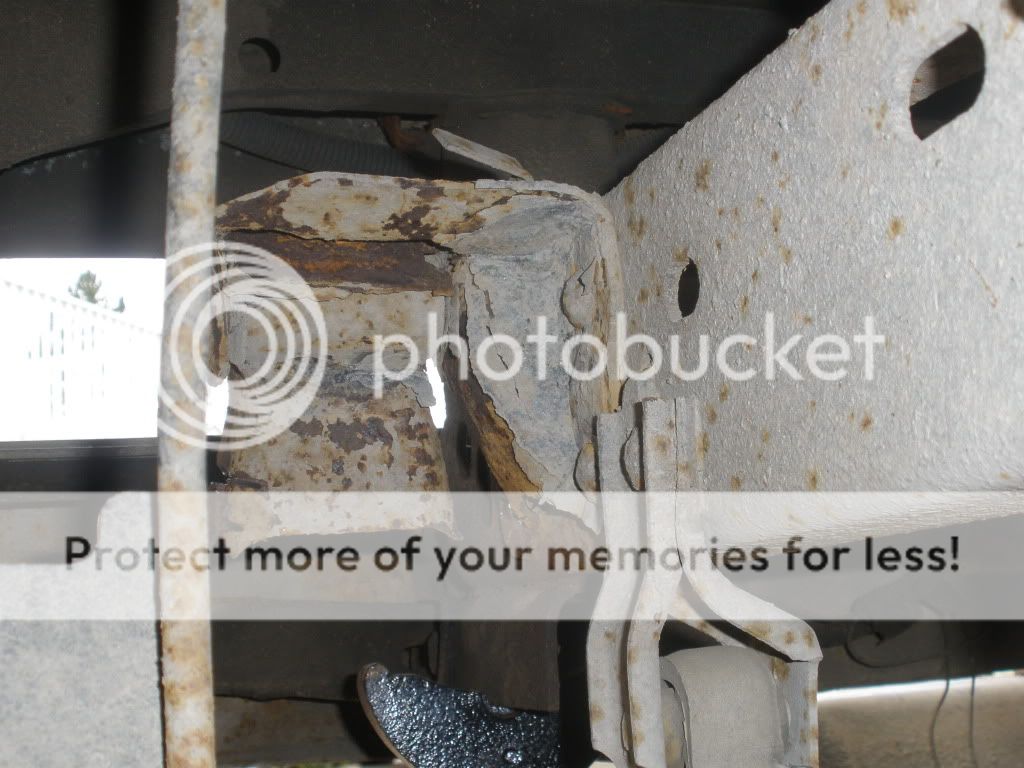

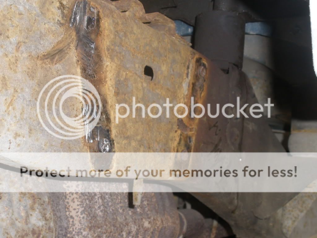

I'm just going to clean this one, it is the best out of all of them.

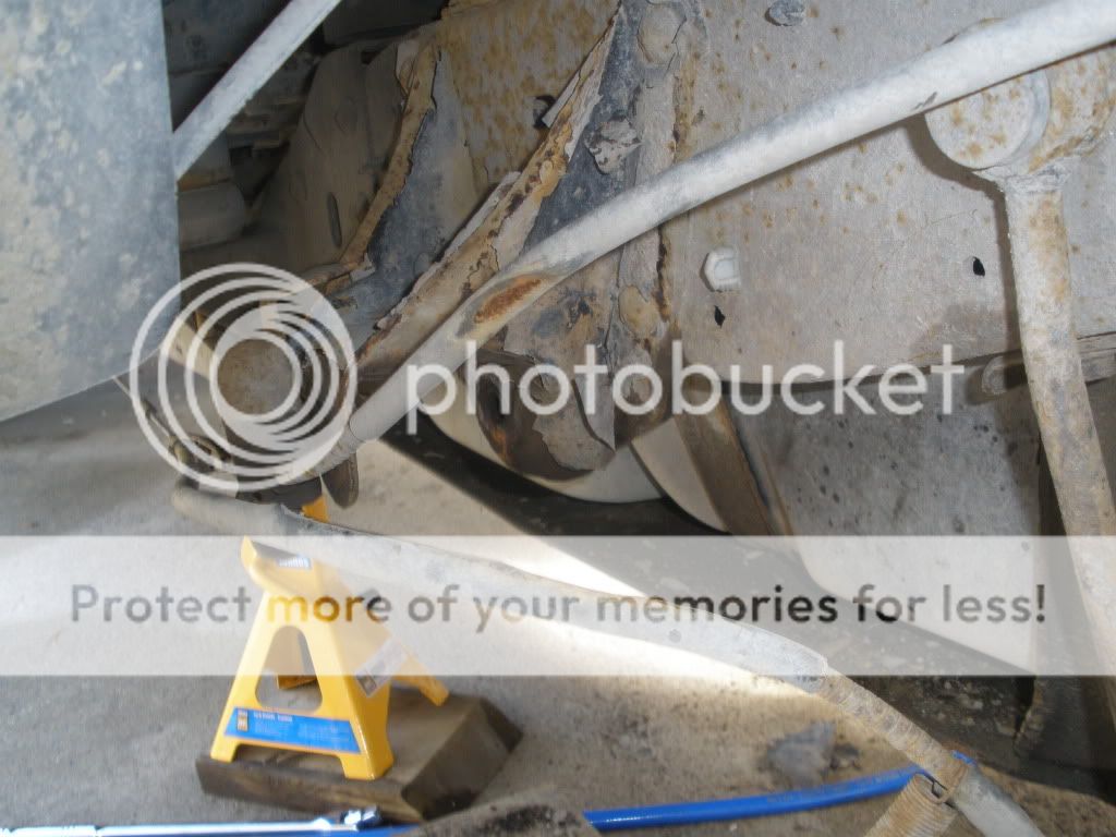

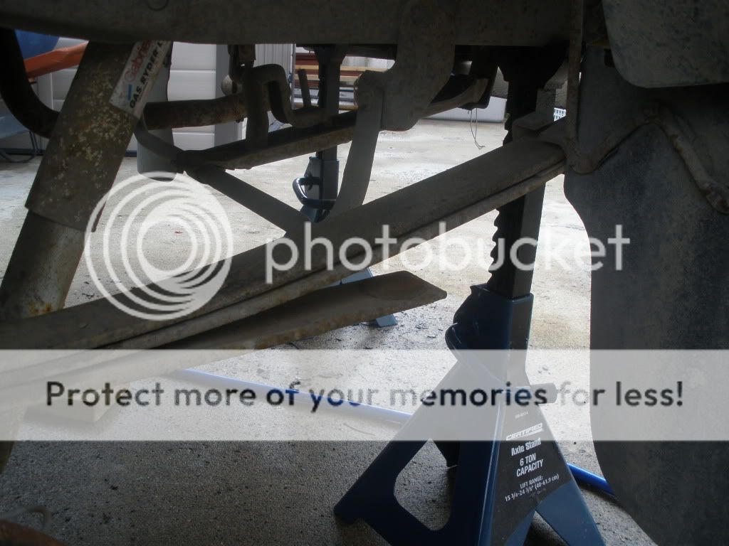

Gotta support the pinion.
Mike's '93 4x4
Mike's '93 4x4
First person wrenching! I had to take the hacksaw apart and put it in the shackle to cut it:icon_rofl:

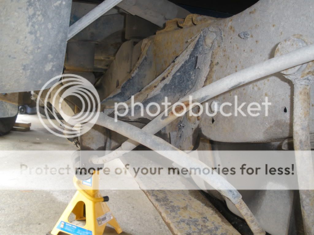

Now what's missing here!
Mike's '93 4x4
Mike's '93 4x4

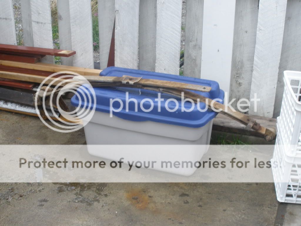

Yes, both are off and ready to be taken to the spring shop!

And multi, I took your advice and bought some steel wool & a can of black rust coat.:headbang:

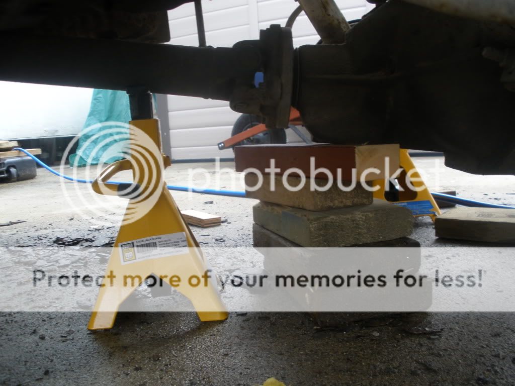

Now there is a setup for flex lol, the way it sits in that last pic there would be some awesome flex
ninja edit: unbolt the shocks too haha
Yeah man, it's called air-flex suspension. It's big with the Duramax guys:icon_rofl:

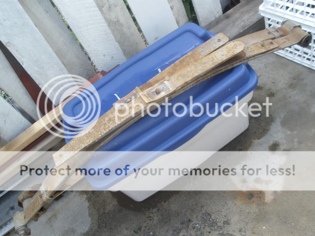

Got the leaf springs dropped off at the spring shop, the guy said they are going to work on them tomorrow:yahoo:
Replacing the middle leaves. One is broken clean across and the other is cracked.

whats the cost on the spring repair?
Nice work by the way.
FrankBoss
I'm anxious to know too. I replaced one of my springs for $52 counting the spring and new hardware, because one of the middle leafs was cracked clean off. I can't see a shop beating that price.
He's charging me $150 for both sides, and he is cutting off the old bolts that are seized in the bushings. Not cheaper that used but a lot cheaper that new and way faster. I've dealt with the shop for the leaves on my other Ranger and they are really good to work with.
$25 a side definitely isn't too bad. Still cheaper than buying a press to get the bushings out.
