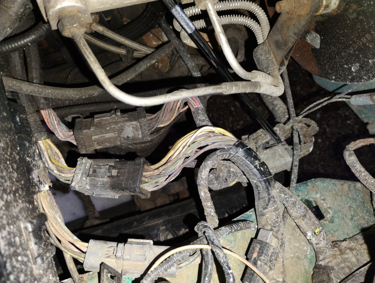

Picture I just took of wiring under my hood.
As you can see in the picture if look close I have no inner fender well on the driver side.
I believe the connector that I need to disconnect is the one I'm using the quarter inch drive extension to point at in the picture. It is being held up with a couple other wires and connectors off of rubbing the tire with a zip tie
There are three connectors in the same vicinity that look very much the same.
In the picture you can see one just underneath the front brake line from the master cylinder and then one right next to it the third one is the one I'm using the extension to point at.
As you can see all the wiring is very dirty.
The next Question I have at this point is what is the best substance to for me to use to clean the wiring off so I can tell the difference in the connectors.
I need to be able to tell the colors of the wires so I can tell which connector has the wire I need.
I currently have some carb cleaner, I also have some electrical wire connector cleaner.
I don't know which would be better to use or should I use brake cleaner or something else?
The next thing I want to address is I'm worried about breaking the connector locking clip on the connector or breaking something else.
I know I need to be careful. I don't want to chance disconnecting the wrong connector and having to worry about breaking something else.
I want to only mess with the right connector the first time and that way I only have to worry about it.
I don't want to use a substance that is really bad for the wires. Can anybody give me any advice?
Clean as best as you can with warm water and soap. Dawn dish detergent should work well. A small paint brush or toothbrush will help get between the wires. If necessary, after it's pretty dry, spray with your electrical contact cleaner as a final cleanup. But you should be able to see the wire colors after soap and water.
My brother I just talked to on the phone who lives in Alaska told me he would use automotive degreaser.
I like the Dawn dishwashing liquid ideal better.

Either should work fine. I figured you probably already have Dawn or something similar. That's worth trying before you go and buy something special.

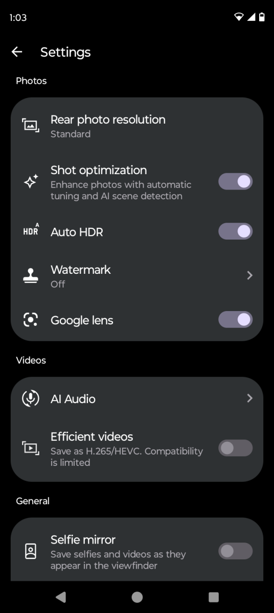

I just turned my camera on and found the settings.
In the video settings where it says Efficient videos.
That looks to be turned off to me. If I turn that on then retake my video should I then be able to upload it in a post?
I don't understand why I can't add a video.
I've turned all the settings off on my camera.
And I even put it on the settings that looks like a flower 🌼. Nothing seems to be working.
