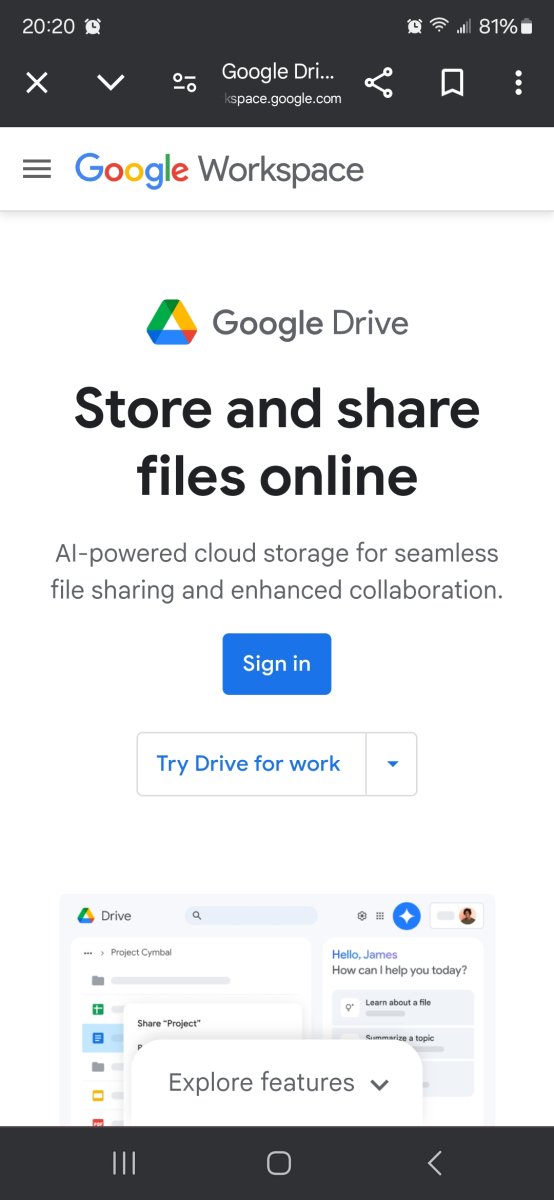

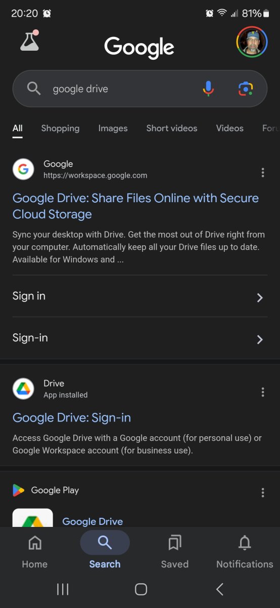

You should have 15gb of drive space for email, photos and drive space for other files.
Type Google drive into your search bar. Hopefully, you'll see results like this.
Click on that first result and you should see something like this
Sign in with the same username and password that you use for Gmail. Then follow the instructions and play around with it. There is also a Google drive app you can download from Playstore.
