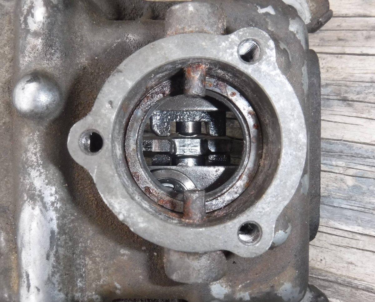

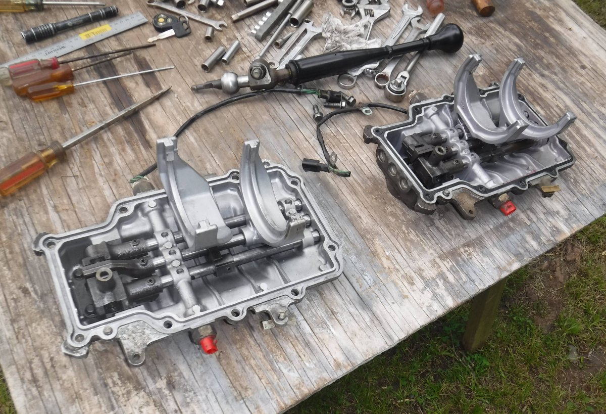

Wait, both shifter housings are in first but you're stabbing the shifter in the neutral location because the side pressure spring deal won't let you get the shifter in the first location, you might need to pry that pushrod deal over to get the shifter in there before the detents will release to let you move it? never taken that part apart since it's complicated and nothing generally wears out... That's likely your problem, you need to get the shifter into the gear the assembly is in...
And this here is the exact reason you only pull the shifter out in neutral! There's ball bearings that limit the shifter so it physically will not go into more than one gear.

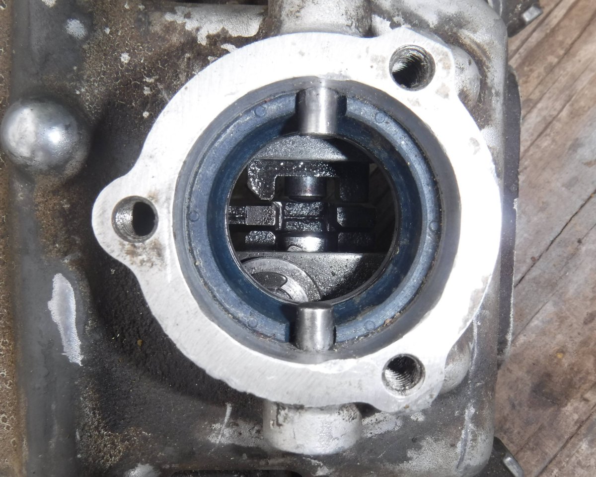

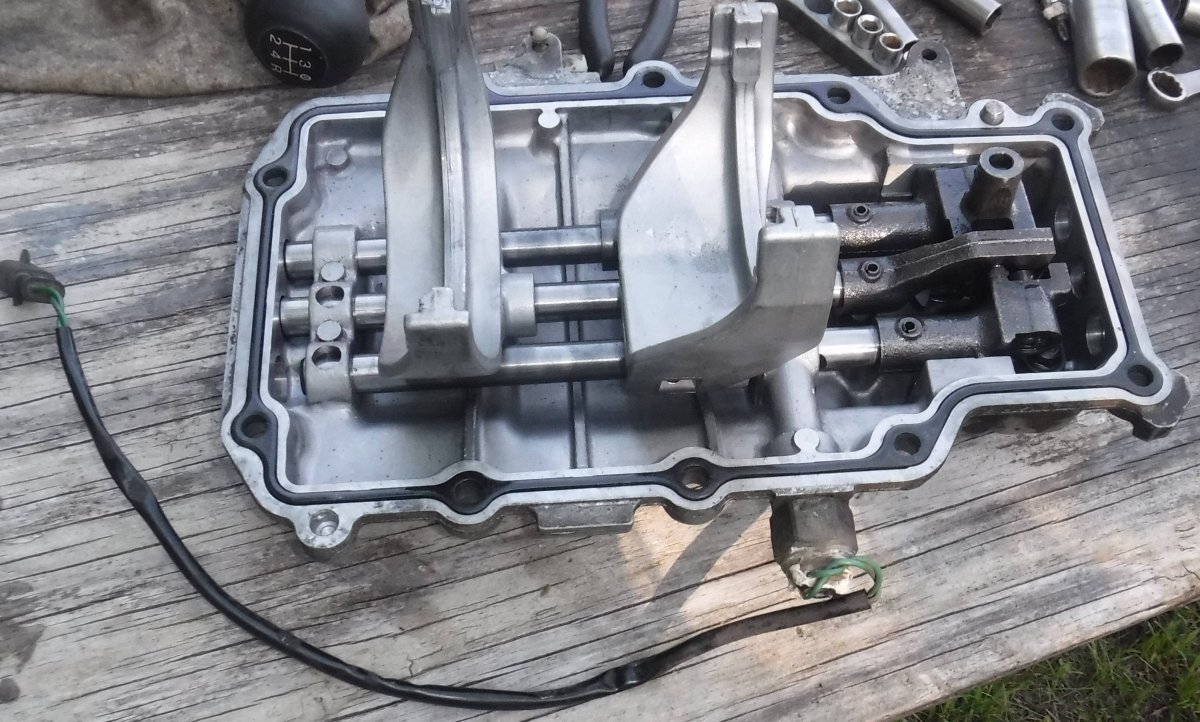

Look at the gap where the shifter stub goes in, both of those shiny round things should be pointing toward eachother with the gap in the middle, one is slid one direction. You need to either get the shifter stub to go in that one that's not lined up or get the shifter housing shifted back to neutral.
Got it in 1st, is that ready to go there?

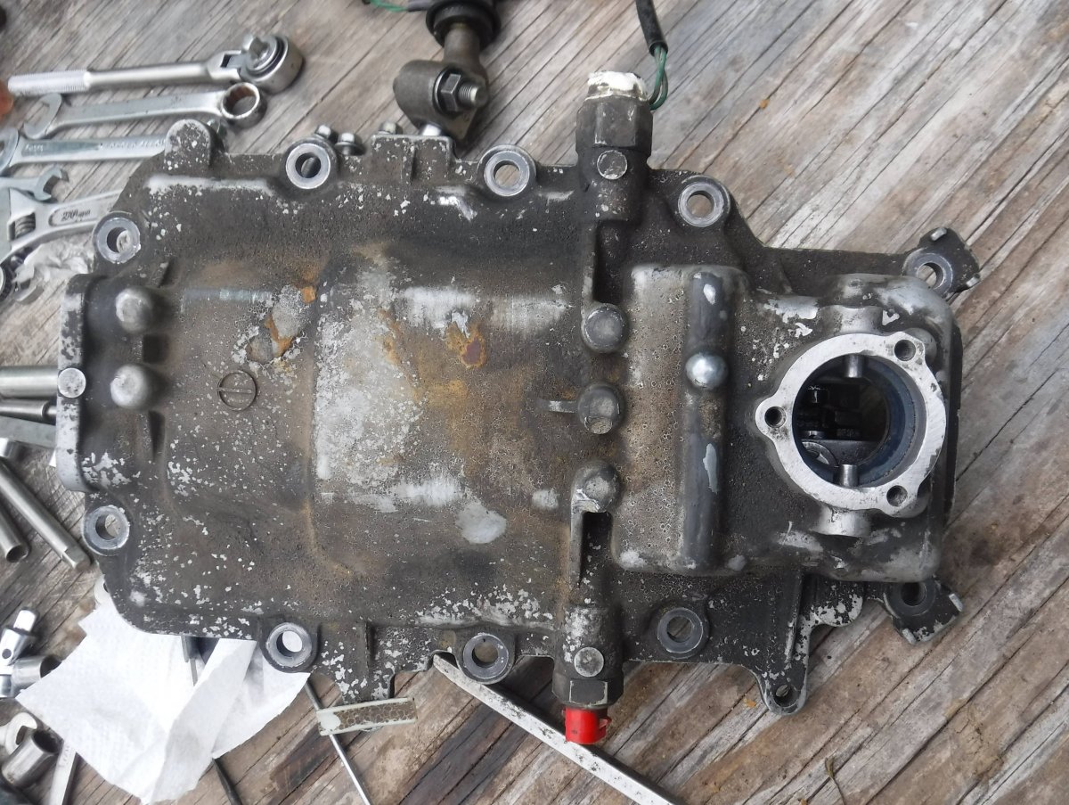

Did this one too

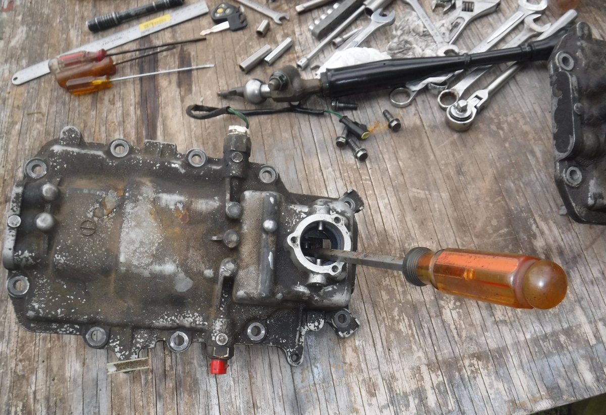

This was the weapon of choice, just push the button and slide it as you will

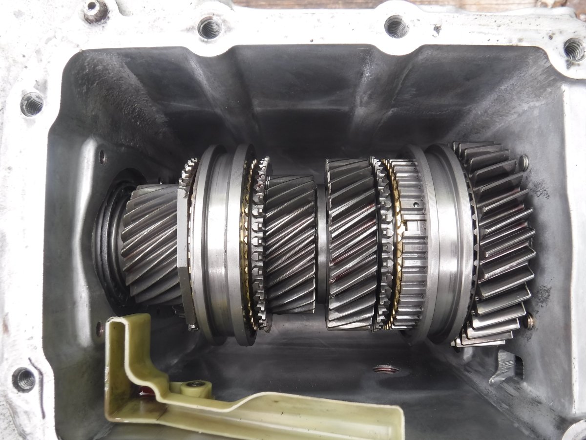

Make sure you move the slider on the transmission to the middle of it's travel too, then you're ready to go back together
The slider on the transmission? Scott, I definitely appreciate you getting me out of the rut here, it has been a very long two weeks here, including one of procedures and 2 days R&R. My nephews coming tomorrow to help with the lifting and I'm hoping get this done. Is the Transmission slider on the covers flip side? Or is it down that same hole?

Yes, on the transmission itself, the one in the rear on the pictures you've posted, just with your fingers slide it forward, it should look similar to the other one where it's centered in the splined hub, that will free it up and put it in neutral so you can put the top cover on.
Conveniently I'm pretty fresh on the M5OD inner workings, and your pictures told the story once I saw what they were telling :)

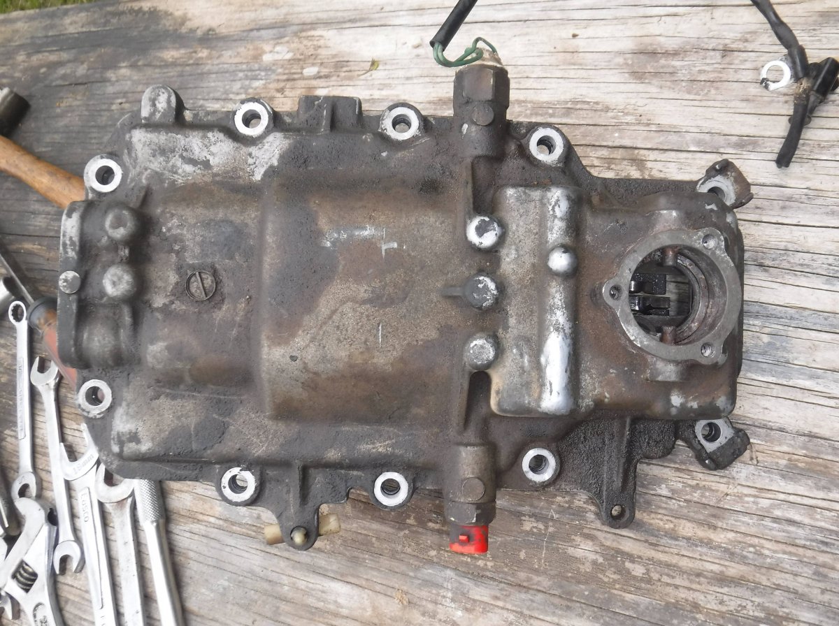

So how close is this one?
Move the slider from the red arrow to the green arrow:

Yes, that's what I was trying to explain... was getting late and my internet sucks...
