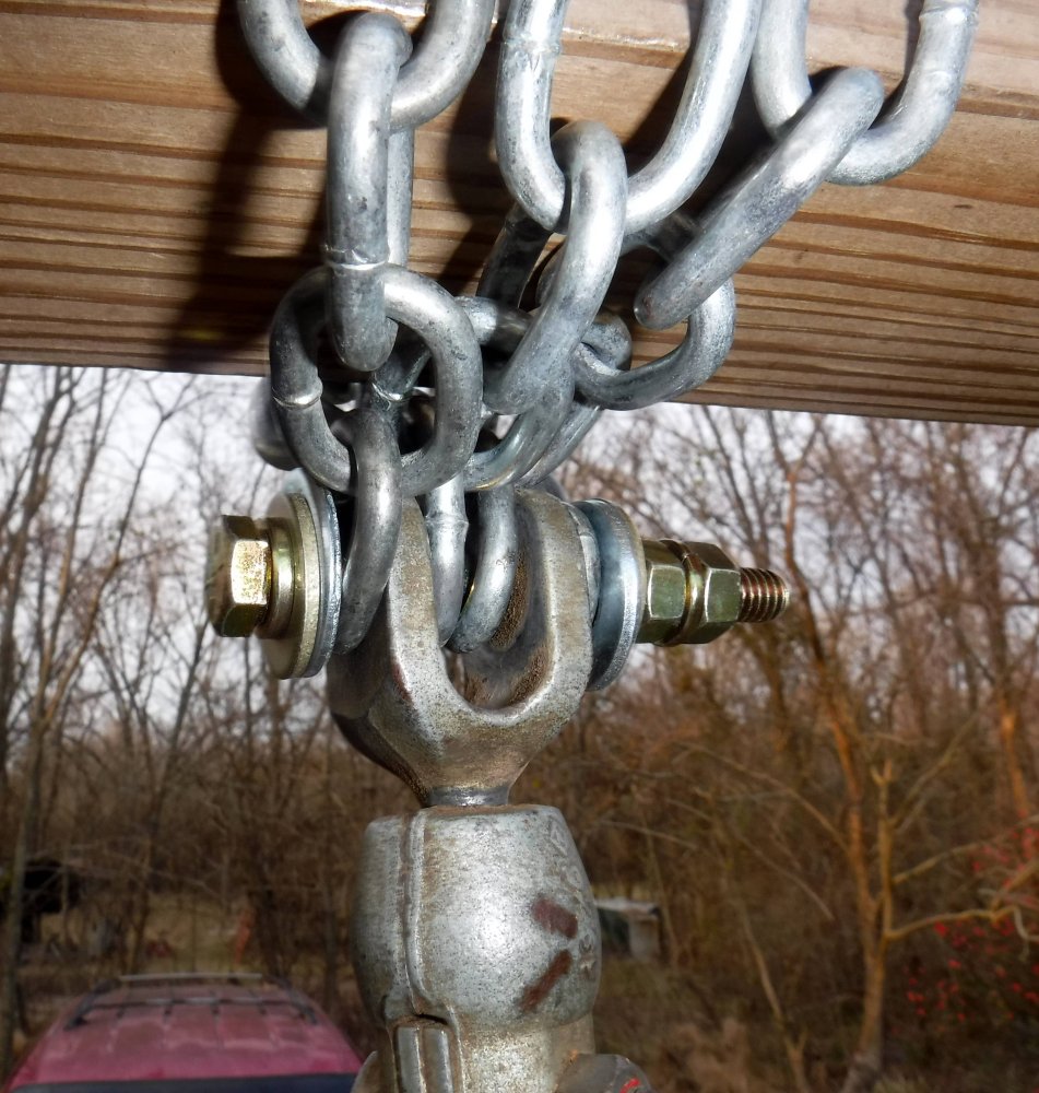

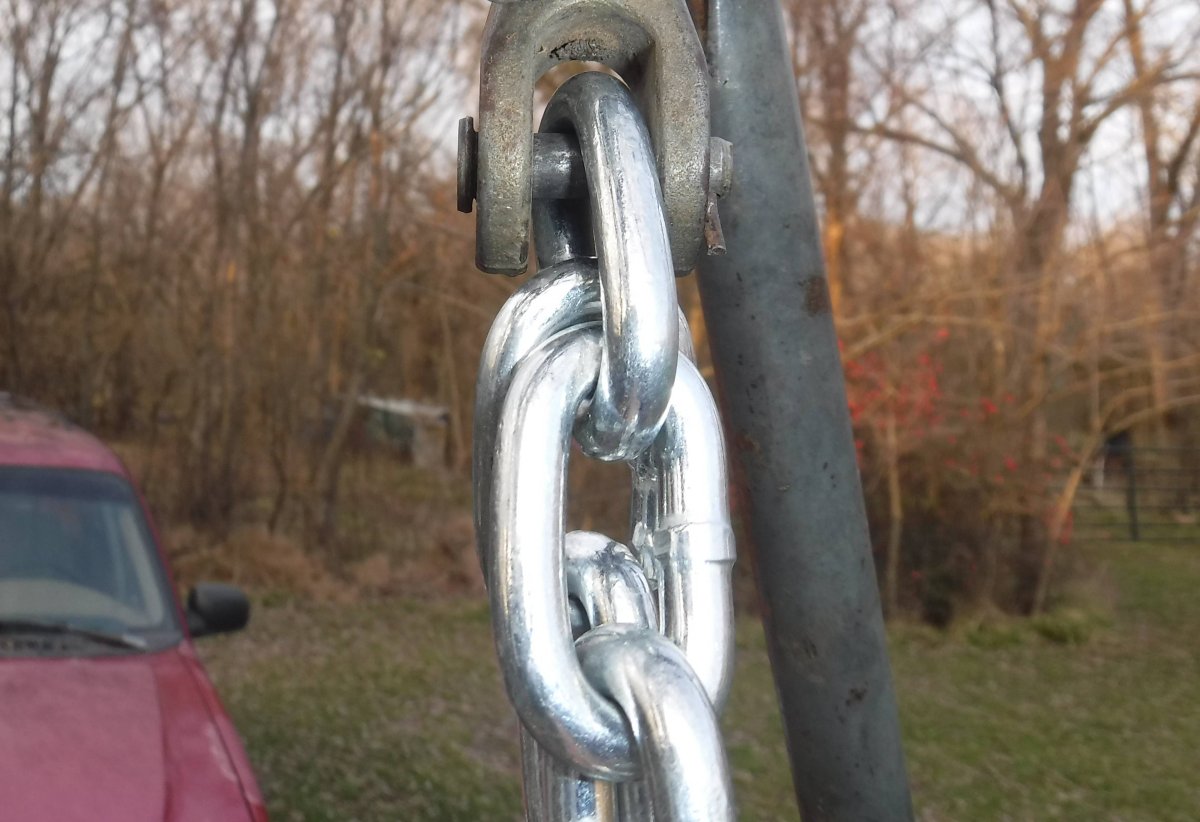

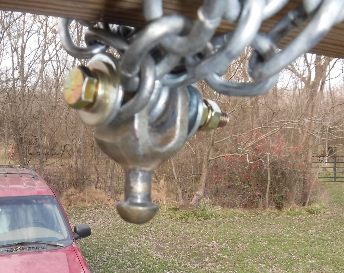

About got the hoist rig figured out best I could, but still need to check it along the way. The lift chain I got first is serious overkill but it will work ok. I took a hook off the come along and put the chain link right into its place.
Going full circle
Took the hook off the top also and rigged a grade 8 bolt through it all to allow two full loops on top. It was very tricky putting that puzzle together but it came together in a way all links are equally absorbing the weight. Figuring 500 pounds that's 125 on each end, with the 4 ends creating 2 full loops, leaving one as a backup if anything did go wrong with the other.

After getting that puzzle together I wasn't going to take it apart before I'm done with it, so I took the come along apart to take it down. I have seen the inside of one of these swivels before but it was likely on one that had busted, I have a bit more confidence in this one when it's put back together

I like your engine lift built one like it 3 ish years ago I got a chain off a old tow truck rapped around the top, my come along has a hook so I just take it off when not in use. it's still sitting in front of my garage have pulled 7 engines with it just tighten the lag bolts before every use. if you check my 4.6 ranger build out you can see it in action

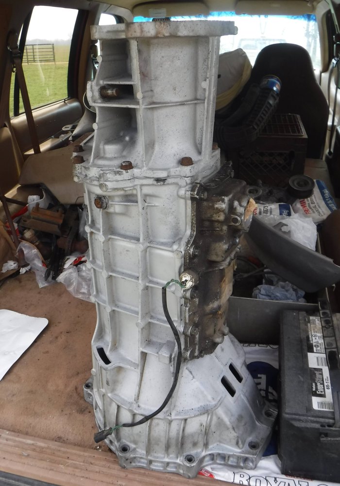

Got the transmission ready, my cousins son put a new main shaft in it. Great fella, he works at the Ford shop too. That's the original shifter on it
