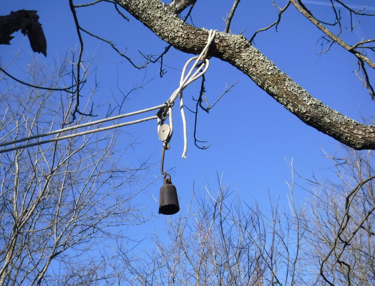

I started putting me a little engine hoist together today also.
  • Going full circle
  • Going full circle
  • Going full circle
You couldn't pay me enough to get under that
I won't be totally dependent on that, it's just enough support to help me get the cross beam attached on the sides. It held me up so I'm fairly certain it can hold 30 lbs a little while, and I won't much be under it anyway
Sorry if I worried you fella's ;)
I had hoped to get it done today but the winds 30+ all day long. Took a little walk in the woods and it sound like a constant jet roar. I think it will let up some tomorrow and Tuesday and be much more conducive to joinery
What engine you pulling that weighs 30 lbs.?
I'm going to build an "A" frame under there, the cross-member weighs about 30 pounds
I can lift it up and tie it off and join it to the two uprights there.
My plan is to pull the Ranger engine, get it out of the way, pull the Explorer under there and pull that engine, leave that engine on the hoist, pull the Explorer back and the Ranger in there and slip the motor down into the Ranger

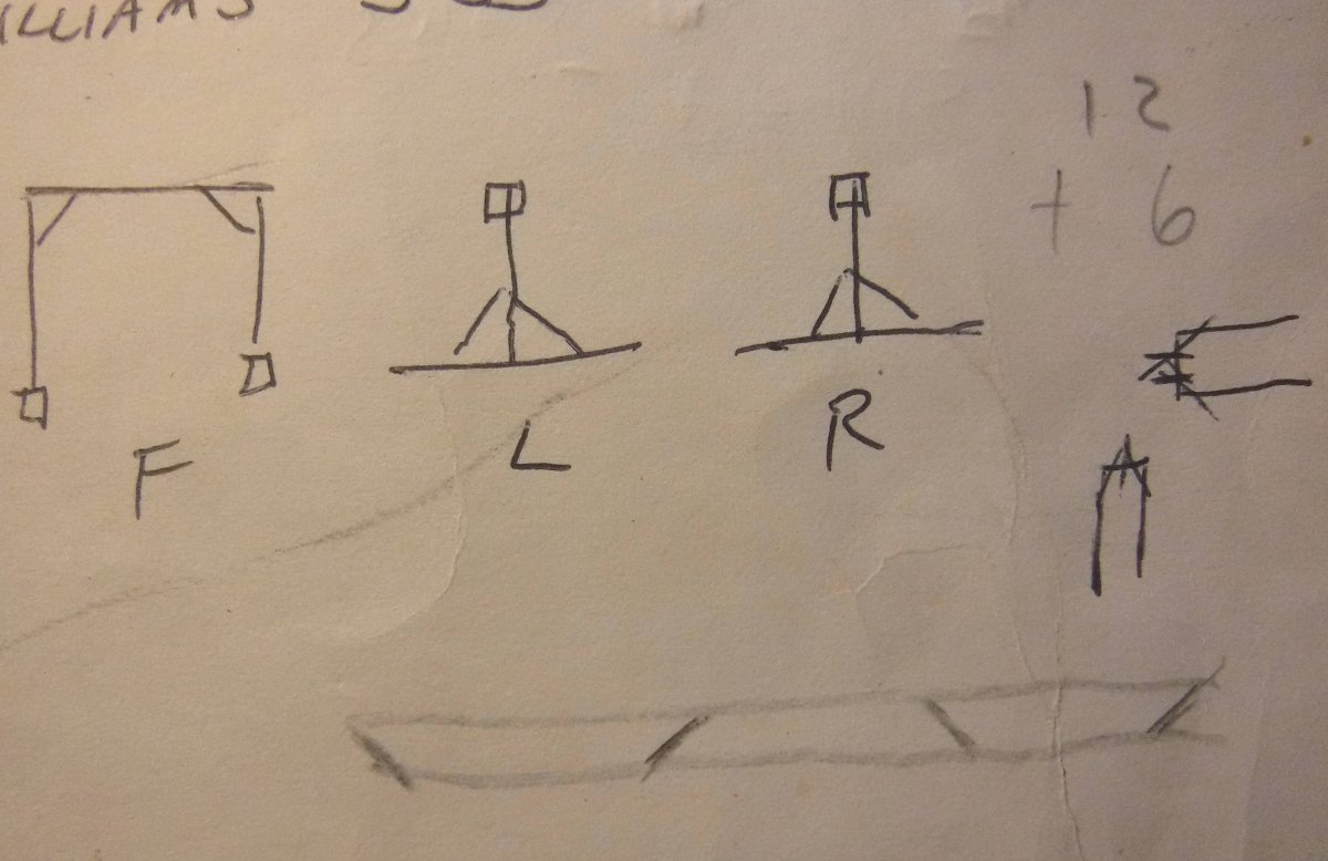

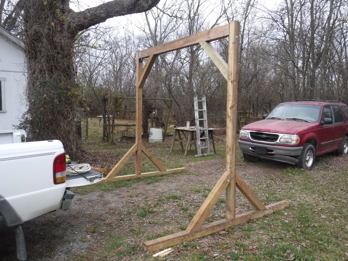

I received request for info on the engine hoist I built so decided to paste it here too. I never drew a plan, and the only figuring I did was on the 2 4x4 I cut the 6 corner braces from, the 2 center ones were a bit shorter and were used on the top corners
Guess I did scribble up a plan, on a 3x5 note card. I have actually drawn plans for high rise office buildings using scribbles on a torn brown paper bag no more complicated than this, and used the brown paper bag to confirm any questions later in the process
Going full circle
I bought the wood, ALL Fully ground treated lumber, for that just as the pandemic was crashing down, and Home Depot hadn't yet gotten into the materials famine they would experience the next couple of years, so the prices weren't so bad. I had also picked up several bags of torx screws of assorted sizes, and a small number of hex head lag bolts, which I eventually had to replenish but the prices still weren't so bad
I used 6 8ft 4x4 and one 8ft 4x6 plus 2 metal corner angles with through bolts for the top corners.
They were stacked there so long the 4x4 had (i stack them perfectly straight, anyone who has worked long with wood will always do so) bent a bit so I picked the straightest ones and used the two crookedest ones for the corner braces, which numbered 6. 2 on each side of the 2 uprights and 2 on each end of the 4x6 cross-member.
I had the Ryobi power tool set which had an impact driver AND a regular drill/driver. The impact was necessary for driving most of the hex screws and lag bolts.
It was actually rather easy to build, and used some long, 10 or 12ft 2x4/ 2x6/whatever for base cross bracing to drag it around a bit to go just where it needed to go. I used a regular flat bar to pry up the base beams and put dirt underneath for leveling it somewhat.
I used a 7 1/4 power circular saw (my ancient Ryobi 10" miter saw on/off switch had just gone dead) to cut the 2 4x4 into 6 braces with 45 degree corners. I layed/marked out the two end ones on each 4x4 which left the two middle ones being equally shorter by a couple inches, so I used the two short ones on the top sides
It really was not difficult, complicated, or a lengthy process but if you build it you own it ;)

Wew!!! First started reading this, thought you were lifting engine with a tree limb; that Frame looks good & stout.
Consider putting crossbeam on top of the 2 column posts, instead of bolted on the inside;
would make Frame even stronger & lessen chance of shearing those bolts with a heavy load.
I'm afraid that's all it's going to get besides a couple metal straps up the side and across the top, maybe a foot each way and fastened down with heavy hex screws.
I just didn't have much luck with my closest Home Depot, only other options are local places which I did check but not much there either.
After several times through there they just didn't stock anything for joinery over a 2x6 I guess, and that was just hurricane strips. The only thing I found for a 4-by was a 4x4 post top to a 4x top rail, so I was pretty much left to do what I could with what I could find, and you won't get no help in there :/
I think there is plenty with what it's going to have to keep it from starting, and if it starts Ima' get out the way!
