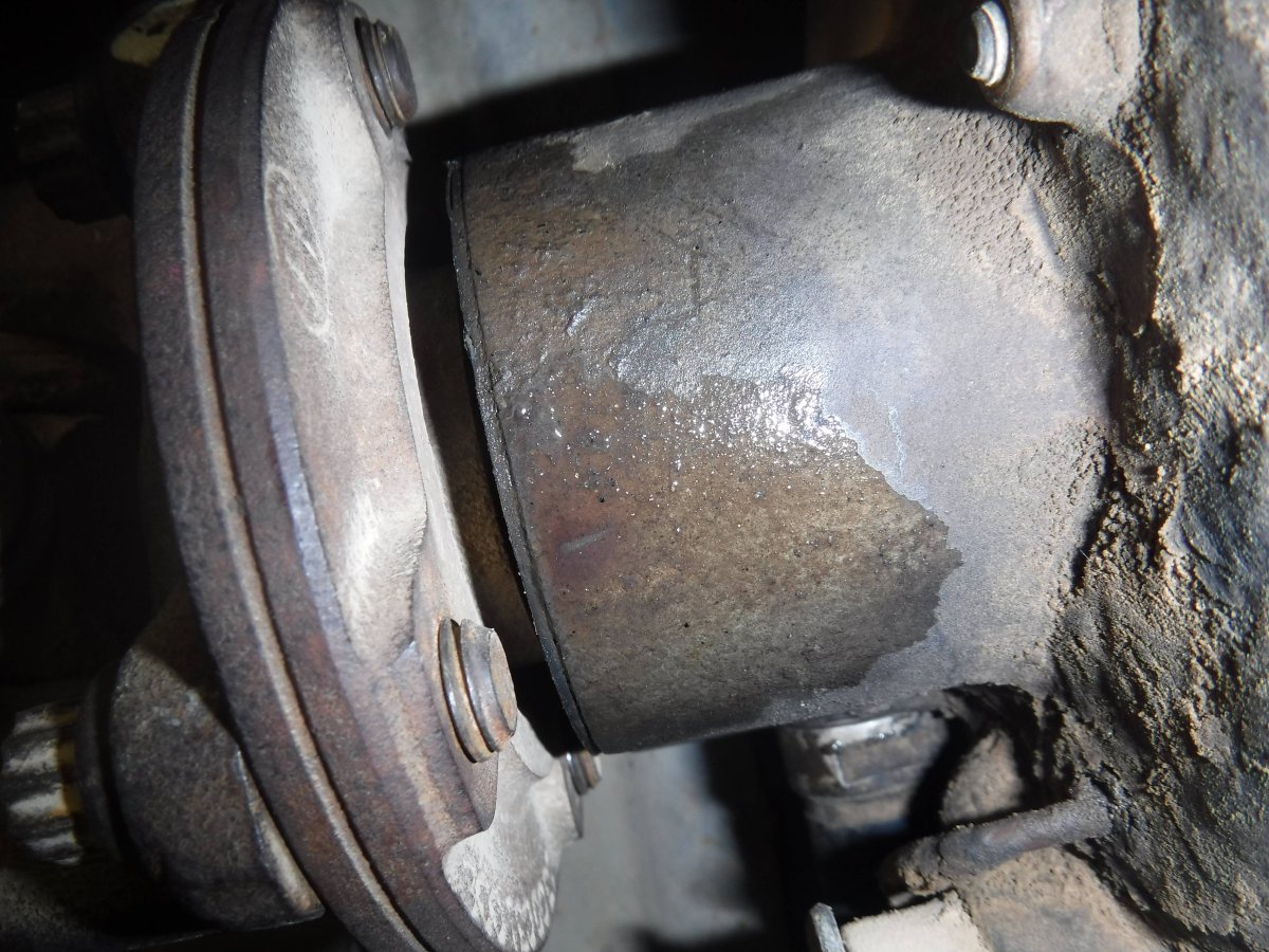

First I topped up the ATF in the TC, it took a good bit of a 5.5 oz STP bottled I emptied into the tank to get the bottle. Noticed a leak on the rear TC seal

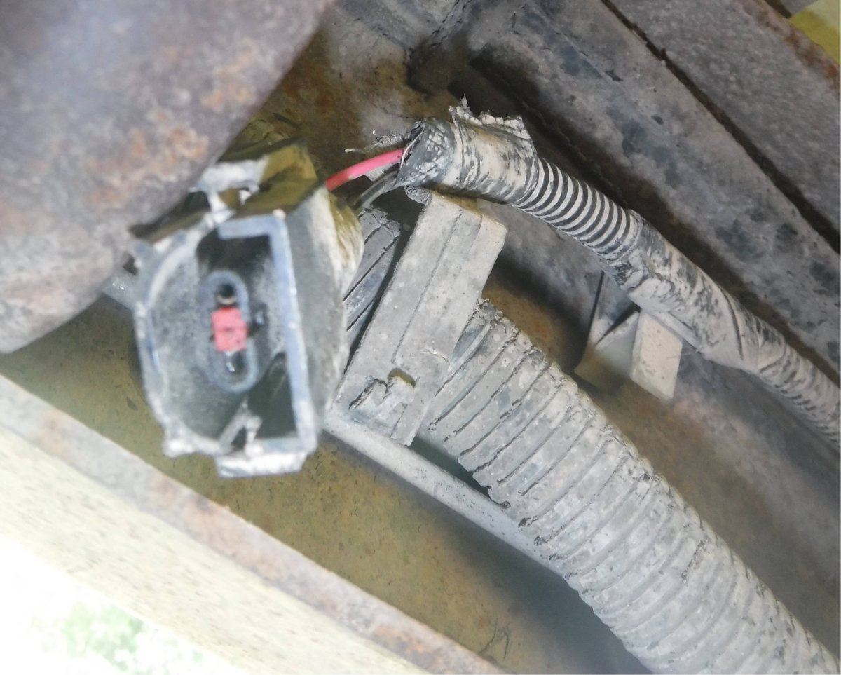

Also a loose connector here, I don't recall where it went, I think over the top somewhere, or right around the Speedo and TC motor

Anybody drop a clue where this thing plugs up? It could be anywhere from front of the gas tand to top of the engine I suppose, but it seems to be comfortable right around the transfer case, just everything I know of there is plugged up and working
Going full circle
Do your backup lights work? If not, that's the reverse switch on the top of the shifter housing.
I checked that Scott, I'm not positive, it was daylight, but the white lights in the middle were on. It was running in reverse with lights on, I shut it off, and turned the key back on to get out and check it
There are two connectors on top sides of the shift cover, today I know I looked at the one on passenger side. I've got a few glitches still to patch up in there yet. I believe most of my connectors in there hook up to the transfer case or shift cover
My speedometer cable is just stuck in there, I haven't yet located the clip and screw that hold it in there, might have to scavenge one off the Explorer, if it even has that type just crossed my mind
Does, or did, the truck have a factory cruise control? There would have been a speed signal generator that plugged into the tranny (or TC I presume on 4WD), that the speedometer cable plugged into. It has a 2-pin connector.
I've pulled the transmission on that 4 or 5 times and don't recall ever having anything left over, excepting plenty of my absent mindedness.
I've had a long week or three and maybe take another look tomorrow. I have another M50D I can check the plugs on, or track this wire as far as possible and see where it comes from. I'll do that over the weekend sometimes.
I do appreciate you fella's trying to help

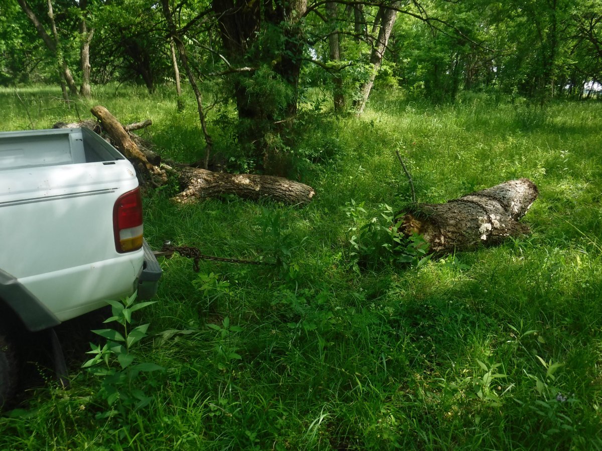

In other news, the transmission is doing fairly well. I had a tree blew over in a storm a few weeks back and am just now getting it cleared up a bit. The biggest part of it kept me from getting to most of it, but after a neighbor helped pull the main part of it out of the way I spent Thursday dragging the rest with the truck.

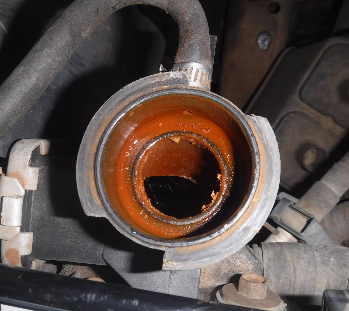

I checked my radiator and found this

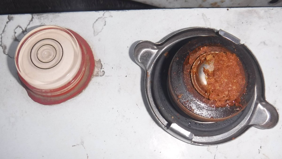

That's the way I check how level it is
The oil looks ok
I've got to make a hundred mile trip tomorrow and that;s what I'm going in :/
The radiator should be completely full of coolant up to the top there where the cap goes, with the overflow bottle system it's way different than the 60's when there was a line a couple inches down the radiator and a puke hose that just went out of the radiator. The expansion and contraction of the coolant based on temperature constantly keeps the radiator full of coolant reducing the pressure and some of the explosive nature of the system... plus the environmental concerns... I always just wing it, take the cap off cold make sure it's full to the brim then make sure there's an inch or so in the bottle cold and it's good to go...
What made it red and caused that corrosion on the cap?
