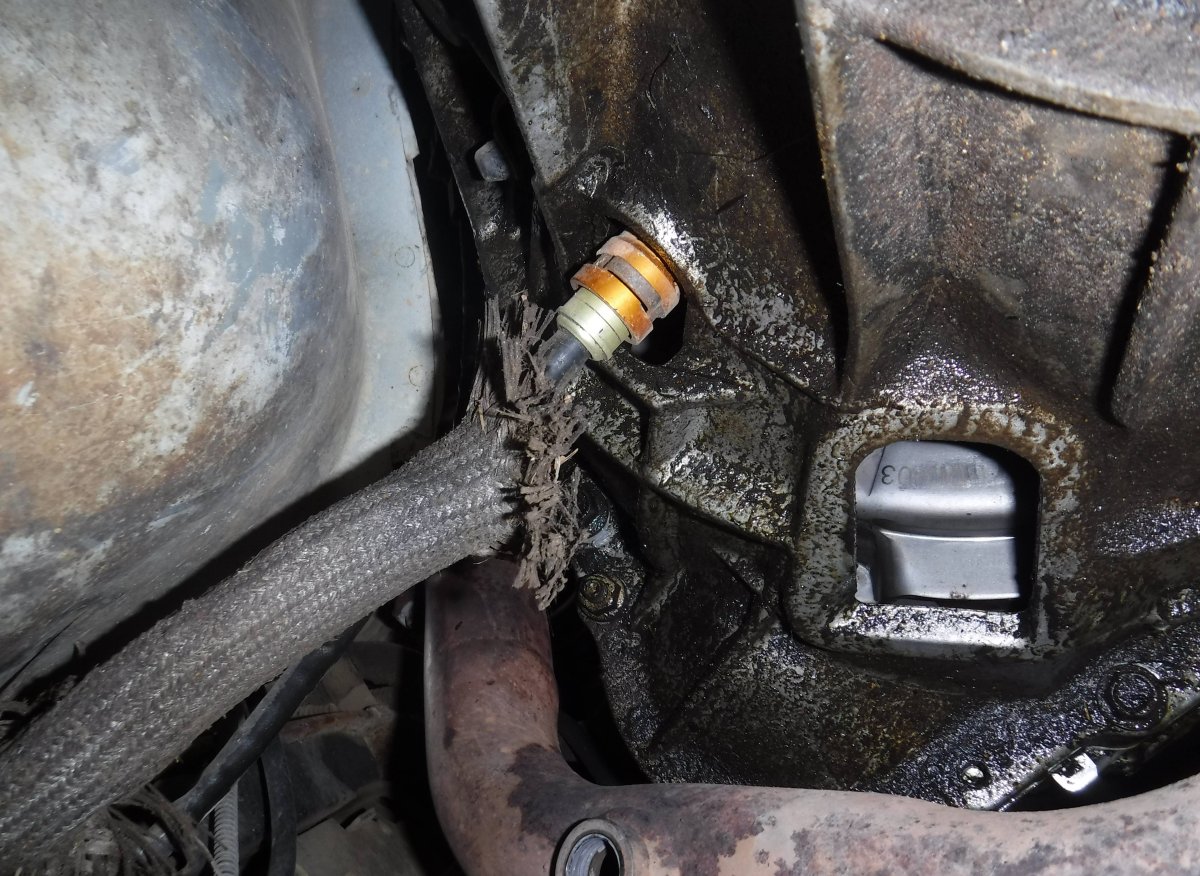

I looked under the truck and saw an oil drip on the transmission, it looked clear

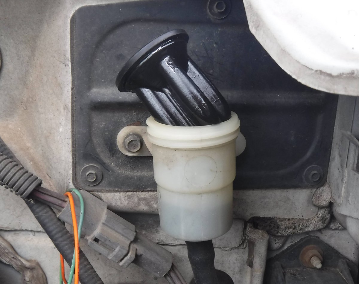

I understand having to watch the expenses. If I was going to do just a slave cylinder, I would try hard to find a pre-filled one, OR, just go ahead and bite the bullet, and pull the master cylinder so that I could bench-bleed the pair, then reinstall the original master along with the new slave.
First time I did a clutch on one of mine, I like to have never got the damn thing bled (it was pre-TRS). Once an air bubble gets up into that backwards-sloped master, it's hell to get out.

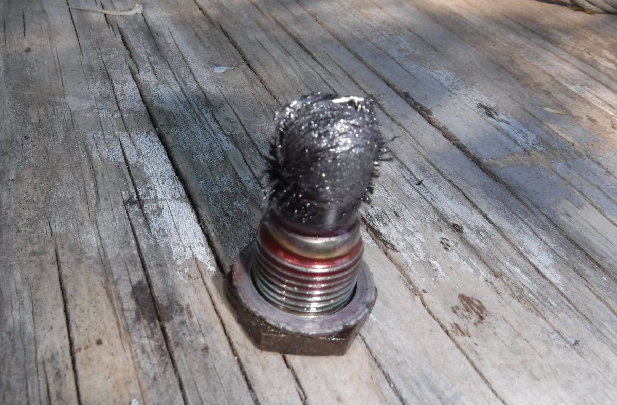

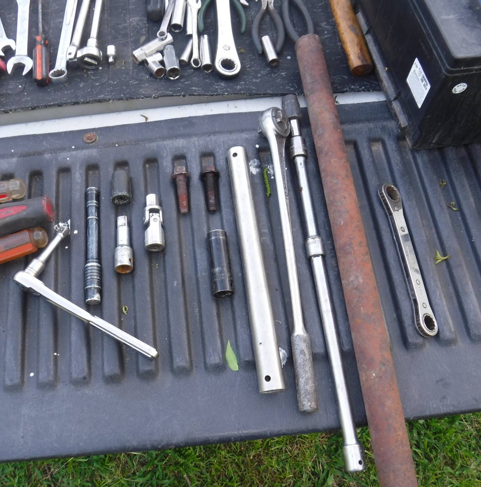

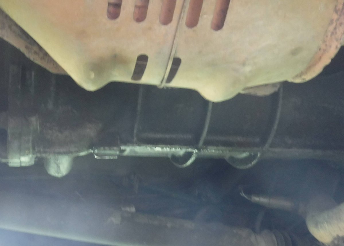

I got under the Explorer yesterday to see what the exhaust may have in store. Hit it wit somePB a couple hours earlier and used an impact but it didn't do much. Then took the long Williams rachet and a cheater and they commenced to twisting right off, after 28 years. It put a strain on me but it got done

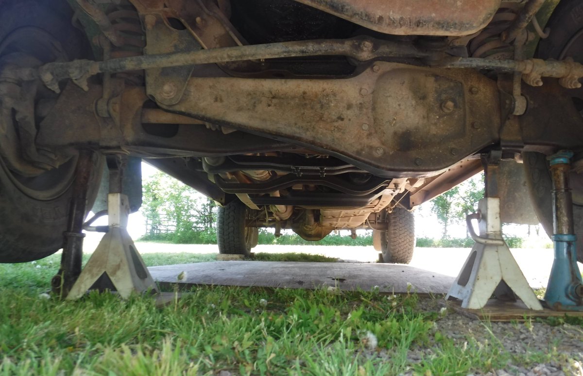

Carried my garage floor out here. Two jacks and two jack stands each bearing weight.

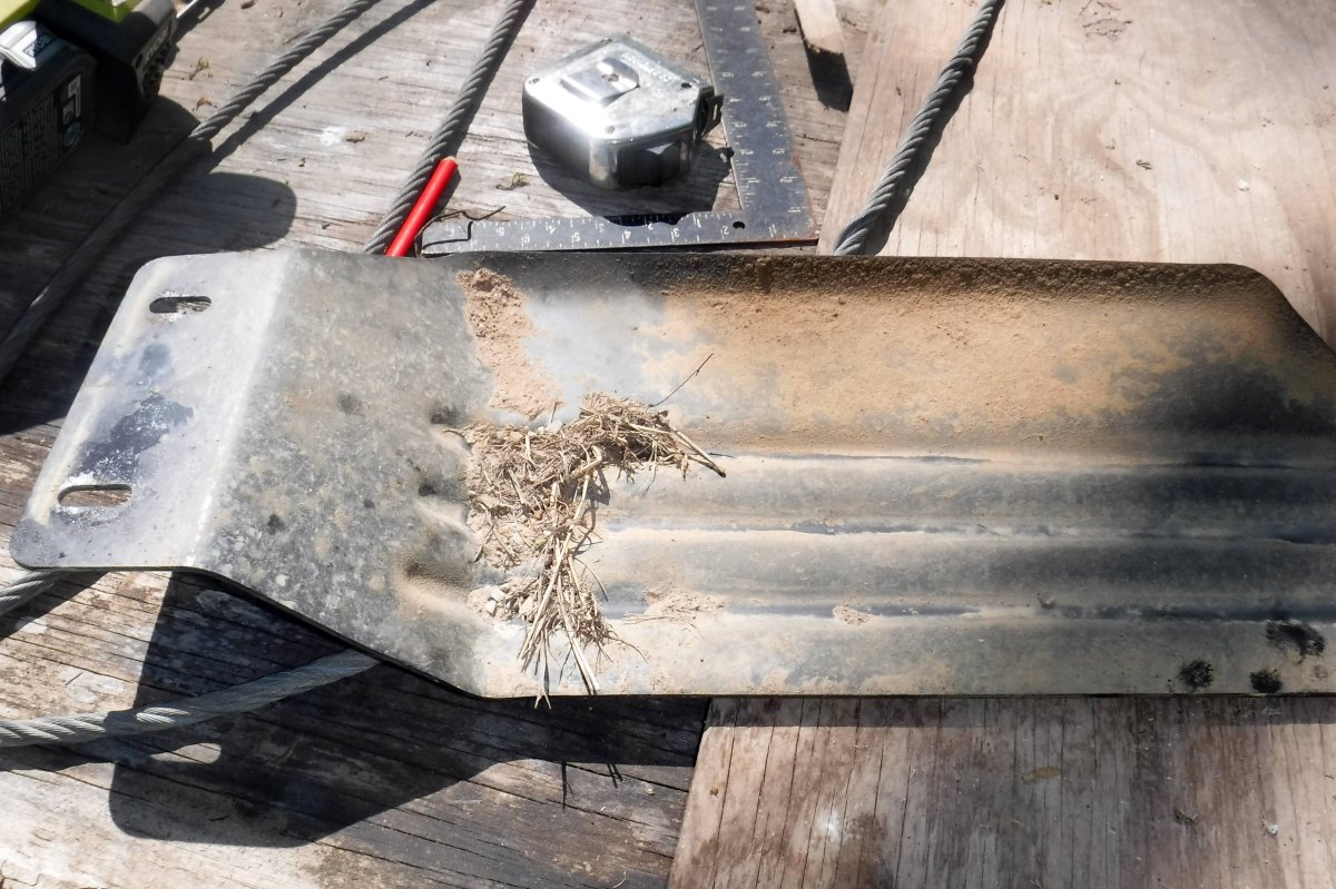

I cleaned most of that out but still some there over a month later. I picked up that grass on a four lane divided US Highway jst after dark on a very stormy evening. As I got out of town and onto the highway the hardest part of the storm was hitting, I expected a tornado could show up at any time. The wind was blowing fiercely and the rain so hard to see through. I'd go a hundred yards maybe and run off the highway and water would splach across the hood. I'd turn it back up on the road and a few hundred yards more I'd run off the other side, splash more water and whip it back. That was the very roughest weather I've ever got stuck driving in. about 3 miles out was a travel plaza I ducked into till it eased up again

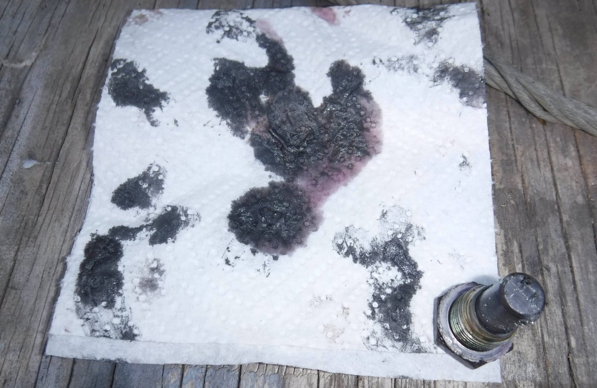

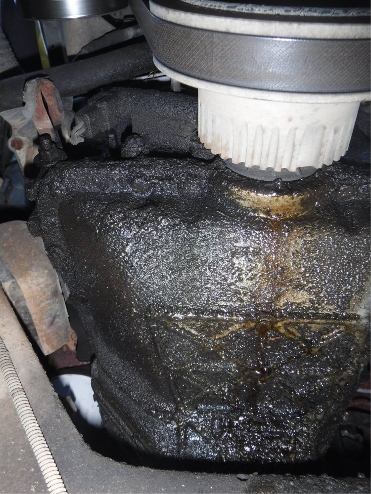

This is from the original transmission I had to revert to when the rebuilt from Minnesota went bad. A friend towed me home and I put the old one back in. It had 234K when I got it, and I put another 110K before replacing it, then used it another 2 years after that went bad, I think it's due a rest :)

That's from the original I just pulled out today for likely the last time, unless it get a rebuild, which it hasn't had for near 400,000 Miles
Well, actually I haven't pulled it yet, but am right down to it.

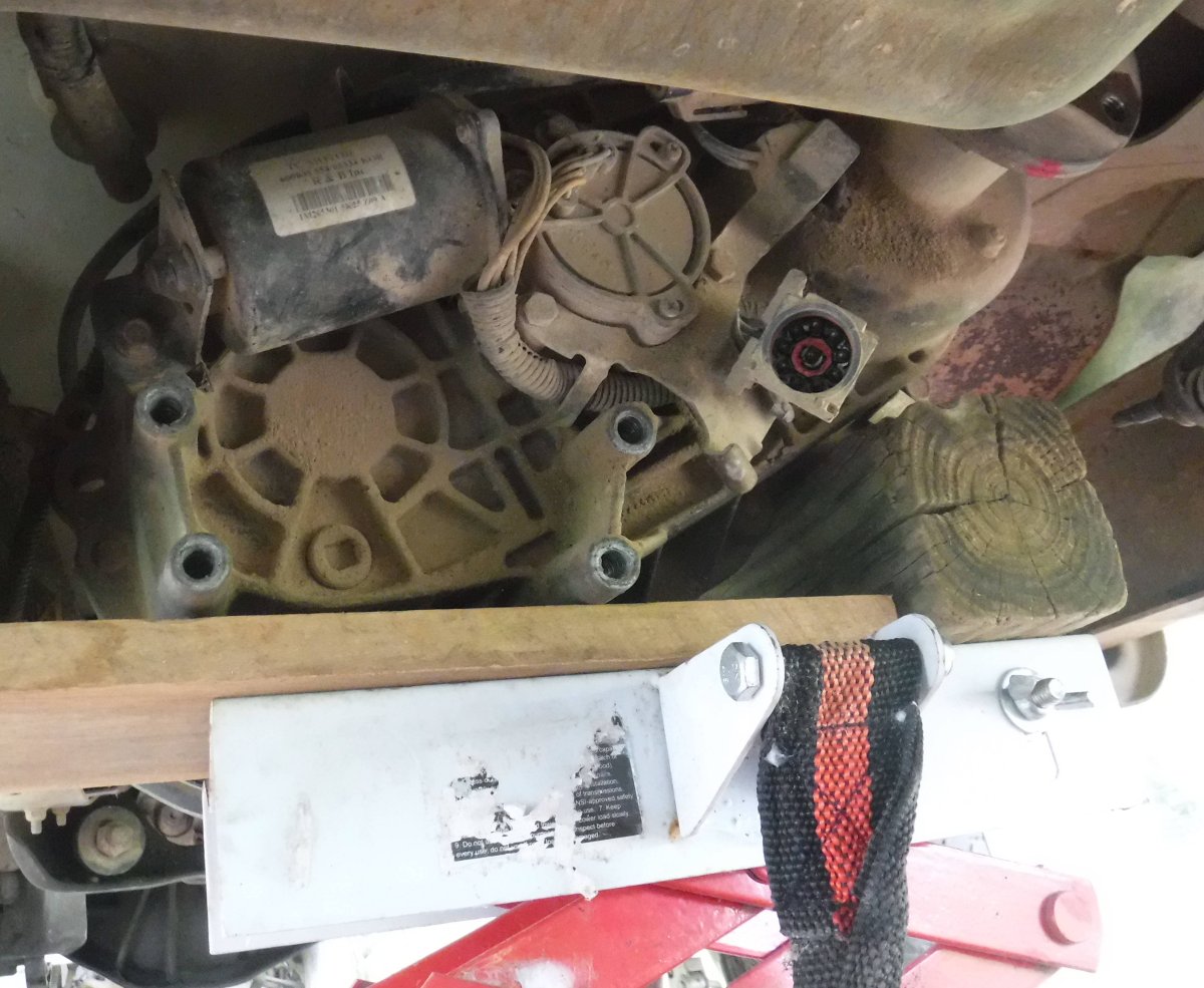

I did get this far tho, that's the way I block up the TC, it works real well with 4X block on the high end

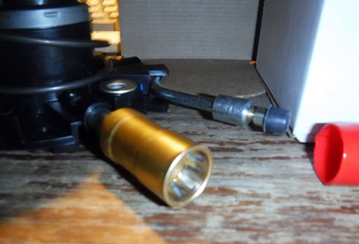

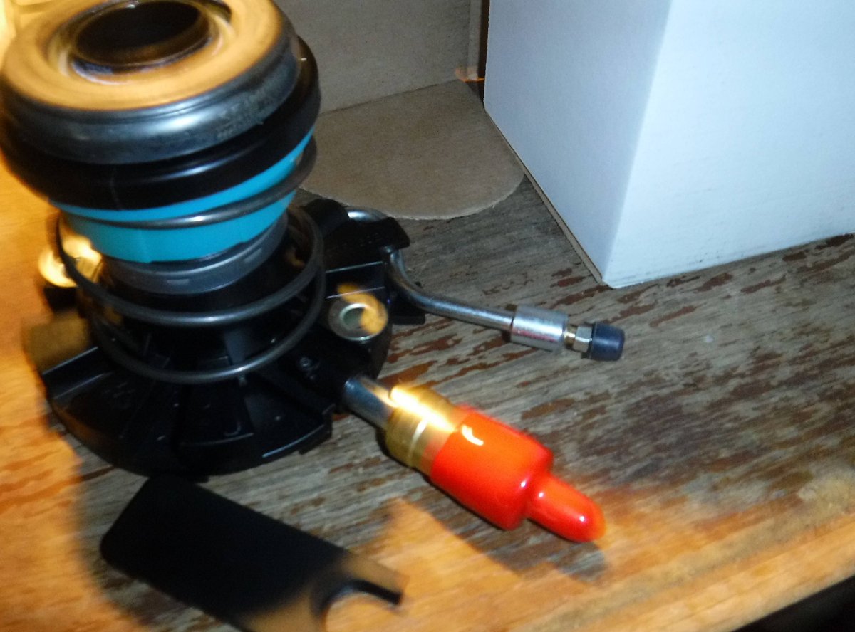

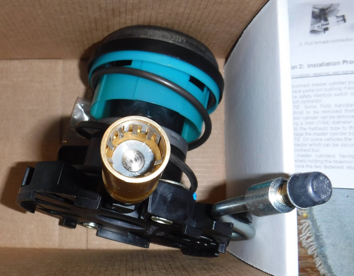

I believe I could be screwed on my slave cylinder. I was running low on time and money and decided to just go local, and had a bonus points or whatever they call it from buying the upper engine set from AZ for $20 off. I went there and asked for a Perfection and was looking at it and something came up I can't recall what and they had another one I looked at and asked about it. It was pre-bled and $3 more. I asked, "$3 the only difference between these?" So much for my ADHD
Anywho what I got was not Perfection or any other I ever heard of, and today I realized this has a clip on latch, and I am not even certain they will connect!? :/

I'm hoping that slave cylinder will work, looked inside, it's got little spring catches all around it to lock it in.
Don't know how it's supposed to come off , maybe I'll just leave that question till next time eh?
That's the same setup used on my '90 to '94 trucks.

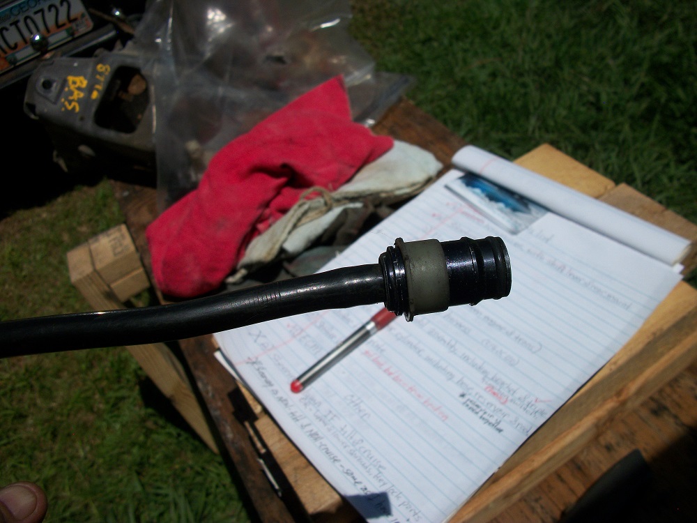

For that type of slave fitting, the correct line on the master side should have a plastic sleeve (gray):
Going full circle
Pushing in on the line AND pushing in on the sleeve pushes the metal spring catches in the female side off of the single retainer barb ring on the male side, allowing the lines to be uncoupled.
Hope it helps; good luck!
