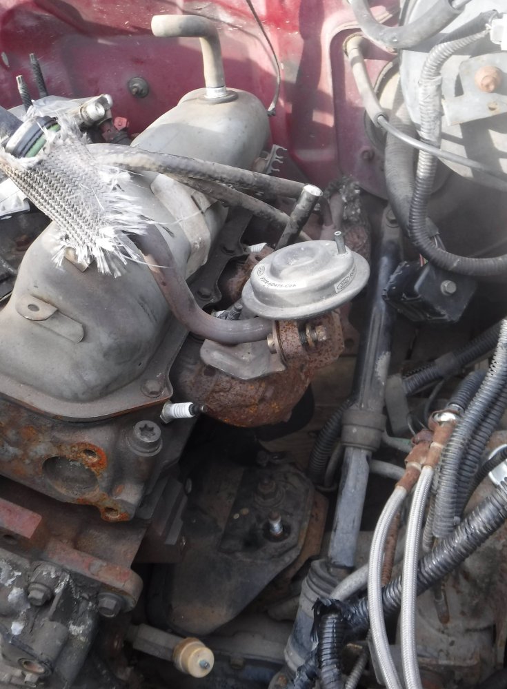

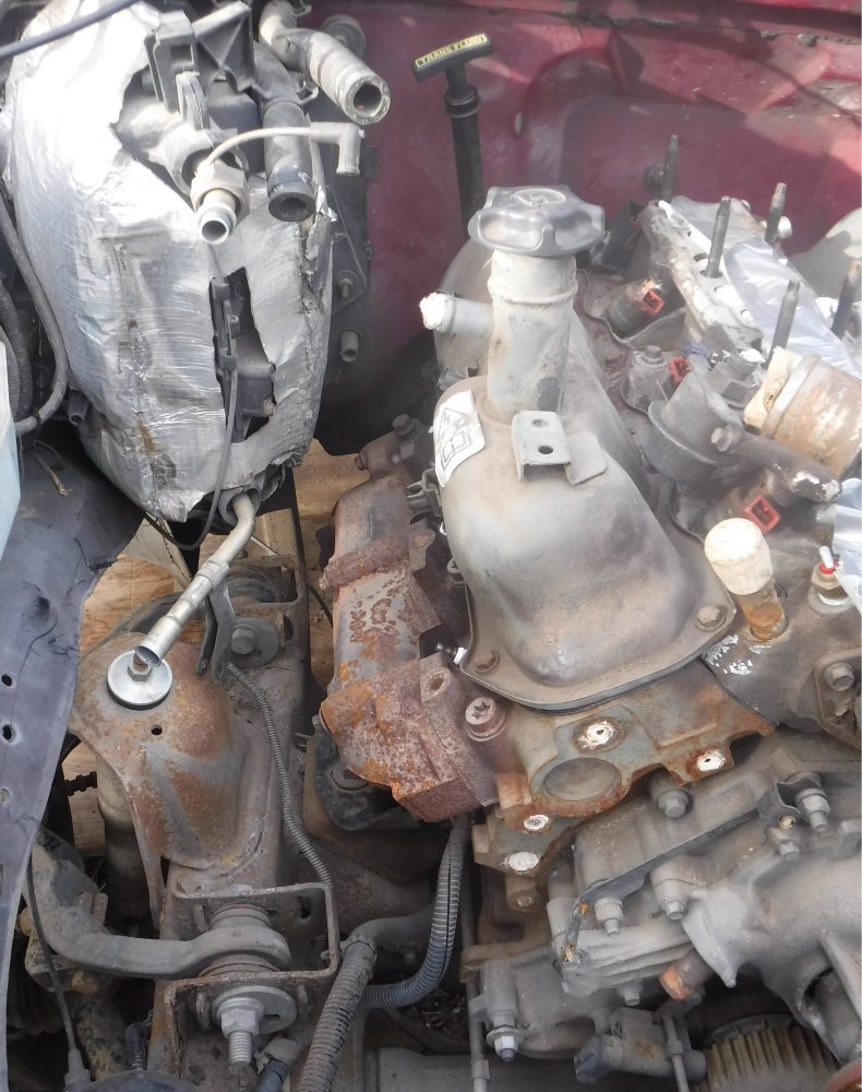

Does that heater box got to be moved? Does the exhaust got to come off?, if possible I'll leave it with the block

Does this exhaust need to come off? Can I remove the Emmision stuff and leave the exhaust pipe?

I wiggled a 5L out of an explorer engine compartment without touching the heater box with the exhaust manifolds installed including EGR tube, you should as heck be able to get a 60 degree V6 out of the same engine compartment...
Yup, I’ve never pulled the heater box. I did find that headers don’t want to fit past the heater box and steering shaft even with the core support out. But factory exhaust fits past with a little wiggling

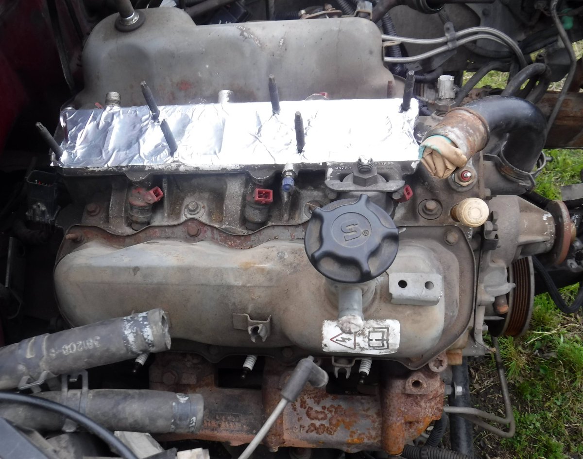

The Spring is springing and I pulled the cover off the Explorer motor today. The varmits had begun to tear into the Aluminum tape I had on it. I found some wider and heavier but it shouldn't need to be there long as the last one did.
I squirted some oil into the cylinders and turned it over, easy as pie. After replacing the plugs I turned it a bit farther and the compression seems to be excellent.
Getting a hankering to hear this thing run. To see this thing run. To FEEL this thing run! ;)
