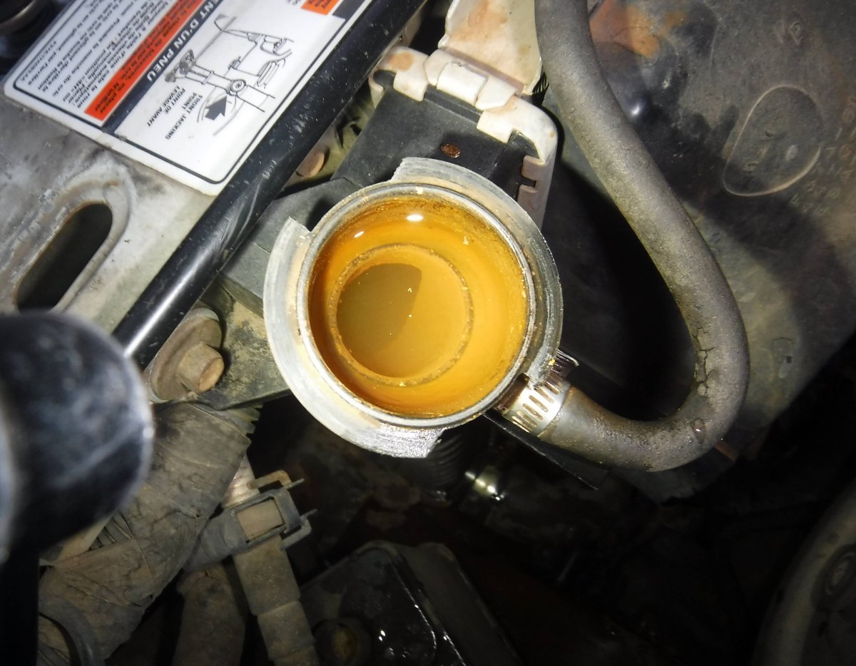

I may have gotten some of that in a wmart jug marked as "extended life", not certain, but otherwise I don't know where the red color might have come from, that was first time I had seen it looking red, also I think the light from the flash and sometimes the flashlight makes it redder.

After getting home and letting it cool and rest I pulled the cap and it looked a bit different, tho I also believe the light has a large effect on it's color

The color looks a lot better. A good flush might be a good idea just to make sure all the junk is out of the system but I think you are good.
If you are using a concentrate mix, make sure to to use distilled water. You can get it in gallon jugs at the grocery store. I prefer premixed 50/50 because it’s convenient and I doubt the concentrate is significantly cheaper after it’s all said and done.

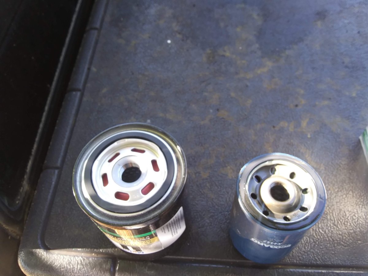

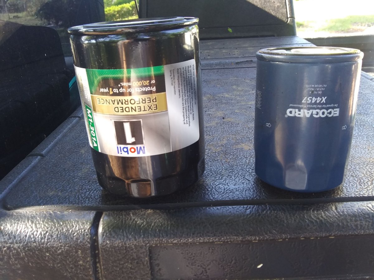

My Nissan takes 4.5 quarts of oil per the manual. I changed the filter from the one they say use to a larger one, now I use the whole 5 quarts with no issues at all.
Outside Diameter is larger, but the gasket diameter is the same. I've had 0 issues since I've made this switch.

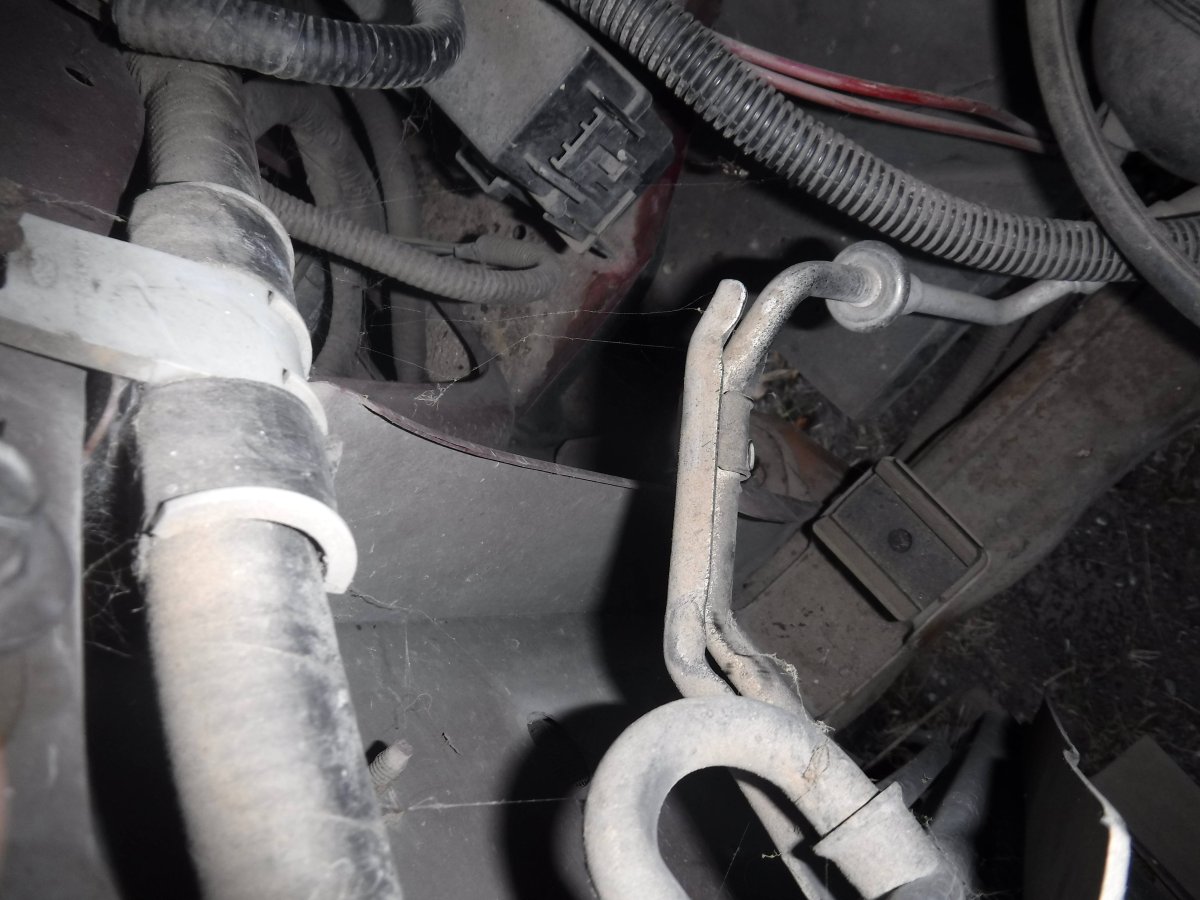

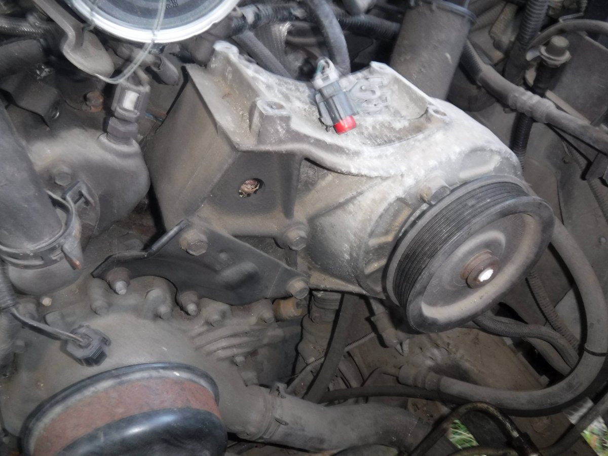

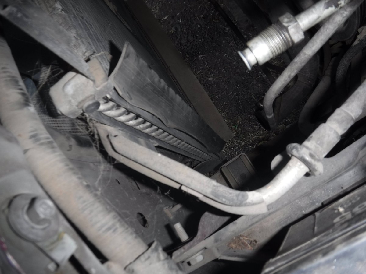

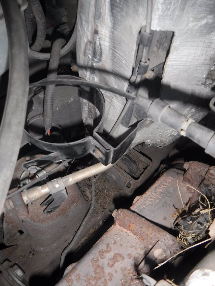

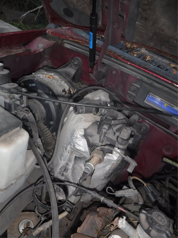

How do you get this stuff apart without just taking a sawzall to it? I really wouldn't mind doing that but see no need in wasting it if it can be used elsewhere
Looks like the AC lines are mostly just crimped but a sawzall is all I can see to use on that
The power steering I can only think to unbolt it and then let hang
Not sure I'd ever need them both but who knows, or maybe somebody else could

AC fittings are Spring-Lock, like fuel lines. It'll use the same tool that wraps around the line and then is used to push into the fitting to back the spring off to uncouple the fitting.

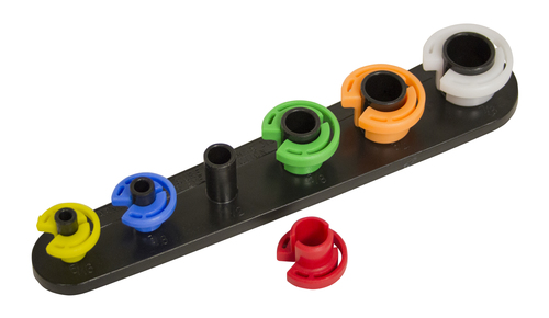

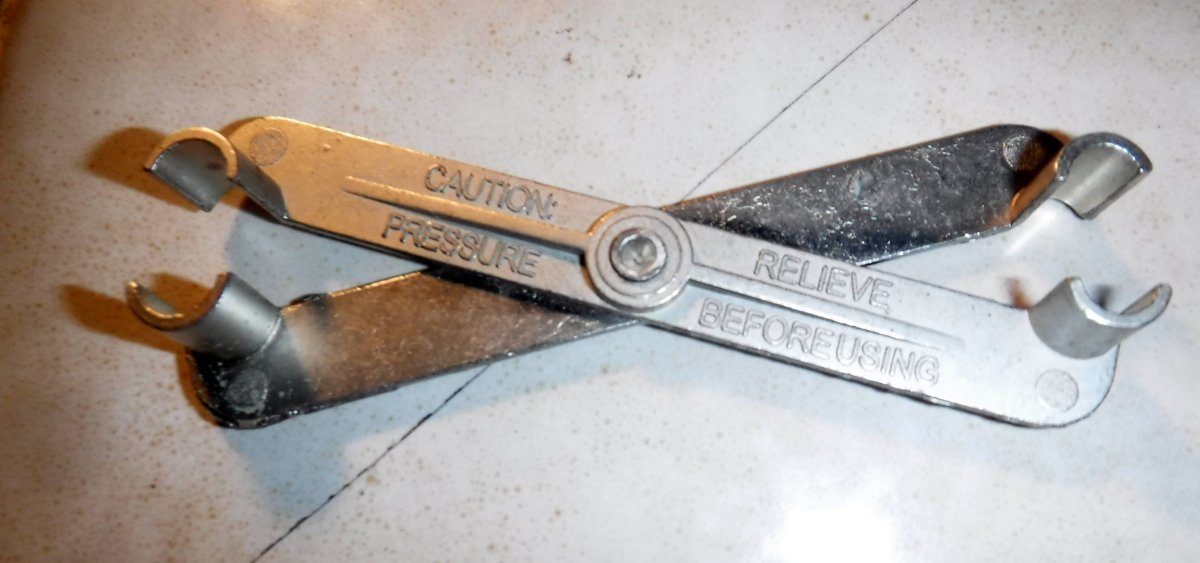

This is what I got and couldn't get it to work on my fuel lines, they said another type worked better but I never got one.
Is this it or does the other one work best on these too?
The othere ones look like liitle top hats with a slice on one side. IMO, much easier to work with.
