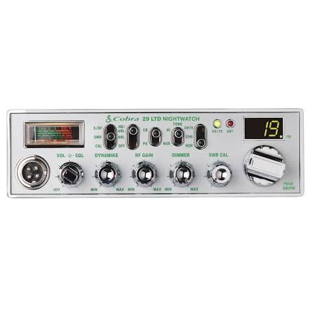

This might help you guys know what cb I have
Cb radio

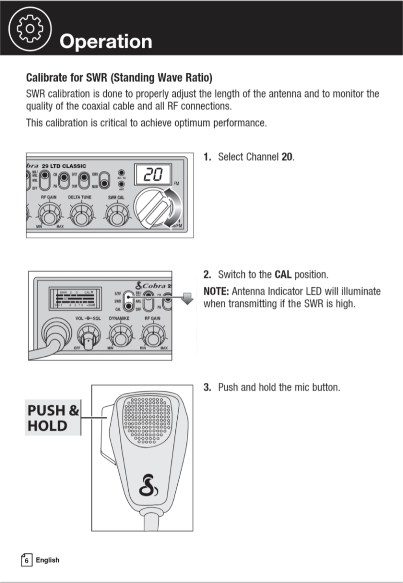

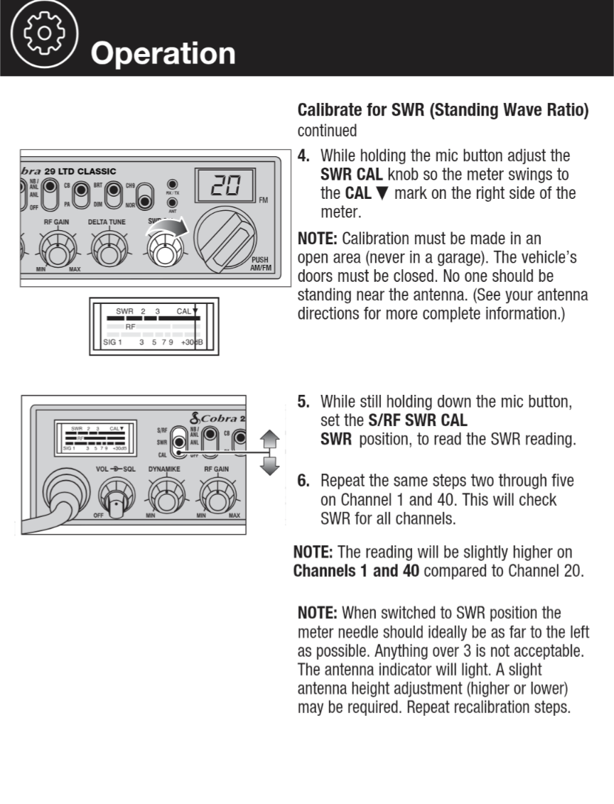

Do you have the user manual? I just found it online and the antenna running procedure is pretty easy and straightforward on that radio. Basically you key up the mic, calibrate the meter to full scale with the SWR/CAL switch set on CAL, then tune your antenna until you get the lowest reading with the switch set to SWR.
  • Cb radio
  • Cb radio
nice cb. i like cobras. as you play with it, there are little things you can do to make it more powerful too. thats for later on if you like it though.
adding stuff inline to make it more powerful can get you in trouble though. i forget what the amplifier is called some people use with a cb but that can make you get visits from different types of government people you might not want visiting you so don't fall for adding those types. a linear amplifier? something like that
