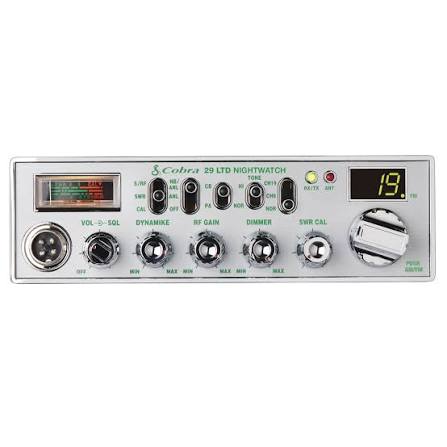

I have a cb it’s a cobra 29 classic it says it was made in 2016 is this old enough I’m worried I’m gonna put this antenna on my truck and then burn my cb out I’m not really looking for distance or perfectly tuned I’m just kinda going for looks and to maybe talk to a buddy 1-2 miles away
As long as you get the SWR below 3:1 on all channels, the radio will be safe. The lower the number the better. 1.0:1 is the ideal number to get, though not always possible in the real world. My 102" whip on the 2011 is dang near 1:1. I don't remember what the magnetic mount Wilson I have on the 2019 has for an SWR but it was acceptable or I wouldn't be using it.

Well my cb has a swr built in so I should be ok by tuning it with that?
I would think so.

This might help you guys know what cb I have
Yea you got a SWR meter built into that.
It will work but they aren't as good as a stand alone unit for some reason. Just make sure you have the switch on SWR when you are going to do it.
