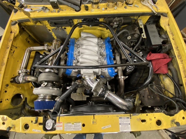

I finished my intercooler pipping today. Also put together the TB elbow. I just have to connect the crossover to the passenger manifold and the turbo kit is done. Well I guess I need to attach the BOV too.

That engine bay is looking awesome. Did you plumb the wastegate dump back into the downpipe for inspection purposes?

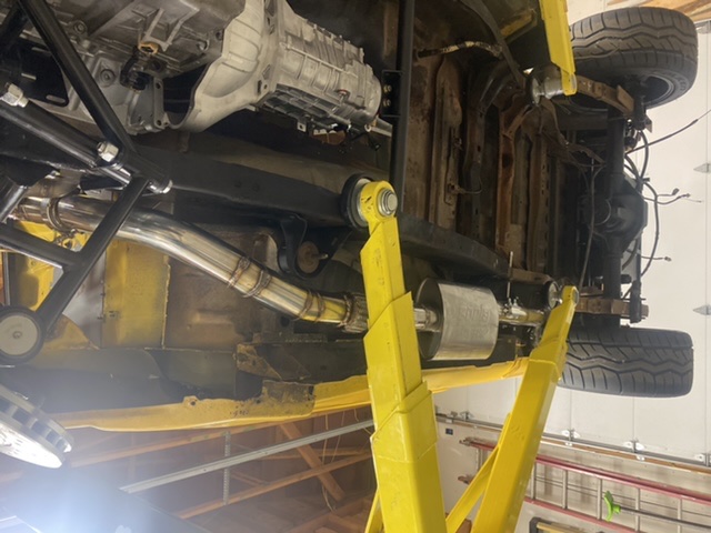

Im doing a daily driver type of build. I want the truck to be somewhat quiet. The downpipe is 3.5” going into 3” exhaust with a Borla muffler. Not going to help HP at all but for the power im after it shouldn’t be an issue.
You might be leaving a little bit on the table by necking down to 3", but probably not much. 3" pipe isn't a true bottleneck restriction until you get into 4 digit power numbers for the most part.
