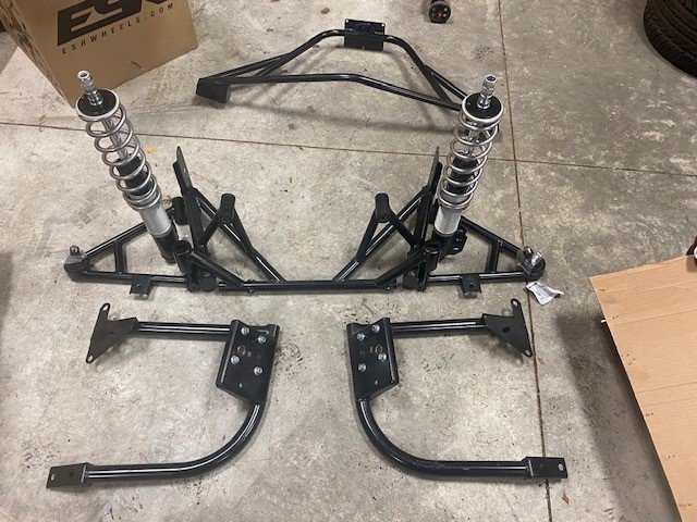

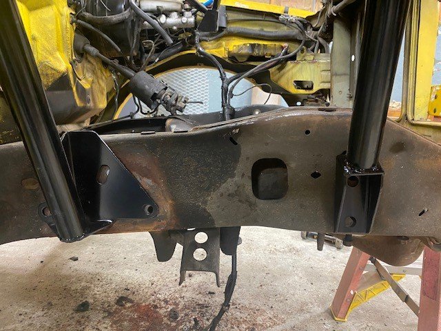

Did you get yours installed? I tore apart my front end yesterday down to just the big engine crossmember. Coil buckets and everything else is gone. Mr. air chisel is my best friend. Now when my kit came I just briefly looked in the box and tossed it in the corner. Took it all out yesterday and the kit I received has very few similarities to the one pictured on their site. They also sent me the wrong engine mounts but talking with AJE this morning they are sending the correct ones out. While talking to a nice lady over there I asked for instructions and she didn't think there was any for this kit. I get the basic layout but being my kit is something I've never seen anywhere else it's really hard to understand how it goes on the truck. Someone from AJE is going to call me today or tomorrow to talk about it. Ill snag pics here soon.

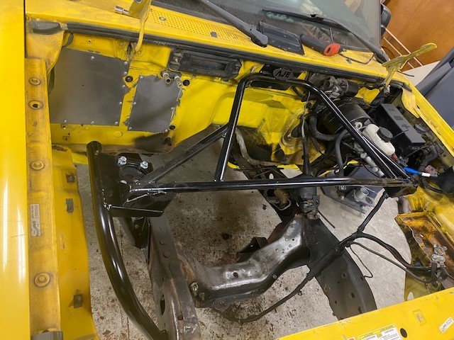

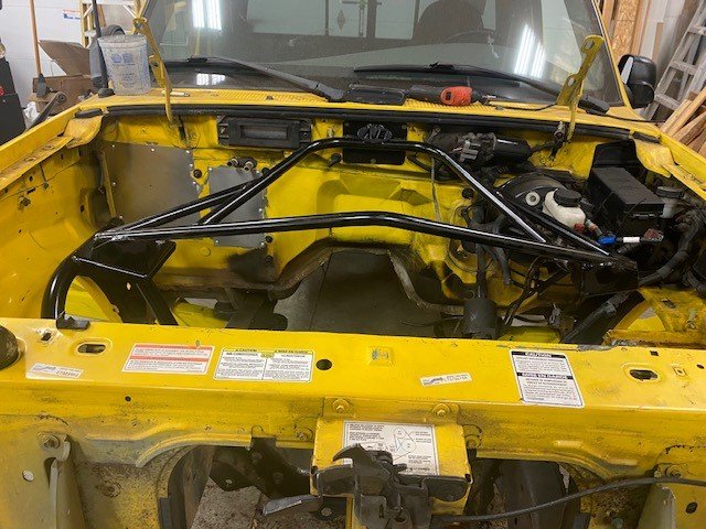

Did a little mock up at my lunch today. Right now it's looking like the battery tray will be in the way, and my master cylinder is really close. Was not aware those two things would/might be an issue. See how my kit is different? The one I got bolts to the side of the frame rail with one bolt on the bottom. The one on their site bolts just from the bottom and inside of the frame. Overall I understand how it goes together, but the lake of specifics really bugs me. I'm just guessing on what stock parts need to be removed/ looking at pics on the AJE FB page. I've read similar frustrations from mustang guys using AJE products but at least with them they have enough people using it they can share what needs done and help each other out.

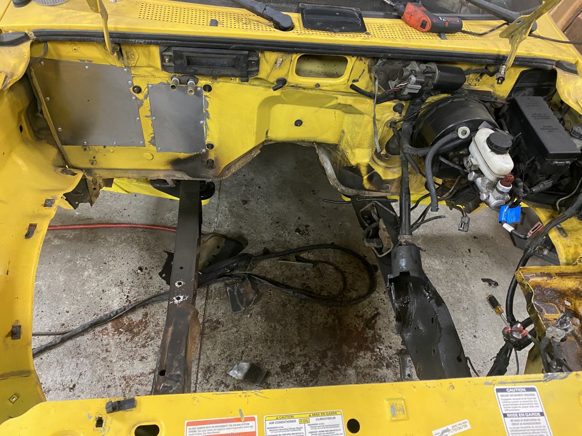

Didn’t really want to share so much but being this info is not the internet yet I can take you guys along for the ride so future people have some kind of idea of what to do.

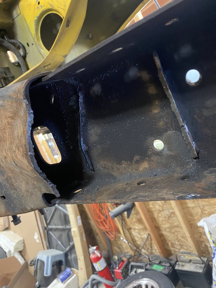

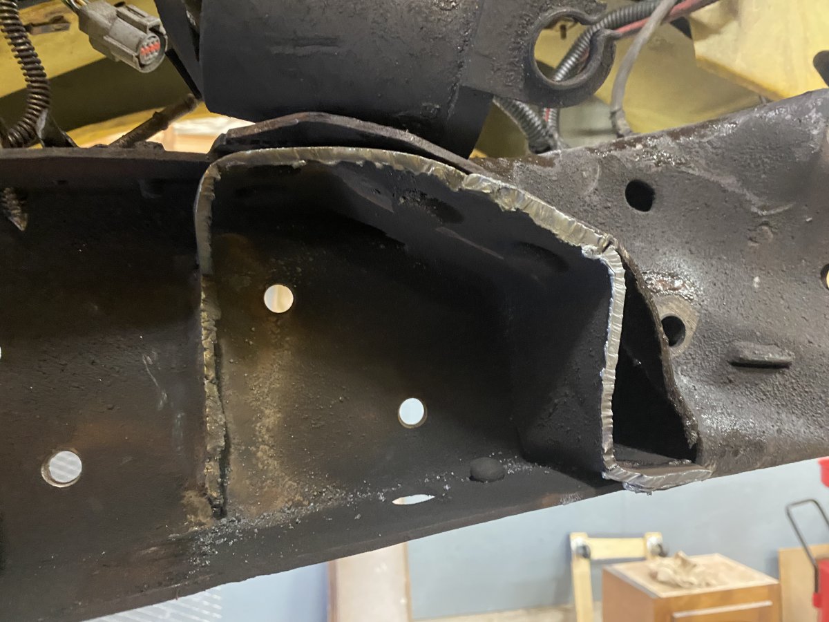

Taking out the engine crossmember ended up being harder than i thought. You’ll definitely want a plasma cutter or a torch. From the outside it looked like just some rivets and and couple welds needed cut. Turns out it’s also welded on the inside where you can’t see. After lots of banging with a sledge hammer and head scratching I ended up just taking chunks out until I saw that weld then ultimately cut the whole thing out. I might not of had to take all the rivets out like I did. Hoping to mock up the K-member today and I’ll know more then.
Talking with AJE who really hasn’t been very helpful it’s recommended I use a mustang master cylinder. It’s slightly shorter . Went ahead and ordered that.
