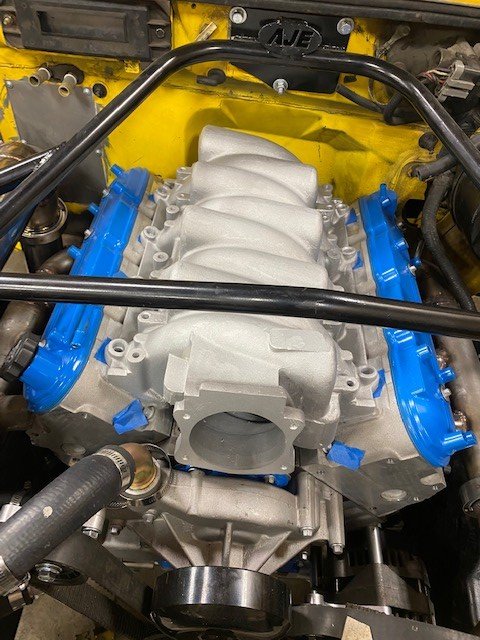

The truck intake although it just barely fit sorta, it's far from ideal. I ended up ordering a Speedmaster ls1/ls6 style intake mani and plan to use a gen 4 four bolt truck TB flipped 180 degrees to clear my truck water pump. The gen 4 TB is quite a bit bigger than the gen 3 TB. I should have just went with the car water pump in the first place. The speed master intake mani and gm TB was the cheapest route I could find for swapping to a car style setup. I'm actually going to test fit it tonight. I can't confirm that flipping the TB is going to work, but I don't see why it wont. My alternator is mounted down low as well which makes room to flip the TB.

Function wise truck intake will work fine. Richard and sloppy have shown us that. The fit though for a second gen is so dang tight. I had a heck of a time getting mine off last time. Be best to unbolt the engine from the K-member and let it sag down a bit. Look at the room I have with this car intake now. I was wrong about being able to flip the TB to clear the water pump. Still hits. I'm going to make an extension or 45 and it'll be fine. Intake mani $240, Truck Gen4 TB $40, Jegs fuel rails $105, TB flanges and material for 45 spacer $100. So $485 to swap a car intake on to it. Plus I gained a slightly better mani, bigger TB, looks better, and fits better. These dang builds are money pits. I'm so far into my build now I look back and think about what I could have bought with the money into this truck.

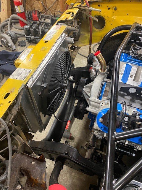

Radiator for the second gen there plenty of room. Just some cutting required.

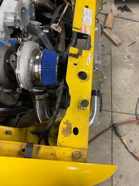

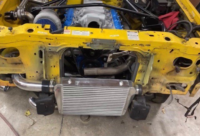

Those appear to be even longer. Not sure they'll work. The amazon ones I test fit were not great for fitting a turbo. Actually are you running a turbo?
I'm running a turbo, yes. I'm hopefully getting the AJE mocked up this weekend, so I'll report back if they fit or not- it's going to be close based on my pics vs yours.
It'll fit but It wont be the best placement for the turbo. Lot depends on what your intentions are with the exhaust. I ran mine down the side and exited in front of the rear tire. If you're just exiting through the hood I dont think placement will matter as much. I look forward to seeing your progress. I couldn't find any turbo manifold that would work with the AJE setup. At least not in the way I wanted it too.

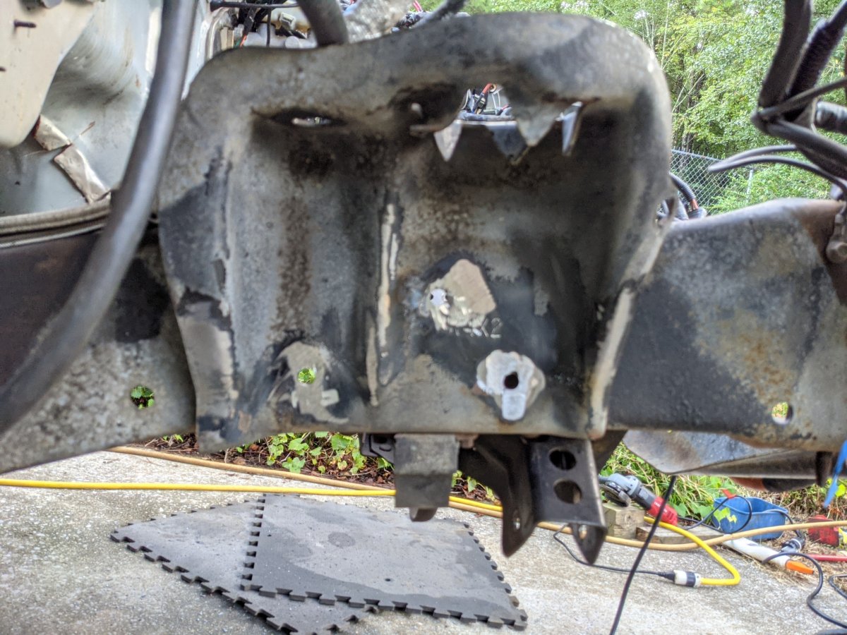

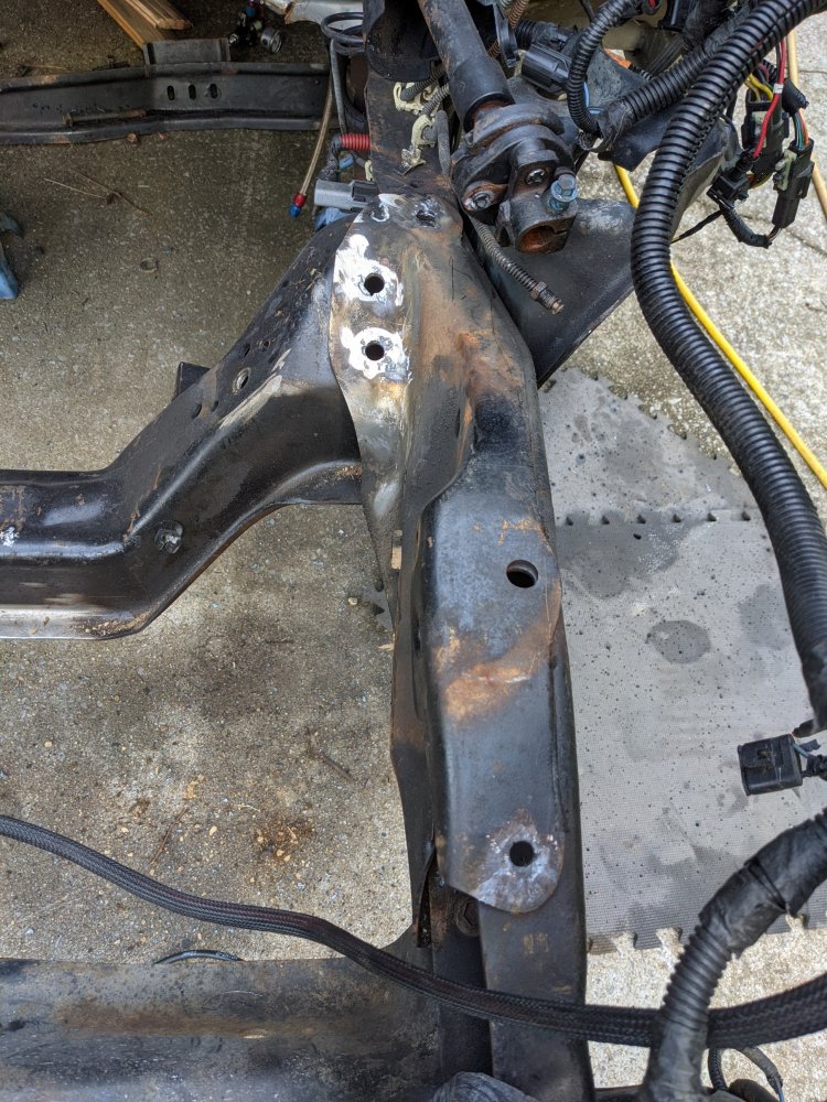

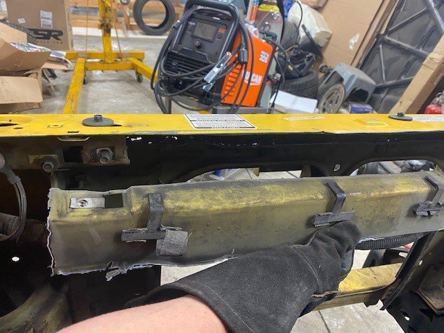

The beginning, grinder, punch and plasma cutter in hand. DJM dream beams, tubular radius arms, and frame mounts removed.
AJE Ranger K-Member Who's Done It!?

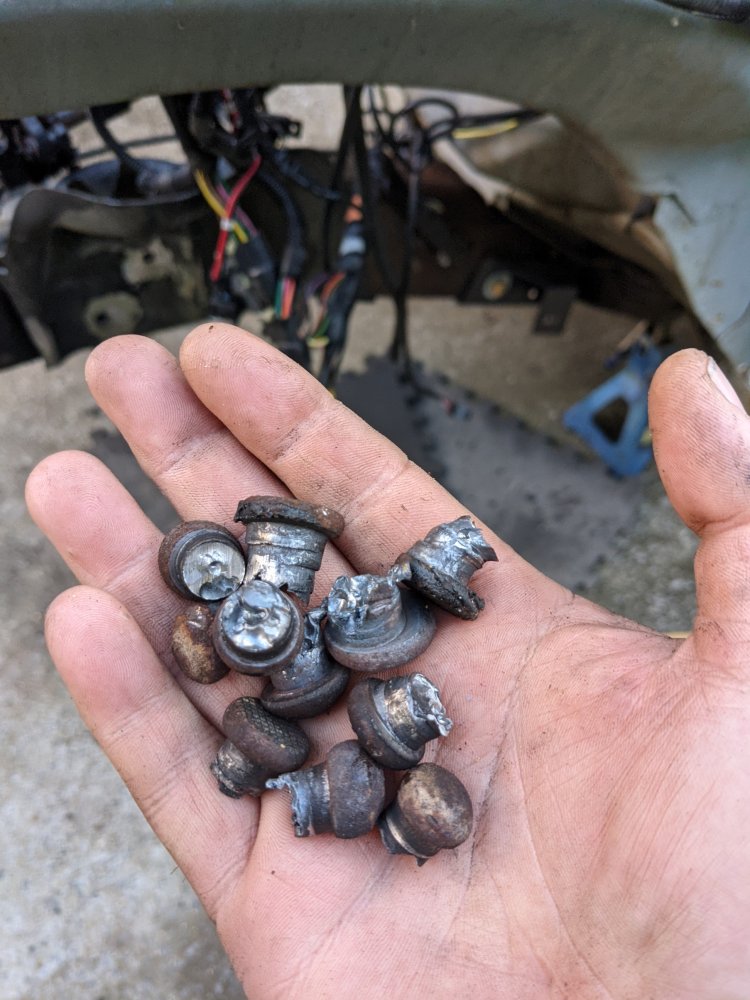

These are what you have to look forward to- I actually lost about 6 of them in the grass (gotta find those w a magnet-I'd hate to send one with the lawnmower).

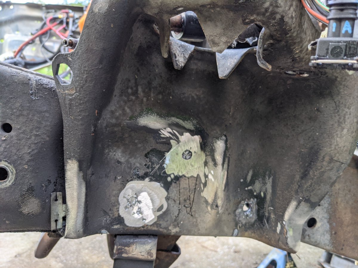

Pass side first. Yotaismygame can point out where the new AJE k-member and strut towers will mount, but you can clearly see what I'm burning / grinding away here

Next comes the driver's side:

The driver's side reinforcement plate has some challenges; it is welded across the top and partially on the bottom.
The entire cross member not only has rivets, but is welded on the inside corners of the frame (riveted there, too...yay Ford).
All said, about 5 hours worth of work (still have the welds to contend with).
More pics later as I curse myself for not getting an arc gouger, too. I also got the fuel cell and radiator mounted in the bed, so I'll detail my approach to that later, as well.
