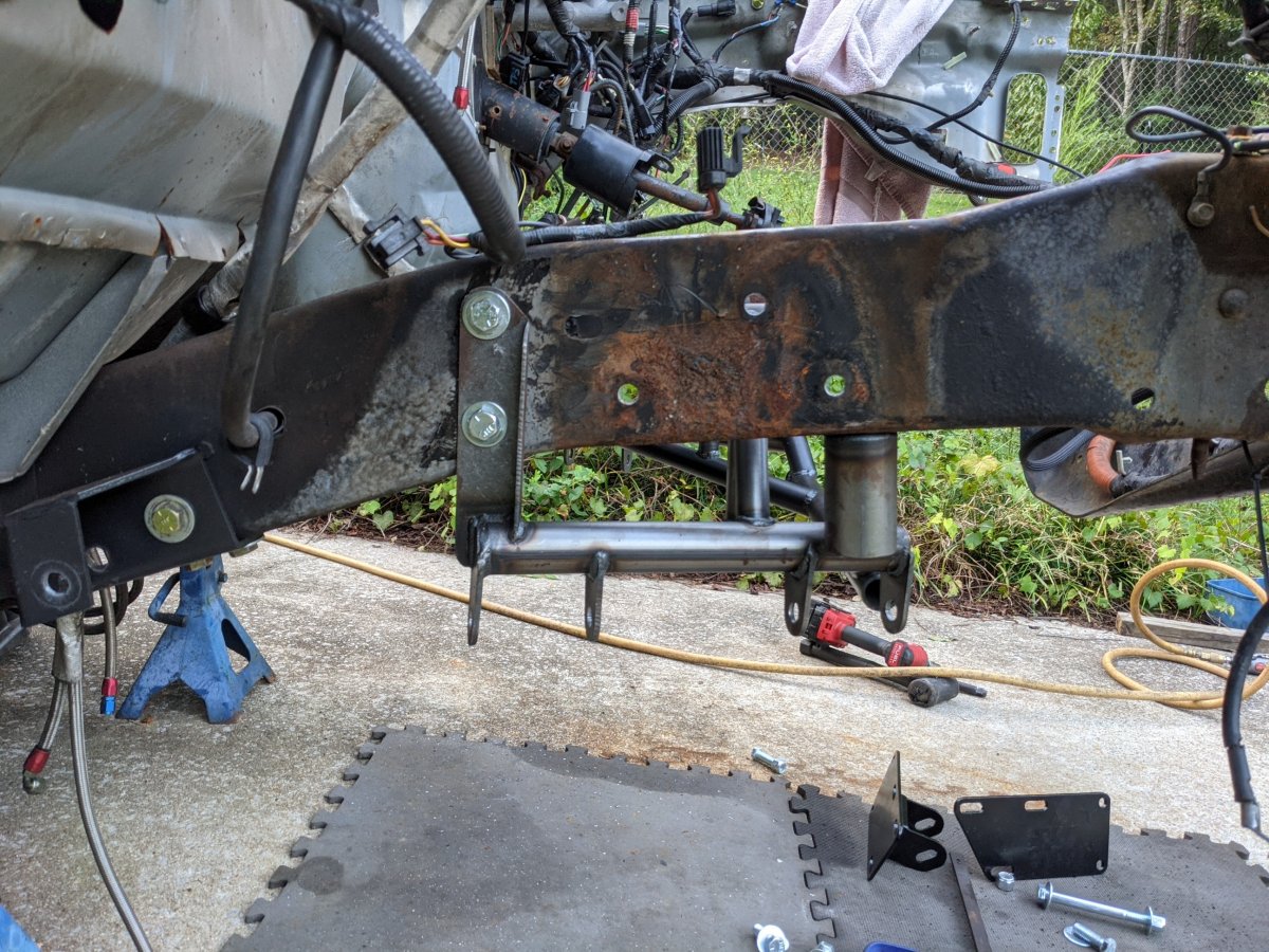

I received the new AJE k-member Saturday. It was a nice gesture that they hustled to get another one fabbed up and shipped out to me. I asked that they didn't powdercoat it to help expedite the process, as I intend to clearcoat it. The welds are much nicer (looks like a welder did it this time) and it fit the frame nicely. You can see the front bracket holes the k-member uses at 9 and 3 o'clock on the frame rails:
AJE Ranger K-Member Who's Done It!?
Per Yotaismygame's advice, I loosely installed it at first, squared everything up and center punched the 0.500" holes to be drilled (one each side) for the rear mounting brackets.
Once everything is square, I tightened the k-member down.
Using a 15:1 Fox body rack from Summit, I loosely installed it to see what the Ranger (I call it Wiley) had it in store for my steering shaft.
Tomorrow I'll finish the install weather permitting, mount the dummy engine and transmission and figure out how my turbo hot side piping is going to go (I decided to coat the stock truck manifolds and use them).
@Yotaismygame Thanks again- This install would have been a bit more challenging without your pictures.
