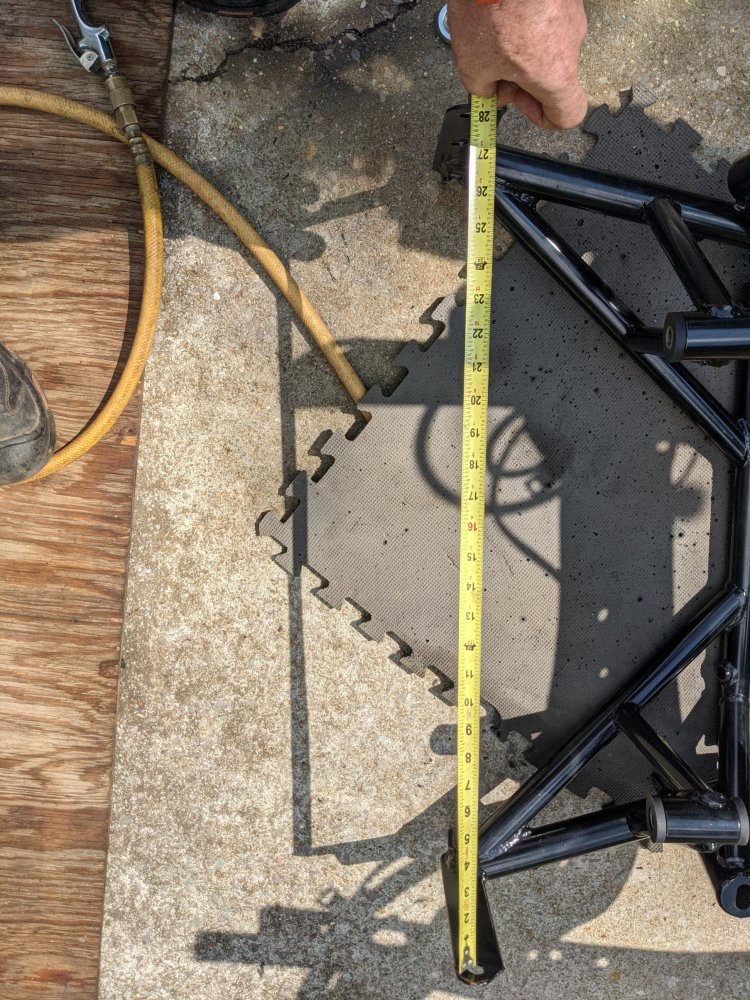

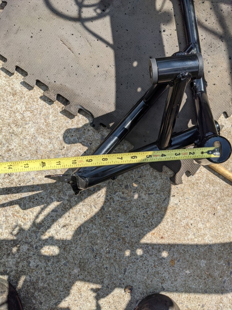

Visual ref:
The first pic dimension is to get an idea of where on the frame the aforementioned brackets would normally locate (10-1/2" ctr-ctr behind the front "round" k-member mount):
AJE Ranger K-Member Who's Done It!?
So...10-1/2" back from the front k-member mount holes is where the frame would be (outside to outside) 28-3/16".
It is not. The frame is not 28-3/16" at ANY point along that dimension. Pic of the k-member I.D.:
Jeg's said they would call AJE Monday- we'll see what happens.

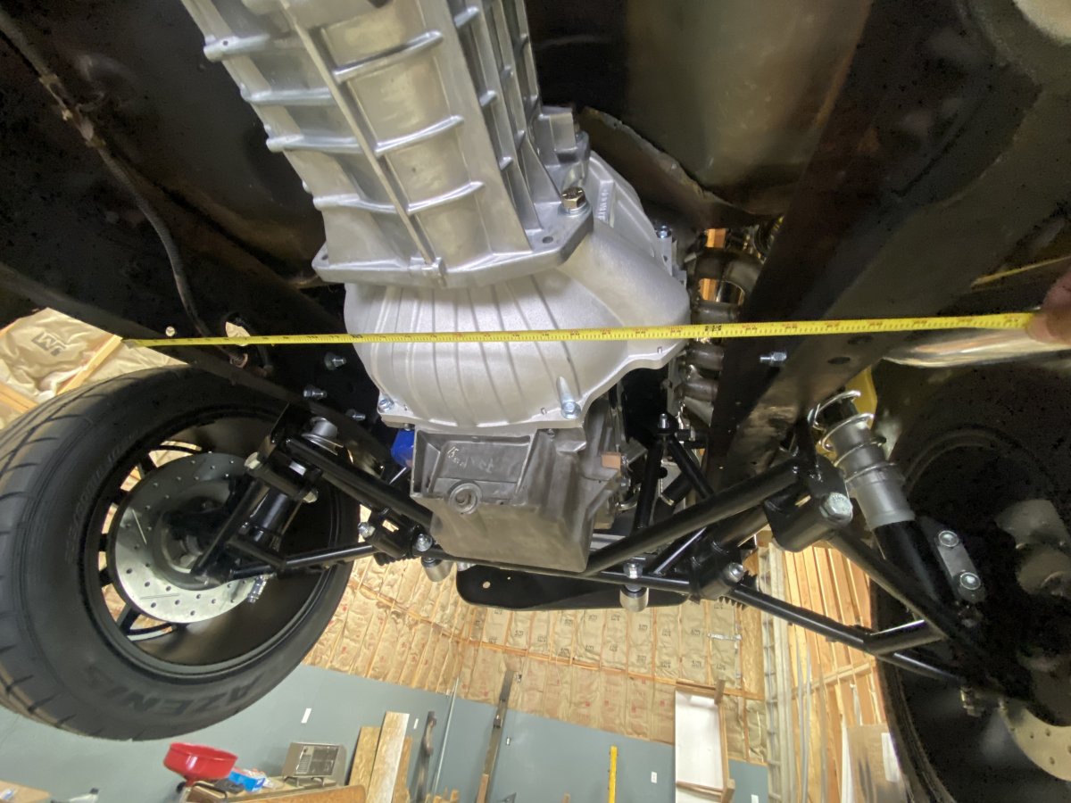

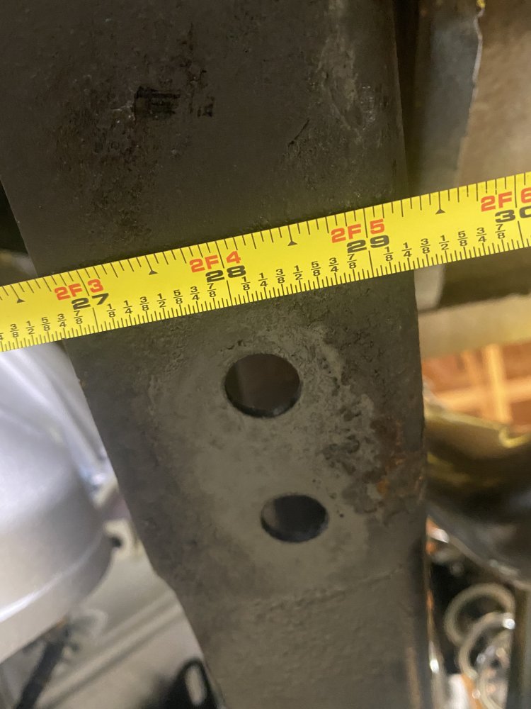

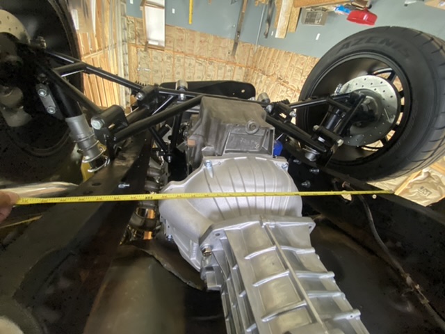

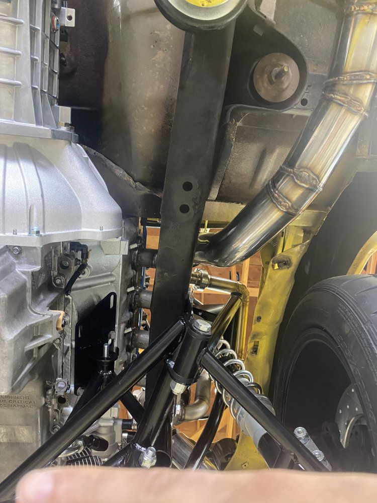

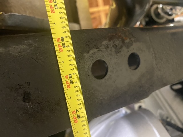

Well I came up with 28”. Problem though is my oil Pan is right in the middle of the two brackets. So I measured each side plus the pan width. Not the best measurement but I can’t imagine I could be off a whole inch
I took another measurement. You can see the frame on mine does start to bulge out after the spot where the K-member bolts too.
  • AJE Ranger K-Member Who's Done It!?
Yep. Thanks for that- I appreciate it.
Jim @ AJE checked the jig and said the k-member I had drew when it was welded.
He (AJE) said they would make a new k-member and send a pickup for the one I have now, but it would be a week before it ships. I told him to send it raw and I'd paint it to save a couple of days and we'd make up the cost diff later.
