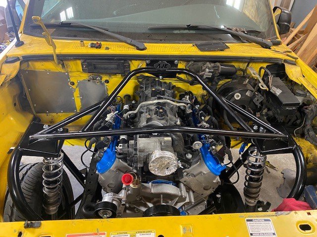

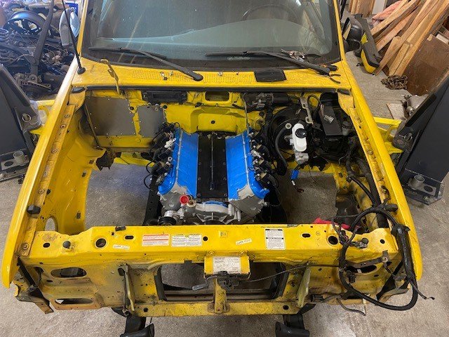

First engine mock up. Really makes me feel like I'm getting somewhere. If this truck was at my house not my Dad's shop I would be working on it non stop that's how excited I am about it right now. Much more room in certain areas than I thought there would be. A heads up if running a LS with truck manifold there will be some clearance issues. Clearly meant for the car mani. Next I need to get the transmission in and mounted so I can move to the rear suspension and set the pinion angle on the axle properly.

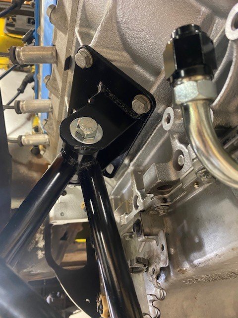

Some clearancing needed here.

Confirmed with AJE these are oriented correct.

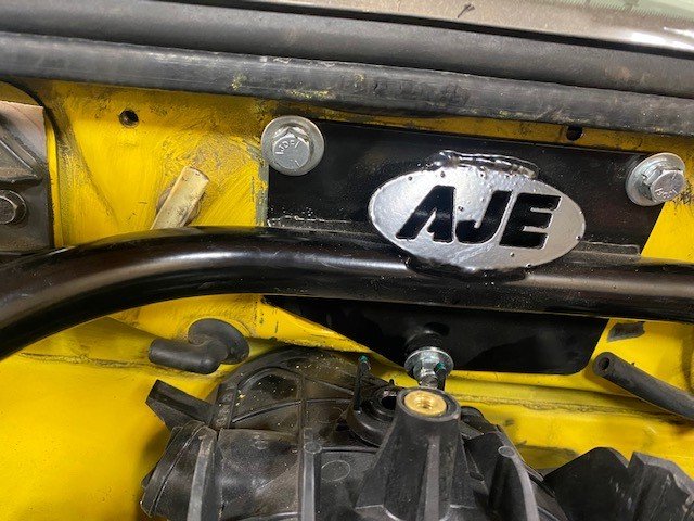

Had to sledge hammer this left corner to fit the intake manifold then had to cut the crossmember. Wish I would have left a little more. Ill also have to cut that mount off in front of the Map sensor so I can flip the sensor around. No room behind it.

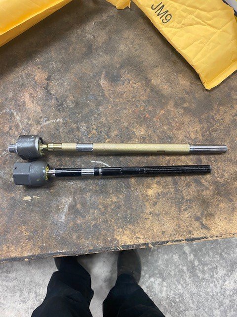

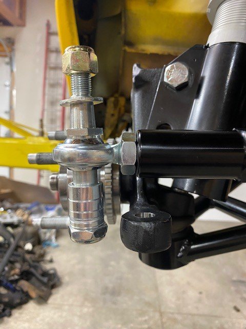

First I ordered a manual 15:1 unisteer sn95 steering rack and sn95 bumpsteer kit. Turns out the inner tie rods are too long. It was recommended from mustang owners who run AJE stuff I use Fox body inners. Well the ones I ordered clearly wont work. Then I found some from Flaming River that look correct but for $55 each! And on top of that the outer tie rods/bumpsteer kits are specific for Fox bodies and Sn95. They each have there own thread pitch. I would have to try and return my bumpsteer kit and get another Fox Body set. I decided to take the inners I have and drop them off at a machine shop to be shortened and re-threaded. Might not be cheaper but will be more convenient. Moral of the story buy a rack for a Fox Body not SN95!

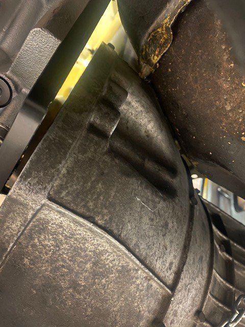

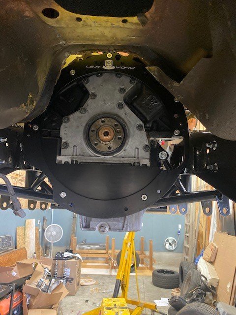

Next up is the transmission I'm using. It's not even close to fitting! Finding strong manual transmissions that don't cost a fortune is tough for an LS. I opted to use an adapter kit from LOJ to use a Nissan frontier 6spd. I don't want to get into the specifics of that but anyways.. The bell housing is huge and no where near fitting. There's major contact right where the gas pedal/drivers foot would be. I'm still in the middle of trying to figure out what to do here. There's options. One of which is expensive but awesome. Have you guys seen the new TKX Tremec transmission! I've been drooling over it...

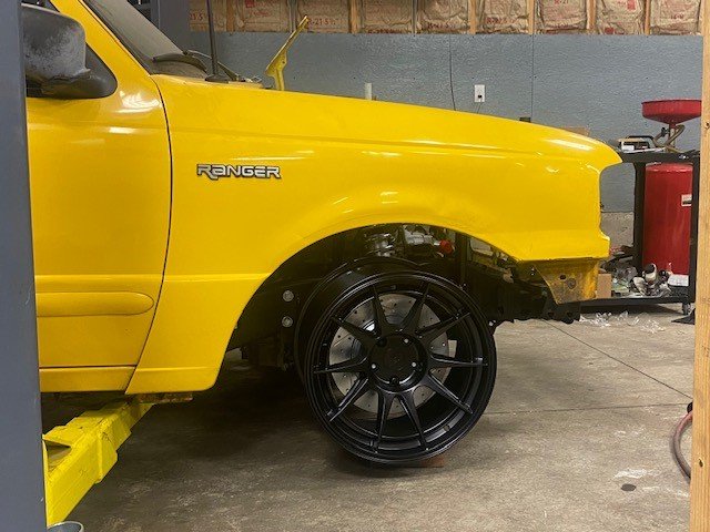

Last here's the wheels I will be running. I got a smoking deal on a close out sale. $500 to my house for them! They are ESR 18x10.5 ET15. So they stick out 12mm more than the other wheels I've shown. They barely clear the coil springs in front. I think 10mm spacers would do the trick but I ordered 1" spacers anyways. I'm going for a wide low stance btw. I wasn't sure how they would look on the truck but the for the money I didn't care too much. 18's definitely seem like the way to go compared to the 17's.
Here they are sitting on top of two 2x4's. Running 295/40/18's all around. So imagine that.
