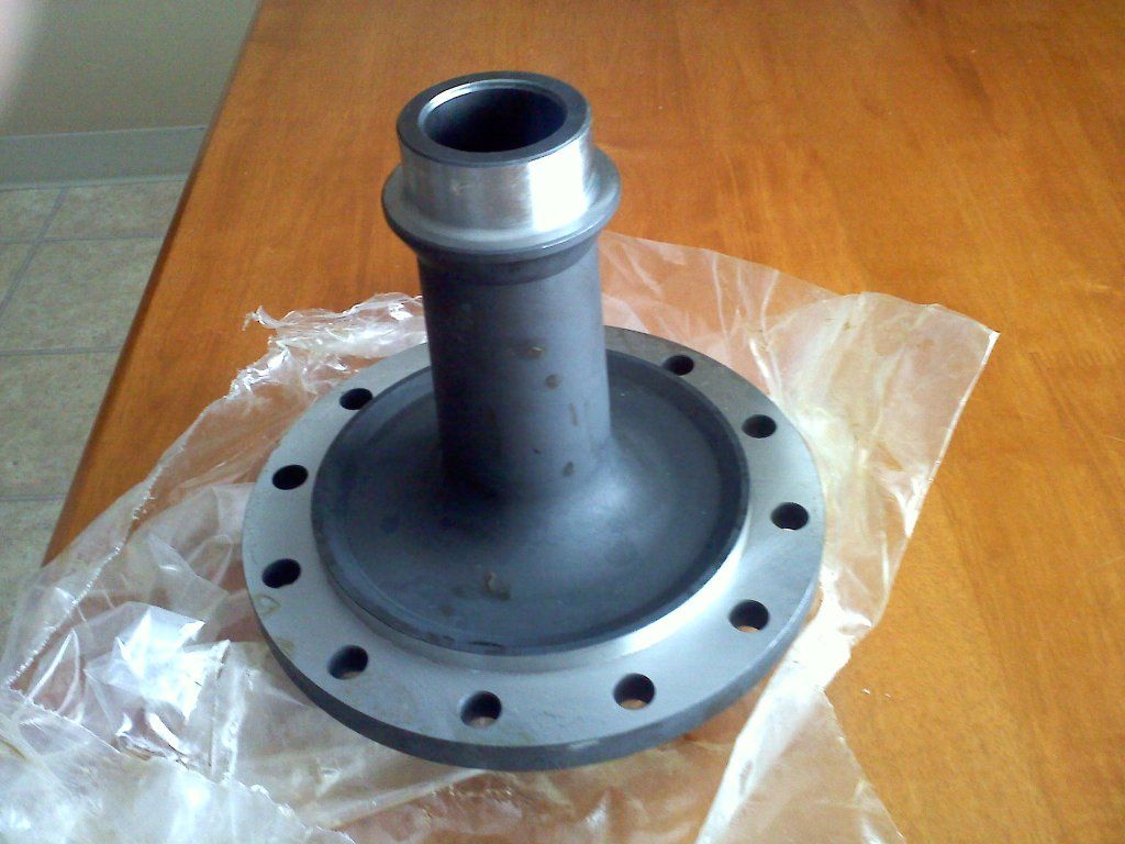

Got my rear spool today!! Planning the install on moday if everything works out.

Ya the spool will work with the gears.
Well things didnt go as plan. Got every thing tore apart, making a trips back to the house bacause i forgot some tools, cople trips to my work to press on the bearing and Just started to put every thing back together,come to find out the pinon is about a half .in from the ring gear!!!! After doing some research and calls i have a rear Dana 61. So now i have to go out and find a real dana 60 and rebuild it and transfer everything over. This Blows!!!!
