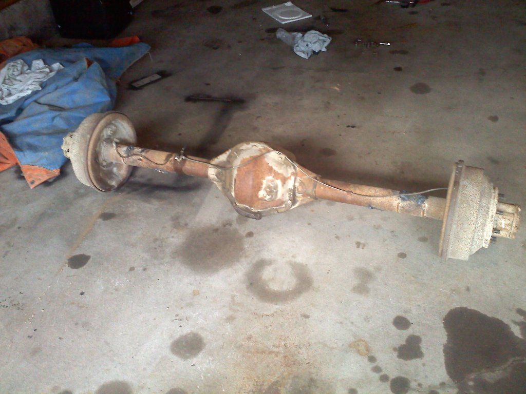

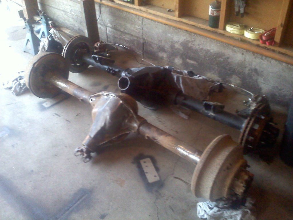

Well pulled my rearend from the ranger today and hauled it home. Used the wifes durango and put it in the back, what a pain in the rear putting it in and out by myself.
Anyway got it home and striped most of the stuff off and clean up the real 60. just waiting for the hub socket to show up so i can pull the hubs, borrowed a friends last time so i just decided to get my own.

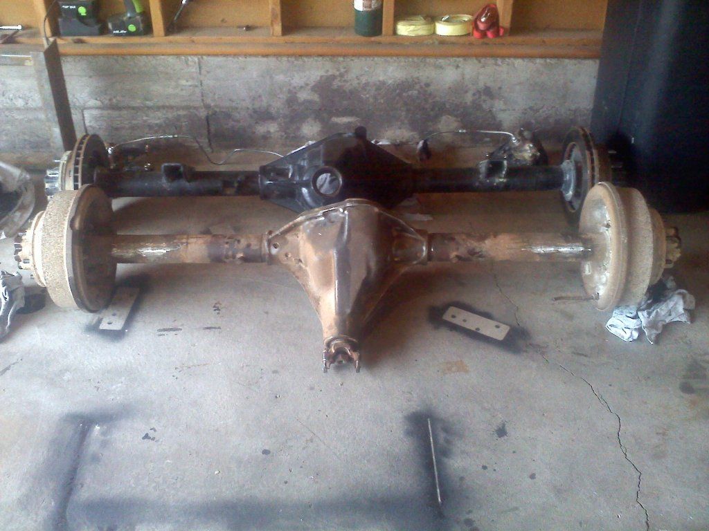

Their pretty much the same, just the 60 center section is smaller than the 61.

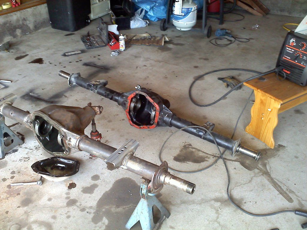

Well got the axle all tore apart and started getting my mounts on.
99 Ranger build
Ether tonight or tomarrow night will be putting the gears in and should almost be ready to go.
