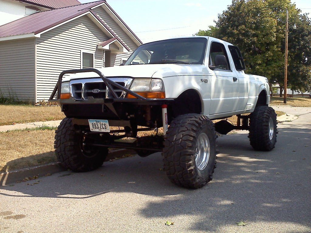

99 Ranger build
Just another pic
I see some big blocks in the rear. Hows that axle wrap workin for ya. I like the bumper. Maybe I should cut down on some projects so I can mount mine. parts are starting to ad up around the garage.
still lookin good thought bud. I like it!
Ah, James did my bumper too. Great guy with awesome skills.
Thanks
Axle wrap isnt to bad and I do plan to build some traction bars down the road.
Wouldn't taller leafs help more than traction bars? And be a little safer?
ya taller leafs world help, Maybe down the road i might get some custom ones. Just as long u dont stack or put block in the front their ok to use.

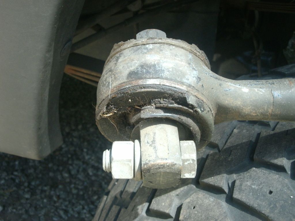

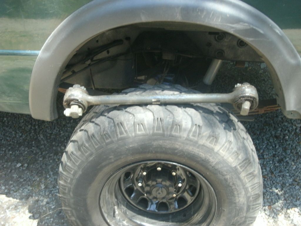

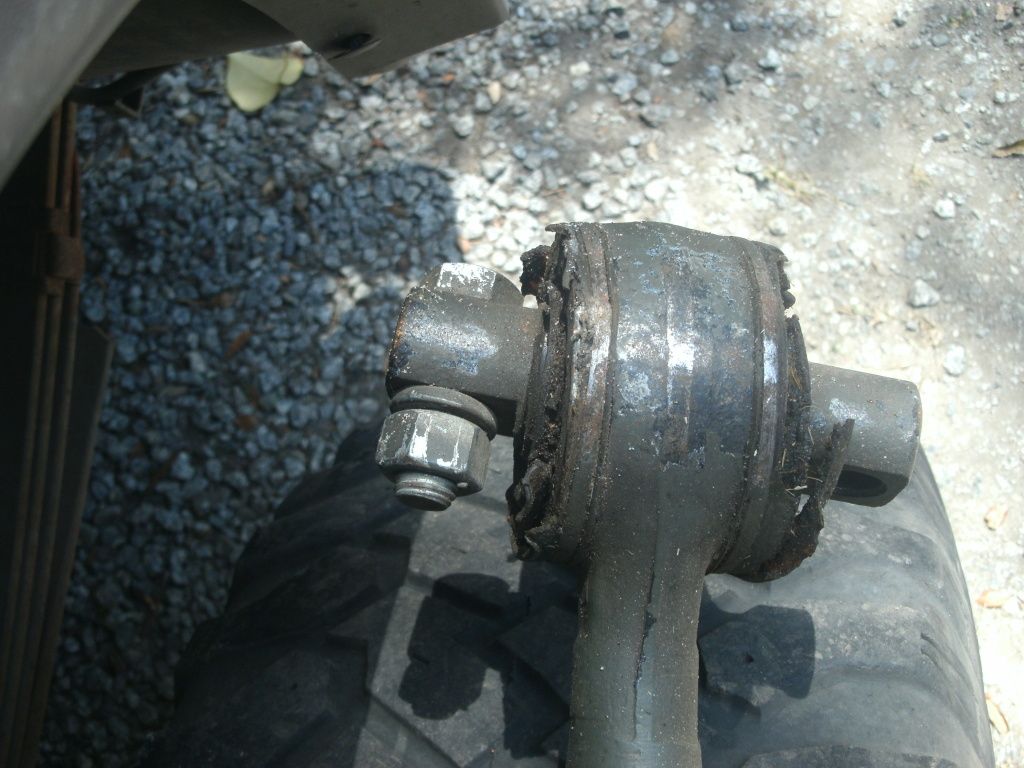

I plan on trussing the rear end like I did the front and mounting this to the top with some 1/2" plate and them making another crossmember for the other end. I pic up my doubler and t-cases tomarrow. Super stoked but now might have to biuld a feul cell because the stock tank is in the way. Its alway something right? I have access to alot of these so if your nice to me I might be able to send you one.
looks like the links off a Super I truck....
you do know that ya need the link to be about the same length as the DS so it doesn't bind....
looks good so far:icon_thumby:
l8r, John
Those arms are big, Railman is right u do have to have the arms almost the same length as the drive shaft or its going to limit flex.
That doubler will be sweet. For the fuel tank clearance u might be able to go with a Bronco 2 tank and fit it where the spare tire sits.
