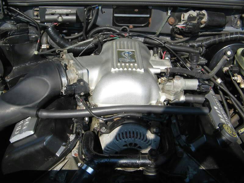

N/A DOHC Cobra engine in a 98-01 Ranger
The S/C engine is about the same height...

Cam change isn't that expensive. MMR will degree a cam for anyone who is lazy and the kit to change the cams is only $80 and can be rented. The 4.6L will fit pretty easily in the engine bay the 5.4L will as well, but the deck height and stock intakes are taller. The 5.4L DOHC has been done which is taller and wider than both. The thing for any of the mod motors is getting heads that flow. Trickflow heads cost money, but they embarass all other heads for flow (based off the old 427 SOHC motors you know the ones banned from nascar).
