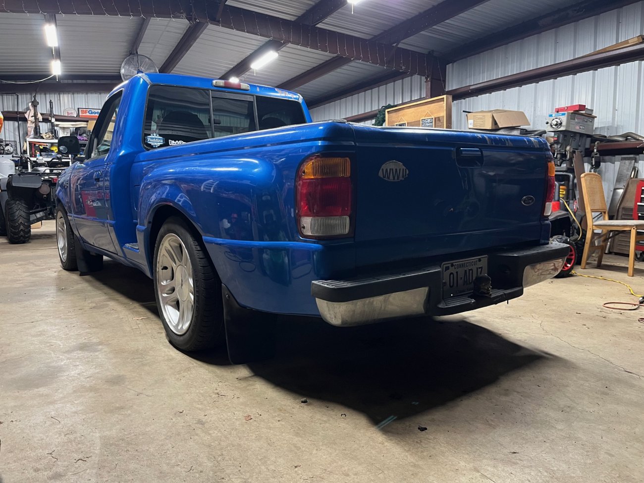

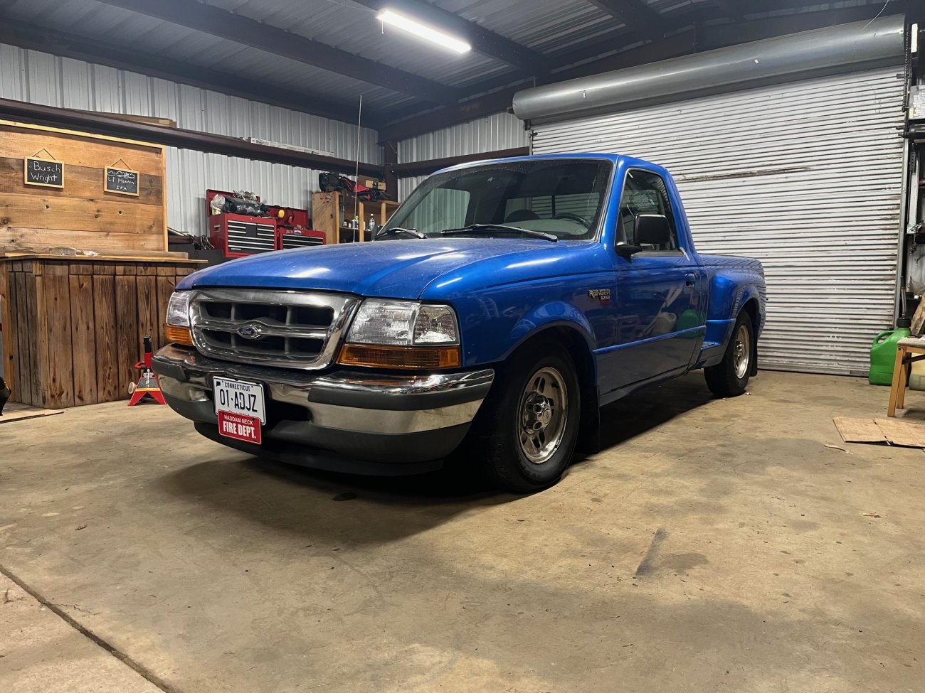

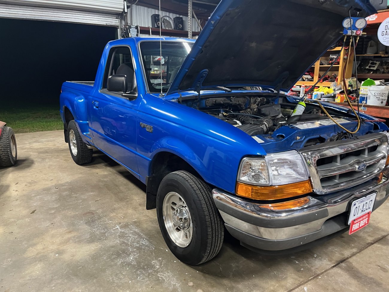

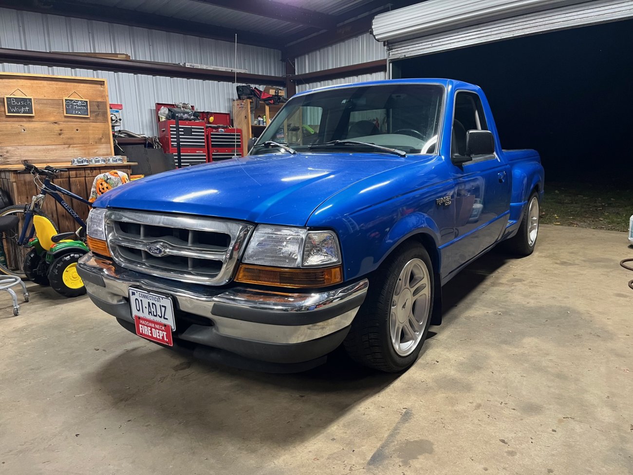

In this thread, I'll be documenting my 1998 Ranger 2.5/auto --> 5.0/manual swap along with any questions I have along the way. The truck was "Pepe's" truck, my late grandfather-in-law. When he sadly passed away at ~98 years old, the family mulled over what to do with it. His "little blue Ranger" had some rough years and we all knew it needed some attention. Instead of sticking it at the end of the driveway with a for sale sign, I stepped it to take ownership of it since it had such great sentimental value. I've had the truck for some time now and have made some marked repairs and improvements to it; drivers floor pan repair (rear glass leak, Sherman 576-40L fit nearly perfect), 4/5 DJM lowering kit, 1997ish Mustang GT wheels, custom side exit exhaust, etc. The truck has been a blast to drive, but lets be honest, its SLOW, and I've never been one to leave anything alone.

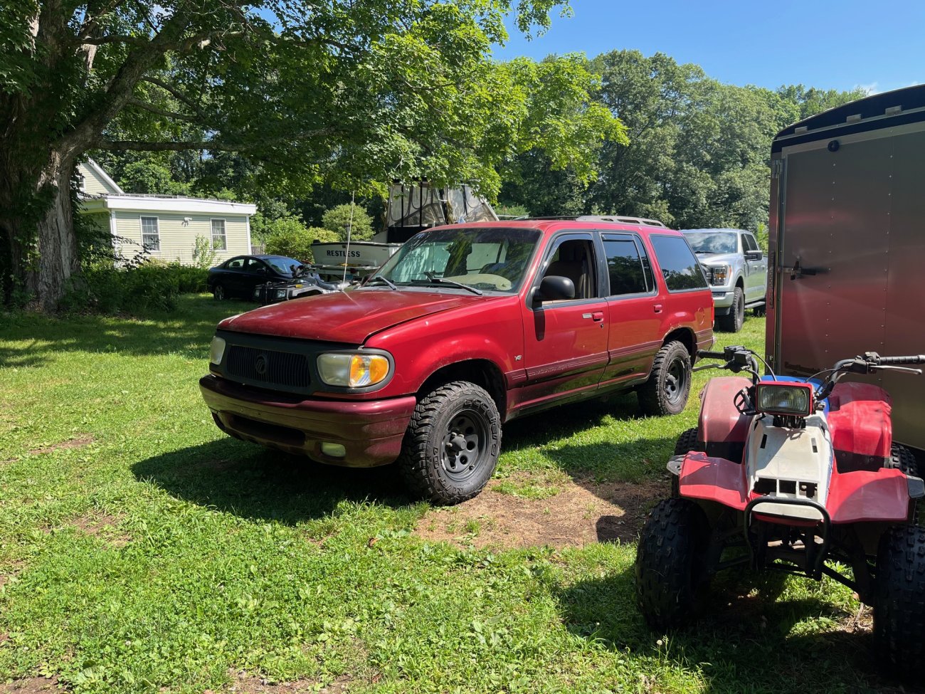

After doing my research here in the tech library and across various threads, I kept an eye out for a suitable explorer or mountaineer. I had several saved on FB Marketplace until the "perfect" one popped up, a 1999 Mountaineer, 184k miles, runs/drives, brakes no good, rust throughout, etc. A couple items in the listing justified the list price of $1400; OBX headers (NLA), DUI Firepower ignition kit ($289), and that it was listed as being RWD. I was initially set on manual swapping the Ranger during the engine swap, but figured this would be a drop in solution from radiator to rear axle. Unfortunately, it turned out to be AWD, and it didn't run very well (seemingly missing on one or two cylinders). I was able to talk the seller down quite a bit due to the unknown reason it was running poorly and that it was misrepresented as a RWD truck. Got her home and started digging in. One of the spark plug wires (#8) was not a DUI Livewire and failed testing with no continuity. I also found cracked porcelein on #4. A set of Motorcraft plugs and Motorcraft plug wires later, and it seemed to be running on all 8 again. There is a lot of the Mountaineer that I can resell, which I hope recoups most of the initial investment cost.
