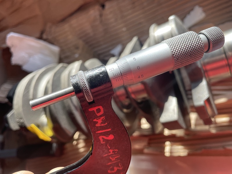

Today early morning I found a few minutes to measure the crank.
Seems the main bearing journals are very close to STD and the big end even closer (see photos).
Checked all of them and the measures were exact to the possibilities of measurement of my tools :)

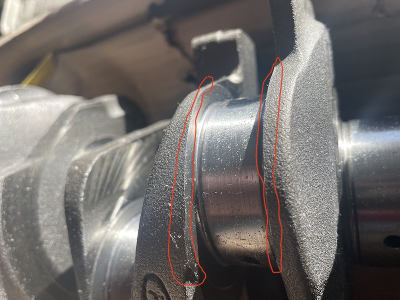

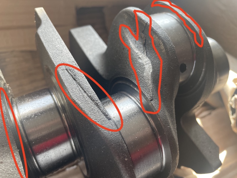

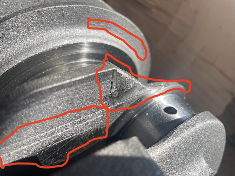

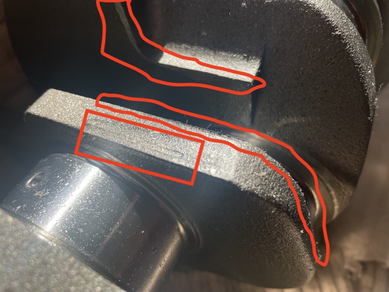

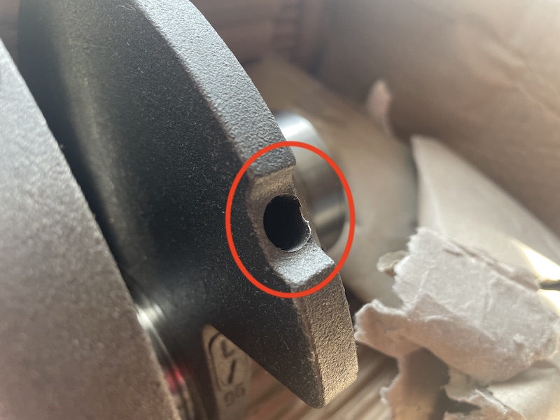

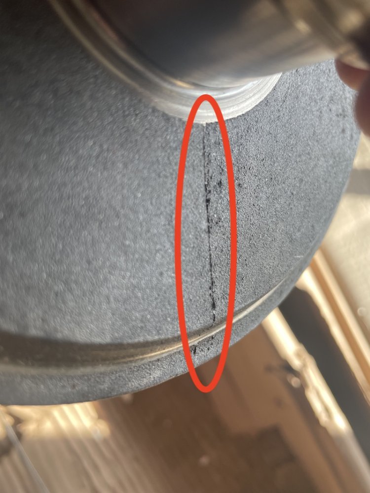

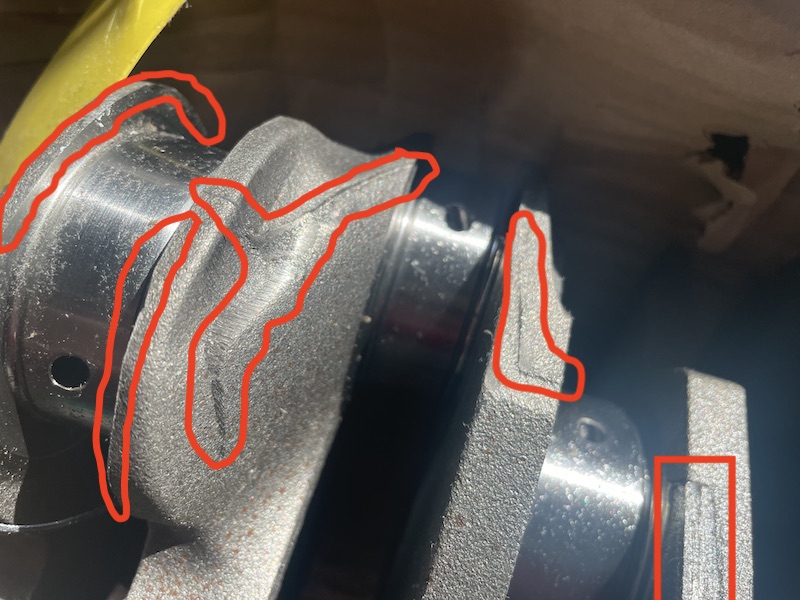

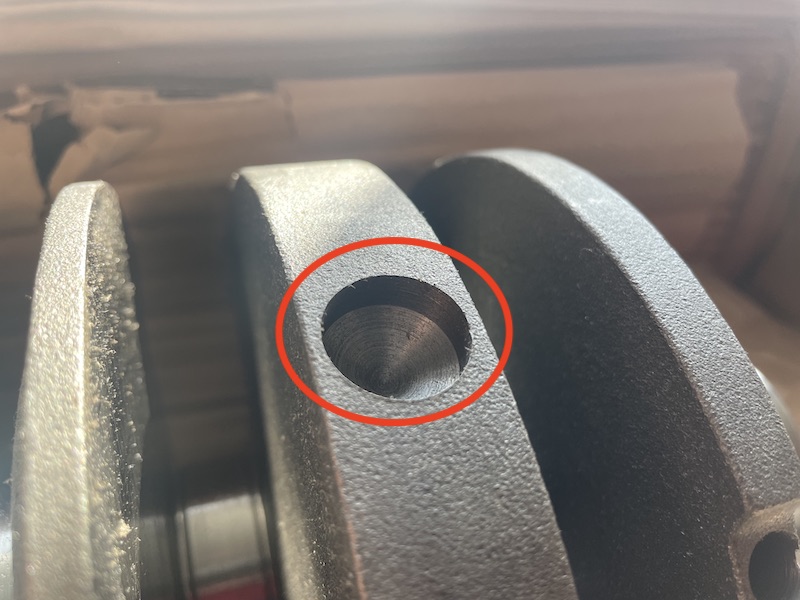

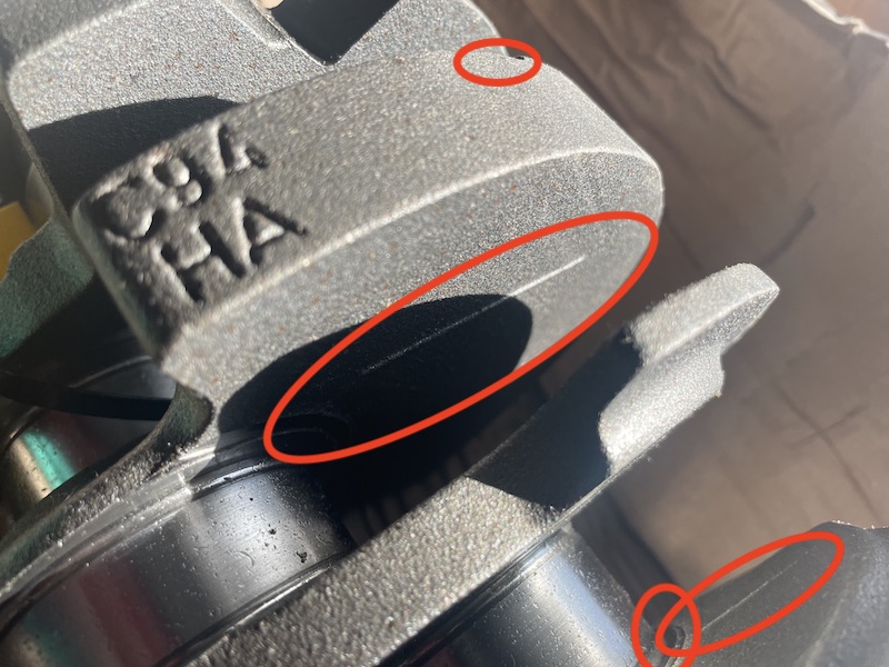

I did take a closer look at the crank today... Well, let the photos tell the story of the quality of the casting...
The good thing is the oil passages in the journals are chamfered. Not sure though if by factory or the company I bought the crank from (it supposed to be crack tested and bend tested and in STD sizes). I am curious how the crank I currently have in my 4.0L on the stand looks like - will be interesting to compare.
For sure I will do some grinding, chamfering and so on. I'm just thinking whether I should grind ALL the casting structure flat? (That area that was not machined and looks like depressed sand in iron I mean). That's a question mark, but from the perspective to reduce any points that could be the beginning for the cracks later on I think this should be completely flat. I need to check if in an old Sunnen book for engine machining there is anything mentioned for the deburring process...
I guess this adds additional weeks to my build, but I just don't cut corners... (but for sure some I will, with a grinder :D)

@konrad911 ,
Everything you have circled/highlighted are areas to deburr/clean up. When I do this to a crank, I follow Sven's guidance, nearly to the letter; in my experience, the results are worth the effort!
In my unprofessional opinion, there is no need to grind the rough sand casting tho there is no harm either as long as there is no major removal of weight. Talk to the machine shop that does your crank balancing and see if they think it's ok to knife edge or smooth the counterweights. The sharp machined edges I would maybe take the edge off. I dont think there is any reason to worry about cracks forming from the holes drilled in the counterweights as there wouldnt be any force but centrifugal operating there. I also think there is the possibility of introducing problems if you're not careful.
Well well… if I will go for shot peening, and most probably I will, then making the rough casting surface smooth is a must IMHO to get the surface evenly hardened. And just after all of that crank will go to nitriding. At least that in my understanding is a fully prepared crank.
I’m not that much worried about imbalance of the crankshaft after bits of grinding. This will remove the material rather evenly, so this will impact the crank balance if at all just slightly. I’m not planning to remove any bosses or so. Just to make the surface smooth in touch. No sharp edges.

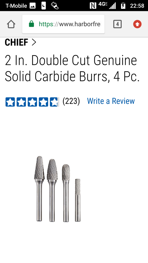

@gaz - what tools you find best for deburring process?
I ordered the 8 bolt flywheel that will accommodate the 10.125” clutch.
I’m getting worried for my tranny now :D
@konrad911 ,
The best tool to use is a ¼" driven electric or air handheld grinder with the appropriate shaped rasp (cutting head). It is good to have an assortment of different shaped rasps and cutting heads. An electric Dremel could be used but the time required and cost of materials would no dought be higher.
