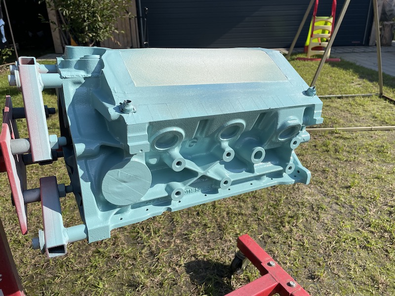

Fall is coming to my location, so having probably one of last warm and sunny days I went for it and painted by block.
3 different paints there. Wash Primer (with anti corroding additives), acrylic primer and acrylic paint in color. Should last for some time. All properly cleaned and sanded before applying the paint.
My kid was picking up the color from the ones on the shelf (orange, yellow, navy blue, dark grey, black, light grey and the one on the photo).
Looks nice and should match nicely the color of the car (orange). And no-one would tell me it's Hemi Orange or so :D

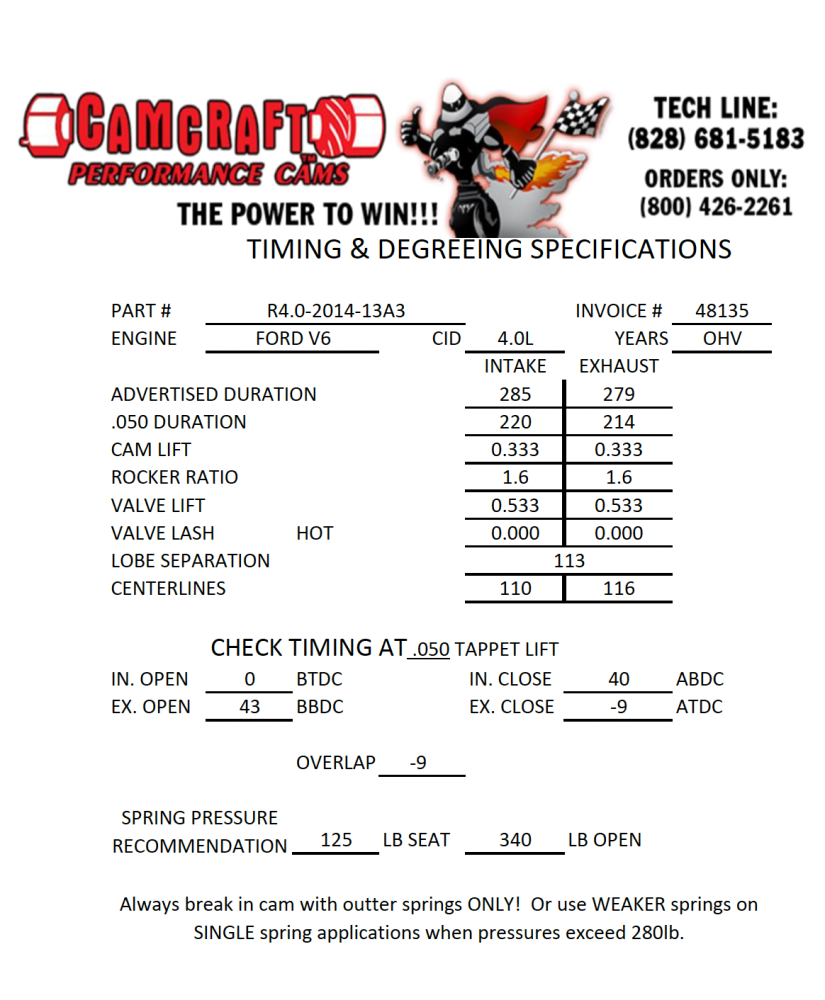

Finally some good news. Talked to Camcraft Cams and they can grind me anything I need woohoo :yahoo:
They have blanks available, so basically anything I want is in reach. I just need to think about the profiles I want.
They told me those 2 grinds available on their website are rather conservative, as these are designed for guys leaving the ignition stock.
But as I will be running standalone, the ignition is not the case and we can go really HOT :D
I just wonder if 340lbs for springs is not to much. This engine won't rev like to really high RPMs, so I don't expect valve float to happen.
Stock spring is around half of that, right?

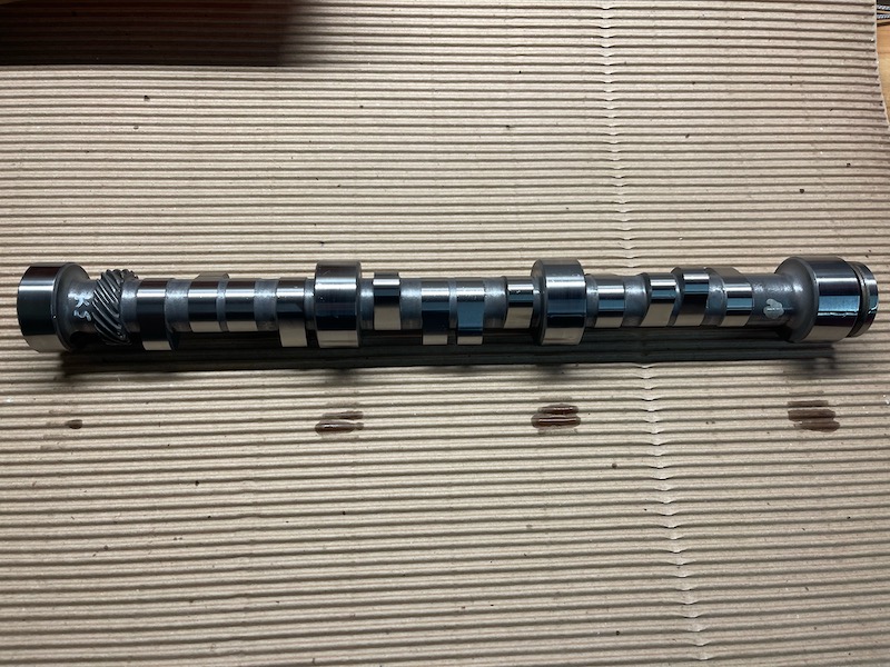

Believe or not, the cam "just" arrived last week at my place.
This means things needs to start moving now.
No more excuses for not doing the deburring of the crank or the block ha ha.
Things to note, as I will use the late (latest before SOHC) crank with 8 bolts for the flywheel I also need to change the timing chain "set". So the cam and crank sprockets as well as the chain itself as it's different (wider). I got the crank with the sprocket and it won't fit the earlier (non woodroof) setup. Pitty I did not pursue that change earlier as I would have that in the package with the cam and other stuff I ordered few months ago...
