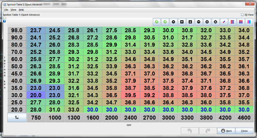

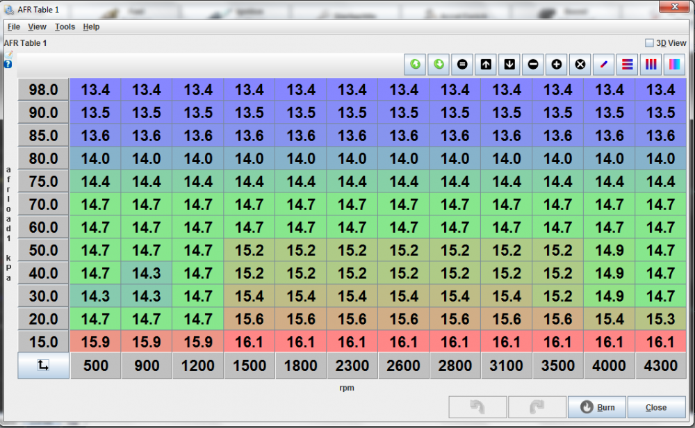

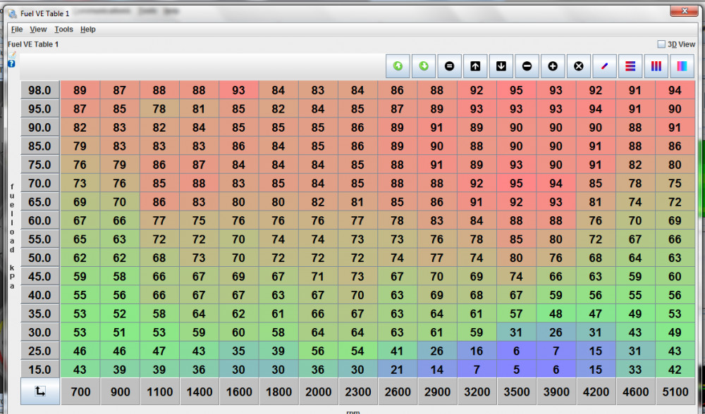

Screenshots of the AFR, ignition, and volumetric efficiency tables are attached as well.
