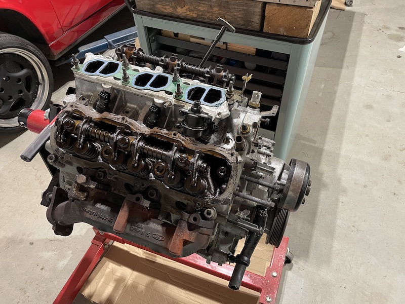

Intake off - not bad for a 30-year-old engine IMHO (for the time being)
2.9L w/ MegaSquirt to 4.0L w/ Ecumaster Black and a Turbo build
Exhaust headers off..
On both sides...

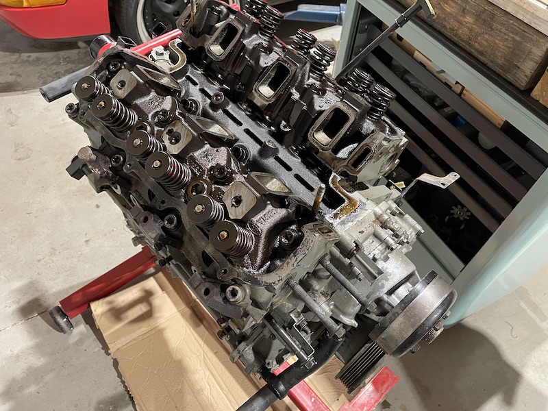

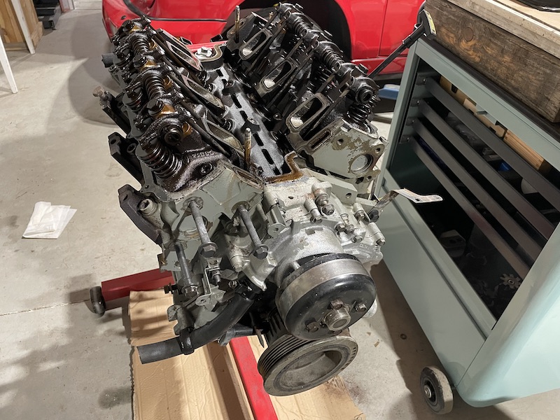

Time to take the heads off. Removed the rocker assembly to access the head bolts.

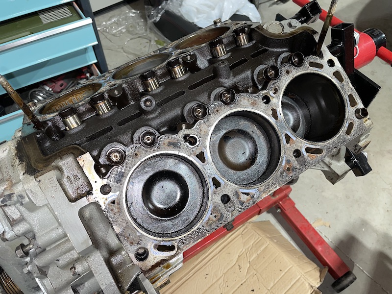

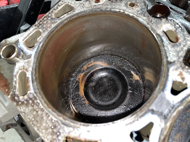

And a surprise on cylinder 3 pops up...
After spraying WD40 and cleaning with paper towel.
I can turn engine by hand by pulley, which is a good indicator. Not sure though if these STD pistons (I expect them to be STD) will serve further :-(
I will need to disassemble the engine further and measure the cylinders in addition to this rusty surprise as I can feel a step on top of each of the cylinders, which obviously indicates they have worn.

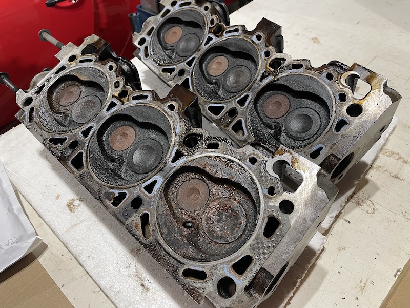

Heads look like below. Intake valves seems to be flat with head surface, exhaust seems to stay out a bit above, but not equally for each valve.
I'm just thinking, as I will do some porting work on these heads anyway, if not to make the shape of the combustion chamber more like sphere.
Obviously this would lower the CR, which in forced induction might be a good thing in the end.
I was not expecting a Grand Canyon that I found there honestly, Ford engineers must have drunk something strong when designing that :D

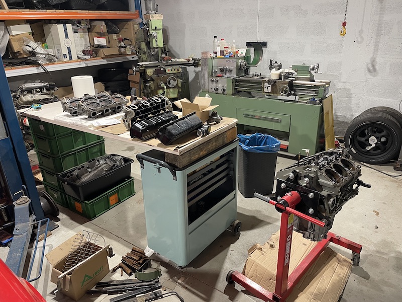

And here's panorama on my workshop (I need to build a proper table on wheels, as when doing engine works I cannot park there anything).

Konrad,
I would do as little over bore as necessary. If you are at standard bore now, then + 0.02" (0.50mm) if possible and if if required. You are not trying to bore/stroke to 5.0, you are making a 4.0L turbo; I would want as much block/cylinder strength wall as possible.

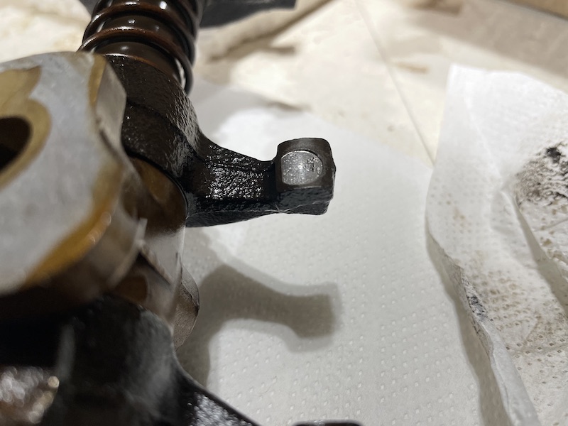

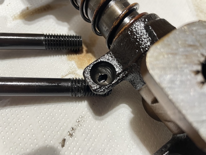

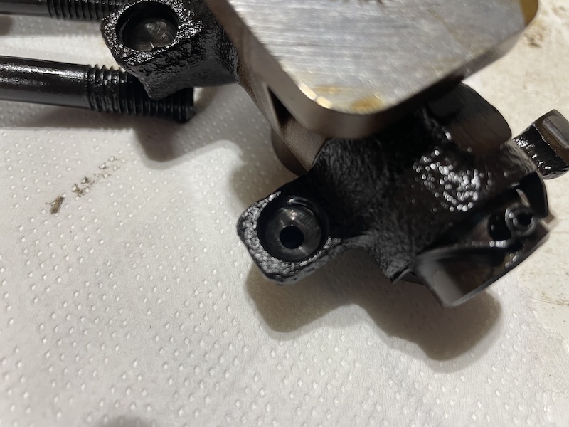

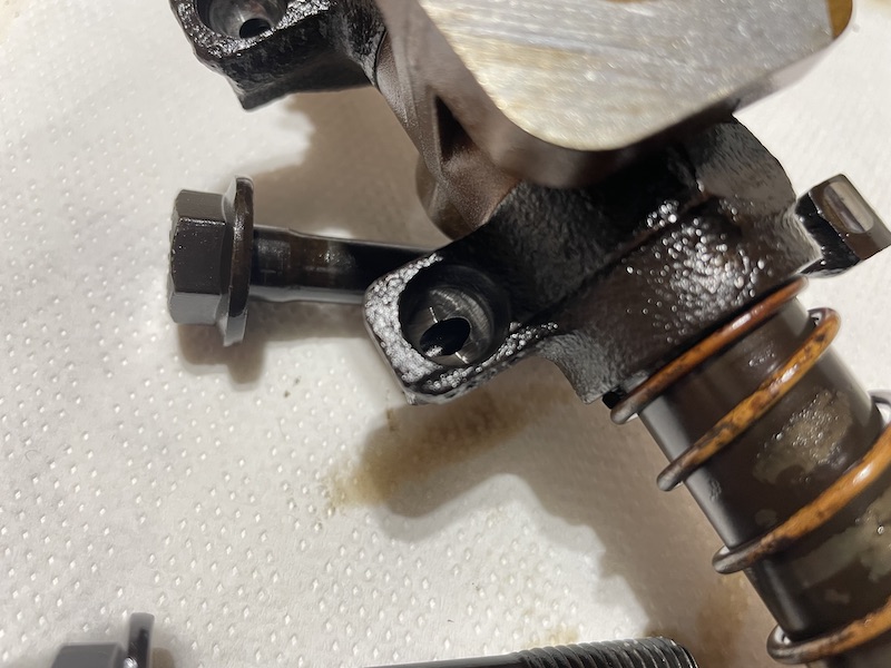

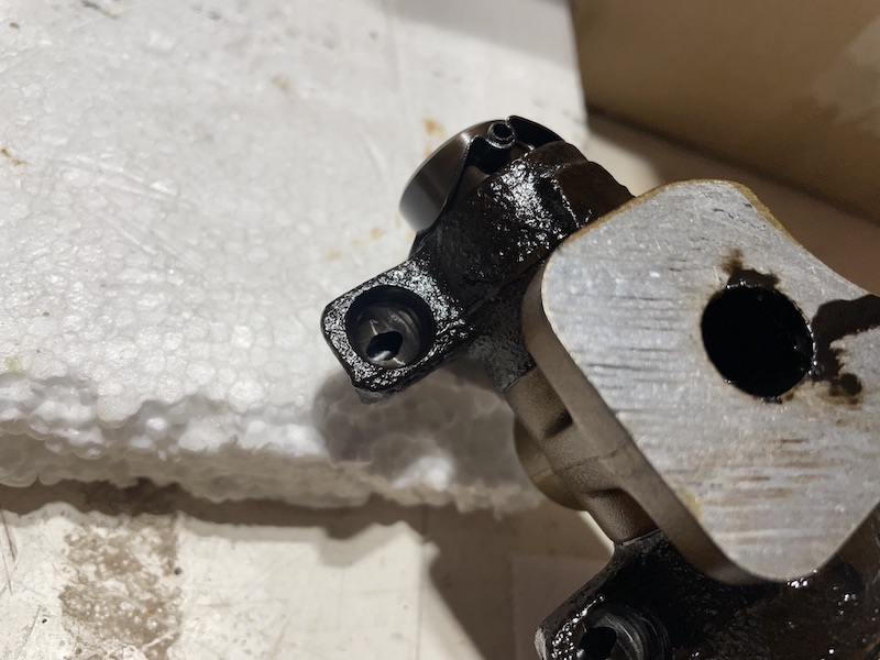

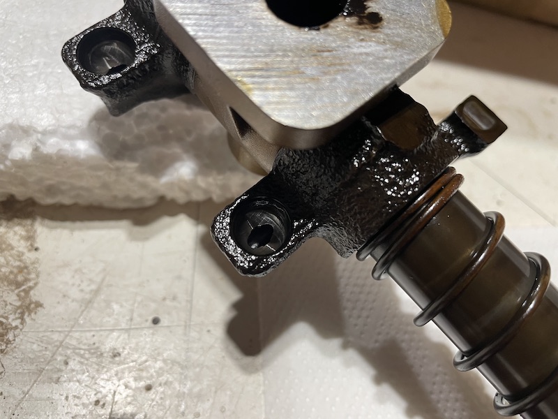

Pushrods are dead. Clogged and polished, especially on top. I'm sure they are out of specs.
One of the followers has the collar that is around pushrod slightly broken - one of 4 latches is broken off.
I'm thinking if I'd need new rocker shafts - although I've read these often are out of spec and cause issues... What issues?
Really not willing to replace everything in that engine...
Konrad,
This OHV 4.0l valve train is NOT ADJUSTABLE, so when the push rods or the rockers wear, the valve train gets sloppy with no is adjustment possible!
The cups in the rockers get hogged or mishaped from the push rods, the push rod ends wear on both ends which both shorten and causes them to loosen. As the pressure on the hydraulic lifter is reduced from component wear, the lifters lose their preload, then they are less unable to efficiently open and close the valves.
Should I consider replacing hydraulic lifters or just wash them in ultrasonic cleaner?
I expect pushrods were made of a soft-ish material that wears out soonest, to save other components (rocker arms, hydraulic lifters).
But I might be so wrong :D

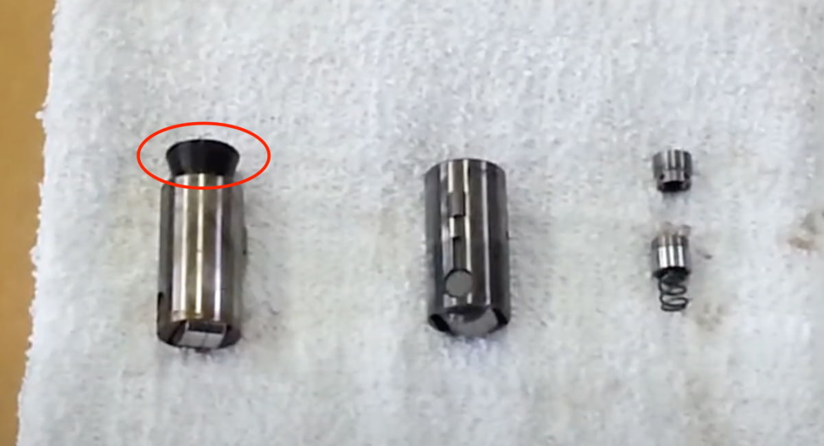

Recently I read that the lifters are double walled and very hard to clean properly. Not sure where I read that.... sorry.
Well I'll certainly try to rebuild my lifters. Here's a nice video how one guy did it.
I want in addition do the ultrasonic wash for them.

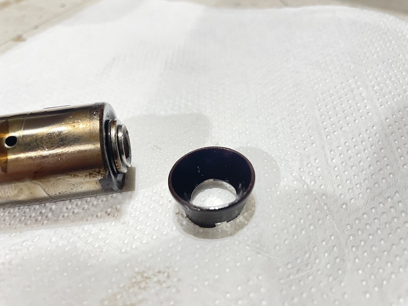

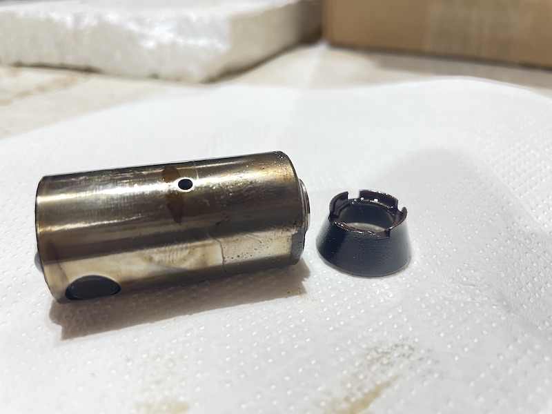

On one of my lifters one of those plastic cups fell off - is this a replacement part? How it's called? P/N? :)

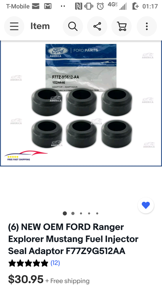

Konrad,
I think these may work, they are for SOHC 4.0l, I am still uncertain if they will work for OHV 4.0l. If it isn't damaged, it should slide back on.

My bust, those are for injectors.

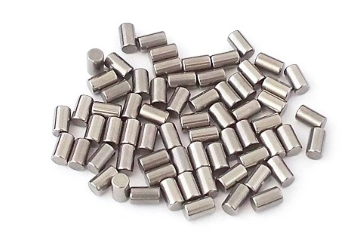

Appreciate your offer to help, but common this is not rocket science. I expect press fitting a roller from a bearing that is made for a highly hardened steel would work just fine... Need to think about it for a moment or two :)
It could just stand out of the rocker arm and be ground to a height of need. Just an idea :-)

So as of the lifters, I'm talking about that part... One of 4 latches broke off.

For the rocker arms I think I just need to buy a set of new ones together with pushrods :-/
Found these on eBay (Northern Auto Parts)
The above seems to be best time/money ratio. Not sure about the quality, but if these survive 100k miles it's more than enough for the whole life of my car.
Mine look like this, I expect excessive wear has a new meaning redefined now :D
