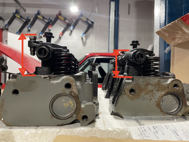

Just thinking, maybe it's possible to change to the manual adjusted rocker arms and pushrods as in earlier 2.8L V6 engines?
I must take a look, maybe I have a set somewhere in my garage...
Anyone did it before?
So my thoughts are - rocker arms' assembly from 2.8L almost bolts on.
The rocker arm shaft of 2.8L is about 5mm shorter and therefore the bottom two rocker arms and tower neighbouring with them are misaligned.
Should be easily solved with the towers & shaft from 4.0L (same diameter of the shaft).
The assembly is slightly higher though, so the rocker covers from 4.0L will not fit. I have the Aluminium ones from 2.8EFI that will bolt on! :)

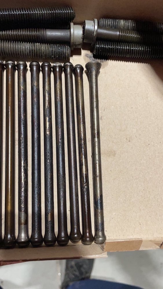

Pushrods are virtually same length and by having the adjustment screw on the rocker arm...
Well I might just saved few hundred of bucks, right? :cool:
What you think???

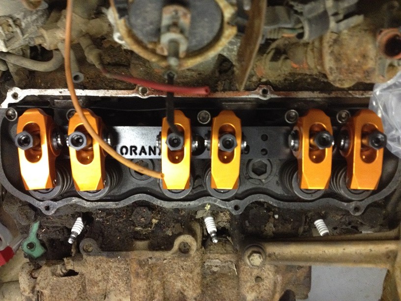

on eBay all shapes and colors and ratios from $129 for a set of 16 rockers, with studs. Just a mounting adapter plate needed to bolt to the head where the stock posts/towers are and then use studs to secure the rocker arms to that adapter plate.

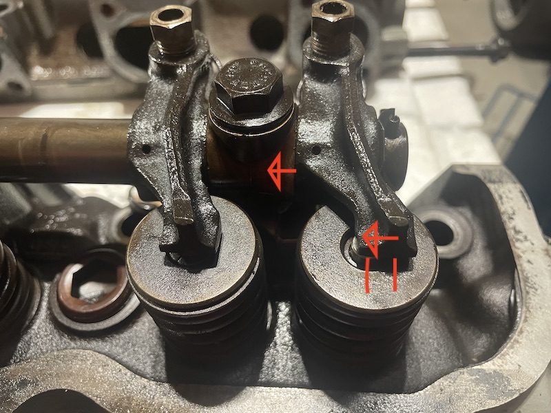

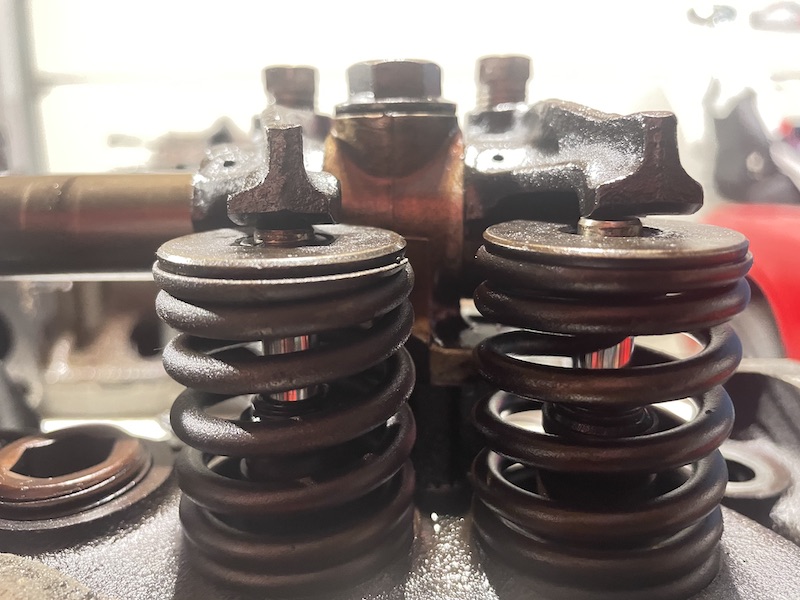

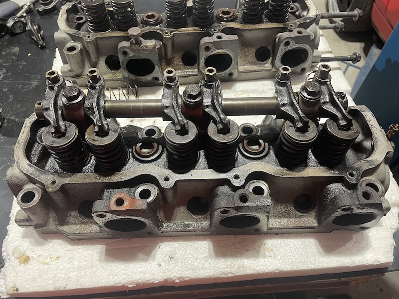

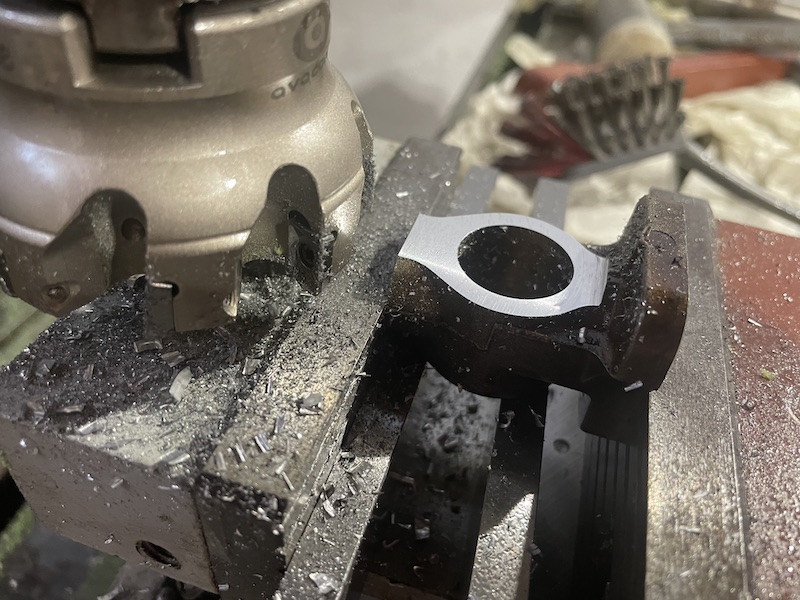

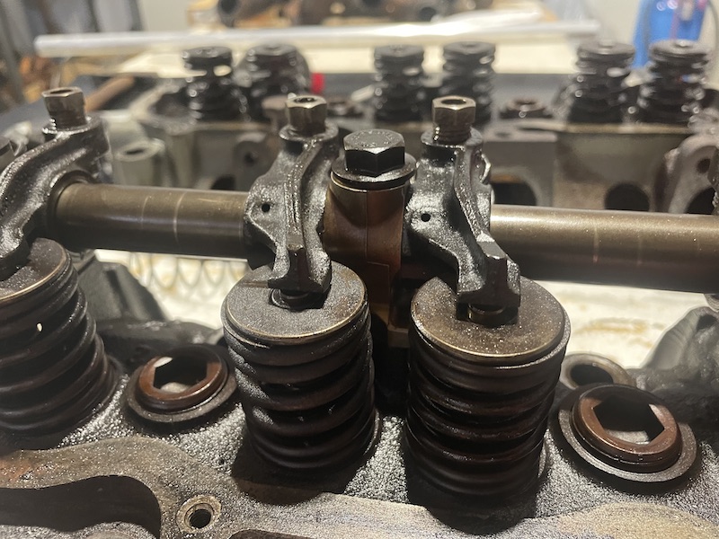

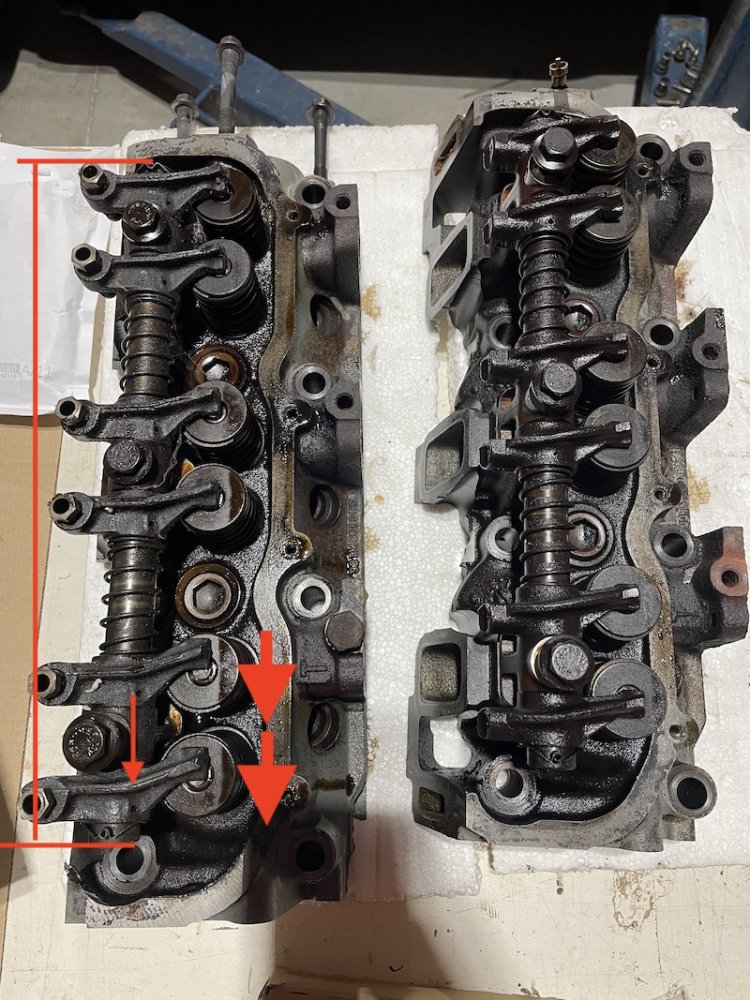

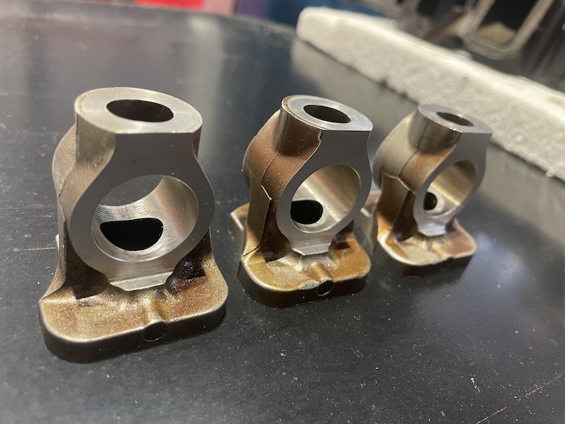

I moved the 2.8L rocker arms to the 4.0L shaft and posts. I did not notice that earlier, but every 2nd rocker arm is misaligned with the valve by c.a. 4mm.
I think easiest way to fix that would be to remove those 4mm from one side of the post.

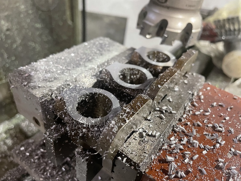

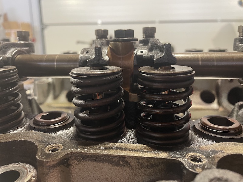

Saturday morning, what a nice time to do some milling :D
Started with one, just in case... 3mm of the material removed.
As it seams all fits nicely the rest followed.
Chamfered the edges and ready to install.

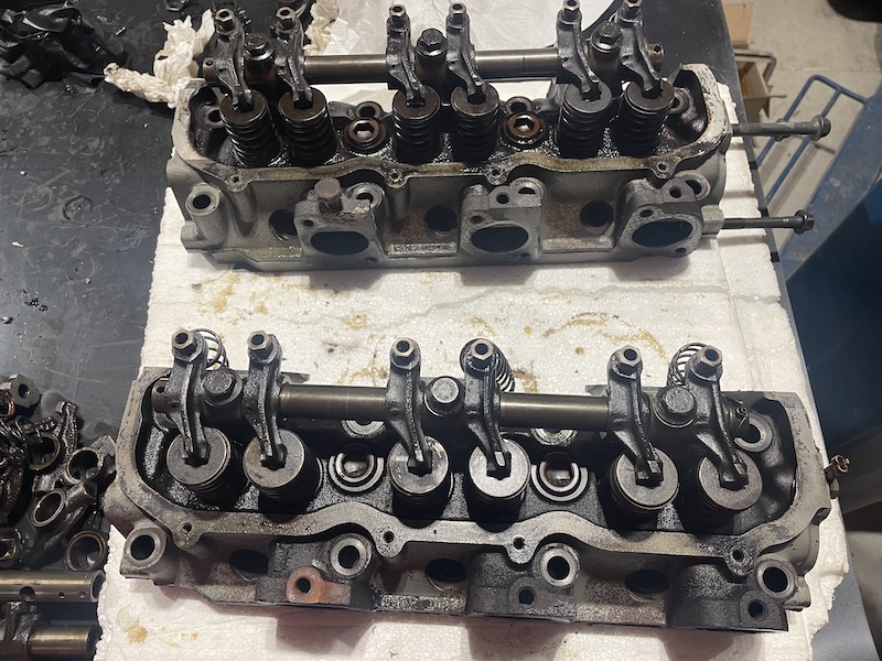

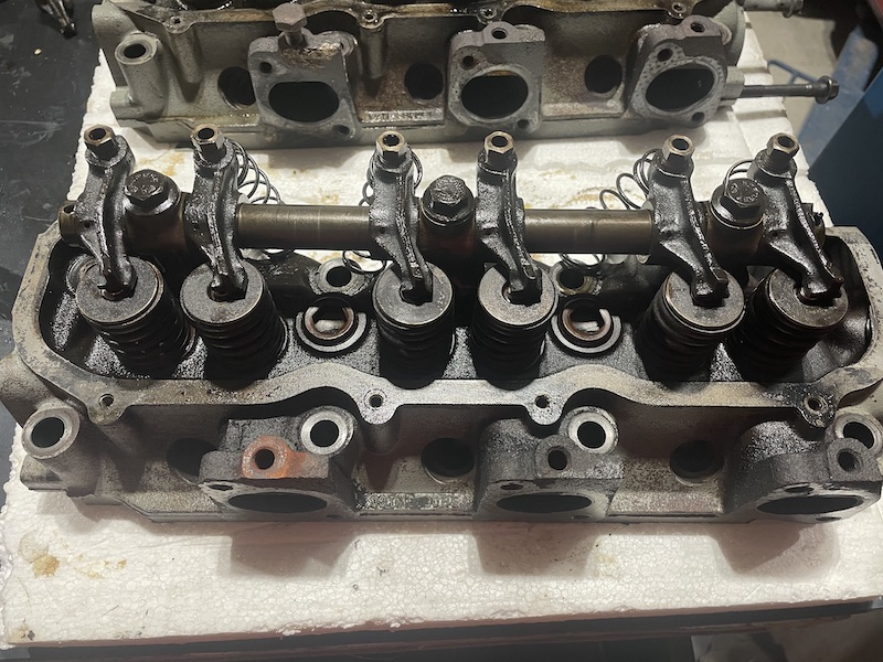

First head first.

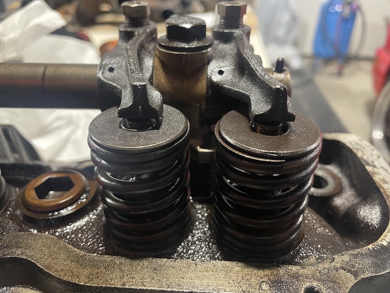

The alignement of rocker arm and valve is much much better now. Even compared to the marks on the rocker arm from the stock 2.8L assembly, stock was not centric.
And here both rocker arm assemblies done.
I assembled the 2nd head rocker arm assembly just to be double sure before machining, but seems Ford was consistent. This side also needed removal of 3mm of the material from one of the side of the posts.

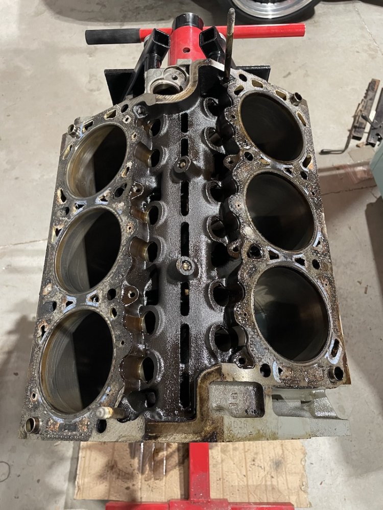

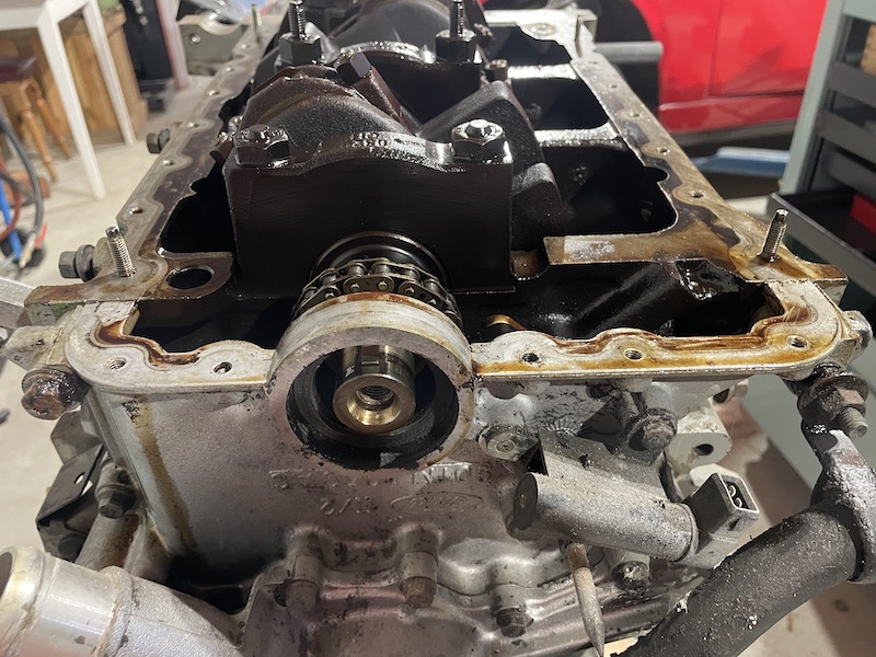

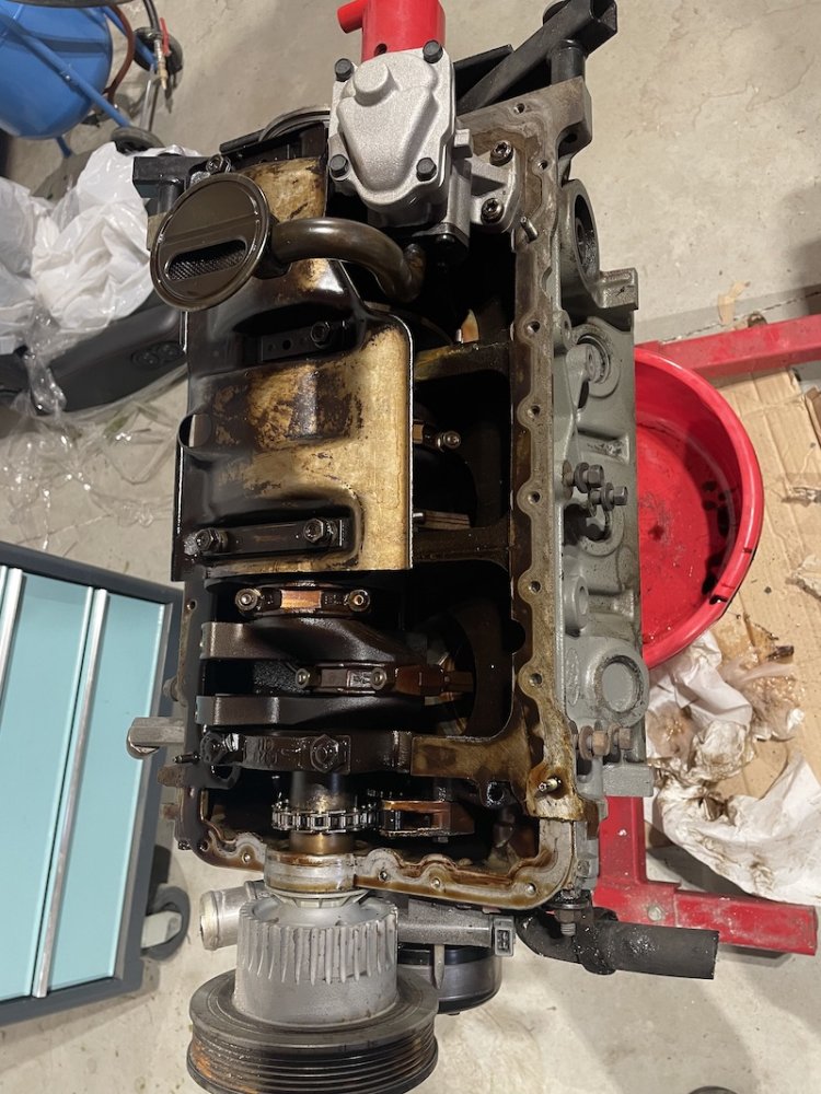

I managed to strip down the engine today.
Each cylinder has a step about 1/4" below the deck.
STD bore is (100.38mm) [3.952in]
My block which is the 1990-1994 can handle 0.060 overbore (found it somewhere in the web), with a safe 0.048 overbore (Doug Anderson) which gives 4.00 bore, which is SBC bore right?
Measured the cylinders on X / Y axis just below this step (metric) [imperial]:
1. (100.43 / 100.57) | [3.954 / 3.959]
2. (100.44 / 100.46) | [3.954 / 3.955]
3. (100.42 / 100.48) | [3.9535 / 3.956]
4. (100.44 / 100.56) | [3.954 / 3.959]
5. (100.43 / 100.54) | [3.954 / 3.958]
6. (100.43 / 100.50) | [3.954 / 3.957]
First overbore is 3.962 (0.01 + 3.952), so very close to my 4th cylinder, BUT what I see is pistons are only +0.02 / + 0.03 / +0.04.

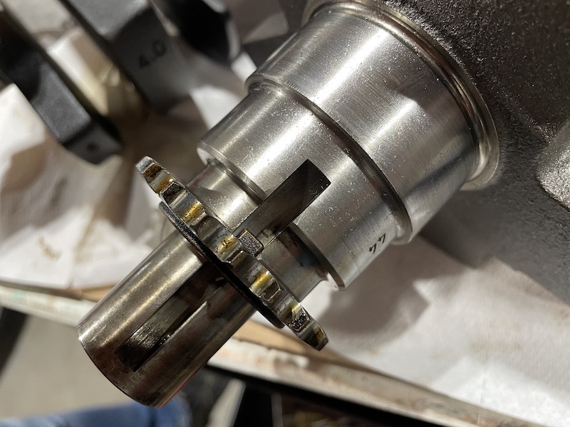

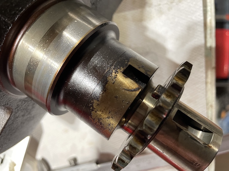

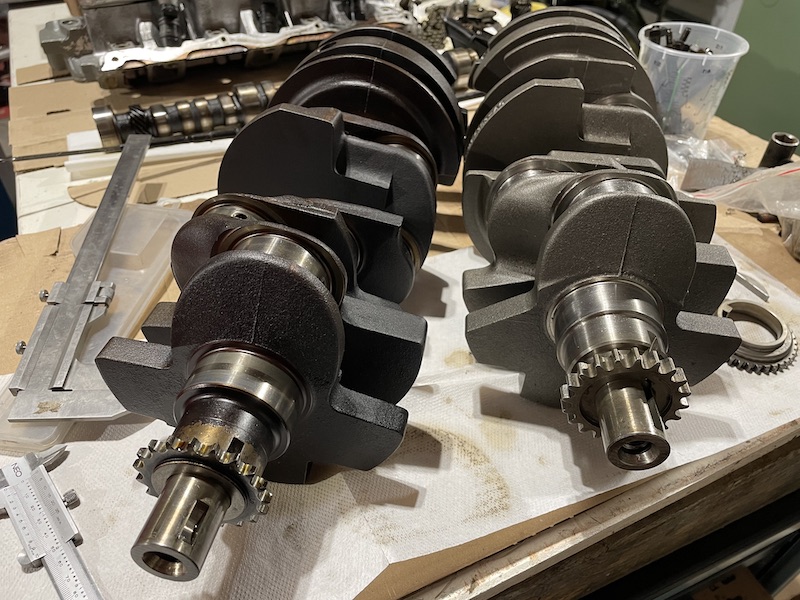

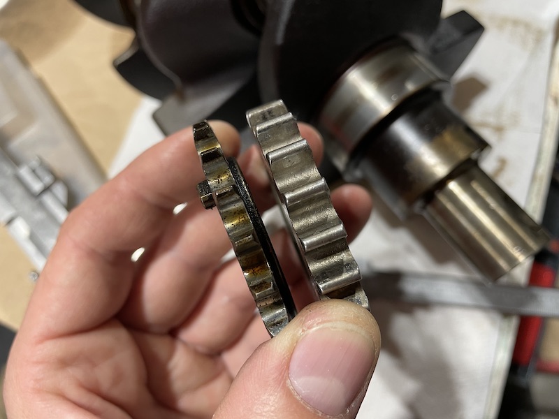

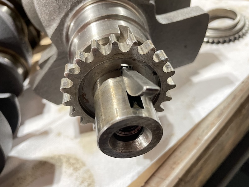

In the meantime I took a closer look at the camshaft chain toothed gear that mounts onto the crank.
These are different and not interchangeable. Seems the later engines with the 8 holes for flywheel used a wider chain.
The locking/positioning is also different. The older type gear uses a "tip"/hole while new type is woodruff key.
Unfortunately the "tip" on the older hear is too narrow and leaves about 1mm of play on the newer crank.
So the idea is to machine a woodruff key seat in the older gear and fix it the newer way.
The crankshaft nose length to the gear is same for both generations of the cranks, so the gear will be positioned in the same place.
Only difference is on gear width where it touches to the pulley/harmonic damper (?) the older gear is 7.2mm the new one in that place is 6.8mm.
But I guess 0.4mm would not be an issue for the pulley to be moved forward of the engine?

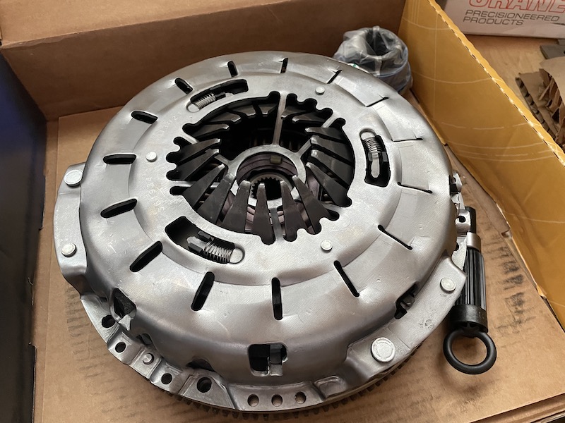

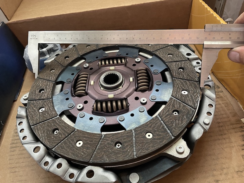

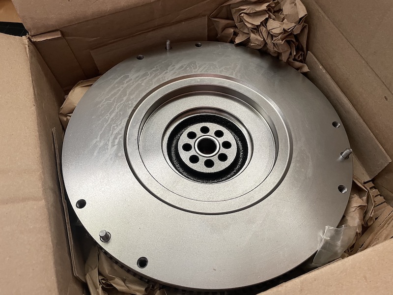

So I have the new flywheel & clutch (257mm rather than standard 242mm) and a set of new oversized Mahle pistons (Friday I'm taking it to the machine shop for boring out the cylinders).
Photos...
